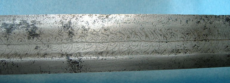

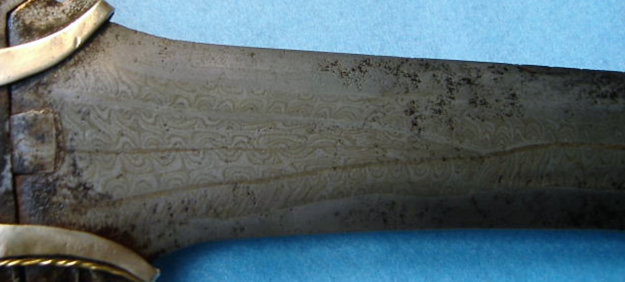

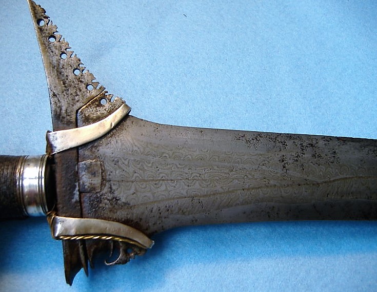

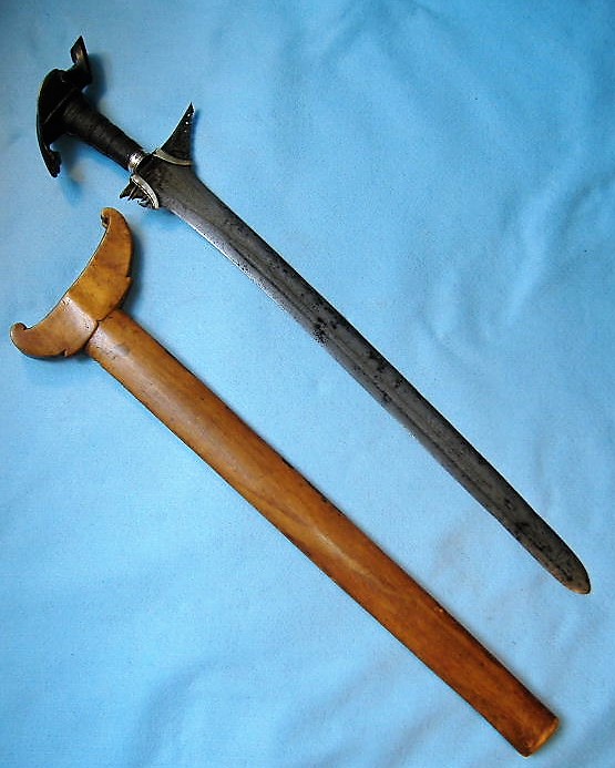

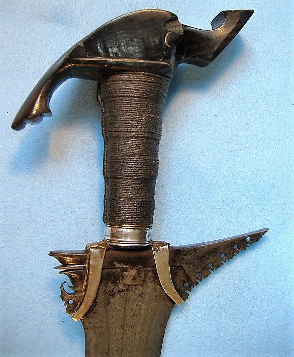

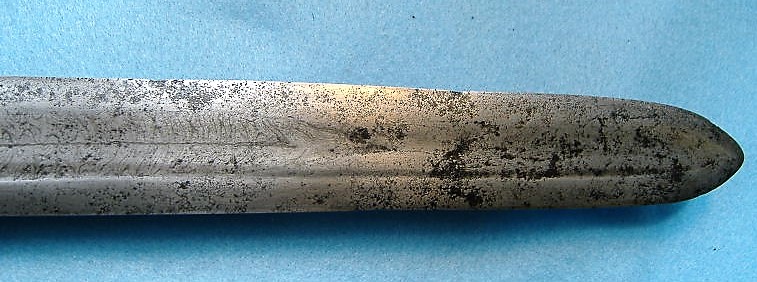

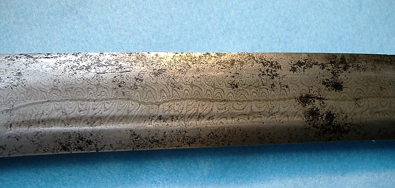

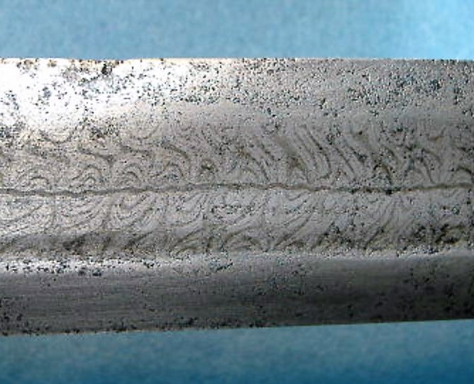

This well worn Moro blade is naturally fascinating because of it nicely defined twist core, but it has some interesting odd characteristics as well. For instance, I cannot figure out the need for the clamp and pin between the blade and ganja. I would think it would be associated with the tang, but for what?
Also, why add a fuller to the bottom half of the blade??? To me it is just a distraction from the lovely twist core. Would a fuller really lighten the blade that much. It's hard to believe that removing just that much metal could have played a major factor in the kriss's balance, but I suppose not impossible.
Ideas and comments are welcomed.
Dimensions:
Overall length(no scabbard) 29.5in.
Blade length: 24.75in.
Width of the blade for the majority of its length: 1.5in.
I believe the kris was refitted with a new tang. Clamped and pinned to secure the new tang.
A very nice catch BTW. I like that dark jungayan pommel.

Thanks for the input. Though Battara may very well be correct, I , like you, tend to lean in the direction of the clamp being tang related. The location of it is just too coincidental.

I acquired one of these krisses some years ago; albeit without the apparent tang repair. I have searched for the post without success; it could have been a brother to Charles' blade.
I have trouble understanding why a tang on a sword like this could break accidentally being something obviously created by a very talented smith.
Possibly the damage was done by Colonial forces with an eye toward rendering it useless; but why not just confiscate the weapon instead.

very nice catch! Congrats!! I think that we see a tang repair here, have a look to this old thread: http://www.vikingsword.com/vb/showth...ight=moro+kris
This kris is now in my possession. Regarding the fuller I direct remember this one wich was recently sold by ebay: http://www.ebay.com/itm/Vintage-Kniv...p2047675.l2557
Also the pommel is very similar to yours.
