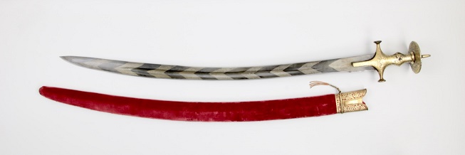

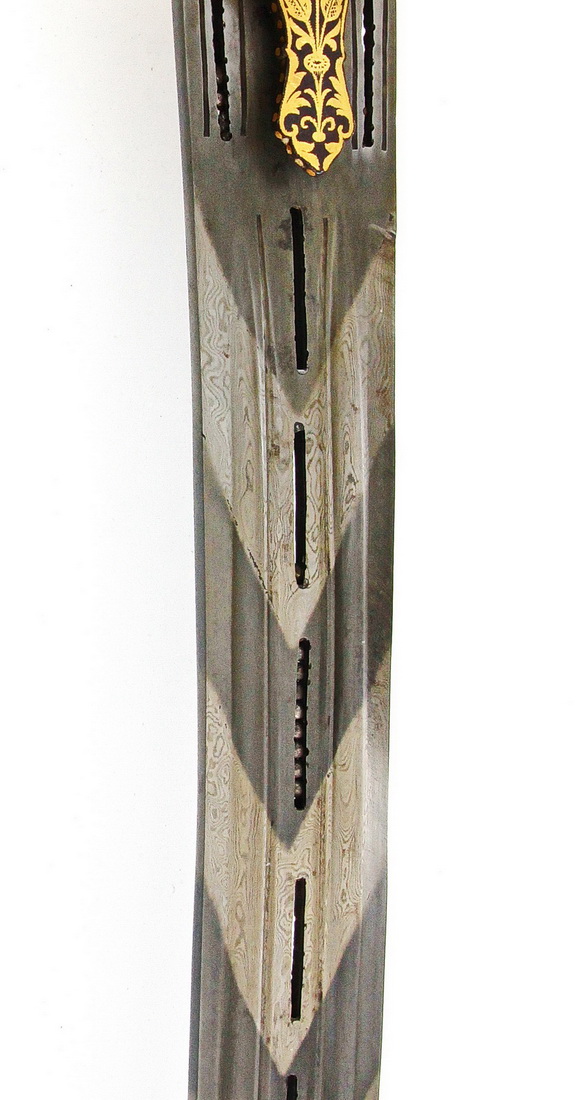

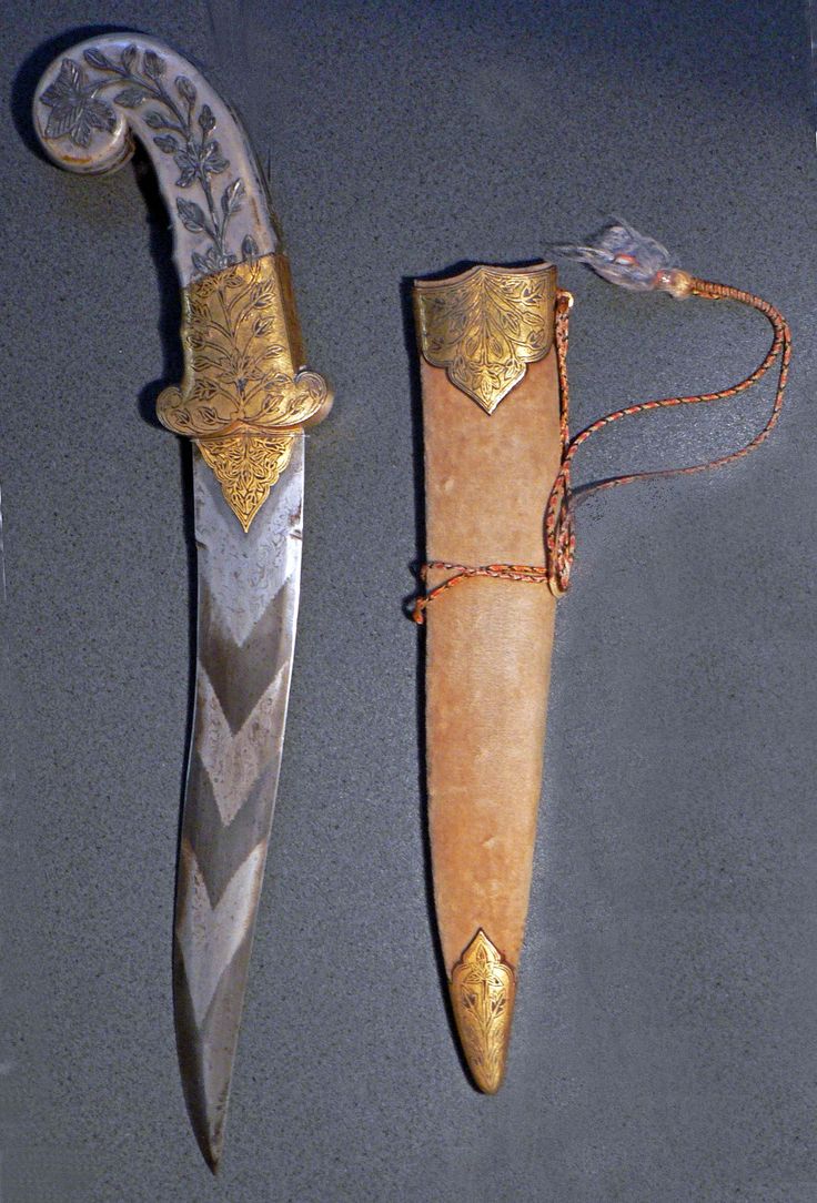

The correct chevron blade are made from pattern welded and mono steel forged together. The blades made with wax are 'the poor man's' blades, and are not the right kind of chevron blades.
Chevron blades were made in the 19th century for the durbars and exhibitions to show the craftmanship of a master smith.
The picture shows a detail of a correct chevron blade. Notice the little flaw between the first pattern welded chevron, and the second mono steel chevron, where the two chevrons have been forged together.
See A Passion for Indian Arms pp. 190-192 and 198-200.
It's interesting to note that Cathey's blade shows a forging flaw in the same area.

Yes it seems so, but it would be easier to see, if the blade had been cleaned and etched.

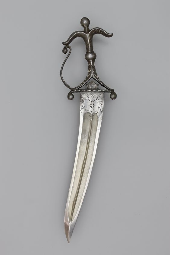

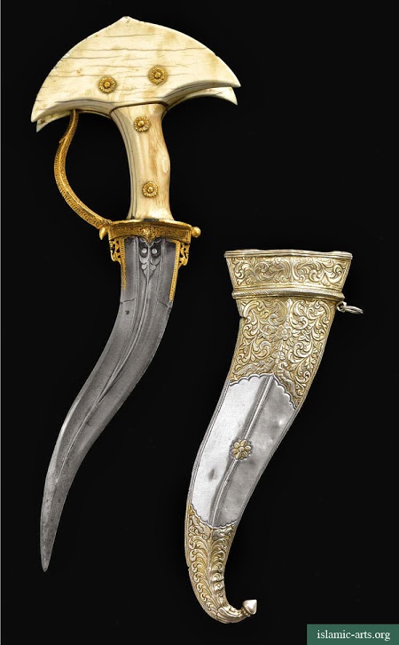

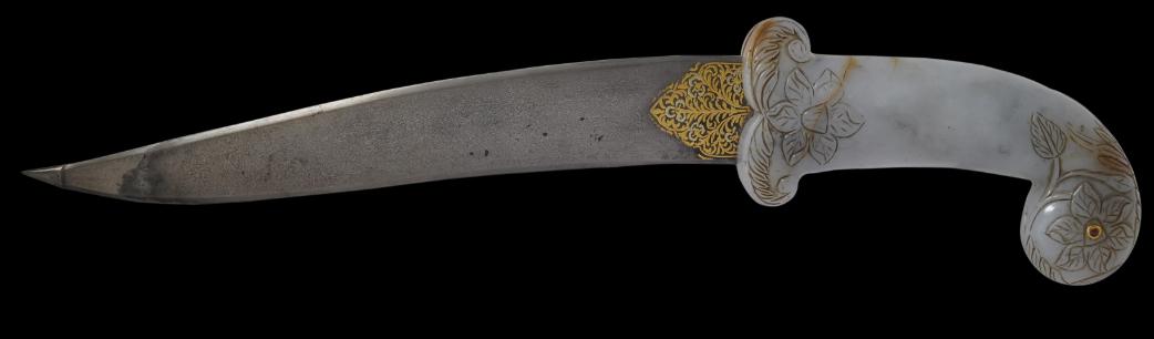

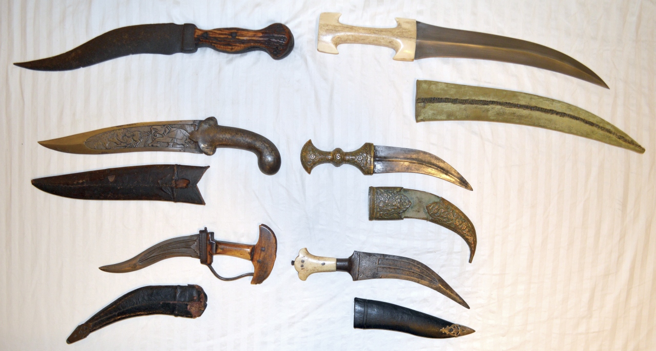

Salaams Cathey and Rex, A great subject and a superb photo and detail though I always have to consider what the difference is between an Indian Khanjar and an Indian Jambia since name-wise one probably comes from the Persian and the other from Arabia ...Yemen. I saw http://www.ewtodanmark.dk/magazine/no%204/Data/p06.html which outlines some variety in Indian Daggers...
I noticed slots in the blade of one follow up example above and filled by small round balls of the style tears of the afflicted. Pulling the right date out of the hat is an art best left to Mr Jens since I just cannot tell from a photo how old these weapons are but in Persian examples they go back to the 16th Century according to The Met. Some delightful examples appear from Moghal court weapons later and these were also sold to Ottoman clients..
Altogether a great subject...
For interest see http://mandarinmansion.com/talwar-lehria-chevron-blade where a an experiment in bending a Chevron sword blade showed it was equally as strong as other blades and demonstrated by Richard Furrer.
Ibrahiim al Balooshi.
Below a few Indian Daggers ..one with tears of the wounded/tears of the afflicted in the hilt. Chevron sword blade included for interest. The lower Chilanum has an unusual Chevron decorated hilt.
