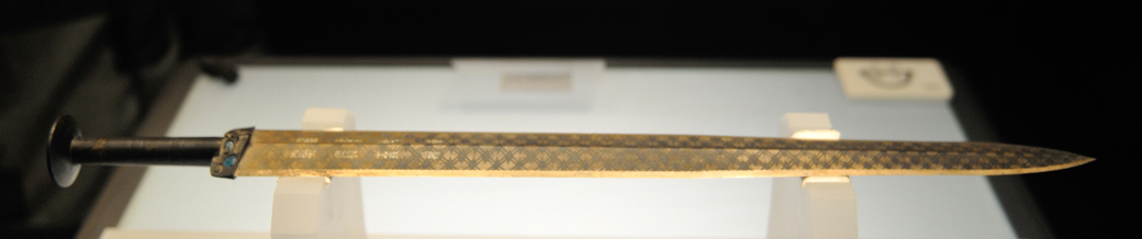

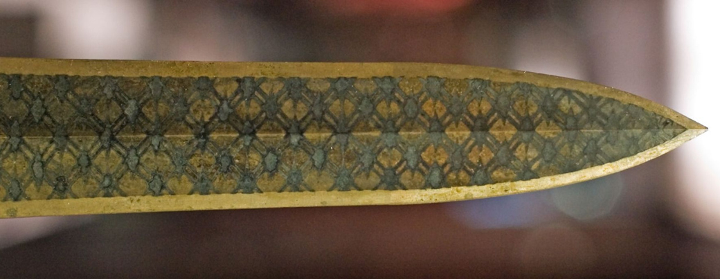

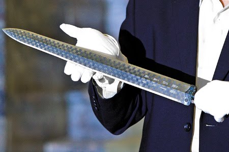

This is not a new discovery, but it has been making the rounds in social media lately. Though it is not really my area i do think it is a really interesting find so i was surprised that in searching the forum i found no previous discussion of it. https://www.youtube.com/watch?v=M6wc...ature=youtu.be
The sword was apparently excavated back in 1965, so as i said, not a new discovery. It does seem curious that i have heard so little about it up until recently.
https://en.wikipedia.org/wiki/Sword_of_Goujian
Though it doesn't seem likely that links will disappear anytime soon on this sword, here are a few images for our archives anyway.

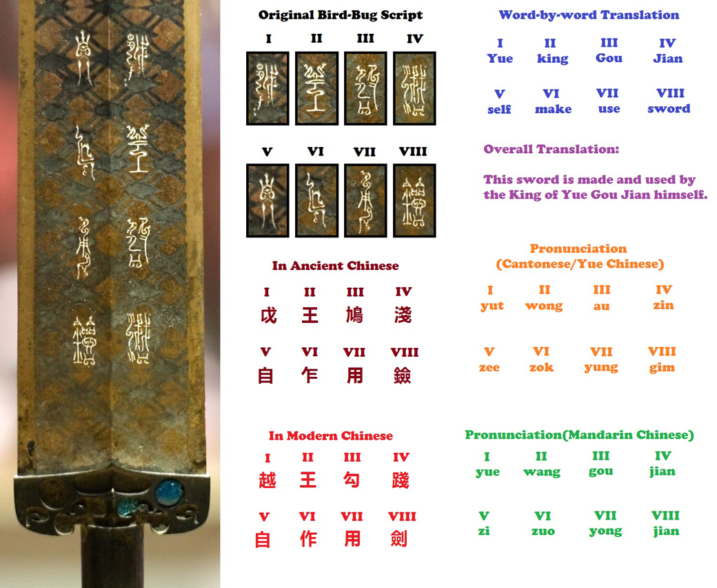

"On one side of the blade, two columns of text are visible. Eight characters are written in an ancient script which was found to be one known as Bird-worm seal script (literally "birds and worms characters" owing to the intricate decorations of the defining strokes), a variant of seal script. Initial analysis of the text deciphered six of the characters, "King of Yue" (越王) and "made this sword for [his] personal use" (自作用剑). The remaining two characters were probably the name of this King of Yue.
From the sword's origin in 510 BC to its demise at the hands of Chu in 334 BC, nine kings ruled Yue, including Goujian, Lu Cheng, Bu Shou, Zhu Gou, and others. The identity of this king sparked debate among archeologists and Chinese language scholars. The discussion was carried out mostly in letters, and it involved famous scholars such as Guo Moruo. After more than two months, the experts started to form a consensus that the original owner of the sword was Goujian, the King of Yue made famous by his perseverance in time of hardship. So the entirety of the text reads "[Belonging to] King Goujian of Yue, made for [his] personal use" (越王勾践 自作用劍)."
