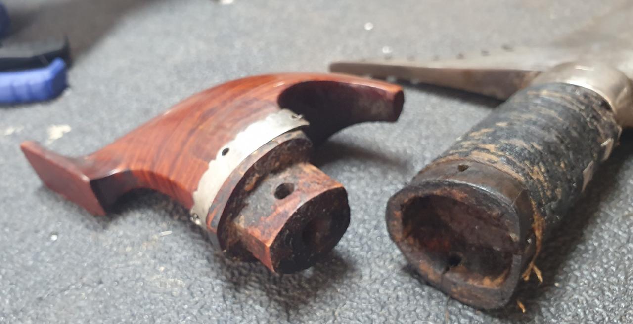

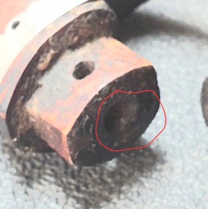

Hello. I am working on an old kris, and find the pommel is attached by pins (old work). Is this common? I am also curious about the divot that has been cut into the plug. Since the plug fits flush, the divot could be there to hold a small object (talisman?).

It could also be to relieve stresses in the wood to lessen cracking as it dries. How deep does it go?

Yes Jeff this is common. Some kris even have pommels that have several holes due to several refittings.

Voids in pommels seem to be reasonably common also.

Are you saying that the pommel was stabilized by a peg on the longitudinal axis at one point in its life?

In my experience...there's usually something like that, yes. Wooden peg, nail... the most unique that I've encountered was a small bone splinter. And it isn't just in Krises, repaired kampilans also have a peg of some sort.

Totally agree with Xasterix.
