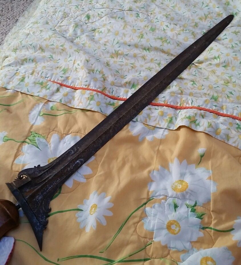

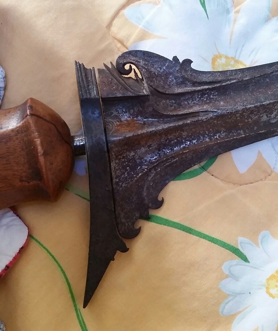

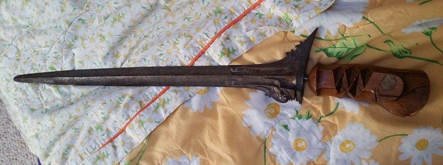

I recently acquired a Balinese keris blade on ebay. It looks old, but due to my inexperience, I am unsure whether it is a recent newly-made piece, or a genuine authentic antique blade. Hence, I enclose pictures of the keris blade for comments.
Can someone advise on its Dhapur and Pakem? I think that the pamor is Ngulit Semangko.

Hello Alexis,
I might change my mind when examining it personally but it sure does look like an antique Bali blade and also the hilt seems to have some age.
AFAIK, there are no published pakem from any of the Bali courts. This blade sports unusual "floral" elements approx. one third along the blade which probably won't fit in any classification, anyway... Please add well-lit close-ups of the upper as well as basal third of the blade for better analysis!
I doubt we can ascertain the pamor yet - the blade is pretty much covered with speckles of more or less inactive rust and needs a gentle but thorough cleaning, careful polish, and stain... Make sure to not utilize any power tools in the process!

Hi Alexis,
I dont know the dhapur, but I sure do know that I like it a lot. It is a very nice keris. Congrats..

Hello Alexish,
I like the blade but in my oppinion it is a very new blade (meaning less than 10 years old).
But I certainly am not very knowlegeable in this field, and I solely base my oppinion on my experience with other types of antique blades.
Marius
