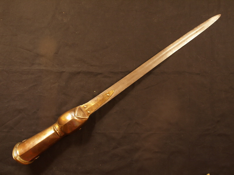

In a concurrent discussion on the 'jamadhar-kitari (katarah) daggers of Hindu Kush, the topic of fragmented European rapier blades used on katars led to a sidebar on rapier blade use in the pata and khanda of the Marathas.
From an apparently incorrect notion I had in place from a now forgotten source, I had the idea that the Marathas disdained the thrust, regarding slashing cuts as de riguer in their swordsmanship.
This led me to believe that post contact use of European rapier blades mounted in Maratha swords such as pata and khanda were more of a status oriented novelty for court type wear. This idea was influenced by the supposed European influence of hilt development from the traditional khanda to the so called 'Hindu basket hilt' from the hilts of European swords.
Since Maratha sword fighting technique was of course not aligned with European fencing, I thought that the use of a thin rapier blade would be unlikely by them. However, I have found examples of both these type swords mounted with rapier blades and clearly intended for thrusting in the manner of a 'tuck' (as described in Pant, 1980) or estoc.
On p.62, Pant describes the pata with a long, flexible 'regularly tapering' straight steel blade, almost always double edged and frequently of European make ...generally Italian or Spanish FLAT RAPIER BLADES.
Here there is some confusion, as often European swords with the heavier arming blades but having hilts as seen on rapier forms are termed 'rapiers' in narratives. In some cases there are blades with ANDREA FERARA inscribed of course spuriously, but these are typically Solingen produced heavier blades of the arming type.
Also in Pant (p.14) he describes the pata , "...sometimes we find NARROW bladed straight rapier with a gauntlet hilt. In this weapon British influence is visible". On p.70 he notes that after the British occupation of India rapiers became popular, and that the rapier blades were fitted to firangi and other Indian swords. In another note he states that 'INDO-BRITISH rapiers of 18th-19th c. have 'long heavy blades'.
So we have here a bit of a conundrum:
Did the Marathas indeed use pata and khanda with NARROW rapier blades in actual battle situations?
Or were the descriptions of Indo British 'rapiers' with arming blades simply termed 'rapier' in the colloquial manner previously noted.
As I mentioned, I have seen examples of the narrow blades mounted on both pata and khanda hilts, but clearly in seemingly considerably less common number.
What are thoughts here on this?

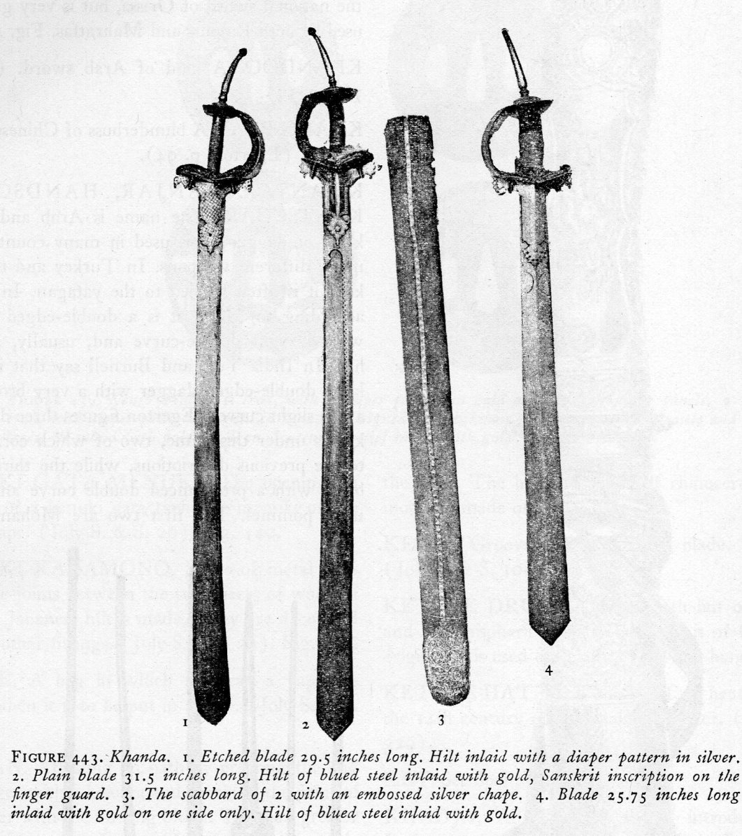

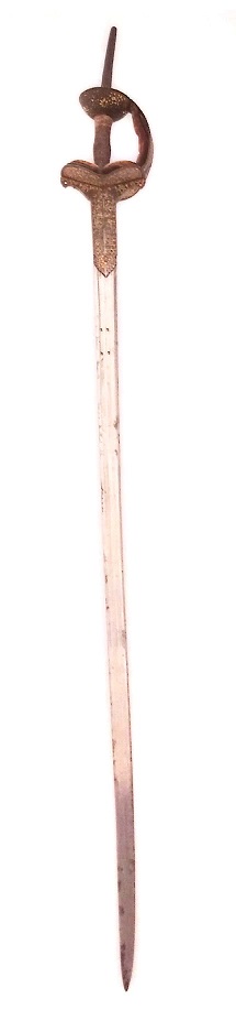

In Pant, there is another plate of khandas (attached here) where the thin rapier blade can be seen.

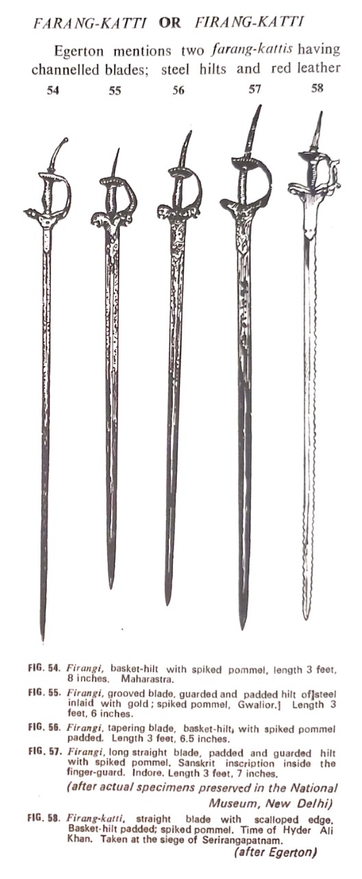

Also from "Arts of the Muslim Knight" (#66) attached is a picture of another khanda (firangi?) which is identified as a sabre(shamshir) ? and as a 'long sword with flexible blade for stabbing and thrusting'. While this is of course a 'basket hilt', it is clearly Mughal, as the inscriptions in koftgari are in naskh.
It would seem that obviously there were occasions for these 'basket hilt' swords, typically with extraordinarily long (over 3 ft. blades to nearly 4ft.) to have thin, flexible, narrow blades as in 'rapier'.

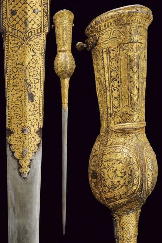

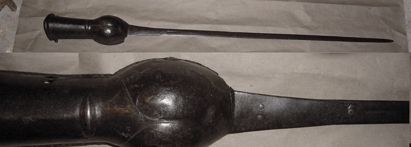

Turning to the pata (gauntlet sword), it is often noted these used from horseback as a lance. Obviously that would seem improbable as the rider would be unhorsed with the weapon lodged in a victim. However, lances were not typically used as impaling weapons, but stabbing, thus the rider does not lose use of the weapon.
It would seem that these narrow blades on khanda or pata, though relatively unusual, would be used in similar fashion, stabbing, not run through thrusting.

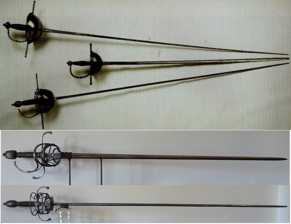

Have you a rapier, or ever had one, Jim ?
This is not the game game; skip over the etymology of the term and just ponder on what a rapier is. Not easy though but then, nothing is exact, and each one is the judge on his own right.
Forget Capoferro, Pallavicini, John Clements and all mediatic Gurus. Paraphrasing Judge Potter Stewart; i don’t know what a rapier is, but i know it when i see it.
Actually as the term rapier became a idolized at its, resistant countries (like Portugal) preferred to keep calling espadas (swords).
The rapier was a civilian sword, although apparently it is recorded that military regiments also used it.
Its blade could (should) be rather thin, even at times extremely thin, some with blunt edges. Some say they should be 2,5 cms. wide, although that is already within the range of a narrow sword blade; 2 cms. maximum being more within typology. But in the opposite, their narrowest section could reach 1 cm. thus touching the estoc range. My school fencing example measures 13 m/m in its widest square cross section. Only two of my eight cup & swept hilt swords are rapiers, for what i consider. Only three or four out of Eduardo Nobre’s collection he considers rapiers, those with blades width + or – 1 cms.
One thing is a narrow blade, another is an extremely narrow one. Same goes for flexibility; true rapiers, to my understanding, could not be extremely flexible, with risk not to do the job, which is perforating; notwithstanding some authors would admit they could also be used in the cutting but then, you are allowed to do what you feel like, and don’t go to jail for that. Same as with the pata; some say it could be used as a lance, but i don’t buy that, thinking is only authors imagination. Pata blades were bought (imported) with an intended flexibility, in order to slash as much as possible in combat; what Caravana calls arm abduction movement and Mundy’s considers them to be able to severe a bull’s neck. Furthermore, while katars could be mounted with European blade fragments (not my term) entire blades for patas were made to perform the intended purpose. But let me not talk about katars in this thread, with risk to be reprimanded for posting off topic material .

Isn't the Firangi a different thing; the Dhup or Sukhella, changing its name to Firangi when with an European imported blade? European but not English, as the Mahrathas were not in favour of their blades. Famous commander Angrey is quoted as saying that English blades were only fit to cut butter.
Tell me i am not wrong, Jim .

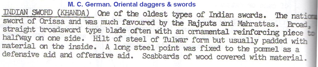

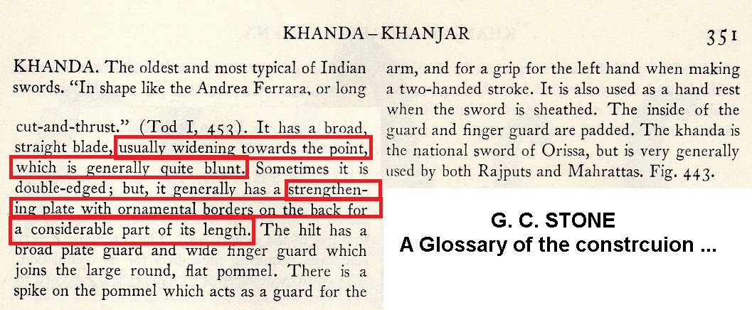

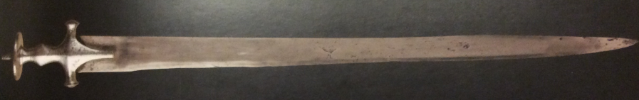

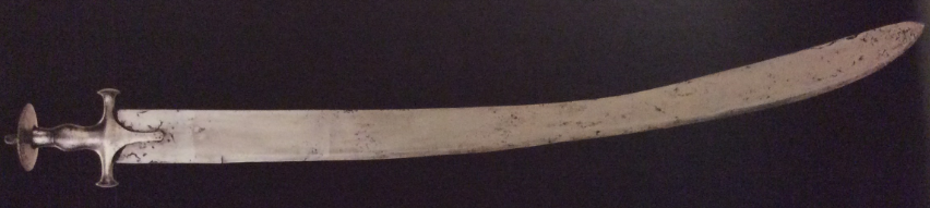

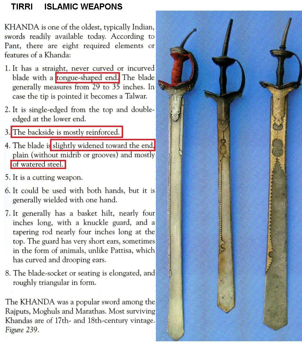

Khanda... What's in the name?
If we adhere to Stone and Rawson, then.. it is straight, has a a basket handle, spatulate tip, edge reinforcements with the resultant one-and-a half edge, etc.
However, here are 3 swords from the Elgood's Jodhpur book: all labeled as Khanda, all with " tulwar" 17 century handles, blades 16-17 century. One is single-edged, another double-edged, and a third one altogether saber-like. Obviously, he got the names from somewhere, and I tend to believe his veracity and judgement.
I was puzzled and asked him for an explanation. His response was that it was all in the local language use.

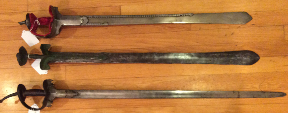

Kind of continuing ( this is more for Fernando).
Three Indian swords of mine.
Top to bottom:
Classical " Stone-Rawson-Pant's" Khanda

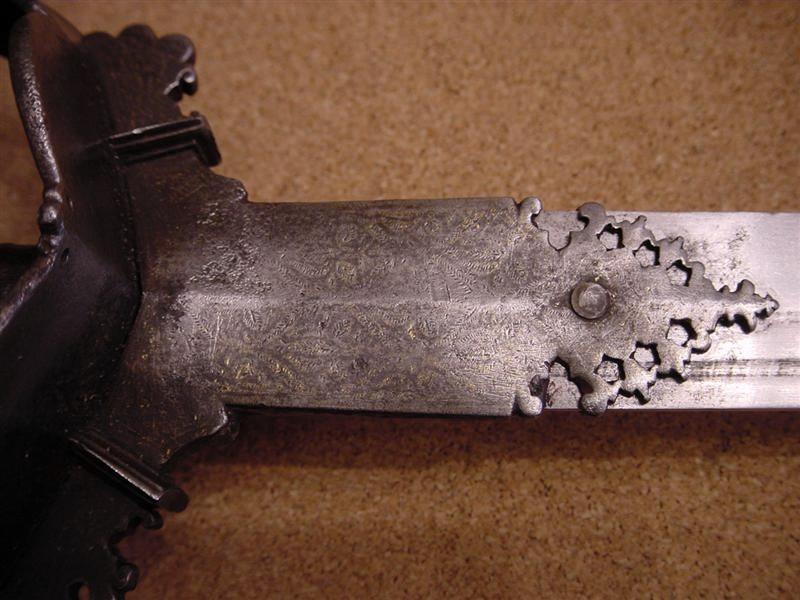

Khanda's old variant ( predecessor?), 18th century the latest, more likely 14-16th: it traditionally goes as Patissa in European sources.
The lowest one is Firangi with a European rapier blade ( see markings). In Deccan it was called Dhup, in Northern India it was Asa Shamshir.
And this opens yet another can of worms: apparently, the word " rapier" was used in Germany, whereas in Italy, Spain and France the very same sword was called spada, espada and epee ( all of which meant simply " sword" in their respective languages).
These cut-and-thrust weapons ( broadswords?) were popular during the late Renaissance times, but in ~ 17-18th centuries got out of fashion and were replaced by a purely thrusting smallsword ( "court sword", "dress sword"),with a needle-like blade based on newer fencing systems. Despite being still called rapiers, they were not suitable for Indian use where a cut was the king. A minor modification of the smallsword's blade gave birth to Colichemard. Having deeply blued, almost black, handle the same smallsword was called in Germany Trauerdegen ( "mourning sword"), which is still in use in Northern Germany during funeral processions.
The bottom line, not only in India, but in Europe as well one encounters same weapon called by different names depending on the language, location, intended function etc.
Likely, the same principle was operating in India with Jamadhar, Katar, Katara, Narsing-Moth and Maustika . Bich'hwa, Baku and Vinchu are established examle. Probably, Chillanum and Jamadhar Katari might have followed the same suit.

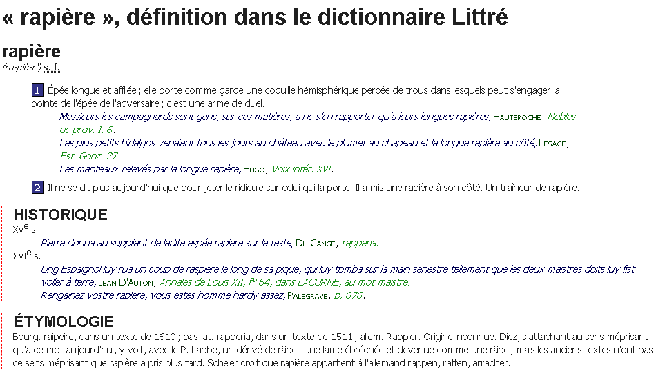

As approached in my post #4, in a simplified manner, calling rapier a "sword" in the different idioms, was a reluctant way from fencing masters, or common man's uncertainty, to not address a weapon with such a 'fashionable' term, considering that its form in particularities was under competition, so to say.
I know your Portuguese is good enough to read that:
" É importante notar que a palavra "rapieira" năo foi usada pelos mestres Portugueses, Italianos, Espanhóis, e Franceses durante o zénite desta arma, os termos spada, espada e épée (ou éspée) eram usados normalmente (palavras genéricas para "espada") ".
To add that, even nowadays, calling a determined sword a rapier, is so often no more than a fancy (read appealing) attribution.

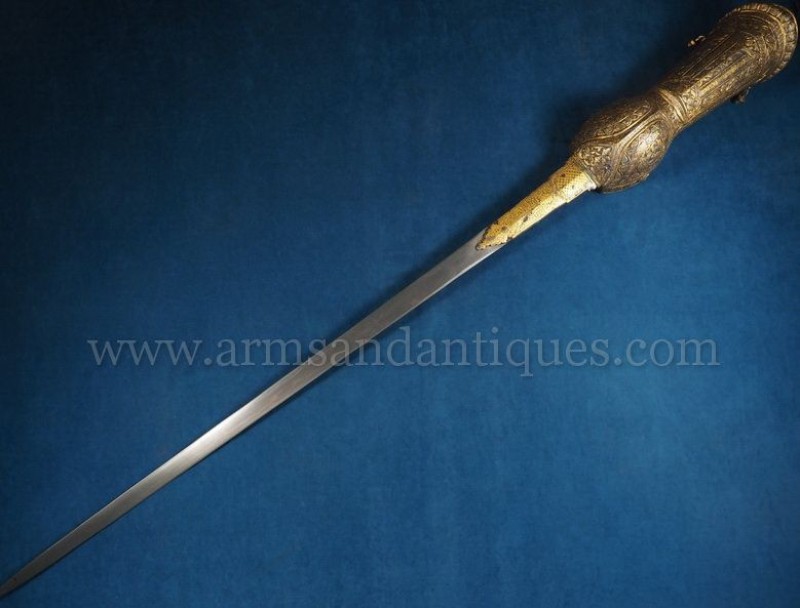

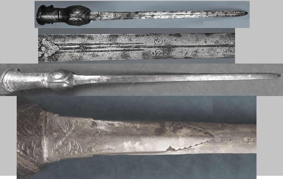

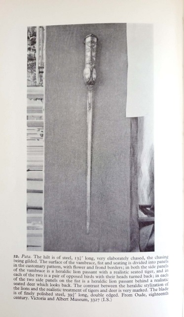

Another reference to the blades in the gauntlet swords (pata) in Pant (op.cit. p.62) notes;
"..the patta has a long flexible, regularly tapering straight steel blade, almost always double edged and frequently of European make- generally Italian or Spanish FLAT RAPIER blades". (caps are mine).
OBSERVATION:

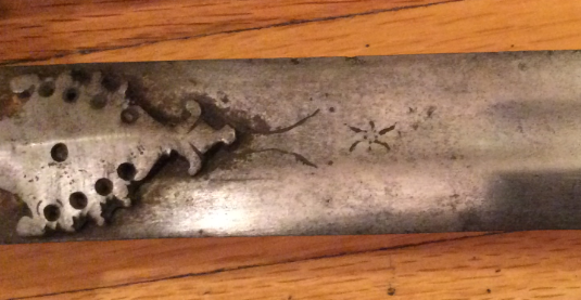

Here, in foot note, it states a pata bearing the sign of Andrea Ferara , the famed 16th century Venetian smith appears, signature forged.
This of course denotes one of the typical 18th century Solingen made blades which were double edged arming or 'broadsword' blades typically seen in Scottish basket hilts.

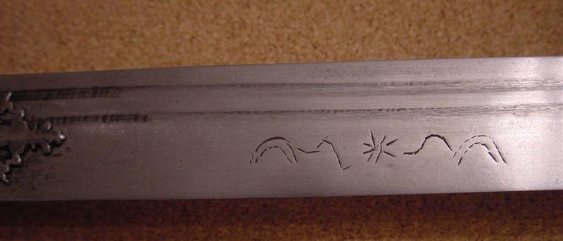

A pata I have has typical Solingen astral figures engraved on the blade, being another of these 18th century blades used on these swords.
The term 'flat' but paired with the word rapier, is exactly what I mean by the misuse of the rapier term. These 'flat' blades were the DE arming blades discussed here, and I would point out that in the 18th c. Spain was NOT producing blades, they were made in Solingen for Spain, and they were NOT rapier blades. The only 'rapier' blades made were narrow and not 'flat' but with distinct section. Italian blades were typically of the schiavona type, not flat but lenticular, and broadsword type (DE).

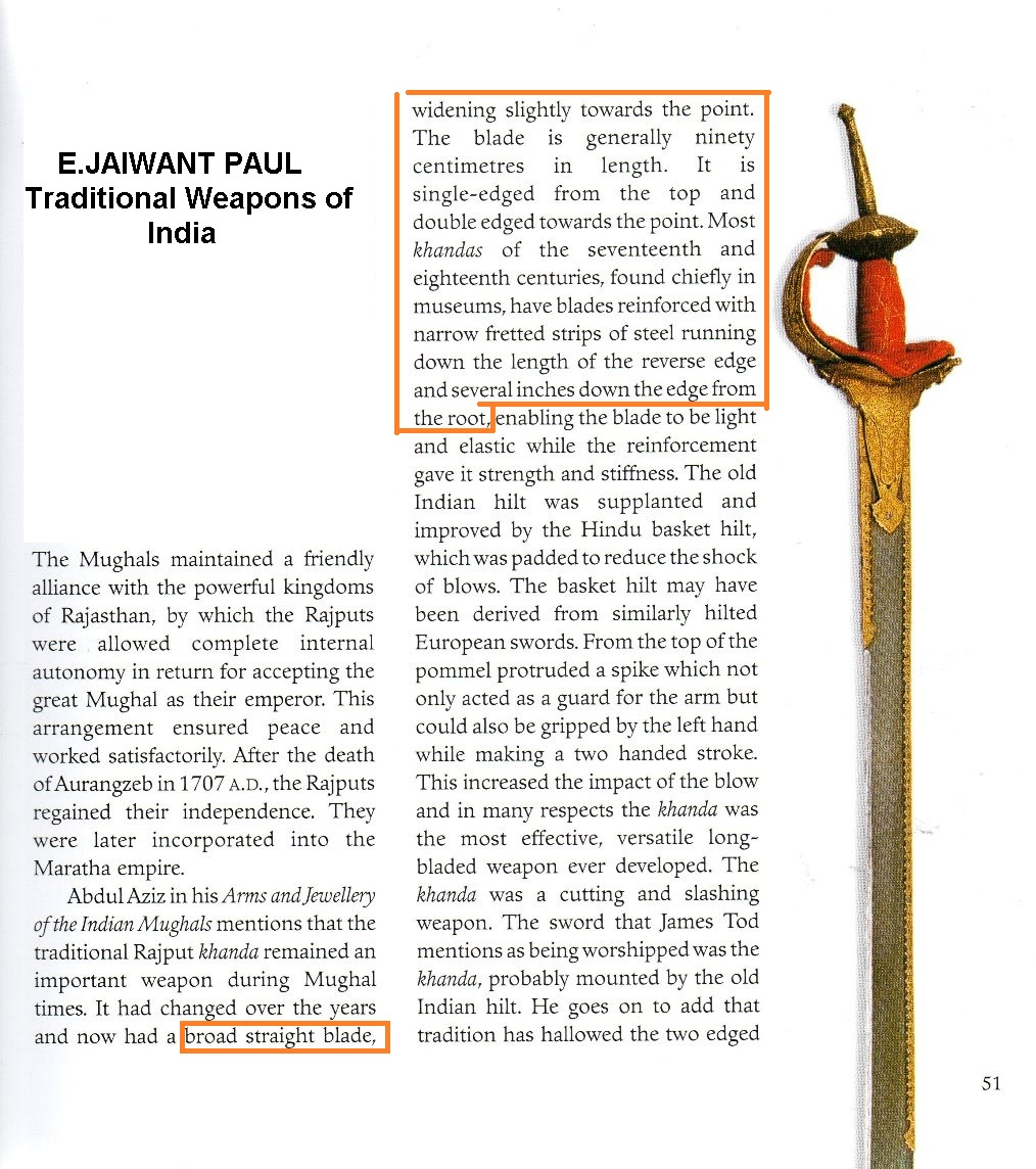

Turning to the khanda:
In Pant (p.183), "...the khanda blade, while remaining true to its form, was made with a longer blade after the arrival of the Europeans in India as can be seen in the illustrations of warriors in the 'Nujum al Ulum' which shows longer and thinner blades in the hands of warriors wearing the tall cap of Vijayanagara. The same thin khanda blade also appears in the 'Hamzanama'.The length and narrowness and SPOON SHAPED tip of the blade makes these easily recognizable.
No doubt this was the counter the extremely long blades (by Indian standards) of the European RAPIERS".

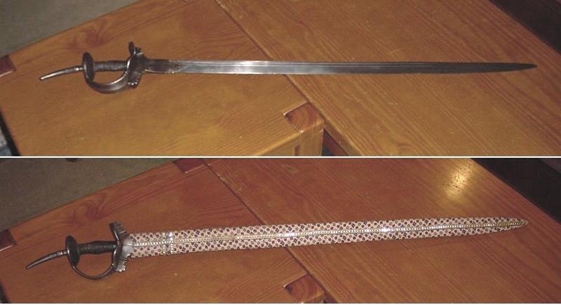

... Therefore I would submit that the narrow rapier type blades used in civilian fencing type swords were not used in swords such as the pata and khanda...
A toast to your candid statement, Jim,
Let's make it an illustrated one ... with images borrowed from my own little collection and Eduardo Nobre's, featuring swords that may be called rapiers, some of them "off mark" (illegally lengthy) and some patas i saved to my disk a while back from this very forum. Different blade typology is visible... at least in these shown

The issue is significantly confused by the fact that we do not know exactly to what kind of sword ( blade) a particular author is referring.
Was he having in mind a late Renaissance cut-and-thrust sword?
Or, the 17-18 century purely thrusting smallsword that continued to be called rapier by some despite the obvious dating and functional difference?
While the former could easily be used as a part of Indian Pata or Firangi, or even Khanda, the latter was totally unsuitable for that purpose.

While the most popular origin of the word “rapier” is traced to the Spanish Espada Ropera ( dress sword), there were opinions that it stemmed from Greek ραπίζειν “ to strike”, or French /English raspiere/ rasper “scraper or poker”.
Language is a powerful tool to confuse us. Not for nothing Divine creation of multiple languages ended human project of building the Tower of Babel and why Americans and Brits are called two nations divided by a common language:-)

I would add to the etymology quiz the suggestion by some dude called Scheler in that, the discussed term comes from the German rappen, raffen = snatch.
But, as in its genesis this sword style had about the same parameters in different nations, and their nationals adopted local idiomatic terms to name the thing, even possibly having given it a different use, evolution then followed its path according to each said nation's needs and imagination; civilian, military, cut thrust, whatever.

As can be seen with the pata illustration, this wider broadsword blade, which is distinctly German in form, but curiously has the three central fullers and the moons (dukari) as placed on Saharan blades. This type blade with three fullers is identical to my pata, but mine has astral sun, moon etc. This shows clearly that numbers of German blades which had been likely destined for North African entrepots, seem to have diverted to the Indian ports in the west.
In Rawson (1969, #22) is a pata in the V&A museum, 18th c. with this type of 'arming' blade. As noted, these became colloquially associated with the late renaissance period thrusting rapiers, where similar hilts were later mounted with militarily feasible heavier blades. (attached image).
In Pant, the plate of khandas I included with five examples (added below)of line drawings, the one on the far left seems to have a thin rapier blade, but this seems an anomaly or perhaps artistic license?
Rawson notes (p.23) that blades were intended primarily to cut, and only the Maratha swords influenced by European examples, which were given reinforced edged and basket hilts, seem ever to have bee conceived as parrying weapons.
While this suggests that European swordsmanship appears to have had distinct influence on the hilt, with addition of finger guard to complete the basket effect....and the bolstered edges which suggest same to receive blows in parrying.....it still does not seem the thrust was used. Again, this would negate the probable use of the narrow rapier blades.

Nihl
Nihl's Avatar
Join Date: Feb 2018
Posts: 90
Hi all,
I think one thing this thread could benefit from is a visual gallery of sorts, like with the pictures that Fernando has already posted. This should help everyone get a better understanding of the swords that we are talking about, as no doubt everyone has a different image of with a specific sword looks like in their mind (I know I personally imagine a swept hilt when thinking of a rapier, but only nebulously imagine the blade as being long, pointy, and thin).
To that extent with a pata I personally have the image of a generic (flat/smooth) gauntlet hilt with a broad blade, as best represented by the first image I've attached below.
To somewhat diverge from my point, I feel like it is necessary to ask: has anyone seen a pata with a definite rapier (super thin & pointy) blade? I feel like the claim that "rapier blades were mounted on patas" can be debunked simply by a lack of physical, documented evidence of the practice. Though of course more swords have been produced in India than have been photographed, it is still valid (I think) to expect at least a couple of these "pata-rapiers" to be documented. More likely I think this is just a case of the previously discussed name-game, with the use of the term "rapier" meant more generically at the time, and only later misinterpreted by us forumites.
As a bit of an exercise, I'd invite everyone to post images of the closest thing to a rapier-bladed pata they can find - whoever finds one mounted with a smallsword blade wins! Of course then there will no doubt be the argument over how thin a blade can be to still be able to cut well in the "Indian style"
Either way, here's my pick (the second & third images) - a pata with a pretty decently thin tapering blade, allegedly native-made from the 17th century.
Nihl is offline   Reply With Quote

Nihl, its nice to have you posting on this, and thank you for observing and reiterating exactly what I had queried in this thread in the beginning.....were there actually these THIN narrow rapier blades ever used in khanda and pata.
One of the problems we had discussed, was the dilemma of the insistence on occasion of earlier writers using the term rapier (which brings to mind the VERY narrow blades used in civilian examples) to describe blades which were actually heavier 'arming ' blades. While I agree the name game is an aggravating nuisance in many cases, when you are relying on unillustrated written sources it can be most misleading.
If you have noted in the ensuing discussion, this very aspect was the source of considerable consternation, and in my post #19, I added illustrations of one pata with what appears a 'heavy rapier' blade (Rawson, 1969. #22) of the 18th c.; and a drawing of a khanda with VERY narrow rapier blade (Pant, 1980, fig. 54) among four others with wider blades.
I think one of the problems with the term rapier may be that as you note, many have an image of a swept HILT...…..actually the rapier term is referring to the blade, the hilts vary. You are right though, more pictures are helpful .
Thank you for noticing my question and appeal for any examples of these NARROW rapier blades. Many of the aspects concerning this dilemma are included in the text of the entries here, but so far without compelling result.

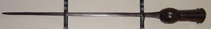

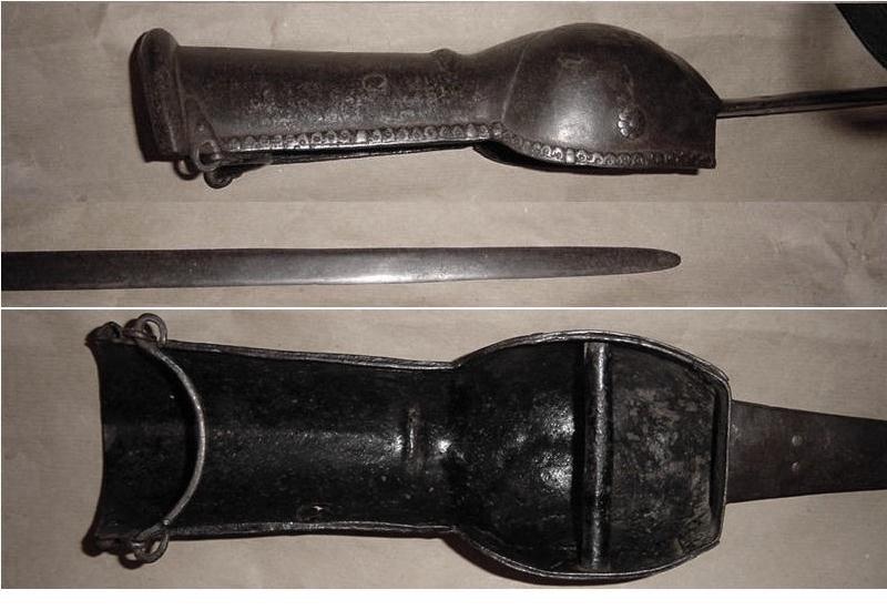

These are the pictures i can recover from the pata i used to have ...
Visibly a field weapon, not one for parade or big shot's show off.
A lenticular blade, not so sharp double edged, one fuller in the first third, slightly tapering towards the end, but not so pointy.
Length 96 cms. width 25 m/m. No marks.
This is to some, what would (could) be called a rapier blade. I will leave it to your discretion.
