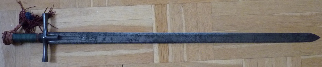

I have purchased my first kaskara. I must admit that my knowlage about these swords is very limited. I am also a little suprised how much sword I actually got for my money. It really quite large (106cm) and heavy.
So I would like to know if anyone could point me towards the age of the sword.
I know these swords kan be anything from 19th century to late 20th century.
Any other information you can share about the sword would also be appreciated. Sorry about the fuzzy picture.

There are others on the forum who know more about these than me, but it looks a good old sword... congratulations. I would say its mid to late 19th century.

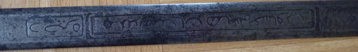

Hopefully someone will be able to translate the inscription, and give you more information.

Good example, its 19th century. The blade is from the Solingen maker Peter Kull and a pattern from the mid 19th century.
Can't help on the inscription but usually these are verses from the Koran.
This a nice example of a typical Solingen export blade, simple but well made that were sent in the thousands to Africa.

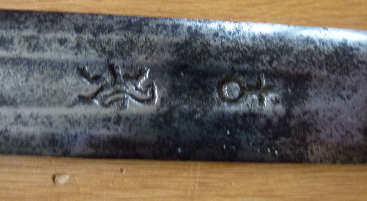

Thank you very much Ian! That is more information than I could have hoped for. I am curious as to how you know that it is a blade from Peter Kull.

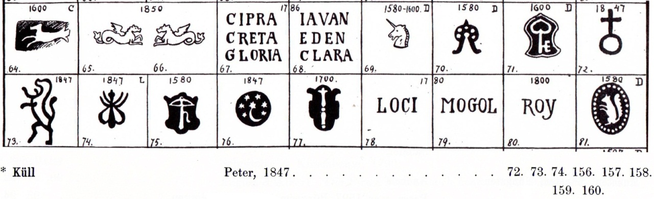

The fly, lion and globus cruciger stamps are a combination known to have been used by Kull and appear in one of the blade mark compendiums. I'll see if I can dig up a scan.
Quite a few blade of this exact pattern can be found in kaskara and more occasionally takouba. Sometimes the stamps were locally filled with copper.

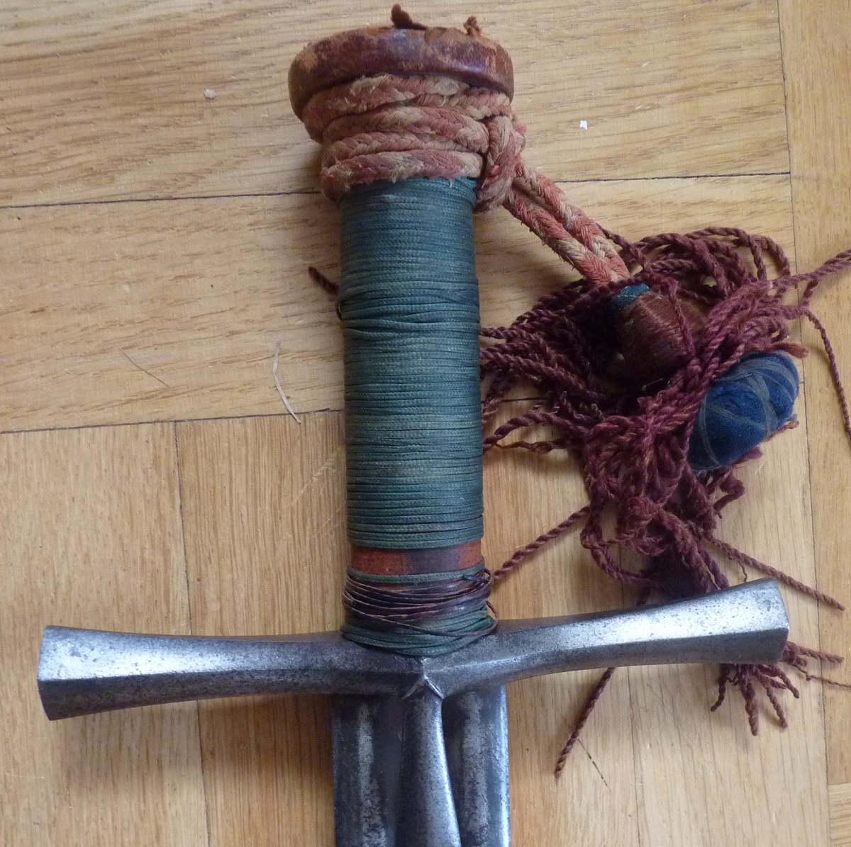

By the way, the cross guard is of the old-time flared type and well made. I hope someone can translate the engraving. It could be a Mahdi Era piece.

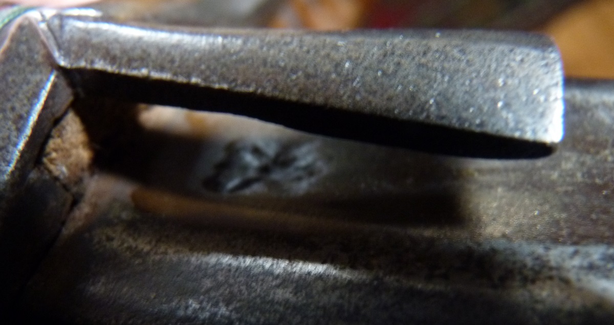

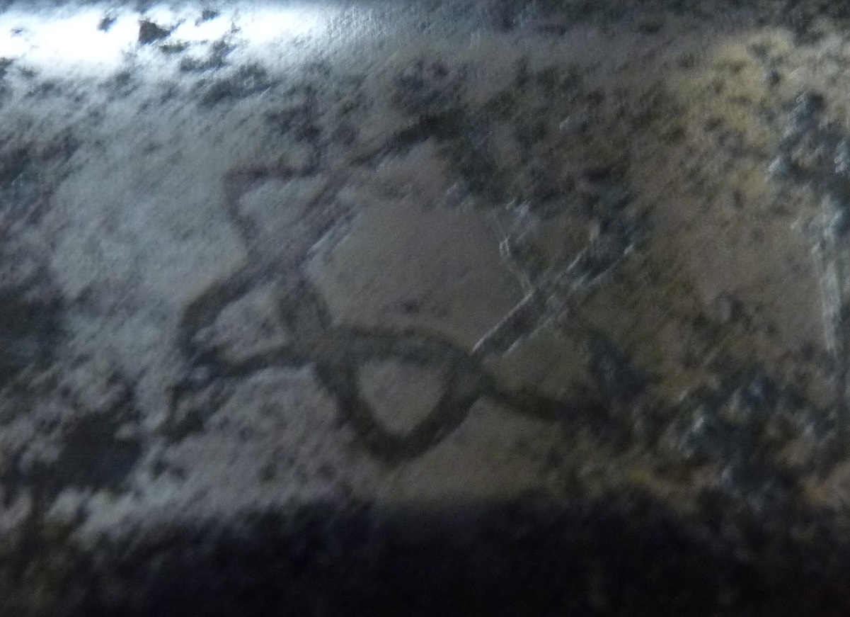

I have some more information. There is actually text on both sides of the blade, I have not noticed before because it is barly visable, it appers to by similar to the one in the earlier photos I posted. There is also a star close to that text that i slightly more visable, I have added a photo of it. There is also a makers mark identical identical to the first one posted on the oposite side under the crossguard, it is a bit higher up then the first.

The star is locally engraved (rather than stamped).
I know its tempting to imagine that due to the somewhat cruder look of this blade its not an industrial product. However even prior to the industriall revolution water powered trip hammers and grinders were the norm for forges in Medieval Italy and Germany. Some are still around, at least in Northern Italy around Belluno. There was no massive effort to refine the lines, fullers etc. on these trade blades, so they do look a bit crude. However, having handled quite a few of the single fuller and triple fuller patterns from the 19th century, the difference in profile to earlier blades from the 18th, 17th is quite pronounced. The 19th century blades, particularly this Kull pattern has a very flat profile with almost no lenticular cross section. Of course when you go further back the 15th and 14th century examples which very, very occasionally crop up (at least in takouba), the difference become even more pronounced.
See the reference below. The three marks in question are noted as 1847 (72, 73, 74). This is not bad as far as kaskara blades go to be honest!
From memory I think Kull may have been listed as a retailer and could well have outsourced production to multiple forges as his name and marks appear on a wide range of blades including military sabres.
