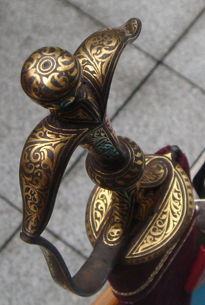

Helly everybody,
I'd like to buy these two chilanums/indian daggers
but a friend told me to be careful : maybe two more replicas
the sellers, specialised in knifes tell me they are authentics no fakes ,
not so old maybe early 20th century.
Not too expensive so...and with indians weapons we have so often replicas with fake damas blade...
the first chilanum told to be with bone hilt + wootz damas blade.
The second authentic too : but the koftgari and the scabbard seems too
recents!!!...
Whath do you think ?
Kind regards

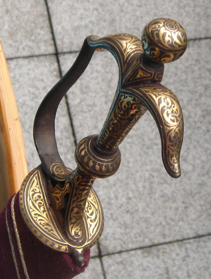

Old 24th April 2017, 06:57 PM   #2
francantolin
Posts: 956
confusion with the pictures:
the second is the first ( & vice-versa !)

Very hard to say from the photos you posted.
The koftgary is definitely recent but the dagger can be older... much older. It is a rather frequent practice to apply koftgari on antique but otherwise mundane knives to make them more saleable. But then again, this looks to be genuine koftgari, and well made. So I don't think being recent makes it less genuine/valuable.
Other than that, the example looks good and made in the traditional way. The chiseld blade is almost unseen in recent production. So I don't think it is a fake. Early 20th century seems plausible to me albeit the blade can be significanly older.
Would definitely like it for my collection.
The recent scabbard has absolutely no relevance for assesing the blade but it is a nice extra.
PS: I managed to download and open the pdf file. Now that appears to be a recent dagger with a pattern welded and NOT WOOTZ blade. So, if the seller lies about this, ho much can you trust the rest? But then maybe I am wrong ...

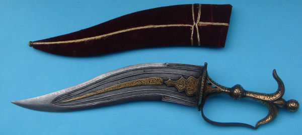

I'll look about what you call ''pattern welded''
here another picture given by the seller of the ''pdf'' dagger- chilanum,
the hilt was complete on this picture but now it's damaged a little, that's why the seller makes a low price.
Do you think it's not a bone hilt ? Maybe Ivory
or plastic ? ? !!!!! ....
Old 24th April 2017, 09:40 PM   #5
Posts: 6,414
If those pictures are all you have to go by; speaking for myself I would pass.
About the broken tip of the knucklebow; I thought those were generally made of steel, in which case it would be quite a hard thing to break.
Is there a return guarantee?
Old 25th April 2017, 12:29 AM   #6
Posts: 4,677
Be cautious here. Can you handle these or are they being sold to you via the pictures? I would not buy them myself if only the pictures are available.
Ian.
Old 25th April 2017, 03:44 AM   #7
mariusgmioc
mariusgmioc's Avatar
Location: Austria
Posts: 1,917
It is as Rick said.
The knucklebow is supposed to serve as a protection for the fingers they are normally made of steel in one piece with th cross-guard and the hilt.
Whether bone or plastic, the second one is fake.

Please do not touch them,they are reproductions from Jodhpur ,Rajasthan
I have seen many appearing in auctions being sold as antiques
best regards
rajesh
Old 26th April 2017, 09:32 AM   #11
motan
Join Date: Apr 2016
Location: Jerusalem
Posts: 274
Default BANDOOK is right
I agree with BANDOOK. Since the typical Jodhpur patterns of folded steel are now recognized by most collectors, "remakes" have become more and more sophisticated. They include many types, like pieces that are made to look old, refitting of real old wootz blades with new hilts and koftgari, cleaning and "redecorating" genuine rusty old pieces and almost every imaginable manipulation. They also appear more and more in secondary markets that are not linked to India directly. Such perfect koftgari on a piece that is supposed to be sveral centuries old should always make you suspicious. Even in the best original pieces, some wear should be visible.

thank you everybody ! Yes this koftgari is too perfect for be true !
Sometimes so difficult to recognize fake from real,
especially for this kind of mixed items : not a ''basic'' indian/chinese replica
not a museum antique piece !
Suspicious too, the price: asking 300$ instead of 900 ...
What will a good copy cost ? 100-200 $ ( nothing ?!! )

Hi francantolin, I am not an expert on these daggers and I didn't mean that they were fake for certain, just that they have some a-typical features that make me doubt their age. There is always a chance that you hit a museum piece for just a fistful of dollars .
Close up picts of the blade could reveal more..
