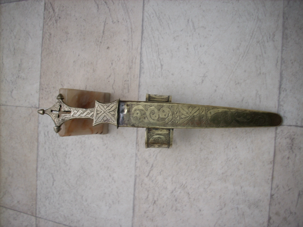

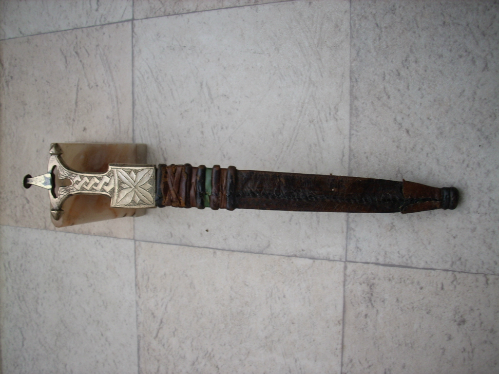

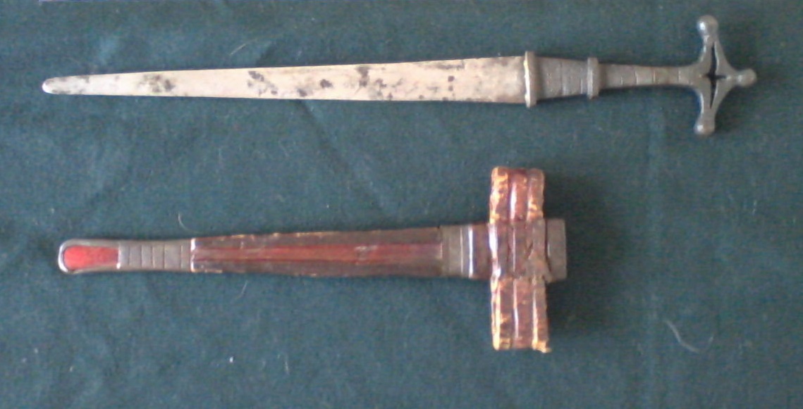

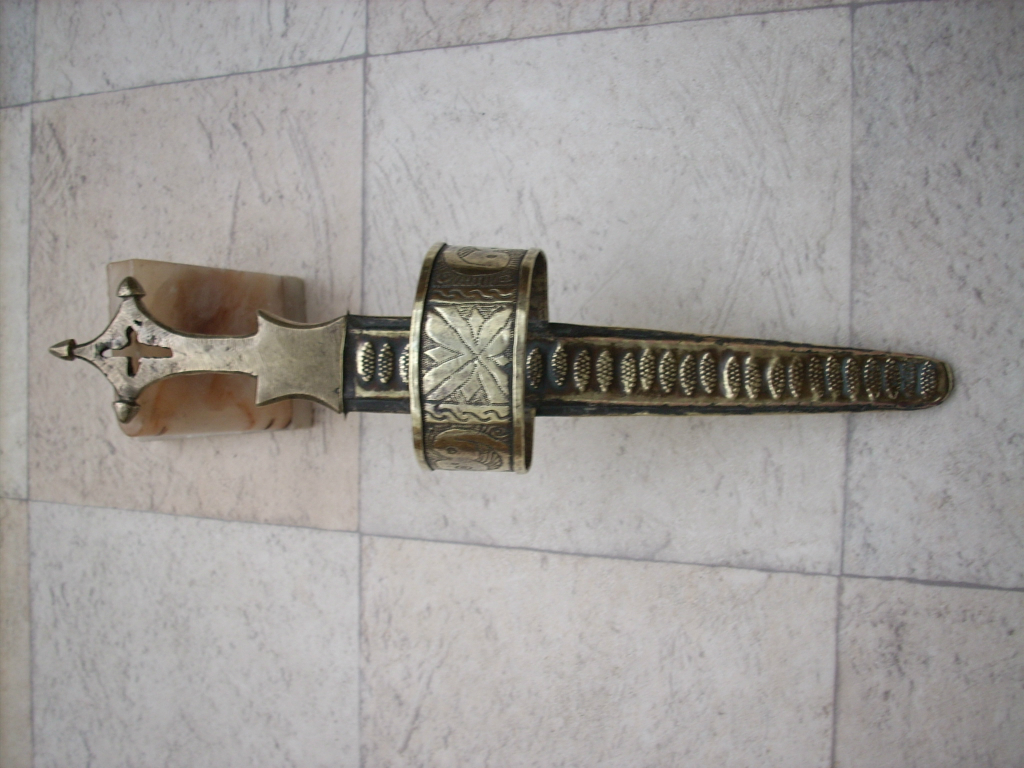

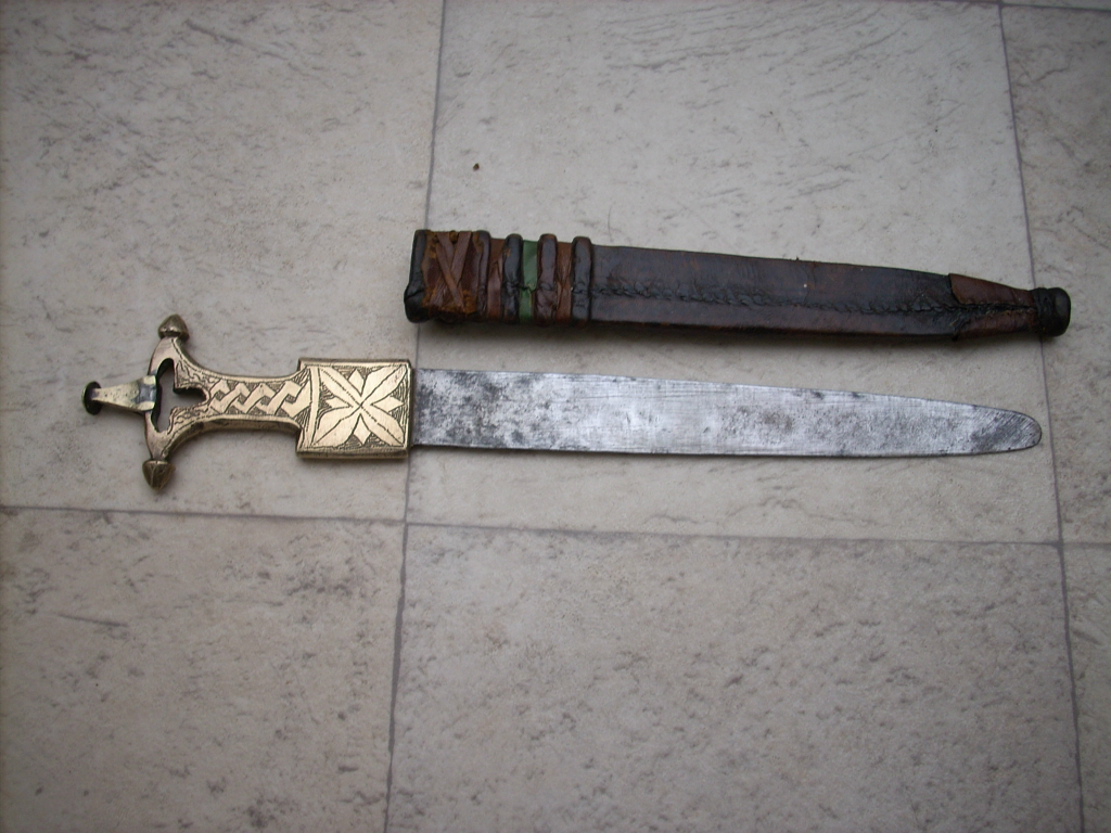

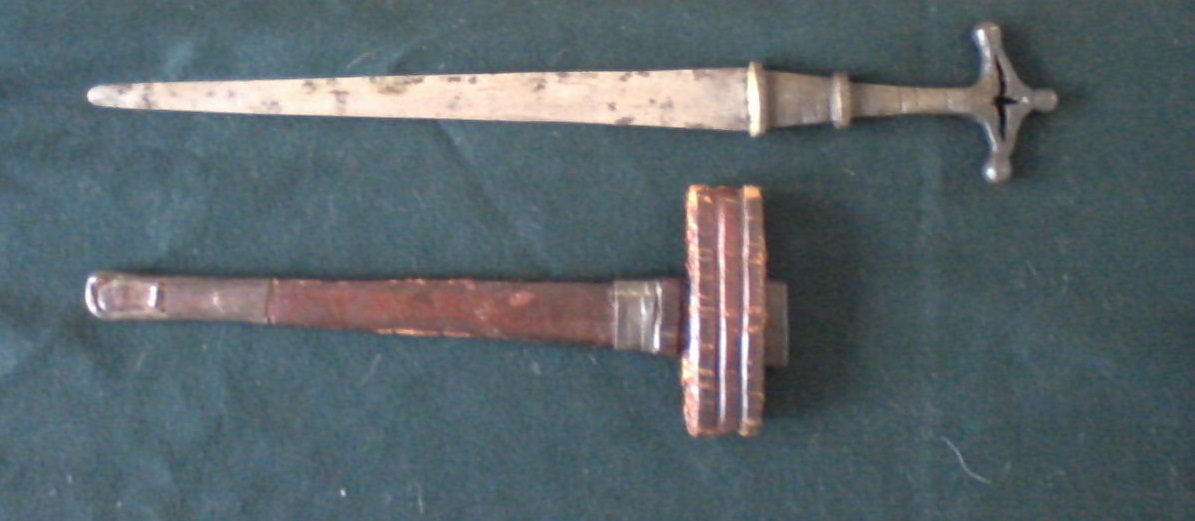

Default Help with 3 'Cross of Agades' daggers

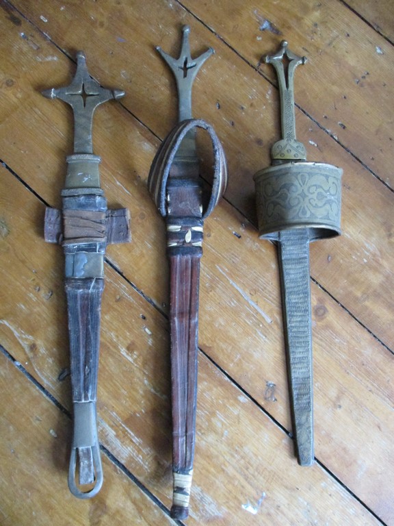

I am trying to sort out my collection and would really appreciate opinions on the ethnological / geographical origins of these three . Most books classify them as Tuareg ... but further perhaps more detailed opinions are sought, thank you.

Excellent approach Redline!
These 'telek' arm daggers are indeed very much Tuareg, but it must be remembered that that classification, as you have observed, is quite broadly applied. The Tuareg confederations of Berbers are dispersed over Saharan regions through Niger, Burkina Faso, Mali, Algeria and Libya and are pastoral nomadic people. They were keenly aligned with trade routes through all these regions, so as you can imagine their material culture was equally well dispersed.
These examples have the familiar Tuareg 'cross of Agadez', which though signifying that key region in Niger, was actually only one of the many variants of Tuareg 'cross' known (There are as many as 22). The actual symbolism is often debated, however it is generally held that the cross in their parlance represented the four cardinal directions, or four corners of the world. Items with this were typically presented to a son by his father in rites of passage, signifying this meaning .
While the telek (an arm dagger worn hilt down on the upper arm) often had these 'crosses', by no means were these the only hilt forms.
As far as regionally, though these crosses are known collectively as 'Agadez' crosses, they are as observed indicative of various regions which seem to have their own favored interpretations. Some of these may be quite subtle, and probably quite often misclassified by observers as the trade factor has dispersed these items considerably.
A great source of data on these kinds of forms etc. in jewelry (which often transmits to weaponry motif) is "Africa Adorned" by Angela Fisher. A well illustrated fascinating book which offers great insight into the style and forms of ethnic peoples in Africa.
The scabbard forms here, as well as the arm loops, offer some potential for perhaps more regional classification, but it will take some research!! We can say these are Tuareg telek (or gozma), and possibly the hilt cross shapes might offer some clue .

Thank you Jim ... many many useful pointers here . As is often the case even with Western 'modern' edged weapons, the metal part ie the knife or sword . lasts indefinitely but its scabbard does not ... and so the owner may need to commission a scabbard locally .... hence I feel that whilst the knife itself tends to be fairly unchanging stylistically , the scabbard in contrast will reflect the local fashion and materials . We see this often for example with the takouba scabbard .

Colin thank you for the input, and its great when we can all get together to compare information and ideas. With me as the novice here, I spent most of yesterday digging through every resource I could find to see if there was any sort of potential for regionally or tribally identifying these Saharan daggers.
It seems Briggs (1965) spent quite a lot of time in Tuareg areas, but was geographically mostly in Algerian regions. In his venerable work, he has used a Northern and Southern demarcation for tribal forms of takouba, which, for me at least has proven challenging. It seems hard to apply this to confederations of nomadic people typically moving about over five countries and vast areas of Saharan desert.
One thing I did discover is that the 'Agadez cross' as seen on the left and right examples in the original three posted here, is indeed that known as 'Agadez', but it is one of 21 cross forms, each attributed to other primary Tuareg locations. I found that Agadez (in Niger) was a kind of key point or center in a sense, and for example, the green leather used in scabbards was apparently produced there, and traded for use through Tuareg networks.
The Agadez cross seems prevalent symbolically on many of these daggers as well as on the Tuareg camel saddles.
The other forms of cross seem to be used primarily on jewellery, and not as I presumed in other hilts, though the center dagger here seems to be a variation of the Agadez with arms splayed upward.
Trying to find consistancies in the elements of these daggers, in comparison to other examples I found, it seems that splayed arm configuration may be most aligned with 'Northern' types, from Algerian regions into the Fezzan regions of Libya. I would say this categoric area must include northern Niger as well.
It seems clear that the 'arm daggers' are but one prevalent form of Tuareg daggers, and that that characteristic feature seems to predominate in those areas. The other type, more of a belt dagger resides congruently but more in other areas perhaps .
Turning to scabbards, while we agree these must be a secondary classification feature, one thing I notice is the distinctive open loop on the tip of the scabbard. These seem to prevail on Hausa or Nupe weapons in the same 'corridor' from N. Nigeria into Algeria and Libya.
It is tempting to think that the 'arm ring' form of telek is situated more to Algerian, Libyan, and Niger regions as the same feature is well known on much smaller daggers worn in the same manner as Sudan. This is of course by free association and realizing such arbitrary assumption is easily defeated, however worthy of note.
Naturally most of what I am observing is from research hoping to learn more on these Tuareg daggers, and I look forward to your thoughts as well of course as hoping for Iain to join in. Its fascinating to learn more on weapons I have known little on, and I appreciate the knowledge you guys openly share here.

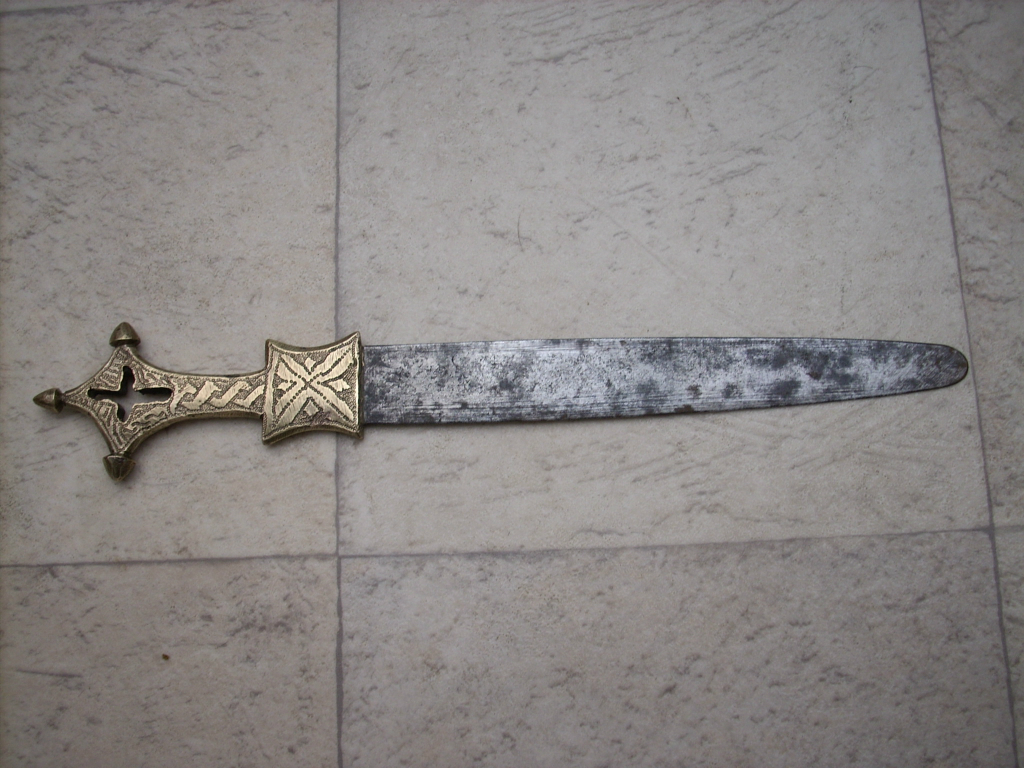

Originally Posted by Miguel
Thank you thinreadline for this thread and thanks to the participants for sharing their knowledge which has made it so interesting. It never ceases to amaze me the wealth of knowledge available and freely given on this forum.
I was given, many years ago, a couple of knives similar to the ones in your thread and have long considered them to be for the tourist trade (mine I mean) due to the shortness of the hilts in comparison to yours and any others I have seen when trying to find a match with mine. The shortness and angularity of my hilts uncomfortable in the hand and I cannot see that any self respecting Tuareg would give them tent room. Having said that I would like to know if my consideration is correct or not.
Miguel
Well Miguel there are others better qualified than I to answer your question . However one possibility is that they are daggers made for children ... I have seen scaled down Kaskaras which were described as such . If these were European weapons they might even have been described as salesmen's samples ... though I doubt this is the case here. I rather like them however !

Iain has tenaciously shown these methods in the remarkable research he has completed on Sahelian and North African edged weapons in general. His years of research focused not just on the weapons, but those peoples who used them. With these studies have not only advanced our knowledge of these weapons, but proven that the study of ethnographic weapons is a viable factor in anthropological and historic disciplines. Most importantly not just learning about the weapons, but their history THROUGH them.
Very kind Jim but outside of the takouba my knowledge if frightfully lacking!
Regarding the example posted by Miguel I think this is a more recent work, I would guess from modern day Nigeria. It could well be simply a show piece to be worn at events like a durbar and thus not requiring any particular practicality in terms of handle size, but more of a fashionable accoutrement as part of tradition costume. Or it could be as suggest for a child, or simply an example of local brass work intended as a souvenir.
I certainly didn't mean to discourage attempts to arrive at a classification or attribution, we can certainly recognize elements that point to a place of manufacture and in some cases the last user with leather-work etc. providing valuable clues. While I doubt, due to the nature of these weapons and their role in society, we will ever arrive at something as precise as the tribal attributions possible for example with Congolese arms, there is always more to learn and puzzle out!
Thank you thinreadline, I think children`s daggers could well be a valid possibility and one that I had not considered.
Miguel
Thank you Iain for your above comments, they make perfect sense, much obliged.
Miguel

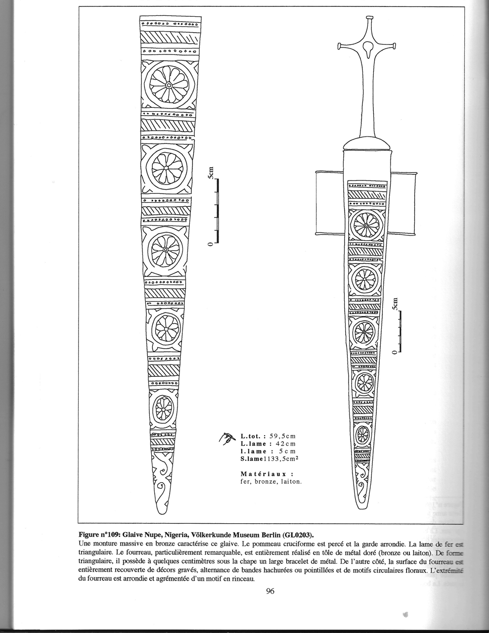

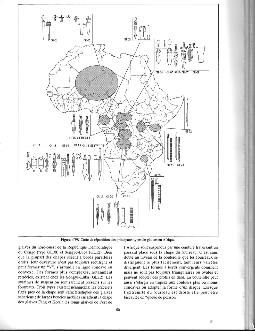

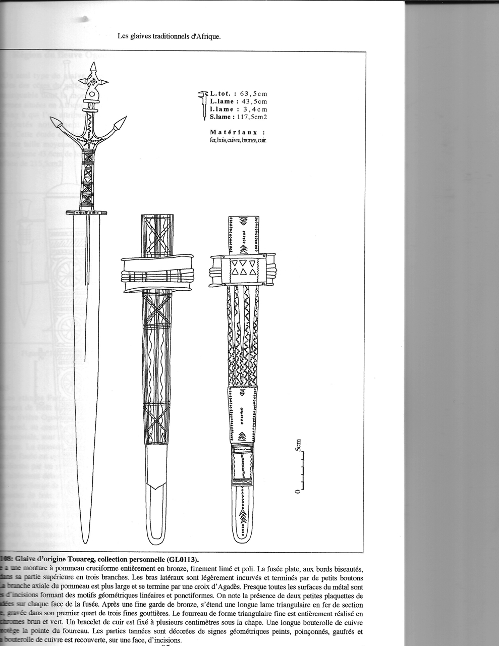

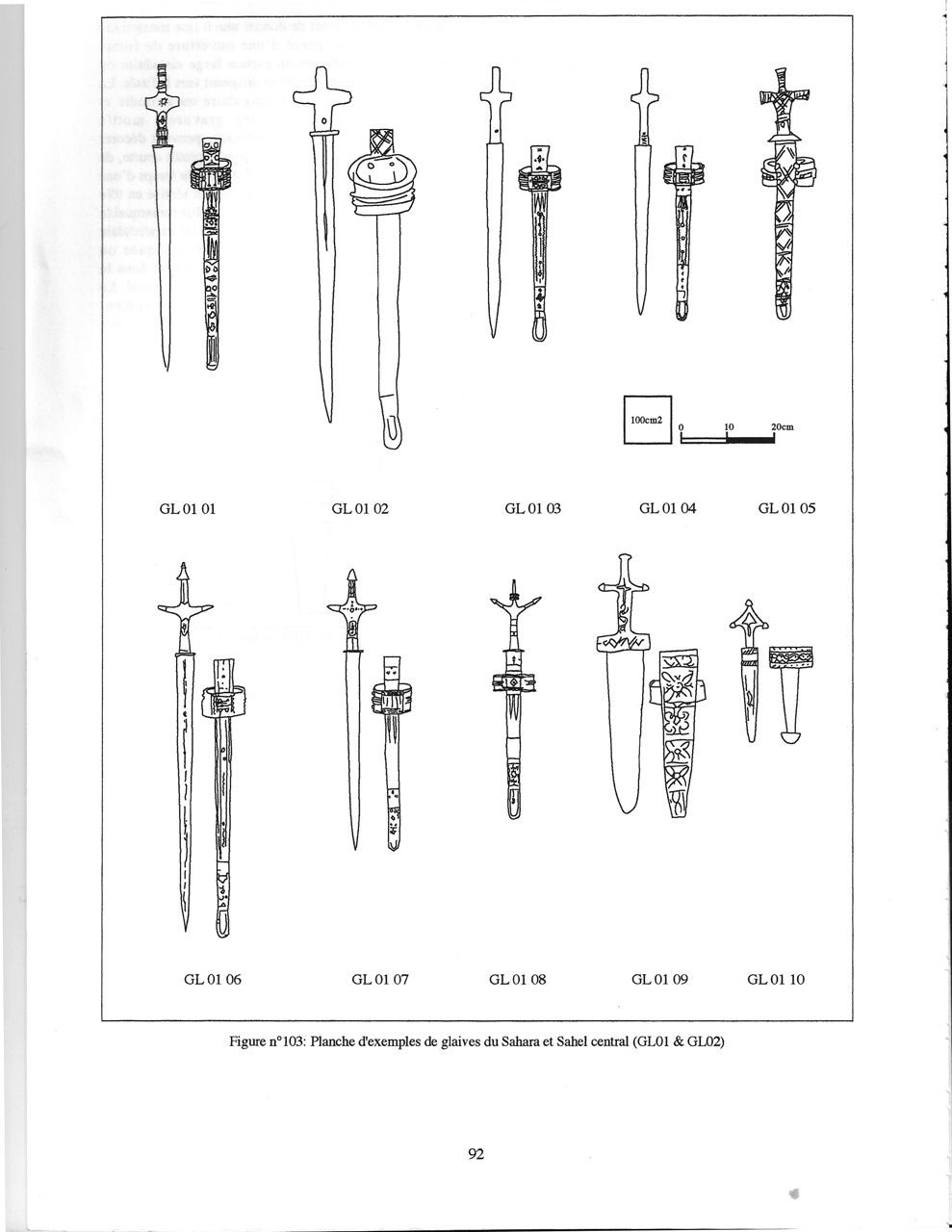

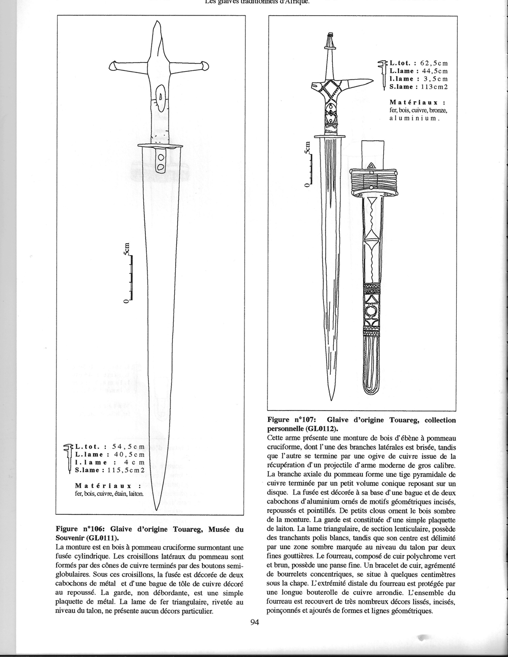

Some more information but all in French; Armes traditionnelles d'Afrique (agues, poignards, glaives, epees, tranches et couplets) Approche regionale et classification technique, morphologique et esthétique. Tristan Arbousse Bastide BAR International Series 1098. 2003
only trouble is I have the first page last.
Old 14th April 2017, 07:45 PM   #27
Miguel
Join Date: Jun 2015
Posts: 584
Thank you Tim for this information, my hilts are very much like GL 01 10 now just have to translate the text
Miguel

Very useful Tim , thank you . Now to brush up my schoolboy French of 50 years ago !

There is a dagger very similar to that on the left of the image from thinreadline, in the book "Weapons and Implements of Savage Races" by Montague 1921. He ascribes it to Bornu, which was inhabited by the Kanuri people ?
