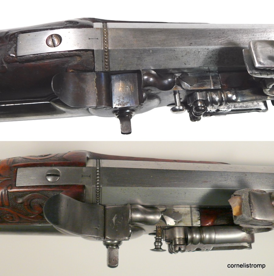

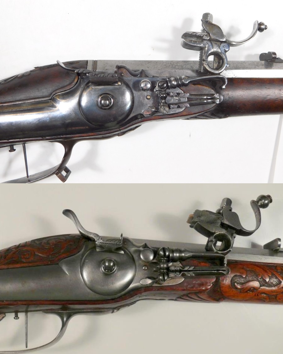

I read an excellent thread from a few years back started by member Cornelistromp showing his excellent example of a wheellock sporting rifle attributed to Johann Michael Maucher, last quarter of 17thC.
See thread: http://www.vikingsword.com/vb/showthread.php?p=85109

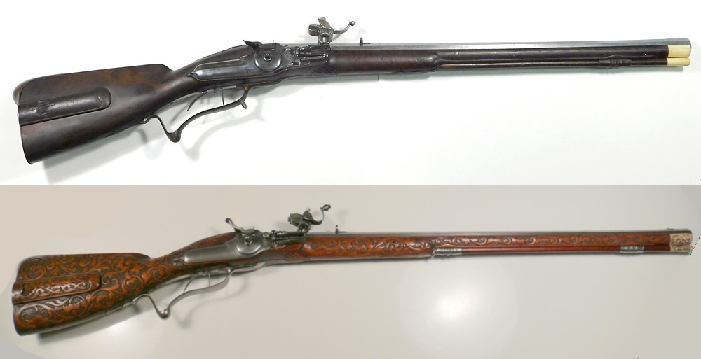

I have one as well. Mine must be an economy version for the woodwork and Ivory/bone engraving is much more simple in nature.

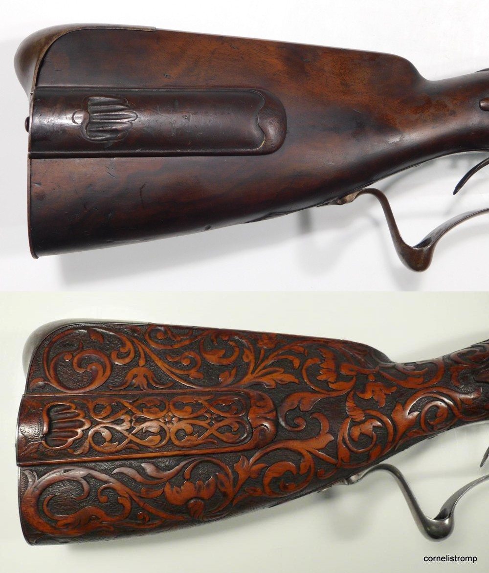

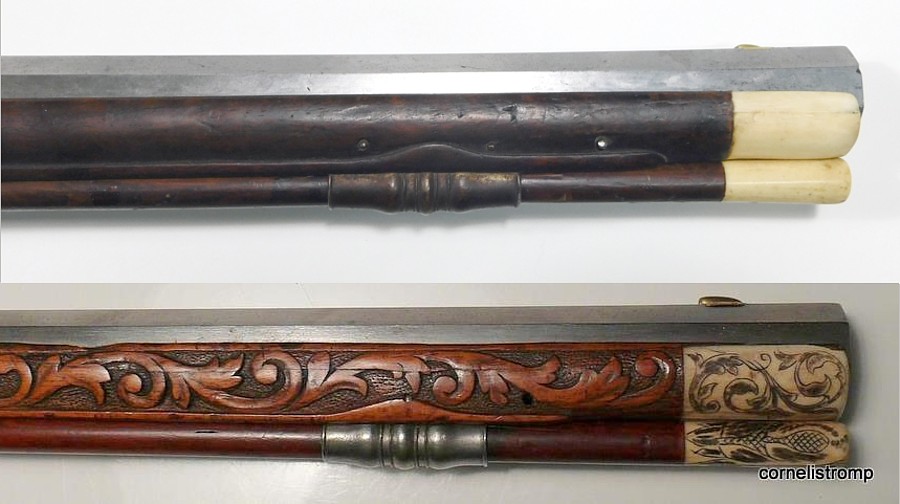

I have attached some photos showing comparisons between the two. I hope Cornelistromp will not mind my using his photos for this comparison.
You can see by the details that the two rifles could have been produced at the same time or within the same month. Heck, they could have been on Mauchers workbench or in his shop at the same time some 300 years ago. I think it's fascinating. I thought you might as well.

Very interesting rifle you have, and no, it is not an "economy" grade.
It was made in the Brandenburg area, sometimes called the Brandenburg school, or sometimes "Prussian" school of gunmaking.
It is beautifully made, and actually much more what we would expect from that area in decoration. Jasper's rifle is a Very uncommon piece for this area!
Frederick Wilhelm 1, and later his son, Frederick the great, were rather austere gentlemen, rather frowning on over elaborate decoration in or on anything. Very much plain and simple types.
This spilled over into guns made in that area, and this is why Jaspers is so unusual, and yours is not.
Certain features always ("Always" is a very dangerous word!!) show up in Brandenburg arms, are the bellied stock rounded on the underside, the type of guard as is on yours, 9 times out of ten, High quality craftsmanship but not elaborate, and simple understated stock carving.
Yours ticks all the boxes.

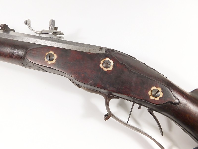

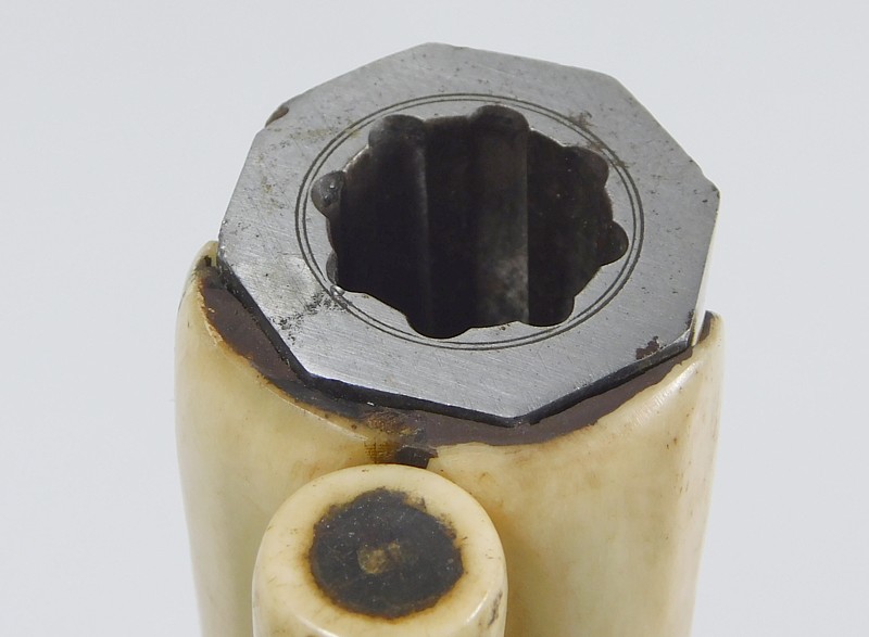

Can you show us the sideplate area, opposite the lock, and a view of the muzzle?

I have attached photos of the plate opposite the lock as well as the muzzle.

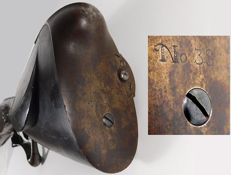

Also; interestingly the butt plate has an engraved serial number. I'm not sure if that would indicate (as modern serial numbers do) that there are at least 37 others produced in the identical manner? or could it indicate this is the 38th rifle which this particular gun-maker made.

Even the three ivory flower escutcheons around the sidenails are Identical to those seen on some Brandenburg guns, as is the muzzle cap and shape of the buttplate.
