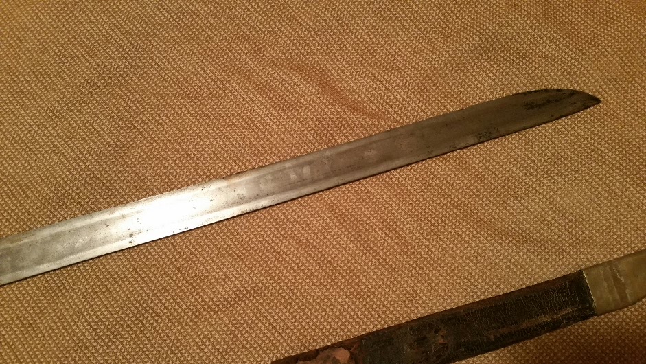

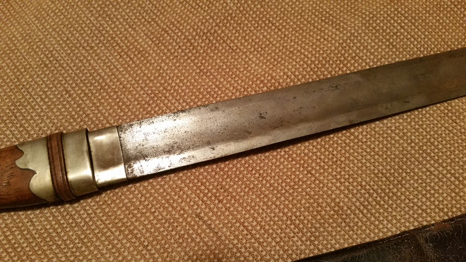

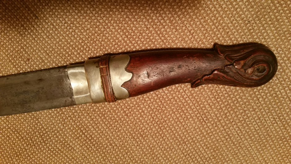

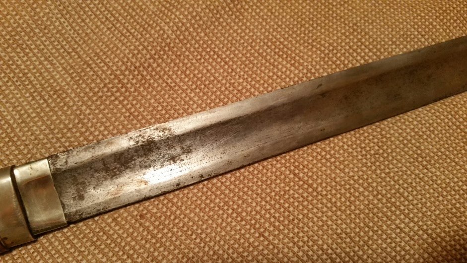

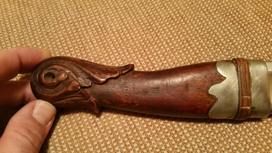

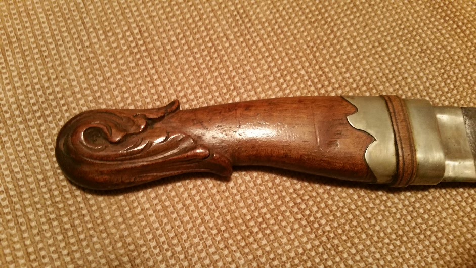

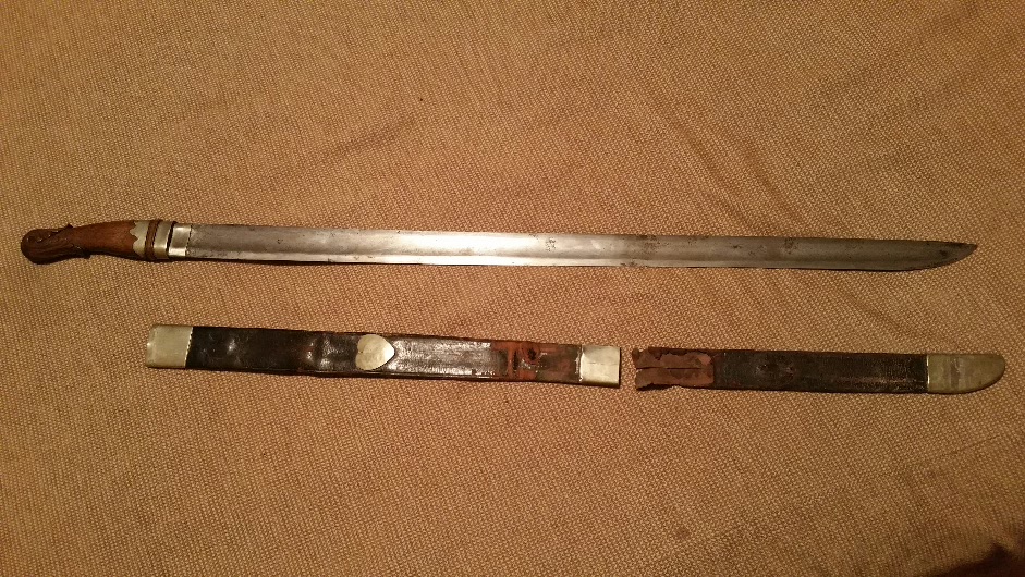

This is my last adquisition, I,m not sure if is a machete or a modified Sword. Total length 40 in.
Handle is wood and silver.

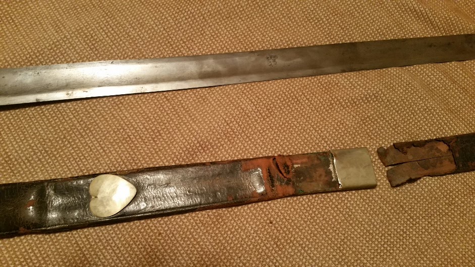

The blade has some engravings but is very difficult see them. The sheath is broken, with silver parts.
Thanks in advance.
Any information will be good.
Best regards
Carlos

It is a sword because its shape would make it very ineffective at cutting any type pf vegetation.
The blade looks like an European cavalry blade... I guess.

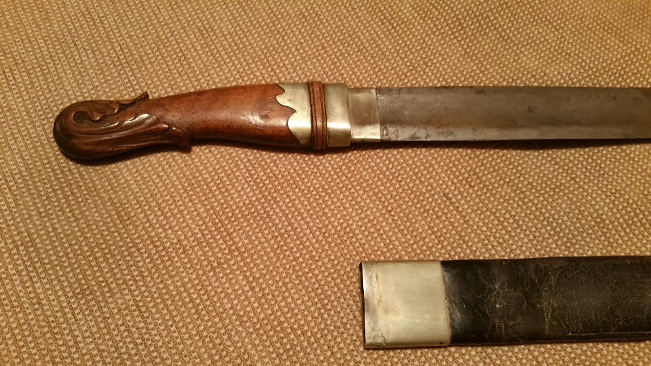

Hello Carlos,
very interesting sword, I like it. Handle carving look very Asian, the handle mounts from white metal (you are sure it's silver?) and the "habaki" look similar to Tonkin sabre mounts, agree that the blade is most probable a European military blade. Scabbard is a puzzle to me.

Most interesting native repurposing of a what appears to be a British M1796 Heavy Cavalry sword blade (the engravings suggest possibly an officers), but these type blades were on the swords used by British in Napoleonic campaigns.
While I cannot be sure of the style of the hilt etc. it seems more Asian or Philippines. The scabbard is stylized after military type scabbards of officers swords of the period, but the original scabbard to this type blade was iron.
This would be entirely to long and awkward in my view as a machete, so what the purpose of this would be is anyones guess.

Pretty sure this is one of the rarest cases of a British M1796 Heavy cavalry blade being remounted........with habaki!!! very very unusual!

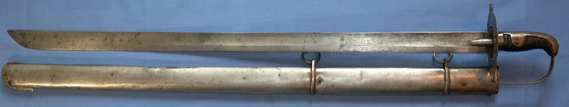

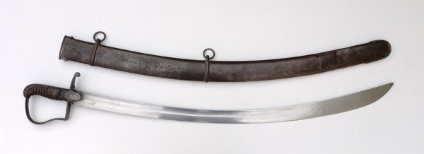

the 1796 LC sabre was curved with a hatchet point and simple stirrup guard
the 1796 HC 'sabre' (or sword) was straight with a hatchet point and a flat perforated discoid guard...many were modified before waterloo to 'spear point' the blades. removed from service in 1861.
i think the differences between the terms 'sabre' an d 'sword' were a bit blurry. troopers carried sabres, officers carried swords, even if both looked exactly alike (except for possible decoration on the officer's). the 1796 HC officer's private purchase swords were frequently decorated with scrollwork. the troopers issued ones were not. collectors tend to lock in terms that may or may not have been the same during the active service life of our weapons. makes for interesting arguments here on the forum

The 1796 patterns (first 'official' British cavalry pattern) were for light and heavy, as were the next in 1821 (actually 1829).....in 1853 the sword was for both light and heavy. The 1796 'honeysuckle' hilt for heavy cavalry officers was an amazing hilt, and had the same blade as the troopers.
The term sabre was often used broadly for both straight and curved blades for cavalry in the 18th century, the same as broadsword was used for both double edged and single edged (backsword).
These heavy straight blades like the 1796 were usually called 'pallasche' on the Continent.
They think the 'name game' is restricted to ethnographic forms only? NOT.
These variances have present the opportunity for many , uh, 'discussions/debates' around here through the years.
Absolutely right on the modification to spear point on these 'heavies' just prior to Waterloo was reflective of the constant debate over cut vs. thrust for cavalry. These heavy cavalry swords were not popular with the cavalry as they were heavy, awkward chopping swords, but were devastating in the immortal charge of the "Scots Grey's" that day .
