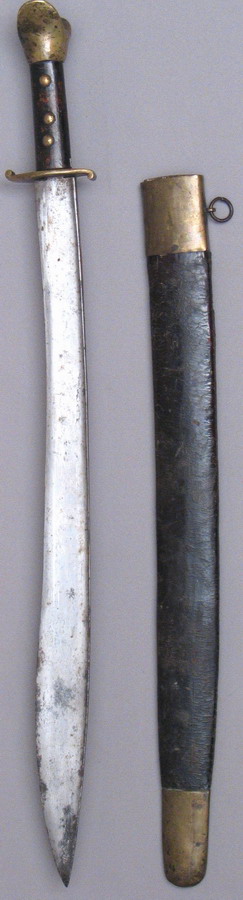

Question Army yatagan?
Hello. Does anyone have idea what it is? Could it be an army model? There is no marks or inscriptions on it.
I will be grateful for any informations.

Just a guess: Austro-Hungarian Yataghan issued to the Balkan troops.

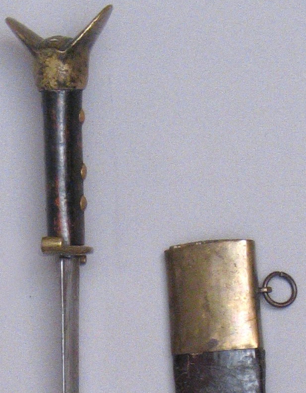

My first association this weapon was also with some Balkan troops, but the complete shortage of markings seems to be strange. If it was an army model, it should has markings. On the other hand, it's a really solid, strong construction, with no decorations or ornamentations, with a crossguard, and the with the scabbard just like for military cutlass... It seems this construction has been carefully thought over, just like army type models. I’ve been trying to find something similar to compare it to, but haven’t had any luck so far.

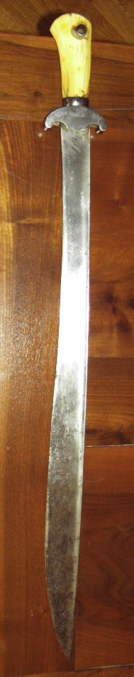

Here is a similar knife (photos from Oriental Arms)
n2s

There is a verry similar example in Tirris book. According to him it is an Armenian piece from the early 19th century

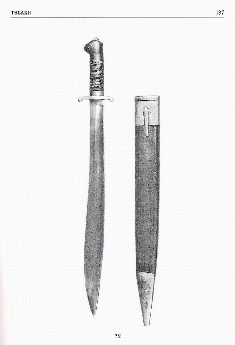

I was browsing "Russian Edged Weapons" by Kulinski and I found a similarity between the weapon, which started the thread and a Russian M 1810 hanger,m issued to the lower ranks of the naval artillery. The hilt and scabbard mounts are different, but there was quite a variety within Russian patterns at that time, and Kulinski wrote his book based on the available samples in the Military History Museum of Artillery, Engineer Troops, and Signal Troops. But before we jump to any conclusion, here are the stats from the book:
OAL length: 685 mm
Blade length: 535 mm
If the size of the hanger in question is indeed close to these measurements (I feel too lazy to convert them to inches right now), then it is very likely a Russian M 1810 hanger. Quite a find.
