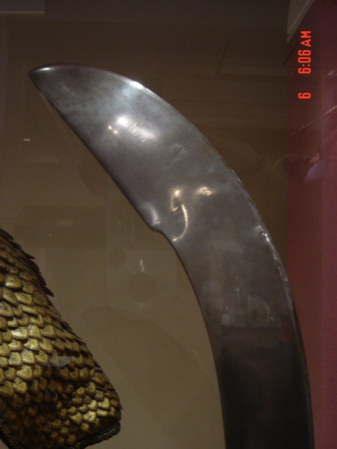

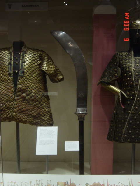

here is a true Indian Executioner sword from Leeds Armoury ( I was the photographer, and Richard Avedon I am emphatically not!)
Look at the length of the handle permitting two-hand grip in a multitude of positions, smooth blade without any T-spine, and economical design: short and heavy blade.
