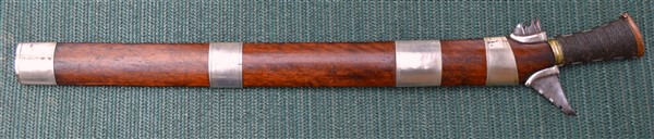

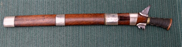

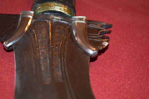

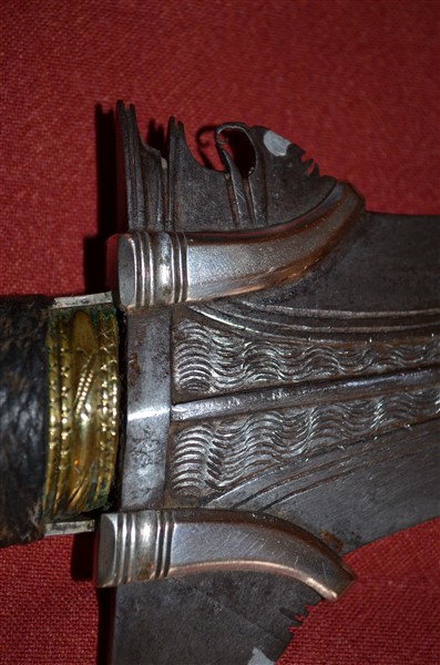

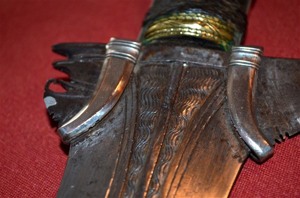

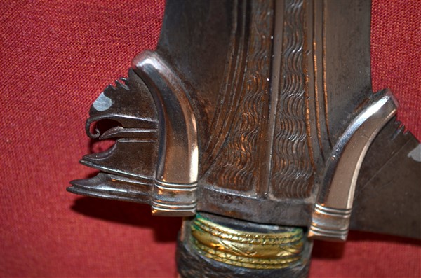

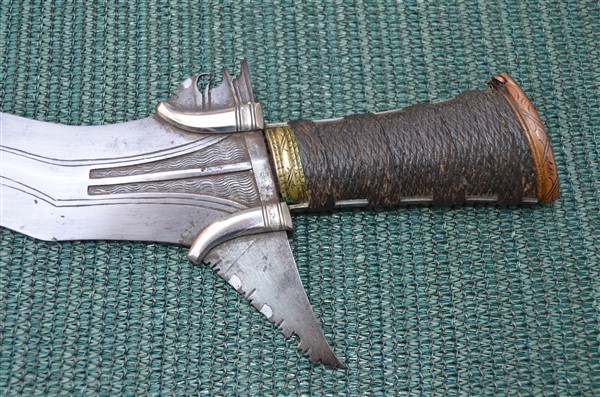

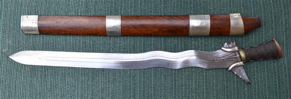

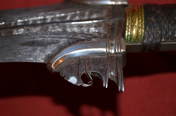

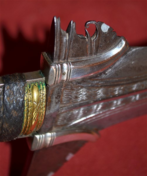

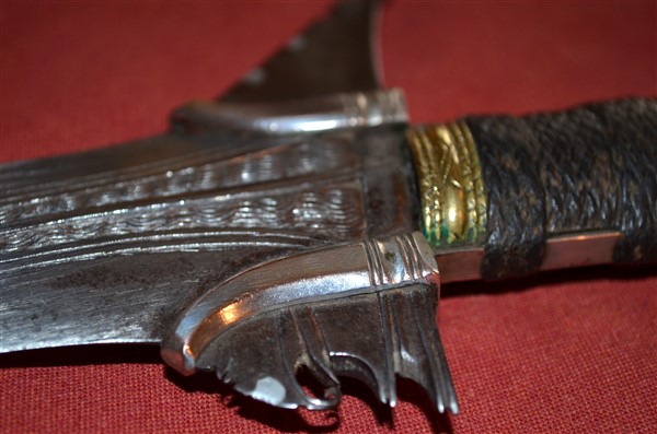

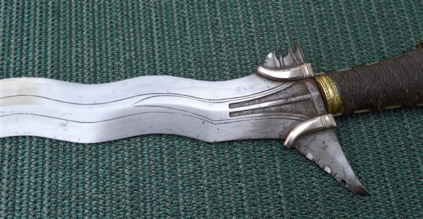

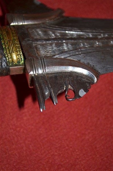

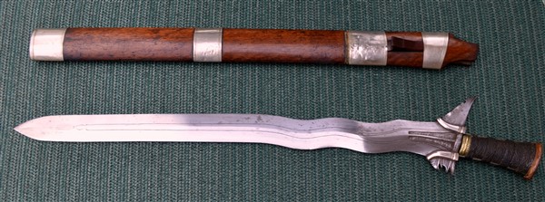

I just acquired this sundang which I believe to be from 1900 to 1945, probably closer to 1900 ; what I found interesting was that the aring(forgive me if I have mislabeled this part), was filled with a metal that looks like silver.I have seen the blades of other weapons with metal inserts, but this is the first time in my limited experience that I have seen the guard of a sundang filled.

Nice example. Congratulations!
This is a Maguindanao kris that I would place a little after 1900. You may want to etch the blade to see if it is mono-steel or laminated.
The copper top on the hilt may have been once covered by a thin sheet of gold to match the ferrule.

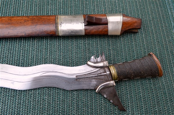

drac2K:

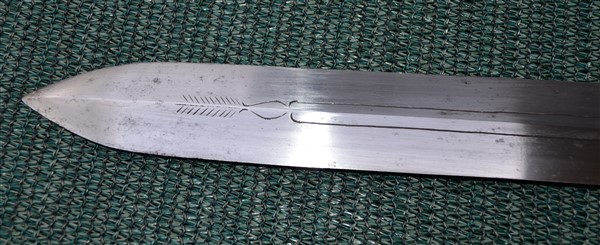

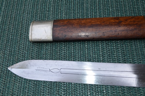

Nice Maguindanao kris. Like Battara, I would place this one later in the 20th C. for several reasons: the sharply pointed, spear tip to the blade; the absence of a separate gangya (an inscribed line has replaced where it would normally be separated); and the general appearance of the sword which looks in mint condition with very crisp incised decorations and pristine hilt. My guess would be closer to mid-20th C., although the scabbard may be a little older.

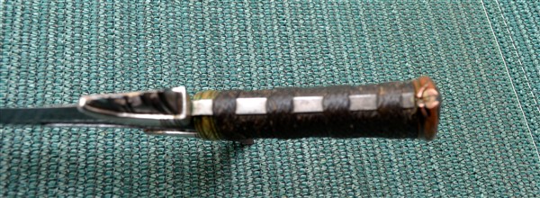

Thanks Gentlemen.I am pretty sure that the gangya is separate(maybe wishful thinking).I'll try to get better pictures.I agree that there once was a cap on the end of the pommel.

Thanks Detlef , any clue why they filled the spaces in the guard ?

Could be talismanic, but just a guess........

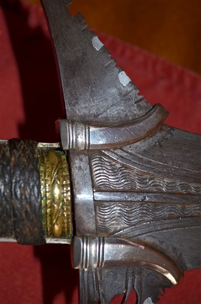

Only way to know for sure is to take the hilt off and see if the gangya is separate. Right now I don't see any clear evidence of separation--the visible line is very straight and shows no edge corrosion or oxidation to suggest a point of separation that has been present for a hundred years or so. I've tried to take similar looking ones apart before, only to discover the gangya was not separate.
If this is a hundred year old sword, it is in a remarkable state of preservation.

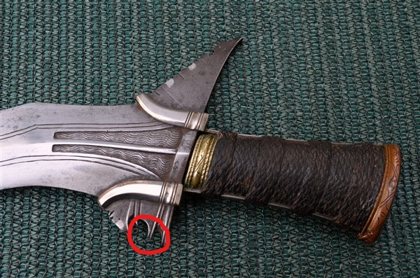

... another way to find out if the gangya is separated is to see if the encircled part of the kris provided are attached or not

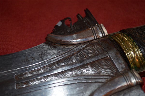

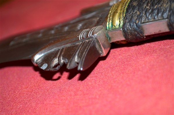

Maybe these additional pictures will help to determine if the gangya is separate.

I have had 3 similar Maguindanao kris (one stolen, one sold off) and the construction was nearly identical, and all 3 had separate gangas. I think this one is also.
Old 5th March 2017, 02:48 AM   #13
Posts: 7,218
Looks separate to me, just in case anyone is in the market for 2 cents.

I have seen holes on the ganya filled in.
Usually holes are filled in with precious metals. More prevalent in the holes near the tip of the Kampilan blades. Could be that, the area in your blade was filled in lieu of the missing holes.
According to Cato, some components (stirrups, bands, etc..), of the Moro swords are used as commodity to pay a debt or to purchase things. A sword is a safe place to keep something of value, the owner always know where his sword is. Then owner could just knock out a small piece of silver when needed.
