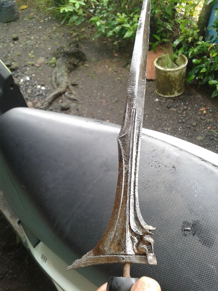

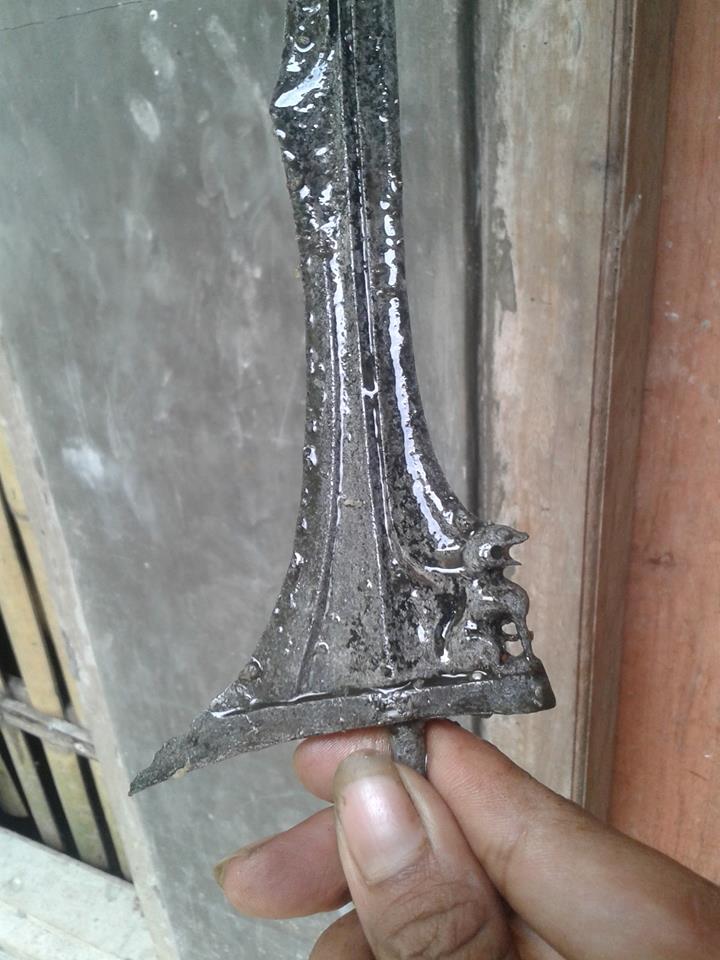

it was offered to me but went above my budget, so I asked permission to the owner to post pictures here here as educational and discussion tool
I personally never seen this dhapur in real life keris form ...
considering the condition, the blade is somewhat old
opinions are welcome
enjoy !!

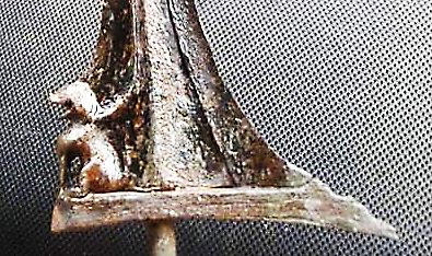

more as difficult to say something by the pictures regarding if it's an old or recent blade. What I can say that it isn't a masterwork of art, I see irregularities but maybe I can be cheated by my eyes. This would speak against a recent blade. Any change to see this blade fresh stained? Or without oil?

The greneng totally eroded : the singo barong still retaining a perfect profile, and most importantly, his manhood.
A truly wonderful keris --- in the literal meaning of the word.

I am nearly sure that we see here a reworked old blade, the singa is added newly, that's the reason that the greneng is worn like this but the contours of the singa are so sharp and the penis still so large. Also the typical Sineba bulge seems not correct to my eyes, the form is not typical IMVHO. But frankly said I've handled only very few Sineba blades so it's just my impression.

Detlef, this explanation is a very possible one indeed and perhaps more likely than a new blade that has been aged, given what we can see in these photographs. But from the quality of the images to the massive amount of oil on the blade it is not very easy to tell one way or another if this is an altered old blade, but it is certainly one way that this creation may have come into being.

It is hard to determine much from the photos but on Donny's 3rd image (side on, greneng to the left) I wonder whether I might be seeing a weld line from above the Singo's head to a point just in front of the pesi

What is happening with Fido's foot?
Perhaps there is just the smallest possibility that this entire object has been built around a genuinely old gonjo?
Look at the grain in the metal, and the surface texture : compare the gonjo with the wilah.
It is always very difficult to appraise any keris from a photo, and where an educated seller has an intention to deceive, it is almost always impossible to know what one is looking at in an online image.
But we can guess.
