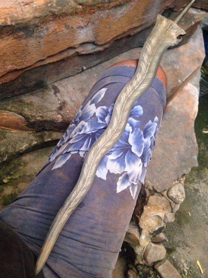

for the beginning I want to ask the opinion of the members here of prestige in this keris. Thanks before

thanks have been received in this forum, this is a kris kris new artificial ground work of empu/panre in Sulawesi, and glad to meet you here sir david

Yes La Pagaru, it looks like contemporary work. Would love to see more of the blade for a better sense of the over all garap.

I don't know much about Indonesian Kerises, but I certainly like the pamor of this one and would love to see the whole blade!

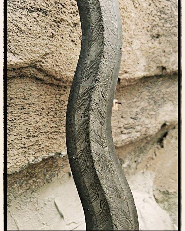

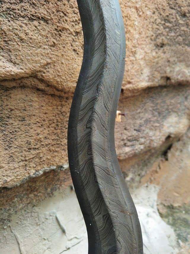

There is no keris upon which to pass comment, there is only a short section of very badly executed pattern welding.

Hi Alan. Hopefully we will see more of this keris eventually as additional photos have been requested more than once, but in the meantime, perhaps you could expand upon your comment on bad execution for some of our members with less experience than you in the actual mechanics of the process. It is always best to display the entire blade along with detail shots when presenting a keris for discussion, but since La Pagura did specifically ask for opinions on the pamor (google translated that word as "prestige") what makes this pamor execution bad and why?
Old 3rd February 2017, 09:55 PM   #8
Posts: 7,228
The pamor has been made by taking two twisted rods and welding them together.
The weld that joins the two rods should be tight and not display any gap.
Look closely at the joint between the two separate pieces of twisted material from which the pamor has been made.
There is a particular technique that is used to achieve a tight, clean joint with the technology available to smiths in Indonesia. The maker of this keris has not yet mastered this technique. I am not at liberty to explain this technique.

I suspect that the garap of this keris will be pretty acceptable, but the forge work is not yet good enough.

Well, even for less experienced members like me it is clear that the welding line between the two bars has been blurred (it doesn't run with Ada-Ada), the frequency of Pamor motif (correspondence between bars) also runs wrong.
Old 3rd February 2017, 10:42 PM   #10
Posts: 7,228
I'd be prepared to accept the way in which the lines of pamor are aligned as OK, not good, not a master's work, but acceptable.
The fact that the weld joint does not run with the odo-odo is something that is less than good, but a less than expert smith can still be capable of technically proficient work.
The thing I cannot regard as acceptable is the poor weld joint running between the two pieces of twisted pamor. This joint is not technically proficient.

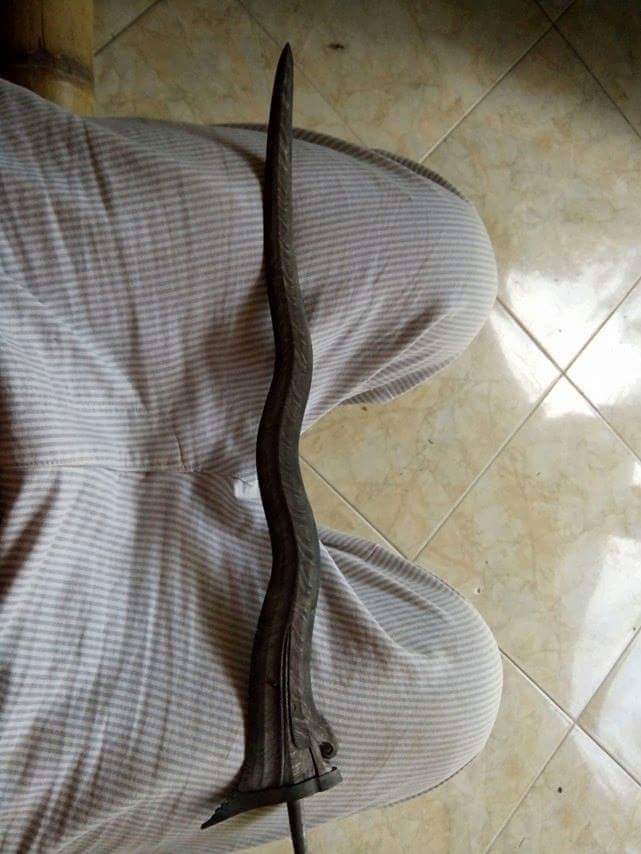

Default On proses
Keris on proses
La Pagaru is offline   Reply With Quote

I hope you look at the making of this keris in the corner of reviews ethnic Bugis, because this is not a keris Javanese, Bugis kris kris is that we make in accordance with patrem and in accordance with the instructions set forth in the records of our ancestors left behind. You will be amazed at what Bugis masters could do, and maybe you can find my name in the book heirloom weapons Bugis Ubbe abe work and friends,

at the time of the unprocessed
