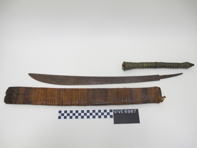

I have no knowledge about which Montagnard/Degar tribes inhabited Phuoc Long province at that time, nor who could identify any distinguishing features of tribal or regional identification on this sword. Heck, I don't even know how to tell if this is a Thai knockoff or something. Can anybody help me contact an expert or locate a useful source, that is unless anyone knows off the top of their head what it is? I got a ton of photographs, so I'll start with the overall picture and let you guys tell me which parts you want close-ups on.

Thank you for bringing this interesting sword to our attention. The blade and hilt of the sword suggest that it is from N. Thailand/Laos. The scabbard is rather nondescript, but also consistent with that general area. It is a cut above the usual village quality Montagnard swords which have, as Ariel noted, a hilt to blade length ratio of about 1:1 and a blade terminus that widens but is less rounded than this example.

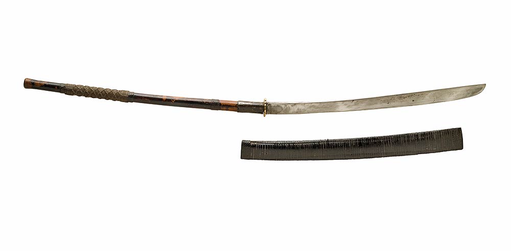

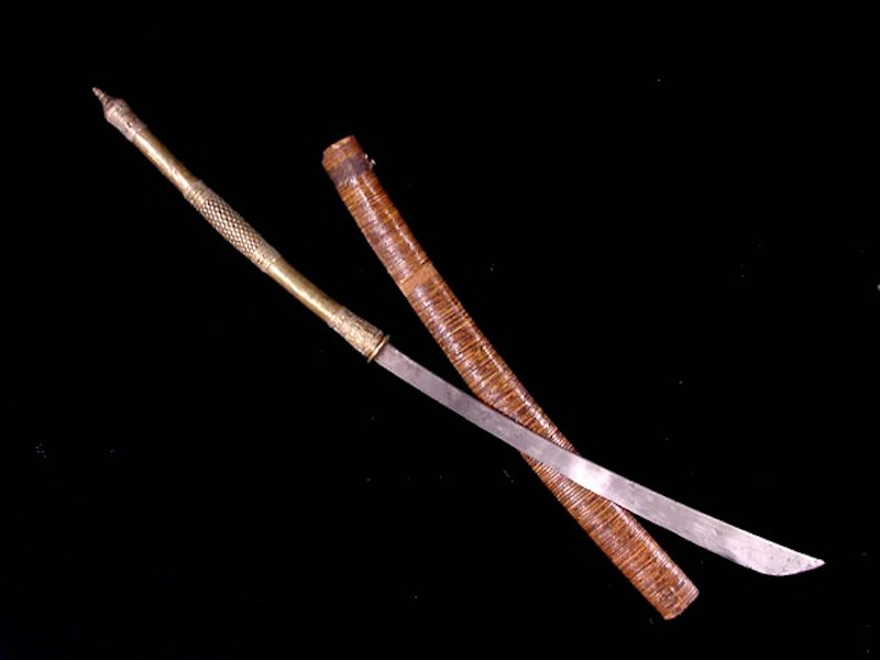

By way of example of the more usual forms of Montagnard daab, I have attached two swords that were exhibited at the Macao Museum of Art "History of Steel in East Asia." The images of these swords are taken from the exhibition's web site where you will find further examples of Burmese and Thai swords.

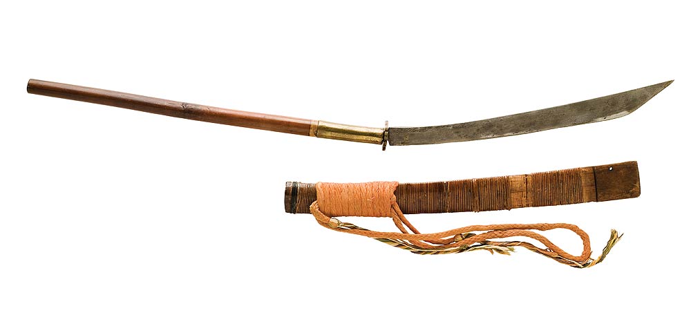

The third picture below with the black background is a sword of mine that shows a N. Thai/Lao daab, probably from the 19th C or perhaps earlier. The hilt has some similarities to the one you show.
As to the age of your sword, it is hard to judge without having it in hand. The style, however, is quite old and the bronze/brass hilt suggests to me it is at least 19th C. This is not your every day Montagnard work sword, but one of some distinction and probably an heirloom that was highly valued by its indigenous owner. Such a sword may well have been owned by an influential Montagnard chief. The gift of such a sword would have reflected the esteem in which the recipient, Sgt Thornhill, was held by the chief.

agree with Ian that it a Lao daab and minimum a 19th century sword. Keep in mind that the today borders are different from the past ones. See here: http://www.vikingsword.com/vb/showth...highlight=laos for a very similar sword from my own collection.

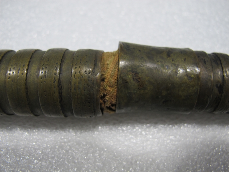

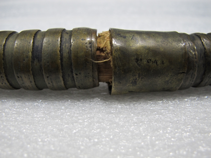

You mention other photos that you have of this sword. I would be interested to see what you have of the multisection hilt. In my experience these hilts were usually made in two or three parts, but I cannot make out how many are actually present here. The decoration of the hilt with geometric designs would also be of interest, with more close up pictures. Lastly, if you could post pictures of the blade, particularly the edge to see if it is hardened, and of any distinguishing marks on the blade (although I'm not expecting there will be any to be found).

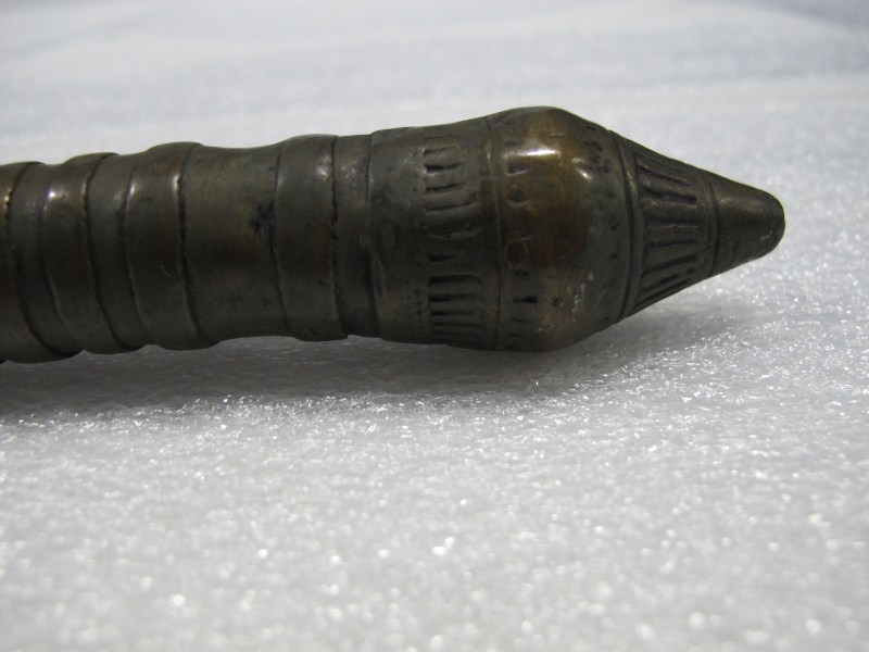

At Ian's request I'm putting up more hilt photographs.

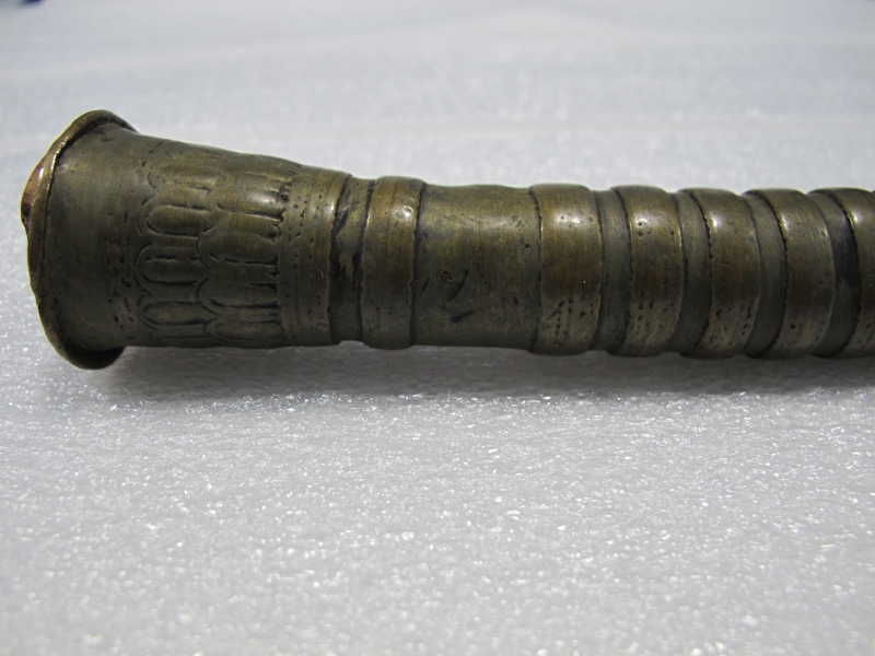

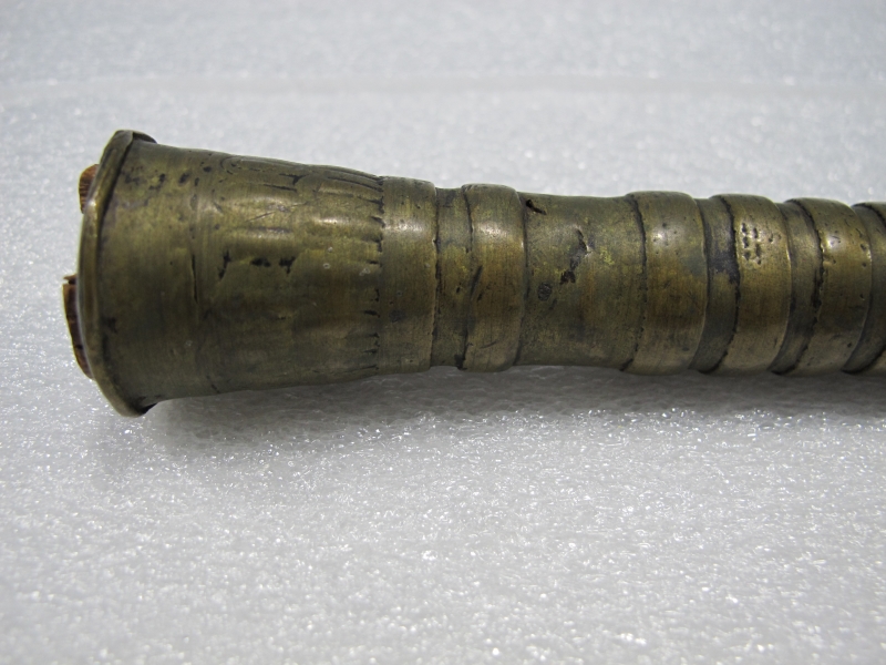

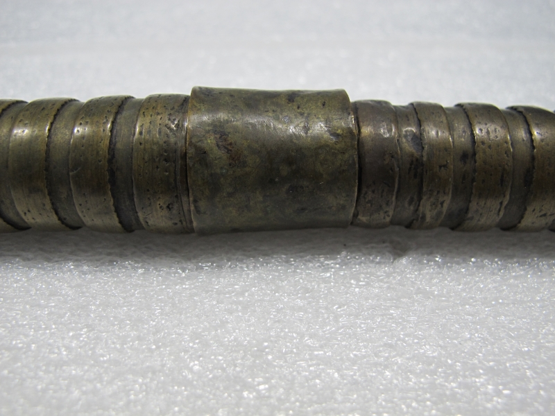

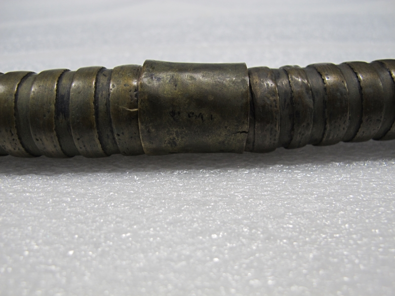

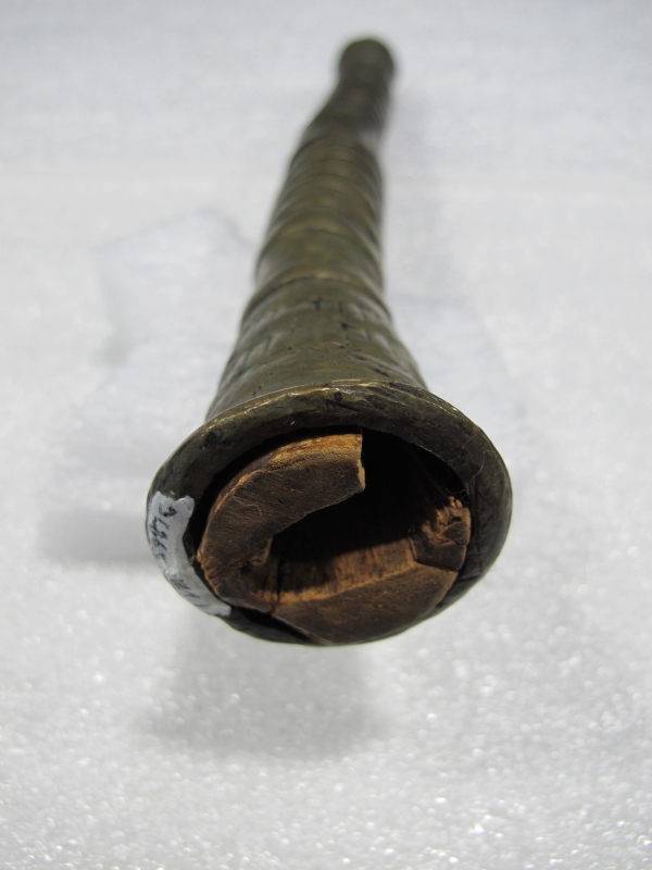

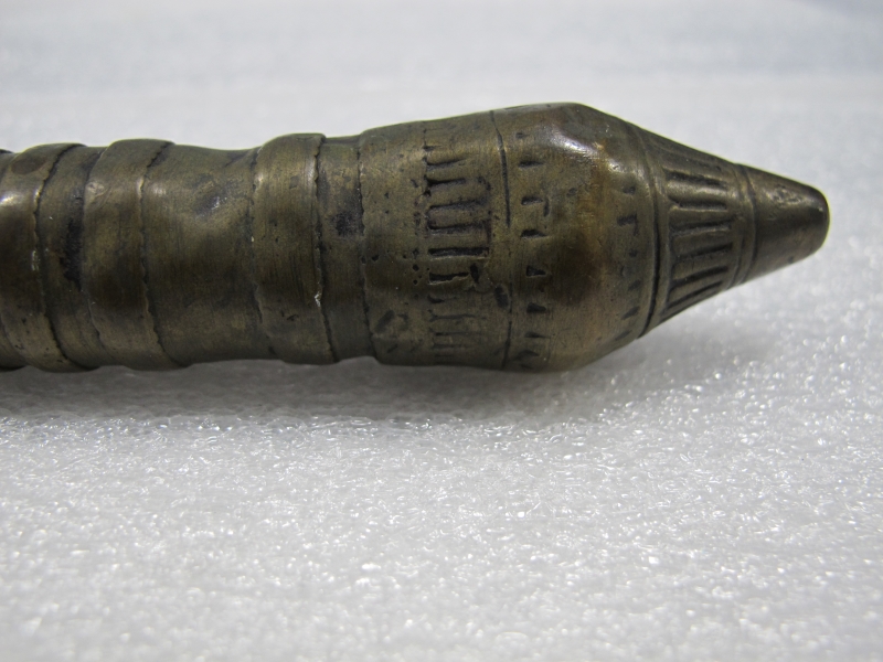

Thanks for the additional pictures. The hilt has been handled a great deal and presumably put to much use. A sword with a proud history most likely.
The hilt is typical Lao work of the 18th-19th C, as several of us have commented earlier in this thread. There appear to be three parts to the hilt, with a small cylindrical mid-section flanked by two longer sections. Much of the original decoration has worn off, but there is enough left to identify typical Lao patterns of the stated period.
This is a genuine antique sword of some monetary value, but its commemorative value is far greater.

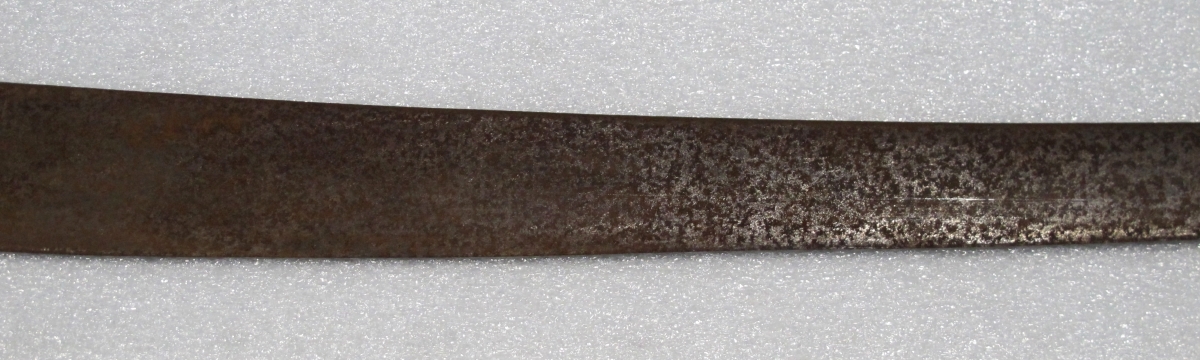

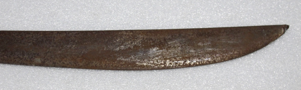

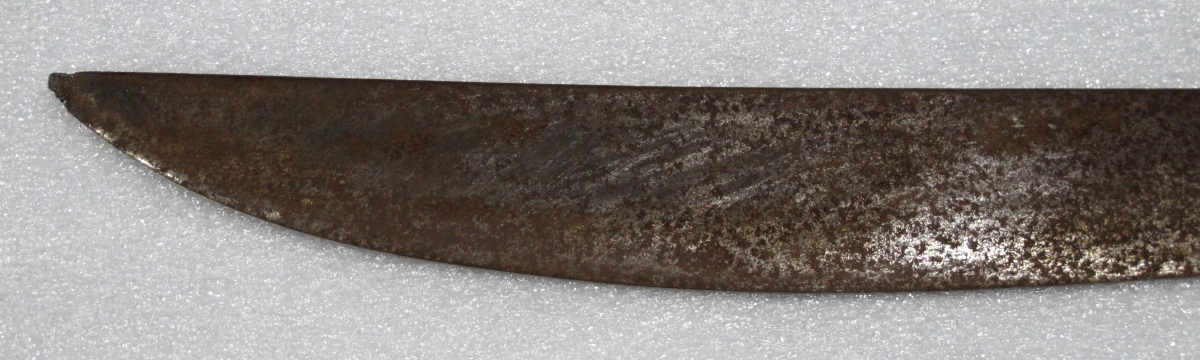

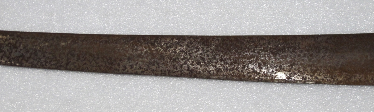

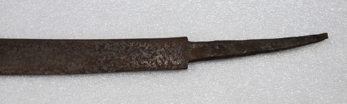

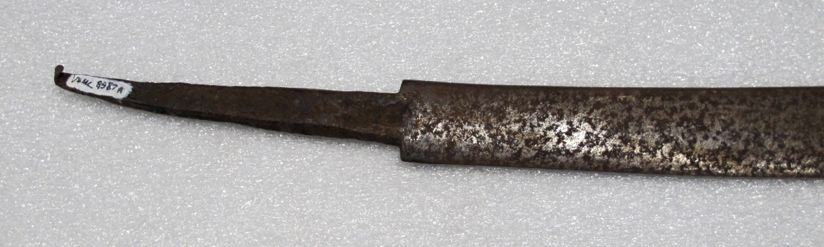

I've got some blade and hilt close-ups coming up next. The blade is a tad rusty so any edge pattern might be hard to discern.

Here's some more close-ups of the handle.

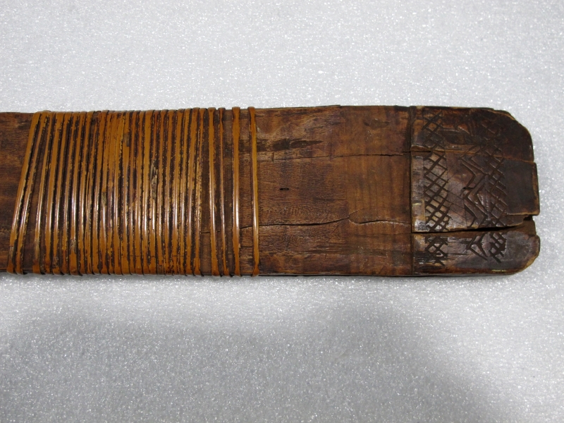

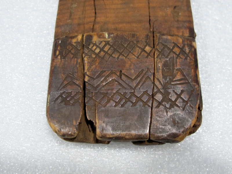

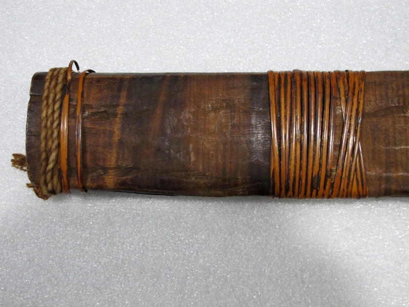

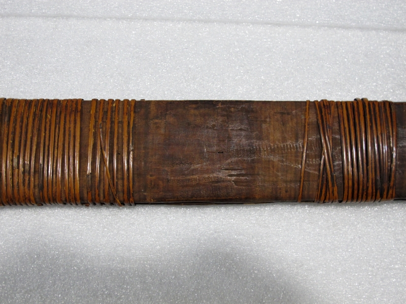

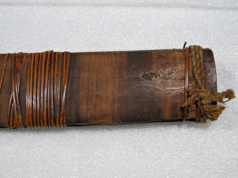

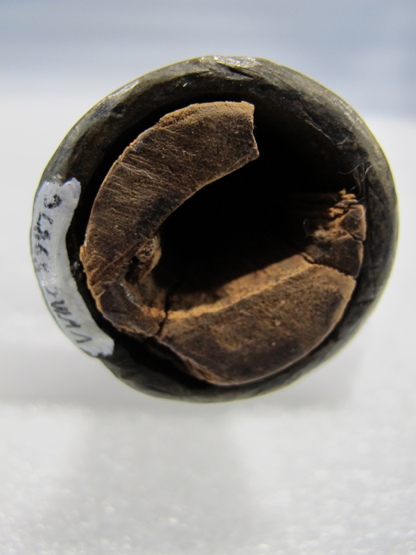

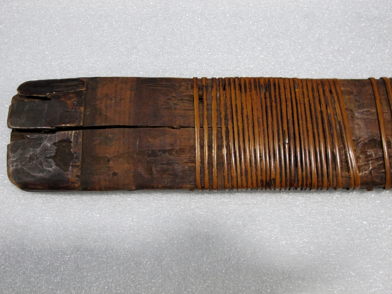

Here are the scabbard close-ups. It seems the two pieces of wood are held together by this cane or rattan wrapping, but is this kind of scabbard usually wrapped all the way, or just in deliberately spaced bands? Is the cane the only thing holding the two slats together, or is there ever some kind of chappe, nail, or peg?

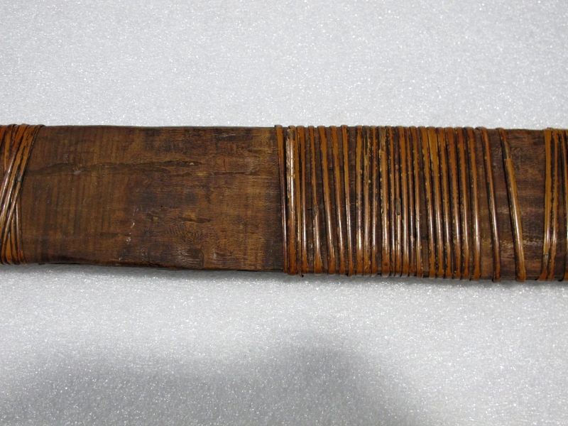

These ones round out the scabbard close-ups.

AzurePark:
The additional pictures are helpful and confirm an antique blade with evidence of old, stable, spidery areas of oxidation as well as some active rust. Your conservator needs to attend to the active rust and prevent it from corroding the sword further. Once the active rust is removed it should either be oiled frequently or treated with a silicone wax, such as Renaissance Wax--but I'm sure your folks know how to preserve these types of artifacts.
I don't see a hardened edge but that does not mean much on a blade of this age. Personally, I would not etch the blade to try to find a hardened edge--simply remove the active rust and conserve it.

Looks like the hilt is made of sections of bronze.
Old 30th December 2016, 10:02 AM   #15
It could be from samrit.
Old 30th December 2016, 03:41 PM   #16
Posts: 7,412
Right Sajen, a form of bronze.
Old 30th December 2016, 10:47 PM   #17
Yes Jose, of course!
