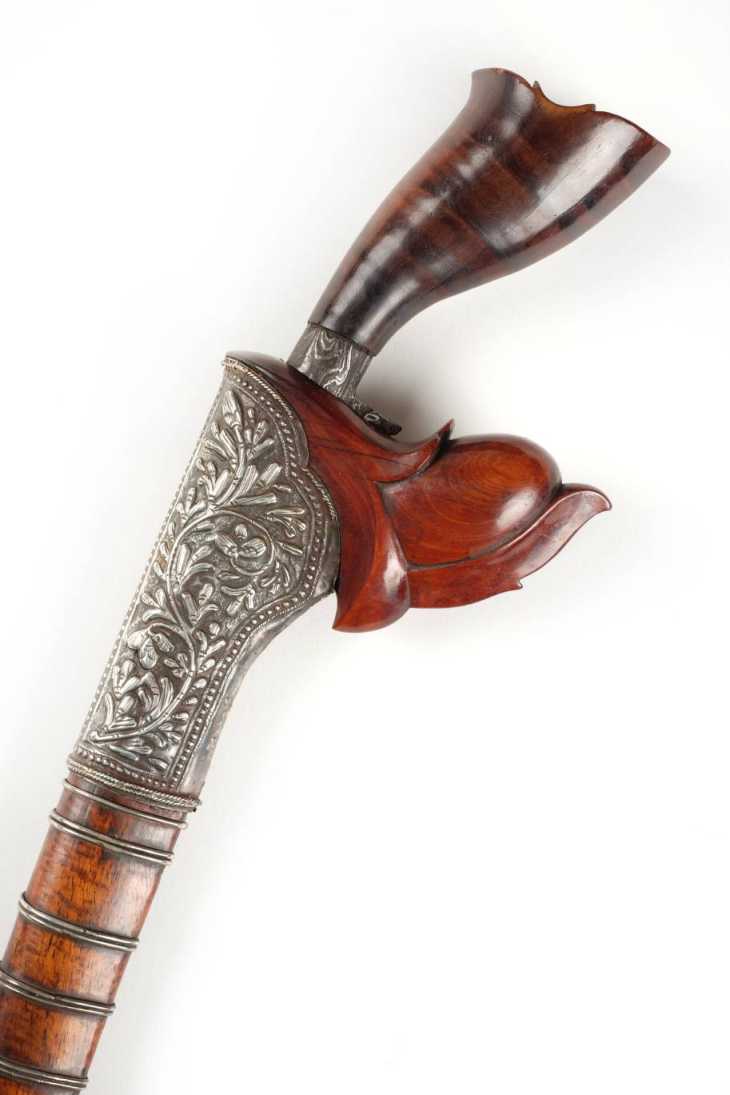

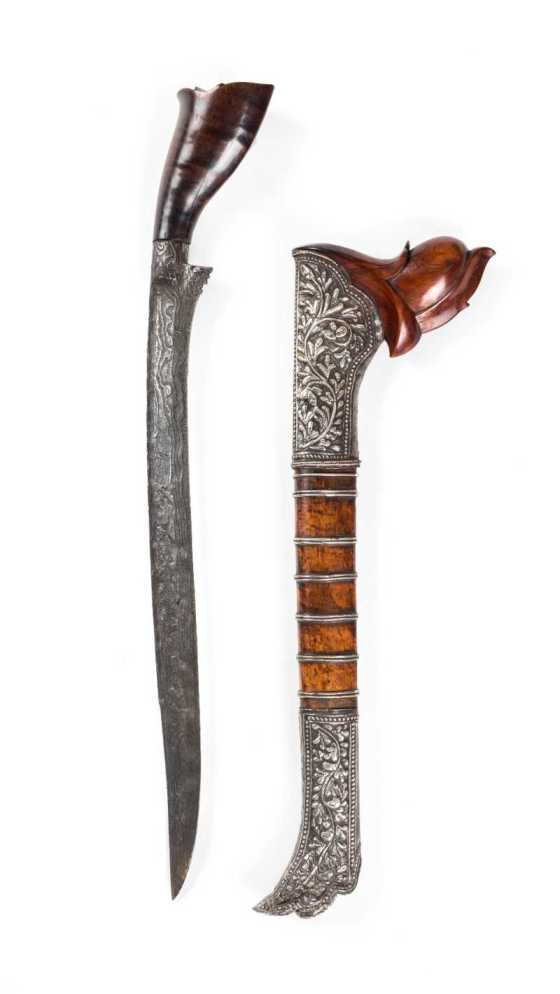

Jut got the sewar in the photos below and would like to know what kind of wood is the hilt made of?!
Any ideas are welcomed!
Marius

could be kemuning wood, difficult to say because it's so dark patinated. BTW, it's a recent fake, so please send it to me, I will dispose it free for you! Nice piece!

PS: I have no idea about wood but in the photos of Kemuning wood that I saw, I couldn't discern the parallel stripes of lighter texture my hilt displays.

After browsing through hundreds of photos on the web, the closest match appears to be MAKASSAR EBONY.... maybe?!
Have a look here: http://www.vikingsword.com/vb/showth...light=kemuning or here for example: http://www.vikingsword.com/vb/showth...light=kemuning

Very interesting! Yes, it definitely could be Kemuning as it appears there are several varieties of Kemuning, some darker, some lighter, and some with stripes.
Thank you Detlef!
What do you think about Makassar Ebony?!

Actually it doesn't look like makassar to me but more a patina form of the outer part of narra tree burl. Quite prized in the region.

I doubt that this wood is either kemuning or makassar ebony --- pic of makassar ebony below.
I do not know narra wood, in fact I've never heard of it, but I do not know names of S.E. Asian woods from outside of Jawa and Bali.
It could be sono kembang maybe, but it would need to have been quarter sawn to present that grain pattern.
If it is a root wood, or wood taken from a crotch or trunk burl it should have a high degree of chatoyancy, I cannot judge this from the photo. I doubt that it is from root, burl or crotch because the grain seems too regular. If quarter sawn it will probably have low chatoyancy or none at all, as opposed to the high chatoyancy we see in naturally distorted grain.

Hello Marius,
like Alan I would rule out Makassar Ebony.

Seems as if narra and sono kembang are one and the same.
https://en.wikipedia.org/wiki/Pterocarpus_indicus
I didn't realise that sono kembang was the same as amboyna burl. I've used amboyna burl for knife handles, and I did not recognise it as sono kembang. The sono kembang that I am used to seeing is sono that has been either quarter sawn or rift sawn, if the wood was from a sono burl, or from a sono root system, in Jawa it would called "gembol", that is "sono gembol".
Still, we must understand the distinction between quarter sawn heartwood, and wood taken from a burl or from a root system.
https://en.wikipedia.org/wiki/Quarter_sawing
As Battara has mentioned, as we come closer to the center of a log of wood, the more intense the colour becomes, in the trunk of a tree we have the sapwood on the outside, which is normally white, and the heartwood on the inside which can be a variety of colours. Even with black ebony, the sapwood is white.
However, in burls and root systems the outer wood is often not white, as is sapwood, but just a lighter shade of the wood that is towards the center.
This sewar hilt might look different in the hand, but what I can see in the photos is a grain pattern that is typical of quarter sawn wood, not of a burl, and not of a root.

note that the burl has a convoluted grain, the quarter sawn wood has a striated grain.
