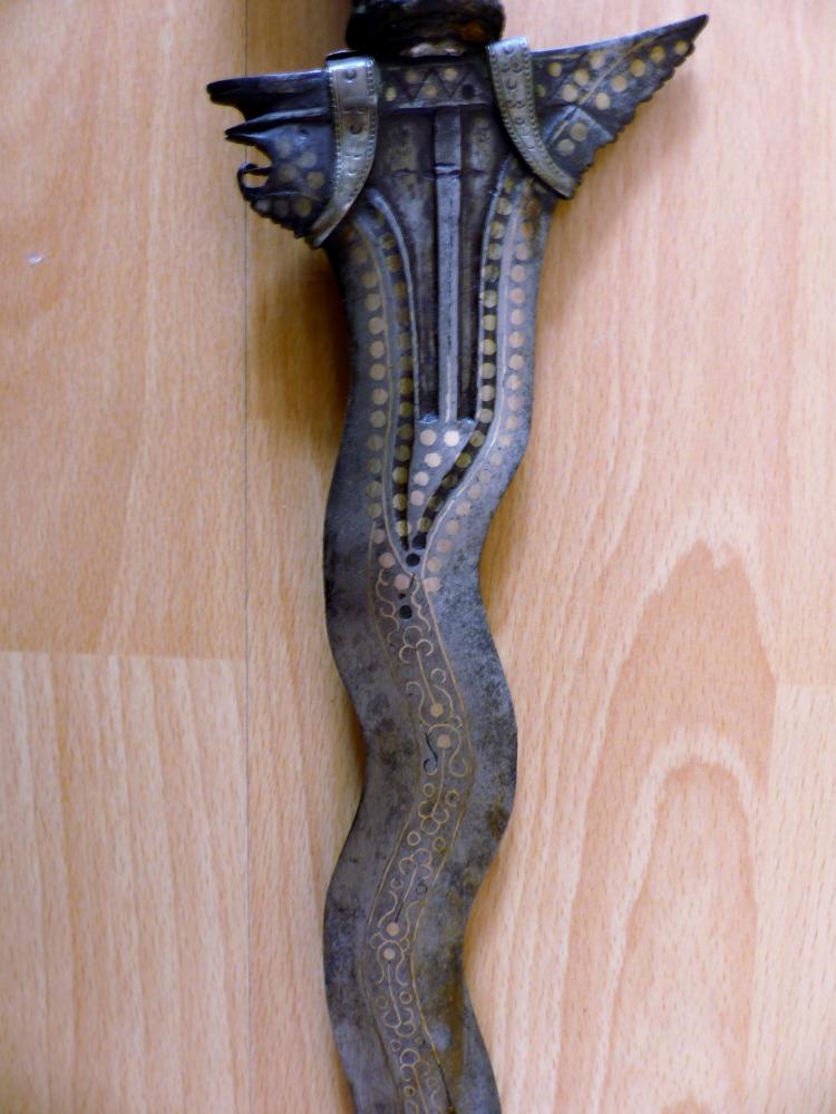

I recently received my first Kris Moro straight from the Philipines.
As I am new to this type of Kris, any comments are welcomed.

Hi Marius,
beautiful kris from the 19th century, nearly can't believe that you get it from the Philippines. The scabbard seems to be much younger as the blade.
Enjoy the polishing and etching and don't forget to show us some pictures later.

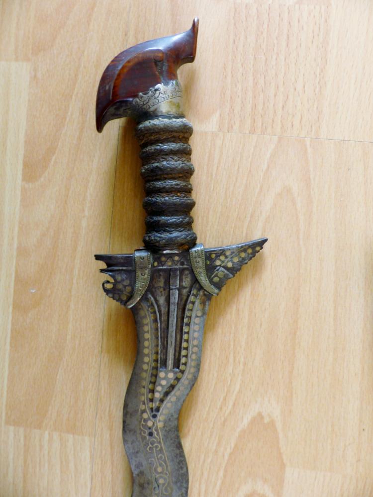

This is a nice Maguindanao datu kris. The grip might be later, but still early. However, the real worth is in the blade: one of the best datu class blades I've seen, even though there are a few missing silver inlays. Nice silver baka-baka clamps too.
As far as the scabbard is concerned, it might be later, but I'm not sure. It certainly is also Maguindanao in style. It would be good to test the scabbard bands to see if they are aluminum, white metal, or silver. If aluminum, then we are looking at the scabbard to be from the 1940s. If silver or white metal, then it was made earlier.

Overall both the Kris and the scabbard show clear and consistent signs of age and wear making me think they are both contemporaries.
The bands on the scabbard appear to be a silver-brass alloy as they are white with a yellowish shade.
Regarding the inlays in the blade, they appear to be brass or a low carat gold alloy.
The fit between the blade and scabbard is tight enough to make me thingk the scabbard is either the original one or a very early replacement.
The overall unsheathed length of the kris is 68 cm, and it gives a very strong and sturdy feel.

I am not so sure for it being a 19th cent. kris and a Datu piece.
The workmanship of the blade isn't particularly good, and inlays look a way strange to me. They are to many, they look to stiff and to neat. If you look at the picture, there are some strange features - the dots are drilled ignoring outline of the fullers at the end of the triangle, but especially the right border of the inlay field starting from the middle of the triangle would be very strange for a 19th or even beginning of the 20th cent. The end of the grooves is still in the middle of the blade, the continuation of the shape with dots and inlays goes out of center to the right. Also the left line of the central inlay field starting "somewhere" from a dot is strange.
At the moment my opinion would be - a quite simple 20th cent. blade, enhanced with "Datu class" inlays at some later time.

Well Gustav, I must disagree with you here. Whether datu class blade or not, I have seen may blades with inlays exactly just like this. If a person becomes a datu by his people, I can see the blade changing to match by the addition of inlays later.

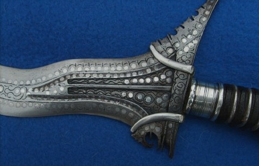

Jose, I would like to see a blade older the 1920ties where the central inlay field starts like this.
For comparison two blades with common position of central field.

There seems to be a bit too much erosion around the gangya area/s compared to the rest of the blade; the Greneng features(Jawa) seem too indistinct; the same with the file work below the kembang kacang/Elephant trunk.
With that amount of erosion there I would expect the blade to show more pitting.

Whether late 19 century or early 20 century, this Kris is certainly a genuine antique item. All the pieces of the Kris show signs of wear and age corresponding to a prolonged use and exitence, and they are consistent throughout the whole piece. Even the scabbard shows significant wear and age.

Old/antique yes, but I doubt it being 19th cent., and I have yet to see another blade with such configuration of inlay motifs. Which (for me) poses the question about all inlays being old/antique.

regarding if it's a 19th century piece I've asked Marius for dimensions since a 19th century piece will be smaller as a 20th century kris. Regarding the inlays, it seems that the inlays are done before the grooves get carved in the blade, you can see this also by the both other kris you have provided pictures from.

this for sure is true for the dots (or most of them), but not for the lines.
The configuration at the beginning of both lines, which border the central inlay field down the blade, is absolutely different from the other blades I did show in my previous post (I have explained the difference in it), and in fact, different from all old/antique blades I have seen so far.

Marius, norms and deviations from norms are bound to circumstances/time periods. If a feature, which is always performed in a certain way, has been changed, we should question the circumstances/time period.

But we can also question the area/smith. Diferent area/bladesmith, different style.

now I understand what you mean but frankly said it look all original but it could be that the inlays around the central field are of later date but for sure not recent IMVHO also when it look a little bid weird.
