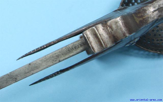

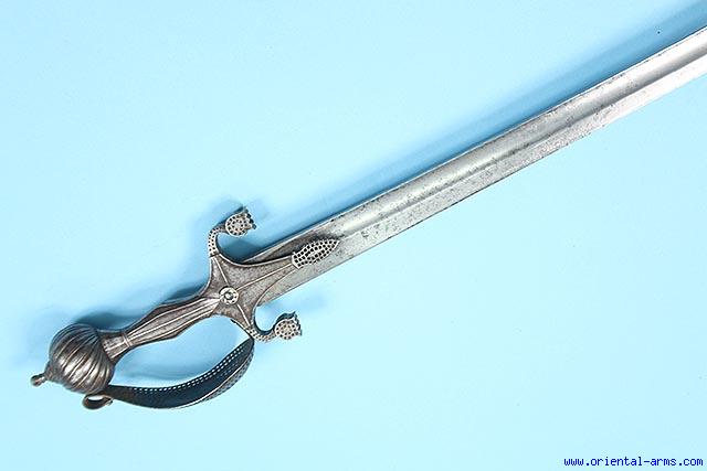

I have this sword on order; it is an Afghani version of the Indian tulwar. The blade is marked “Enfield”, so I would assume that it was made from a sword captured during one of the Anglo-Afghani wars. To the best of my knowledge, Enfield did not make sword blades for general export. There might be a date that has been obscured by the new hilt. My question to the group is what was the original British pattern for which this blade was made?

First one Ive ever seen with a British military blade, but this does not seem an unlikely combination. After the Treaty of Gandamak (1879) and end of 2nd Afghan War, the British installed Abdur Rahman Khan as Emir and they continued a nominal occupation of Afghanistan. This included the creation of the Mashin Khana state armoury in Kabul, which produced British military rifles for Afghan army as well as some other arms. This seems to have taken place around 1886, but production seems to have faltered around 1905.
While I cannot recall for certain, it seems the small arms produced were Enfields.
While the forte on this blade is partially obscured by the langets, it appears to be either an 1885 or 1890 pattern British cavalry blade, although there were earlier ENFIELD production blades. The earlier blades usually had the year after the Enfield stamp.
There should be WD and arrow mkgs on the blade.
Enfield began producing sword blades after 1820, but as noted, like other British makers, blades were not made for export.
Rather than suspecting this blade may have been captured, I believe it more likely to be from the British occupation period, with an Afghan armourer using it for mount in a traditional hilt, probably around turn of the century or later.

The blade by Enfield would originally have been a 1821 pattern light or heavy cavalry troopers sword. The latest dates on 1821p Enfield swords I've seen is 1848. These blades are 35 1/2" or so.
The name Enfield is followed by the date on the blade spine, on this sword it is obscured.
