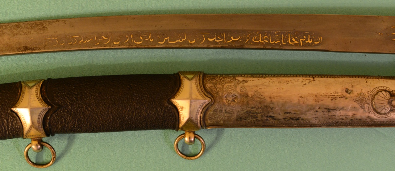

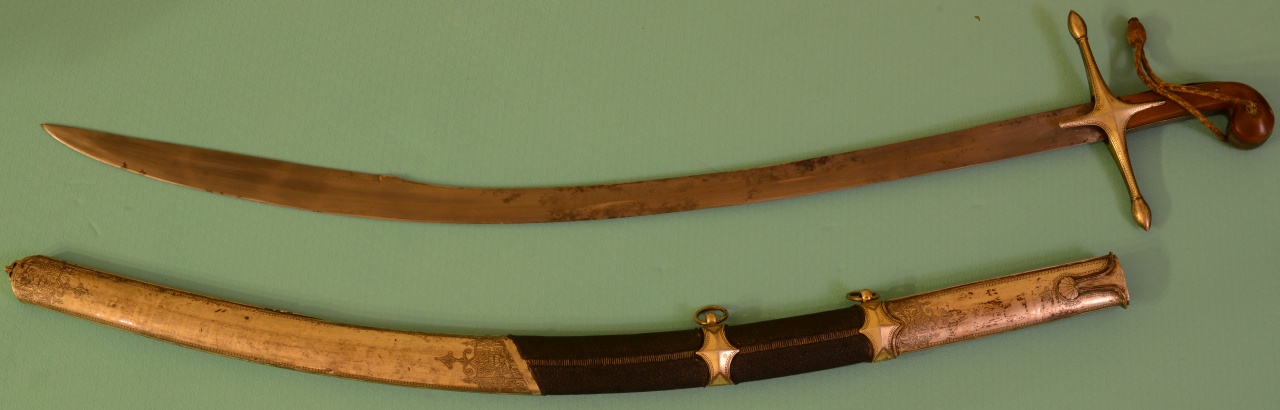

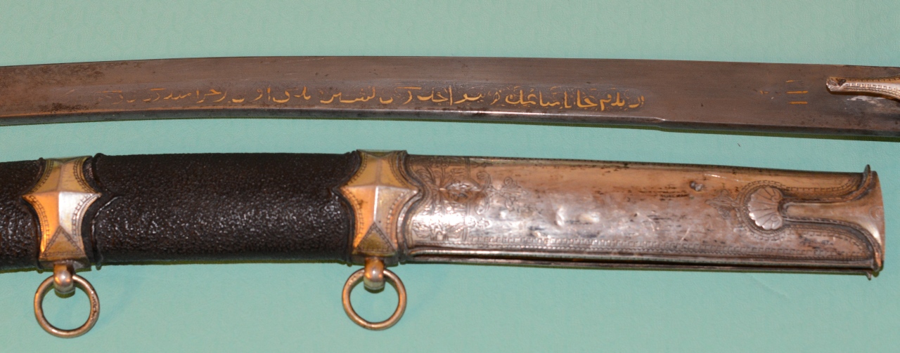

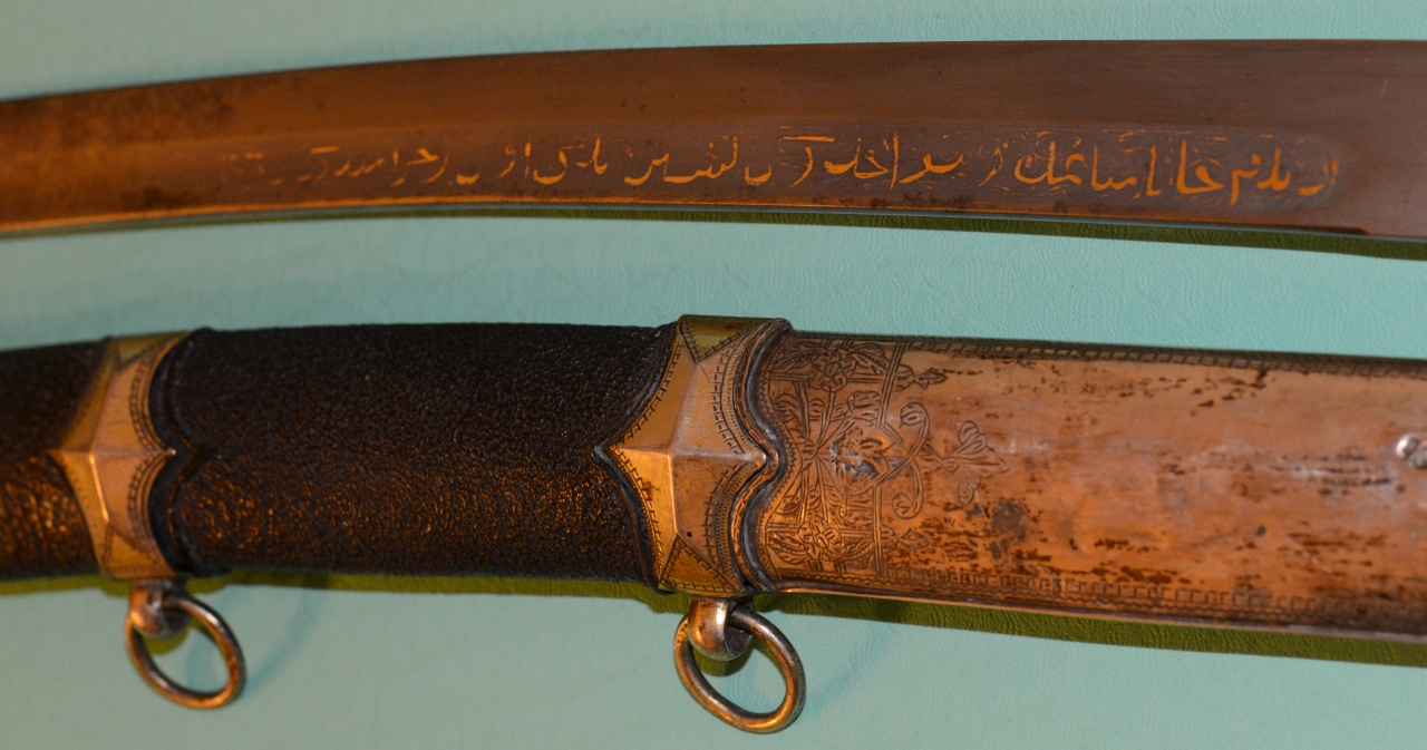

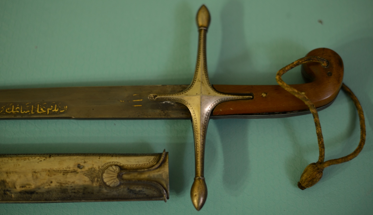

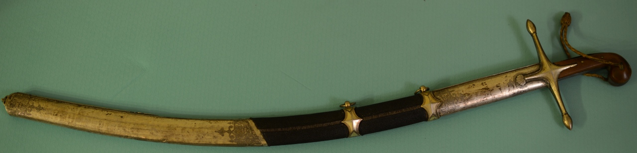

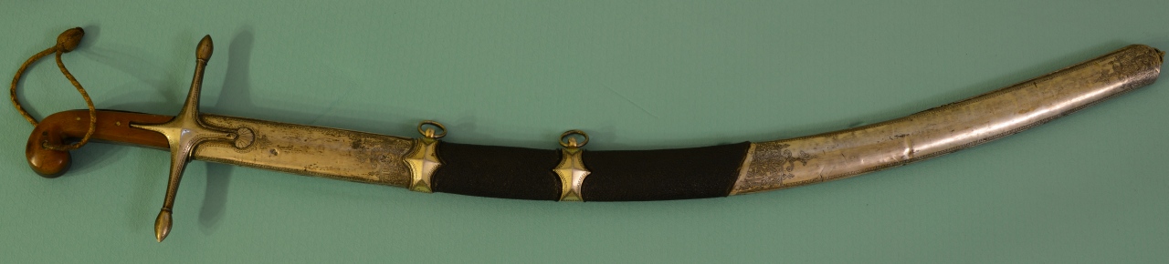

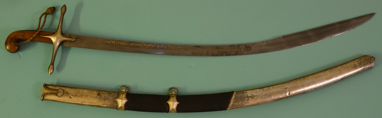

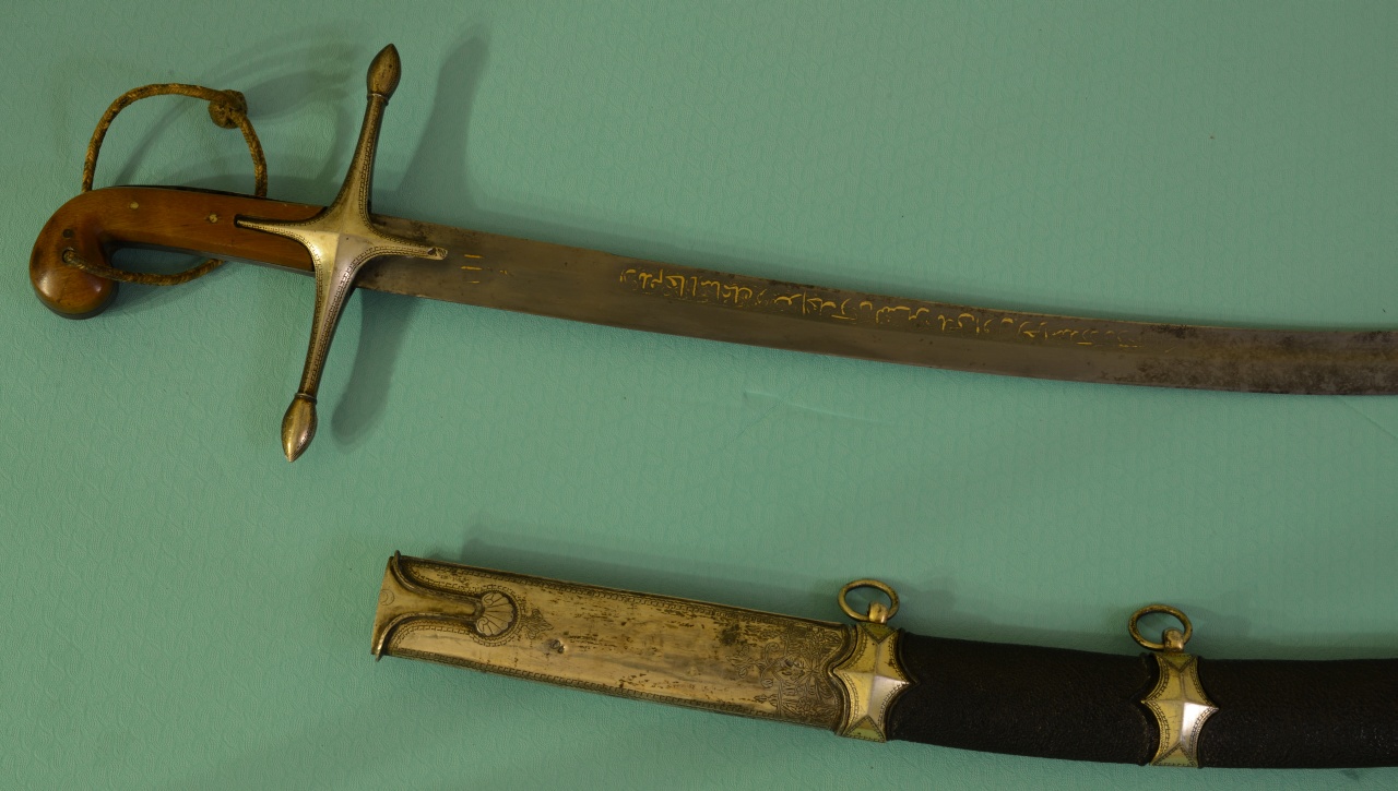

Hi friends,
I would appreciate if someone could translate the inscription on this kilj.
Turkish silver-gilt with marks, Reign Of Mahmud II (1223-1255 A.H. Corresponding To 1808-39 A.D.) Your comments also are welcome.

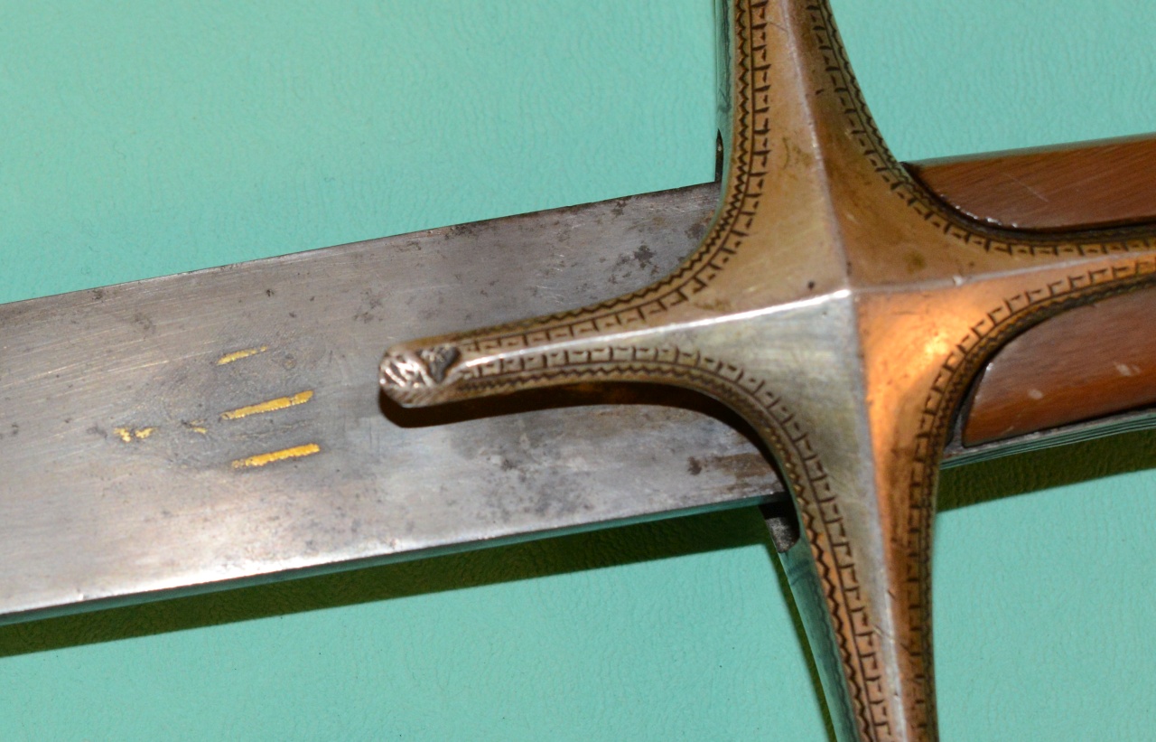

While we are waiting for Zifir or someone else to translate the inscriptions, I just wanted to thank you for sharing this superb kilidj. The blade looks like it could be earlier than the fittings: have you tried etching a small window to test for wootz or a mechanical pattern?
Teodor
No, Ι am afraid to do that. Furthermore already has sufficient corrosion thereon.

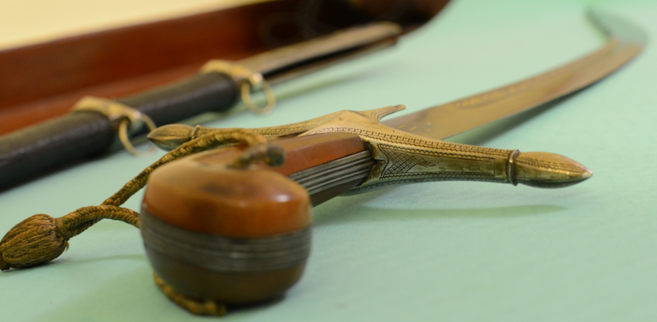

I agree that this is an early example. Also the hilt looks like it is made of rhino horn.
Nice kilij!

looks nice, a light etching would make sense to me... Just to see what it is made from...

I too would leave this as is without an acid etch.
To etch a window would detract from the current fine old appeal.
Such a sword would more benefit from a professional polish if you wished to know the metal type and view it as new again, but as it sits, it is not required, it is a fine old sword of good quality.

Is that a scarf weld I see where the blade widens ?
Strange place for a scarf weld .

More likely where someone has had a little go with an etchant to see if it is wootz!
Aint that the truth...LOL See...
linky.
linky.
Anyway, the seller did not describe it as wootz.
Sometimes when I look with a magnifying lens I see dark waves, but rather is what I would like to see...

The Wallace Collection, exhibit Νο 1993. (Αnd one last attempt to find a translator...
Sylektis is offline   Reply With Quote
