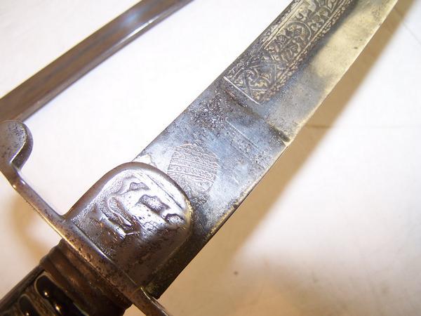

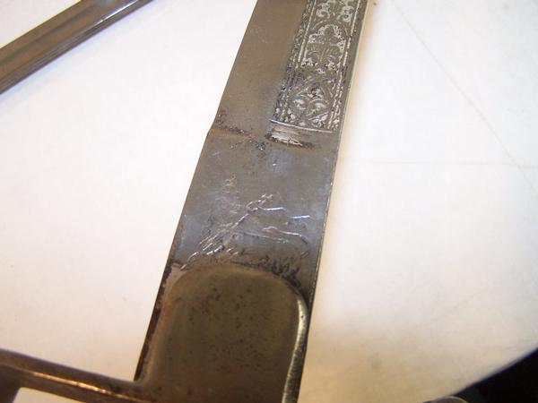

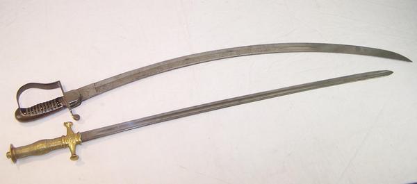

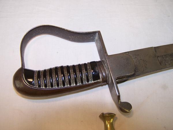

Hi, just won these two swords (both swords in the same auction), my first Ethiopian sabre 35", looks to be 'overly' cleaned but looks in good condition.

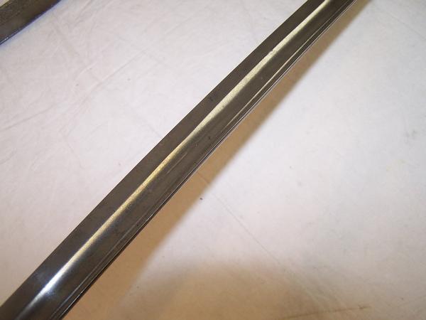

The second has a 'Tulwar' styled hilt , straight blade with 'WHITES' stamped on the blade OAL 33". It is either 'vintage' or, again, overly cleaned.
Comments, information on age, origin etc on either of the swords would be greatly appreciated...

The straight sword seems European/Eurocolonial. Are you sure there's not a wooden handle under a wire wrap there? The cross-shaped guard does seem Turk/Persian derived. Did it once have a knucklebow, or why the asymetry to quillon and pommel?

Thanks for the reply I did notice that there once could have been a knucklebow...unfortunately I do not have the sword in my possession yet, so can't really comment but judging from the pics it seems there was a knucklebow which was removed due to damage or 'customisation'. I had assumed the handle was wood but again wont know until I received it.

p.s. - it does look like there was a protrusion on the guard and a corresponding one on the pommel of the straight sword that could have once been a knuckle guard, now removed and well rounded over.
