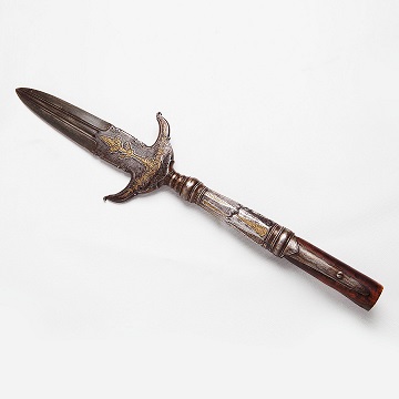

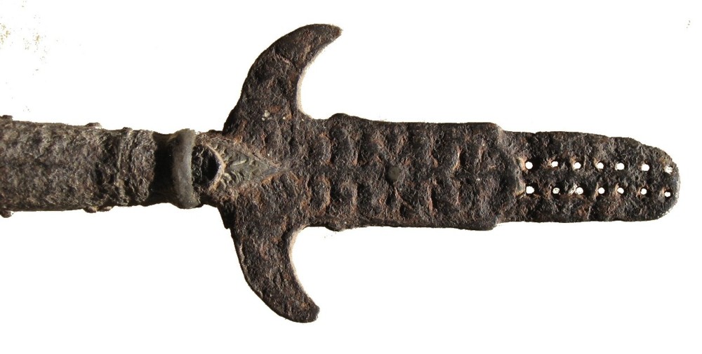

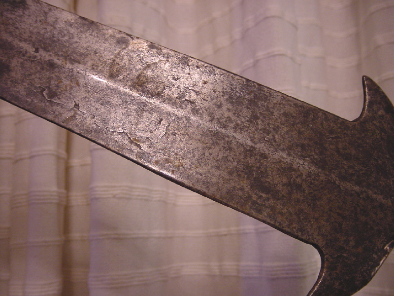

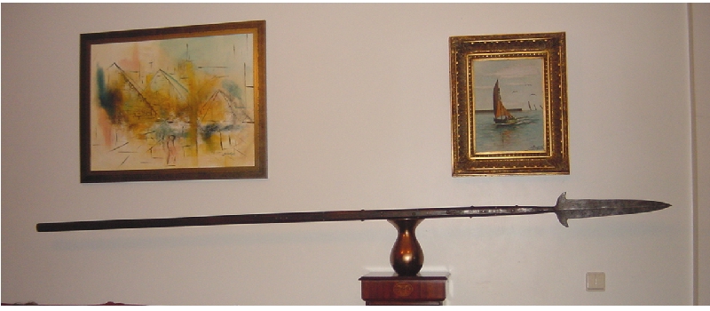

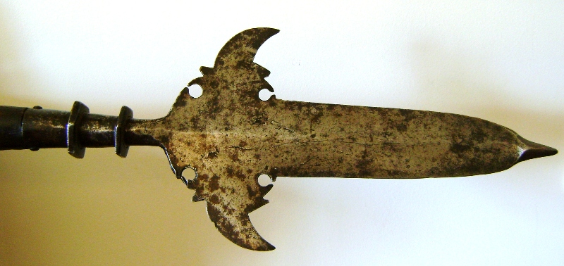

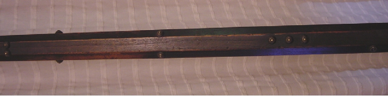

This is a polearm called partisan; some say the ascendant of the spontoon.
It is in principle Portuguese (provenant from Oporto); the seller dates it from the XVII century.
It would have been an action weapon.

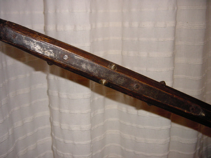

The staff is possibly the original one, adorned with several brass fancy nails, possibly a later stage embelishment, certainly to have a second life serving ceremonial purposes

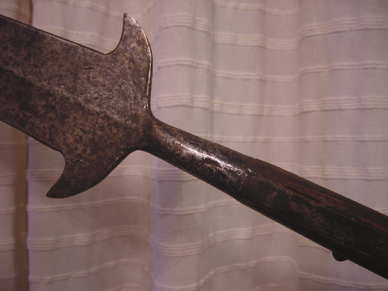

Blade length is 46 cms ... 53 cms including socket.
The side straps measure 34 cms.
The total length of this piece is 2,70 mts.
Anybody care for coments ?
Thanks
Fernando

A very handsome example Fernando! and though I dont know much on polearms, I wanted to add some thoughts after reviewing some notes on these. The terminology on polearms is interesting, and perhaps it would be interesting to discover more on these terms. Apparantly the 'partisan' is also more familiarly known as a 'spontoon'. " always think the 'oon' suffix is curious, as in the swords we have studied such as 'walloon' , the 'spadroon' come to mind.
It seems most polearms were intended for combat against horsed enemy, and there were many variations in the shapes and features of the heads on these, with distinct purposes associated with axe blades, spear points, hooks, winged type protrusions and so on.
The earlier forms of partisan, I understand had axe type heads on either side of the blade, which evolved into two side blade protrusions. On these, as on some other polearm heads, these were hilt-like in function defensively.
In this example, as you have noted, these side blades have become rather vestigial, and the weapon, as was the case with partisans in general by the 17th century, had become more ceremonial. I believe, if not mistaken, that the spontoon (partisan) became a sort of rank insignia that was often carried by sergeants or similar equivilants in rank and file.
Interesting to have provenance with this example, and perhaps looking into the military history there, more information might be present.
I know these turned up in Spanish colonial sphere, and I think were even used as noted during the American Revolutionary War. Need to check more in Neumann's reference! Looking forward to more comments.
All the best,

Hi Jim,
Thanks a lot for your input.
It appears as, despite the use of the term spontoon is a coloquial attribution, indeed the partisan is an earlier weapon ... derived from the lance, we can admit. From what i have been reading, the partisan ended up as a rank insignia weapon, while the spontoon was already generated for such purposes ... or something of the kind .
I guess the term 'partisan' (partasana in portuguese) derives from the italian 'partigiana', a weapon aledgedly used by the Partisan militians (Partigiani).
Isn't sometimes the sufix 'oon' the same as 'ão' in portuguese, or 'on' in french and spanish, meaning large, or dimensional... right ?
Fernando

A very fine piece, Fernando - well done.
Although this kind of weapons, having become, as Jim put it, rank insignia by the time that your partizan/spontoon was made, is not really within my expertise I like it very much. Very good photos as well, one showing clearly the layers of wrought iron coming off - a proof of authenticity anyway.

Hi Michael, thank you for your coments.
Within my humble perspective, while at the period sugested by its haft, this piece served an insignia purpose, i do beleive the blade shows a lethal aspect, suiting a task more 'responsible' than just ceremonial.
Fernando

Hi, Fernando,
It is just as you wrote: the form of the blade does serve a lethal purpose. I even see it in the same line of formal development as the Late Gothic langue de boeuf and the early Renaissance short cinquedea.
What makes me wonder if that lethal purpose could still be reached with your partizan/spontoon is the relative thinness of the blade and of its central reinforcement ridge. These two were, in my opinion, somewhat more accentuated in former blades meant for actual fighting.
Again, this is not the field that I can plow with sufficient authority though.

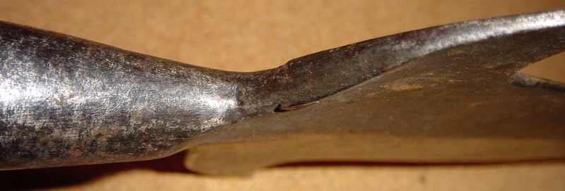

Hi Michael
... What makes me wonder if that lethal purpose could still be reached with your partizan/spontoon is the relative thinness of the blade and of its central reinforcement ridge. These two were, in my opinion, somewhat more accentuated in former blades meant for actual fighting ...
I see your point.
Not that i have not seen blades with a rather more fragile aspect. But i lake the experience to discuss the subject, even much less than you, of course.
Indeed the blade thickness in this one is 6 mm by the ridge, although its lateral 'hooks' reach the 8 mm, partly because they have been beaten (hammered), for whatever reason, which made their rims even thicker.
Fernando

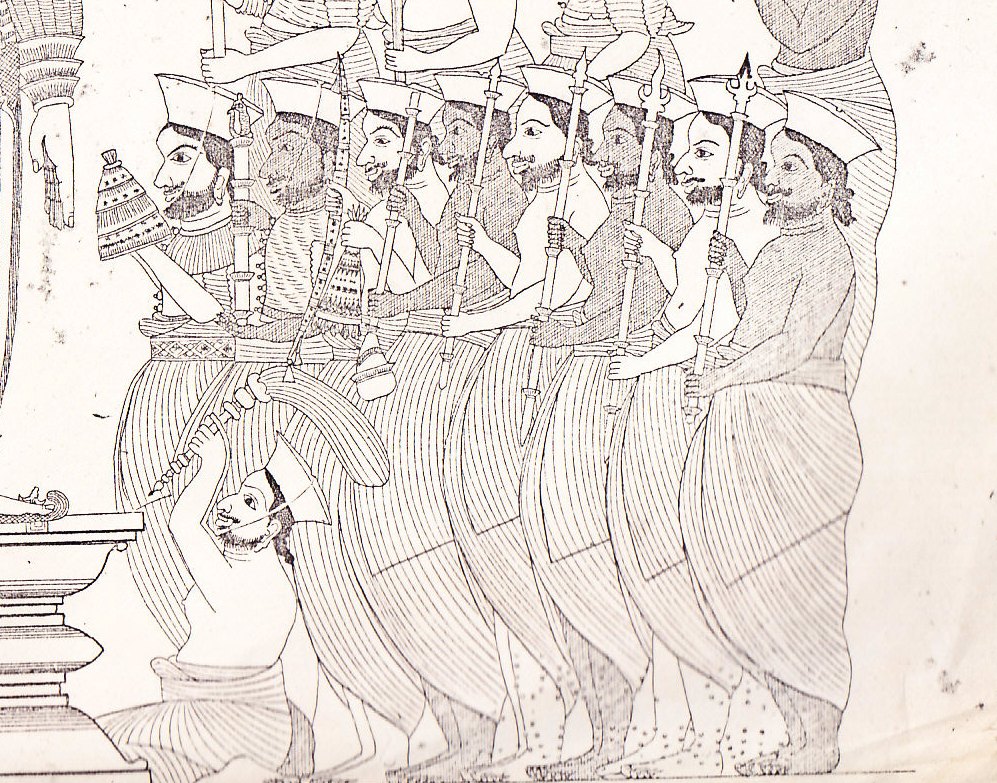

More...I add in retrospect the importance of looking at the martial arts of the Sri Lankan diaspora in an attempt to lock down these weapons probably absorbed from the Portuguese. This particular spear seems to be one such weapon.

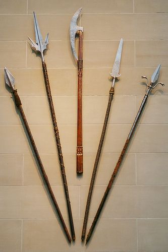

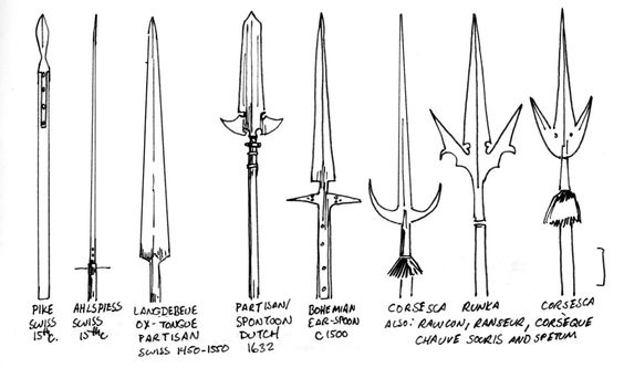

I illustrate below similar weapons from a variety of European locations...all Partisan styles ...It suggests that this form was copied into traditional weapons in Sri Lankla...I wondered if I could see Partisan spears at the back leaning against the wall in Rembrandts great work...so I included that...Partisan spears crop up in German, Italian, Portuguese and many other European regions. It makes sense that The Portuguese transported in this weapon to Sri Lanka...rather than the other way around.

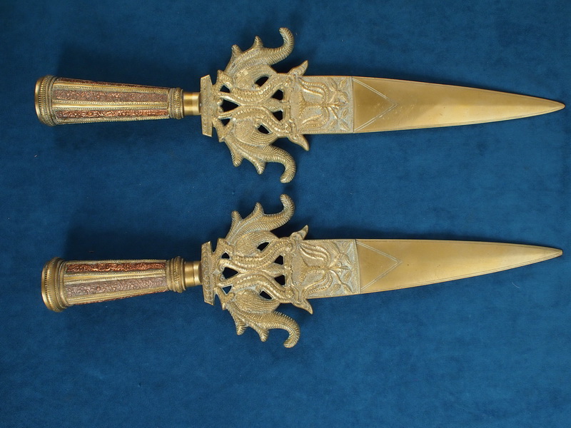

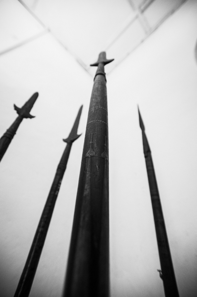

At the Ratnapura Sri Lankan National Museum ~ Patisthnaya Spears.

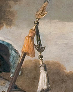

the partisan was imported by the Dutch! in Sri lanka (Ceylon)
Ceylon was between 1640 and 1800 of the VOC, It was conquered on Portugal.
During this period there were two types of partisans in use in the Netherlands, one with an openwork effects (ajour),fe mermen and mermaids. (see a rare spontoon from my collection which, to my knowledge no second copy is known, beyond on the paintings) and a closed Version.
best,
Jasper

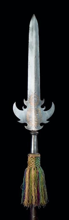

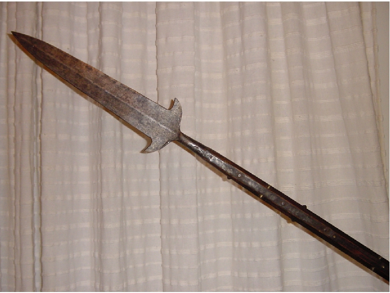

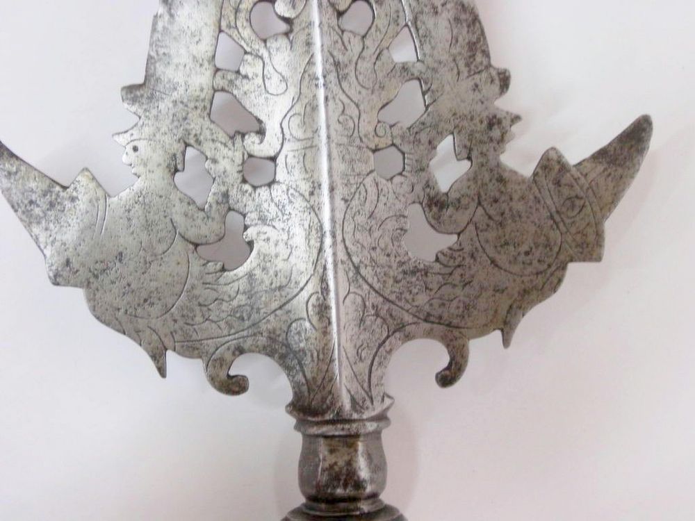

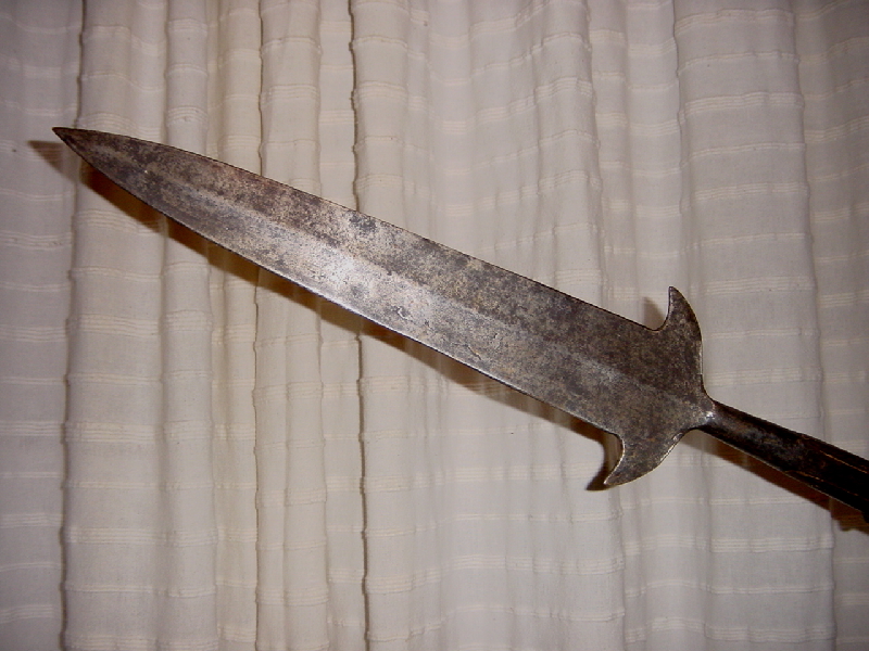

Magnificent example Jasper, that with openwork details in your collection.

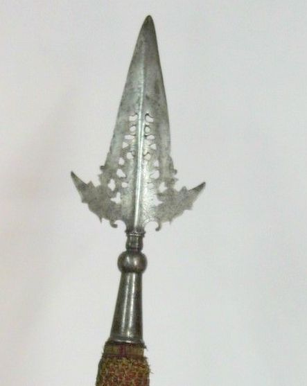

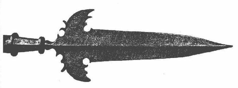

Here is my other partisan, supposedly Swedish.

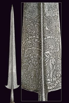

... And a similar one, with the etched face of King Gustav II Adolf, in the Brahe-Bielke arsenal, Skokloster castle, Sweden
