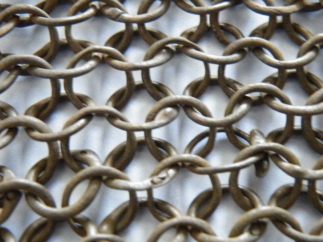

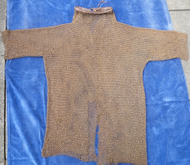

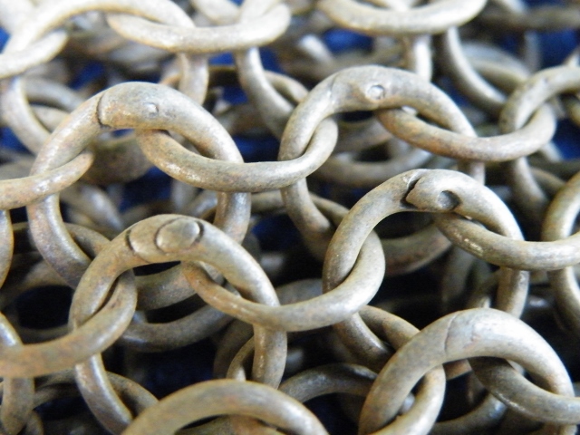

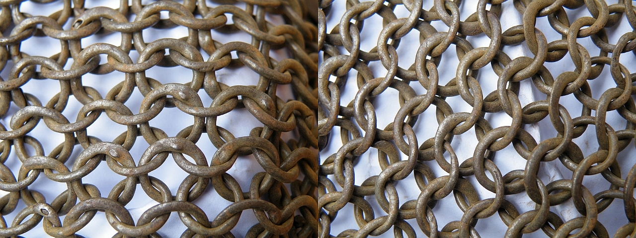

I found this chain mail shirt (hauberk), a little while ago. Can anyone help with identification etc ? The links are riveted and there is a leather collar.
I'm thinking its most likely from Northern Nigeria or Cameroon, but I guess Sudan is also a possibility. Maybe early part of the 20th century in date ?
If any forumites can assist with origin, date range or any other information. please do so...
Thanks in advance.

Colin, if it is riveted it is not African, it may have ended up there but it almost certainly made elsewere. Can you post some large photos of the links both front side and back (not to close)?
If you can take very large images you could post them on flicker or photobucket etc and post a link,this would help identify where your hauberk originated. Also do you have a weight and length? Is it constructed with alternating rows of solid and riveted links or is it all riveted links. It is hard to tell from the images you posted but it looks like every other row is made from solid links.
If we can identify what type of rivet that was used it would also help identify were it was made (wedge shaped rivets or round rivets).

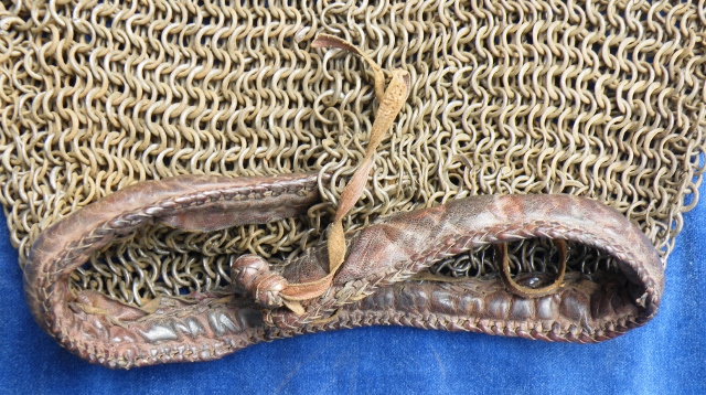

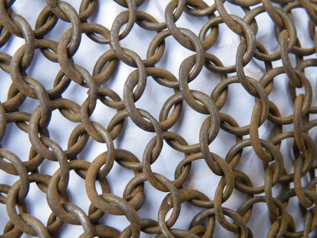

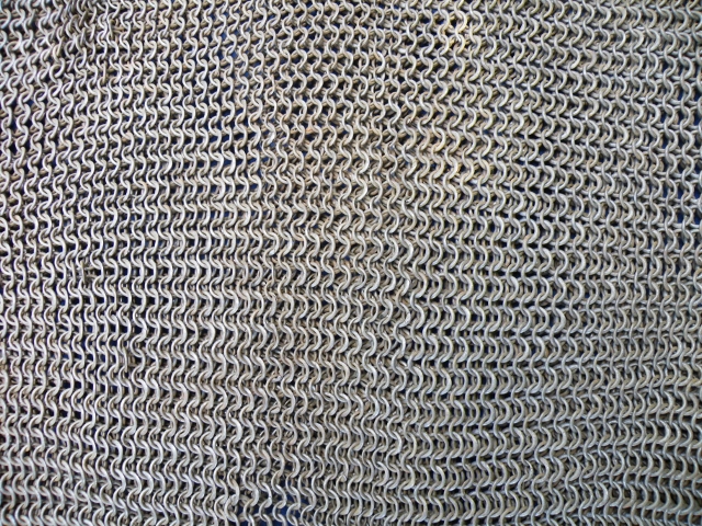

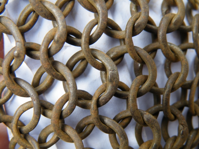

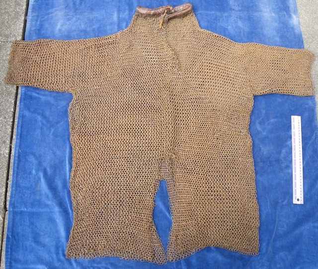

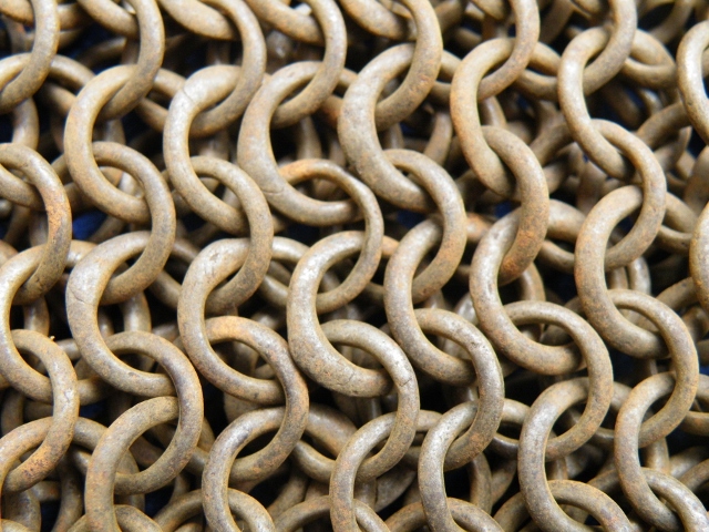

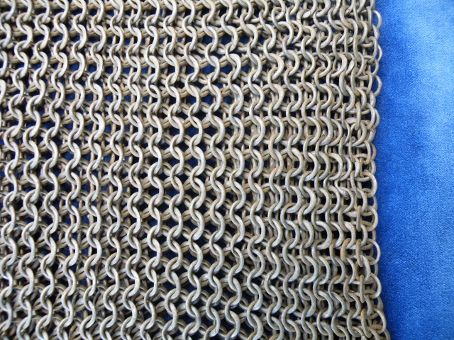

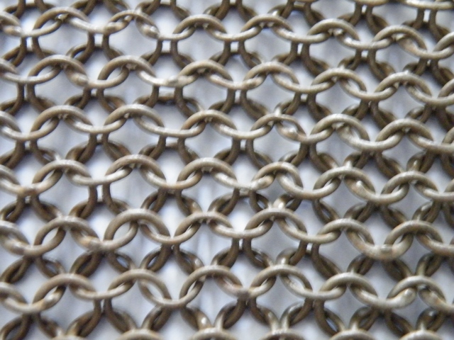

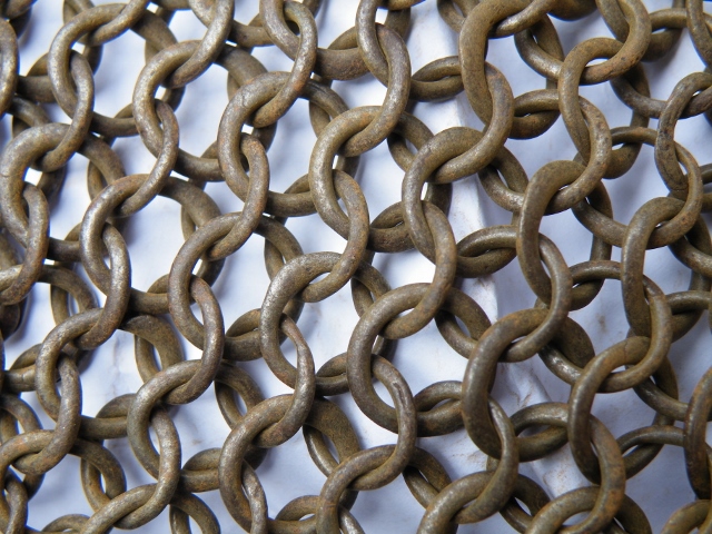

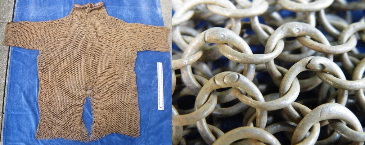

Estcrh, thanks for your comments. Here are some more images of the hauberk.
To address your queries :-
Height : 94cm
Width : armpit to armpit : 68cm
Width : ends of sleeve to sleeve : 120cm
Measurements are approximate, with the hauberk laid flat.
Unfortunately, I don't have scales strong enough to weigh the piece, but its heavy !
Upon close examination it does indeed appear to be made up of rows of alternate solid (welded ?) and riveted links with round rivets. The links near the edges of the sleeves and the skirt are smaller and lighter. The rivets seem more noticeable on the inside of the hauberk.
In general the hauberk is of a high standard of workmanship.

Your hauberk is in very good shape and at 94cm / 37in it must be heavy. If you ever get a chance to weight it that would be very helpful to me. To weigh mine I just use a bathroom scale and weigh myself first then I weigh myself while holding the hauberk. I expect yours to be 20+lbs.
Your hauberk is not African, as it has the typical alternating rows of solid links and round riveted links (demi riveted) it is Indo-persian and can be pinned down to the Indian, Persian, Ottoman category. I rule out Indian as their solid links are not usually round, they appear to be cut from strips of sheet metal and then welded.
Your solid links are round and would have been welded so this narrows it down to Ottoman or Persian.
My guess is that your hauberk is Otttoman Circassian, the links are very well formed and quite uniform in shape, which seems to be a characteristic of Circasssian mail from what I have seen based on other examples that were said to be Circassian mail. While this is not an absolute it is the best estimate I can give you with the current information available.
I would say the age range would be from the 17th century to the 19th century, I do know of any way to date it more accurately.

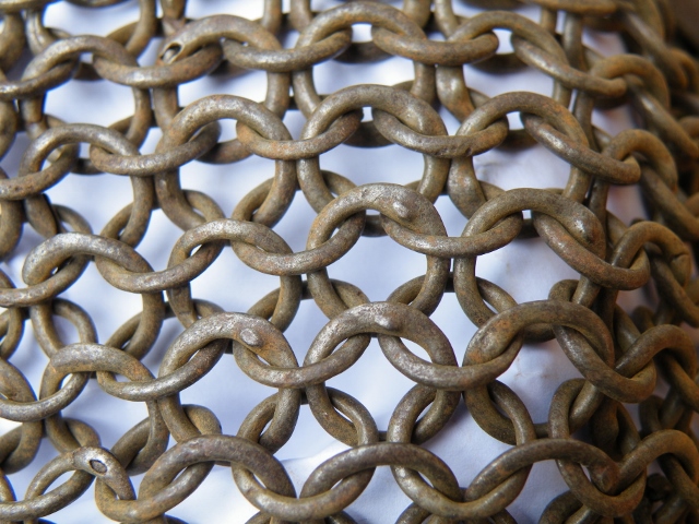

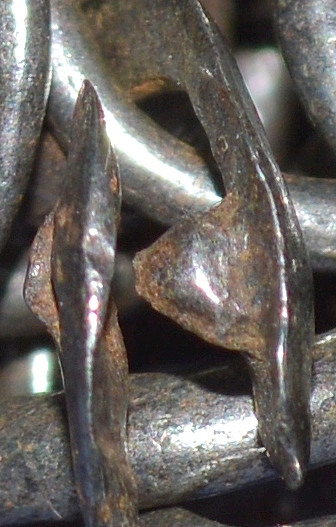

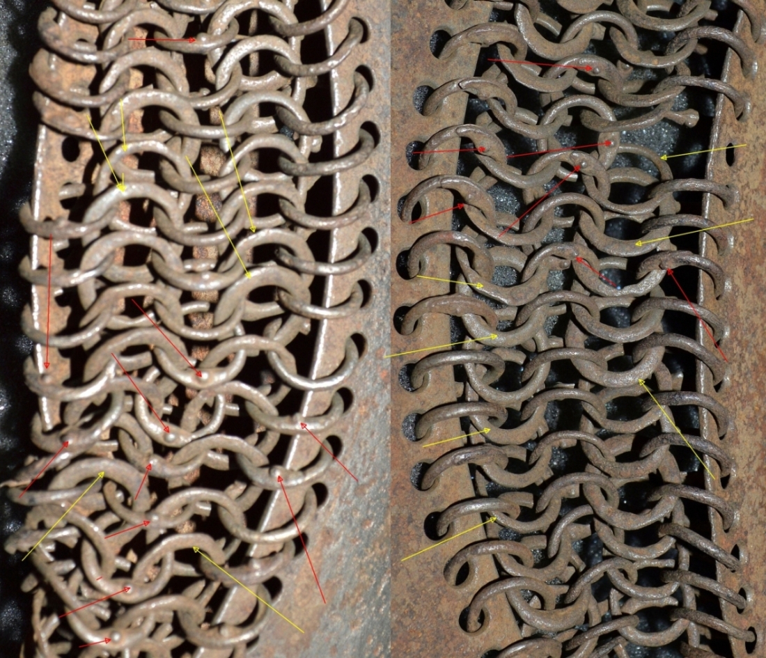

Collin, just to be sure, can you take a photo like this one but from the inside so I can see the back side of the links. I want to be sure that these are really round riveted and not wedge shaped rivets, the only way to do this is by seeing both sides of the links. The side of the link that is not usually seen is just as important if not more so than the outer side of the link.
Wedge shaped rivets can seem to be round on the front side of the link but.....on the inside of the link the rivet will look like a small rectangle inserted into the link, or if the mail is very worn you will not see any sign of the rivet at all. If it is really round riveted you will see a round rivet head in the inside as well as the outside of the link. Extreem wear will often burnish the inside of the links to the point were there my be no sign that the link was rivetd at all.

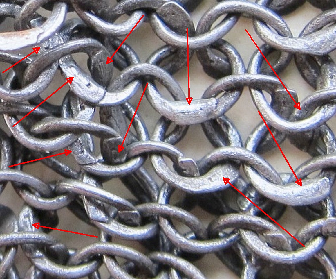

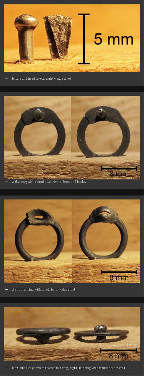

In order to understand European and Indo-Persian riveted mail, the methods of riveting the individual links together needs to be understood. BOTH sides of the mail needs to be seen / photographed as there are important clues as to the origin that can be learned by seeing the outer and inner side of the links.
In Europe somewere around the 13th to 14 th centuries, the age old method of using aternating rows of round riveted links and solid links started to change to a new method. Rivets made in a wedge / triangular shape started to be used. At first the wedge shaped rivets were substituted for the round shaped rivets but the solid links were still used.
At some point in time, possibly around the late 14th to early 15th centuries, European mail makers in increasing numbers started to leave out the solid links, they started to manufacture hauberks with all wedge riveted links. Eventually most if not all European riveted mail makers used this method right up until the last makers of European riveted mail hauberks went out of business.
Below is a graphic which shows the difference in looks between a wedge shaped rivet and a round rivet. You can see the riveted link profiles from both sides. The round rivet heads can be seen from protruding from BOTH sides of the link......while the wedge riveted links are smooth / flat on one side with only the tip of the wedge shaped rivet showing were it was peened over. The wide end of the wedge shaped rivet fits into a slit / slot punched into the link, it is not peened and eventually over time this side of the wedge riveted link can actually be burnished smooth leaving no trace of the rivet to be seen.

On European wedge riveted hauberks that were not heavily used the wide end of the wedge shaped rivet can be seen, here are some examples, you can see the back side of the links which would be worn up against the wearers clothing, the wide end of the wedge shaped rivet can be seen sitting in the slot that was punched into the link.

Now here is a European wedge riveted hauberk, probably around the 16th century, the red arrows show the front of the link, you can see that after many years of use the rivet head has been burnished smooth and is now just a bump, while the yellow arrows point to the wide end of the wedge shaped rivets on the inside of the link, they have been burnished smooth with no trace visible of the rivet showing.

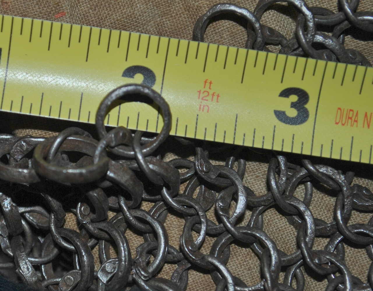

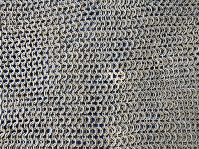

Now on to the typical Indo-Persian riveted mail which in the vast majority of examples will be made with alternating rows of solid links and round riveted links. The use of round rivets mades identifying most mail from India, Persian and the Ottoman Empire rather easy.
Since most European riveted mail was not made with round riveted links since around the 13th century to 14th centuries, if you encounter a riveted mail hauberk with round rivets you can be fairly sure that it is Indo-Persian. There are some examples that were not made using solid links but if they have round rivets then for the most part you can assume that it is Indo-Persian.
Until very recently it was assumed that if a hauberk was made with wedge rivets that it was automatically European but recent examples of some Indo-Persian riveted mail have been shown to be made with wedge rivets, some of these examples are in the Met museum collection. These examples have been attributed to Ottoman Circassian mail makers. The links of these are very uniform in size and shape and the overlap, which is the flattened area were the rivet goes through is very neat with no overhang. So no longer can one assume that any wedge riveted hauberk is European.

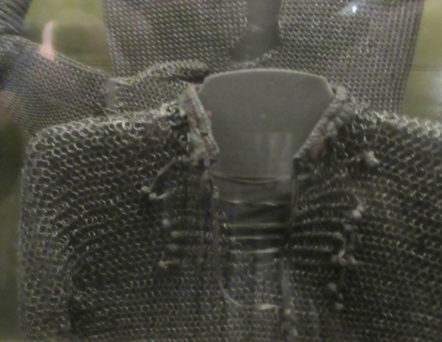

Below is an example of Ottoman 16th century round riveted mail, it is used to connect the steel plates of a cuirass together, these are typical Ottoman alternating solid and round riveted links. Both sides of the links are shown and you can clearly see the round rivet head on both sides of the riveted links. You can also see that the solid links are not perfectly round, they almost look faceted, this seems to be fairly common on Ottoman solid links from that time period unlike the Ottoman Circassian solid links which are round.
What you are seeing here is both sides of the steel plates and the attached mail. The red arrows show the round rivet heads, there are clearly visable on boths sides of the links, these links are over 500 years old and you can still see the details, you can also see the overlap on the links were the rivet goes through is quite flat and long. The solid links are shown with yellow arrows, they not round at all but have flat edges on the outside, I have no idea how they were formed.

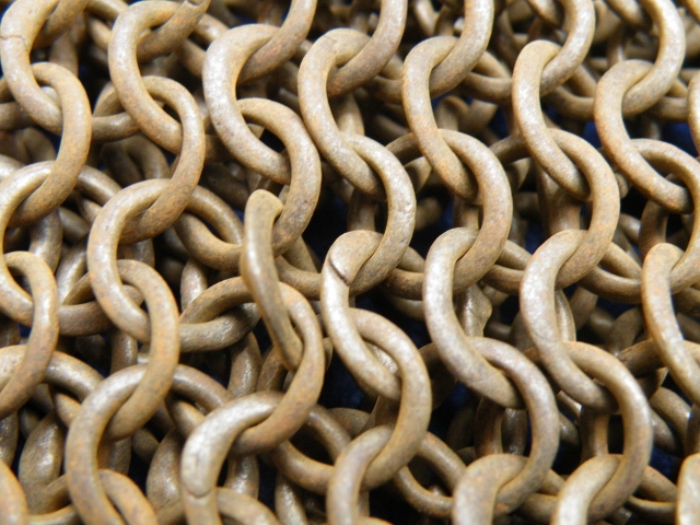

Here is a typical example of Indian round riveted mail, probably from around the 17th century. Again it is made from alternating rows of silod links and round riveted links. No need for colored arrows here, the round rivet head are clearly visible, while this shows only one side of the links I can attest that the other side is pretty much a mirror image.
Most Indian solid links are very easy to identify, as you can clearly see they are not make from round wire. In the past it was assumed that these were punched from sheet metal, but this is not the case, they are actually welded strips of sheet metal, recent photos show some of the welds delaminating, proving that they were not punched.

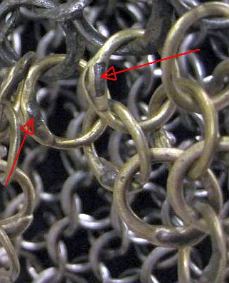

This photo is from a European wedge riveted hauberk which I believe is from around then 14th century, it shows a wedge shaped riveted link that has failed. The head of the rivet was not properly peened and it allowed the overlap to seperate.

This all goes back to Colins hauberk, with pictures showing both sides of the links we can probably figure out is it is round riveted or wedge riveted.

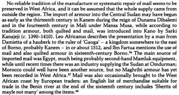

Iain, here is a reference to mail being exported to Africa from Eqypt and European sources.
Warfare & Diplomacy in Pre-colonial West Africa, Sydney Smith
Univ of Wisconsin Press, 1989.

? - colin posted pics in post no. 5 that appear to show round rivets.
Old 7th July 2016, 05:34 PM   #21
estcrh
estcrh's Avatar
Join Date: Jun 2012
Location: USA
Posts: 1,492

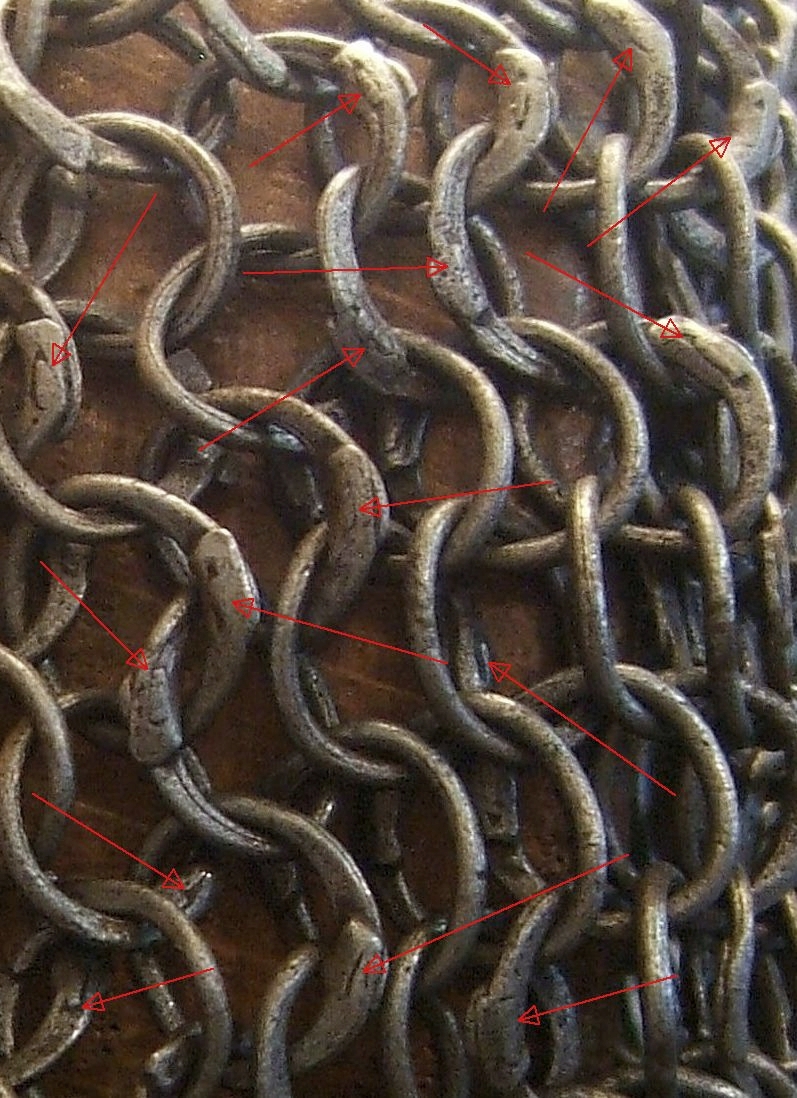

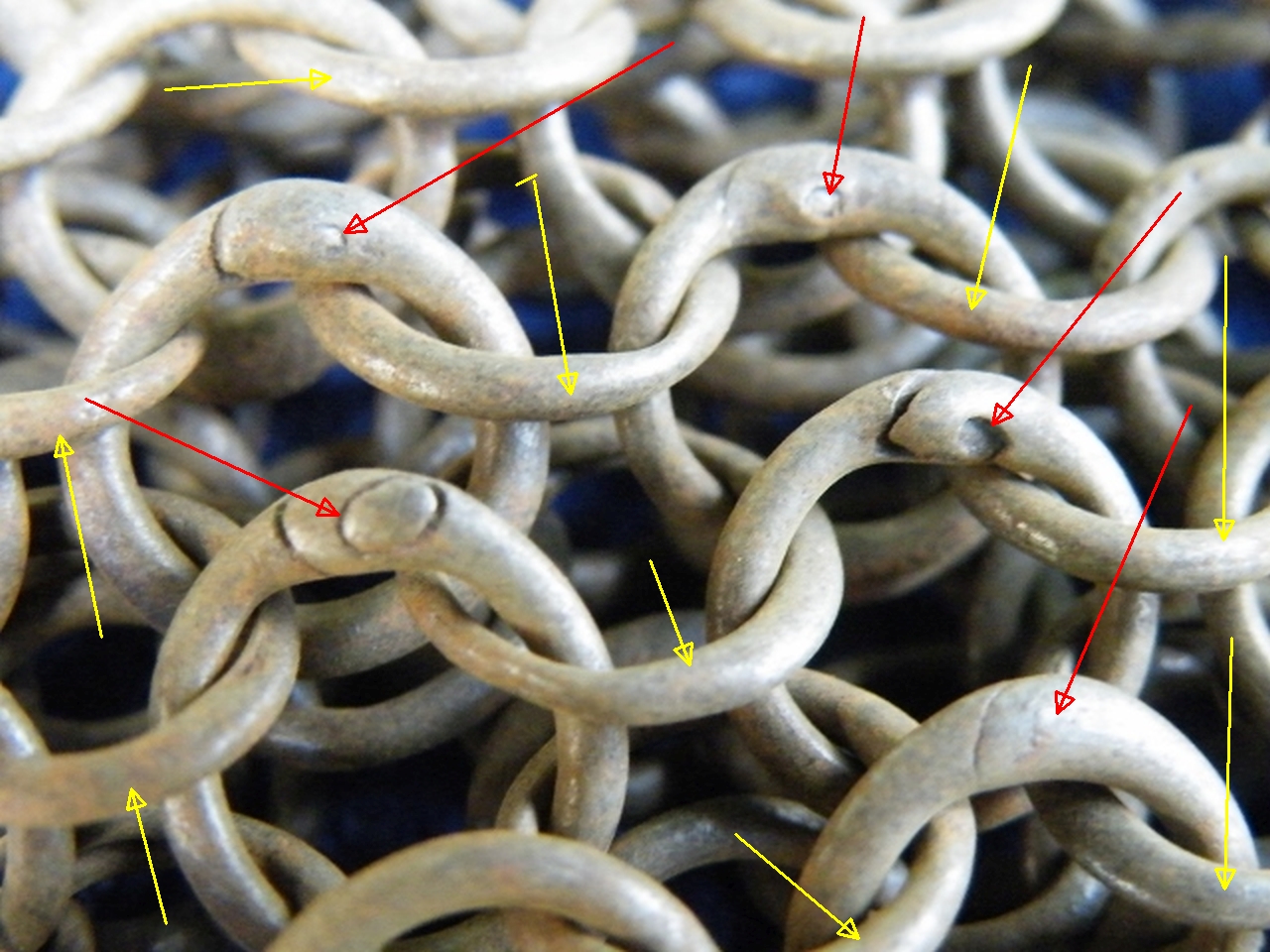

Actually Colin's image only shows one side of the riveted link. The rivet heads that are showing do not have the appearance of typical round rivet heads.
Usually there would be much more of a dome or mushroom shape from the rivet being peened. If these are round riveted there will be a corresponding round rivet head on the opposite side, if the links are wedge riveted the opposite side will be flat and no rivet head will be showing.
The red arrows point to the rivet heads, the yellow arrows point to the solid links. The rivet head here are just not formed well enough to determine if they are actually round riveted.
Take a look at the Ottoman and Indian round riveted examples I have provided and compare the rivet heads to Colins hauberk and you will see the difference.

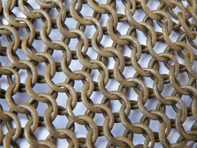

Old 12th July 2016, 03:24 PM   #24
colin henshaw
Join Date: Jan 2008
Posts: 1,435
Here are some more close-ups of the links taken from different areas. The first two images are from the inside of the hauberk, the rest from the outside. Perhaps it was turned inside out at one time ?
Old 12th July 2016, 05:21 PM   #25

Old 13th July 2016, 07:32 PM   #28
estcrh
estcrh's Avatar
Join Date: Jun 2012
Location: USA
Posts: 1,492
As you had asked for more images, I was hoping you would expand further on this topic...
Here is an image of the front and back of the links next to each other, from the information I provided someone should be able to determine if this hauberk is round riveted or wedge riveted......
