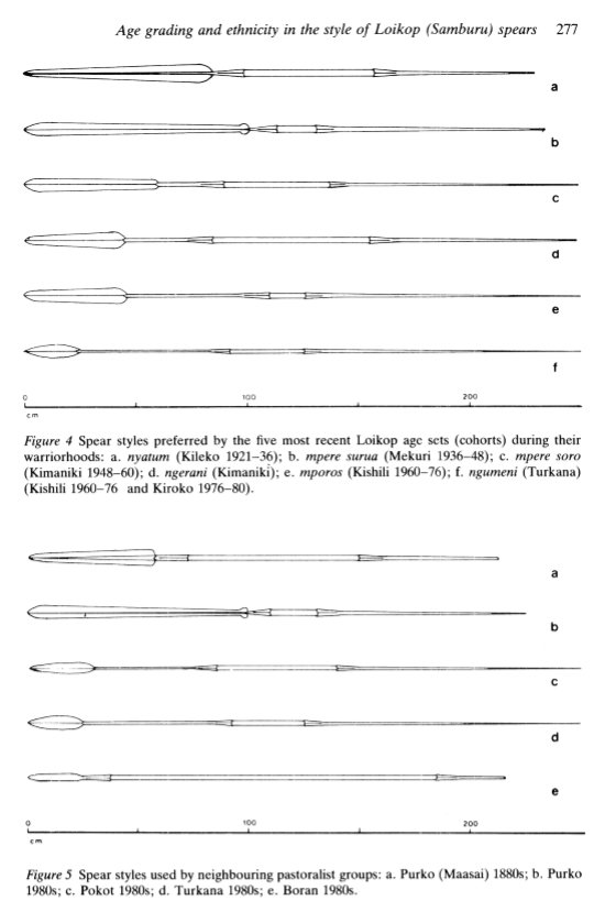

in 'Age grading and ethnicity in the style of Loikop (Samburu) spears' by Roy Larick (1986) it corresponds to the turkana style favoured by some senior warriors.

an excerpt from the ref. i listed earlier:

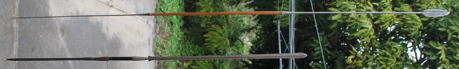

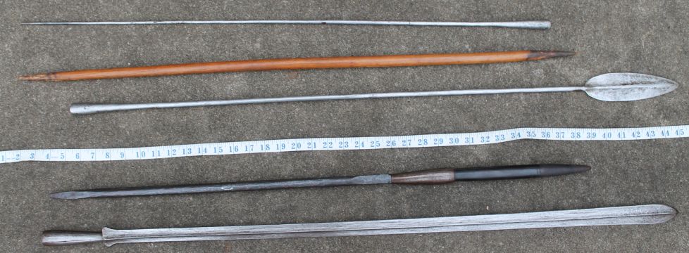

Here is my one of these, and my lion spear.
In the assembled photo, the clothesline they're leaning on is about 170cm/5'8" high.

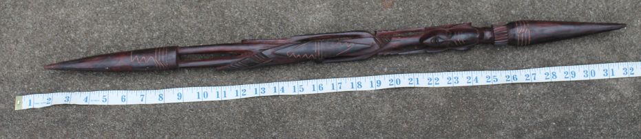

And because I was talking about them, the middle section of an ornamental spear. Despite the large size of the wooden section, the head and tail were quite petite (they're probably in my magic box of spear parts, which I can't easily reach at the moment).
