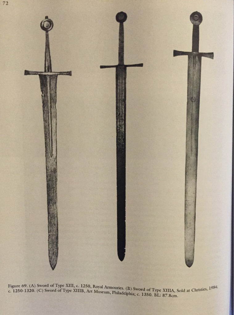

Oakeshott type XIIIa sold at christies 1984.

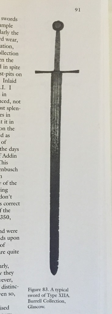

This sword is illustrated in “sword in hand” as a type 13a fig 69 and the same fig 83 as a type XIIA .
It seems to be the same sword.
May be somebody has explanation for it and also may be better pictures from both swords.

Well, clearly the same sword. I did not see it pictured in the Christie's London 1984 catalogs upon quick perusal. Sword in Hand was a nicely cleaned up version of a series of articles in The Gun Report that represented an updating of material from The Archaeology of Weapons. Looking at the original magazine the caption for what becomes fig. 83 is "A typical sword of Type XIIIA"; the next illustration of another sword gives the Burrell collection attribution in both versions (magazine and book). The same sword shows up again in Records (XIIIa 12) as "Collection: Private".

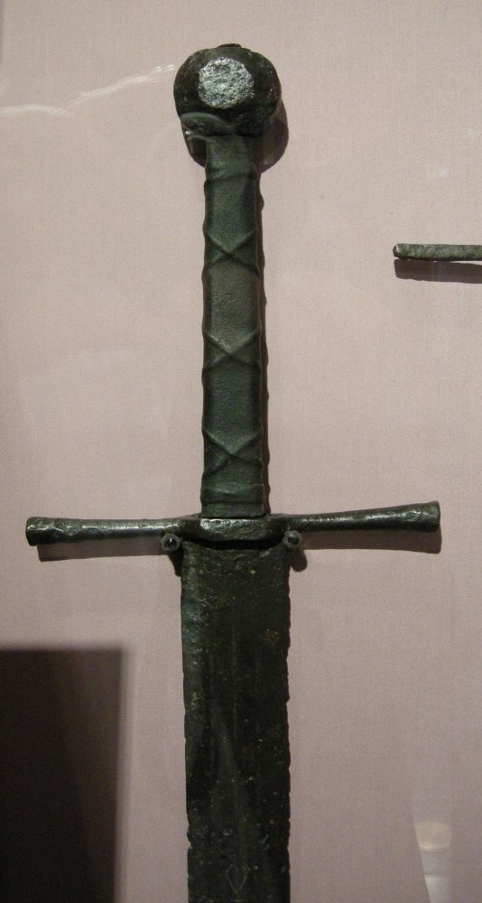

This particular sword came up for auction a few years ago, and I believe it has made its way into the collection of a fellow forum member. The photo is from the recent exhibition in Solingen.
The lot number is 119; as it happens, lot 120 is also shown in Sword in Hand as fig. 14.

Description from Thomas Del Mar sale (9 Dec 2009):[/I]
A COMPOSITE MEDIEVAL GREAT SWORD, CIRCA 1270-1320
in excavated condition, with broad flat near parallel-edged blade tapering to a blunt point, formed with a pair of fullers over almost half of its length and cut with a latten-filled heart and cross mark on each side (the latten with losses), iron hilt comprising a pair of 16th century straight tapering quillons of circular section, and slightly compressed wheel pommel, and later fabric-bound grip
98cm; 38 1/2in blade
Provenance
Christie, Manson & Woods, 20th July 1983, lot 27[I]
Not described as 'composite' in the 1983 catalog or in the Sword - Form and Thought catalog where it is #18 and passes Peter Johnsson's proportional measurements.
So the attribution to Burrell Collection was a typo and the sale date was a year earlier.

Jean-Luc,
as you probably know, the sword is in my collection, I think I already posted a thread about this sword! please look under threads cornelistromp.
what do you exactly want to know?
best,
jasper
ps it was on loan to the Klingenmuseum in Solingen last year.
ah here is my thread from 2009;
http://www.vikingsword.com/vb/showthread.php?t=11231
