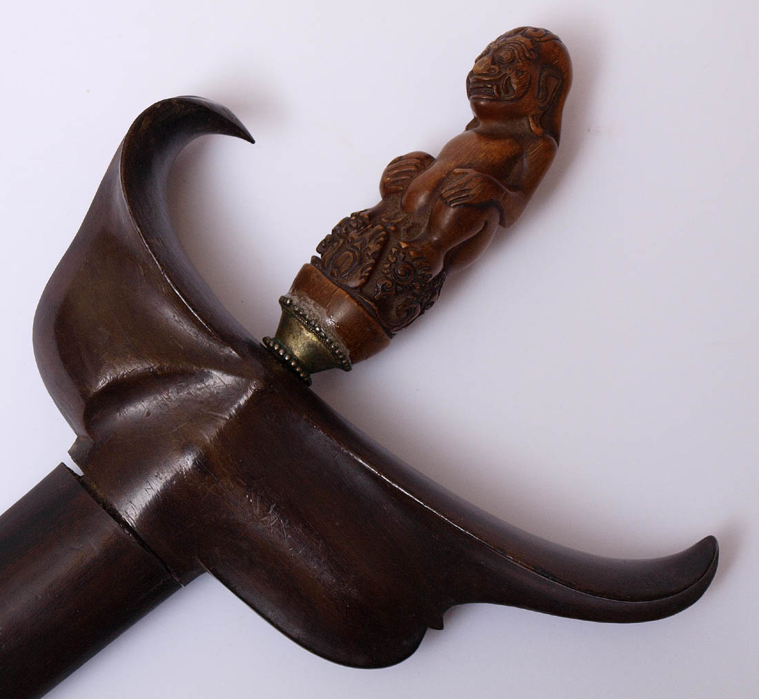

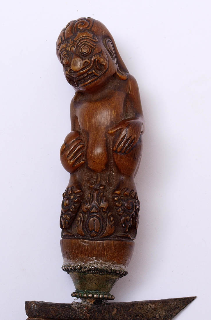

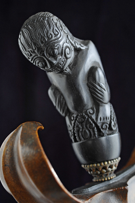

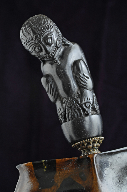

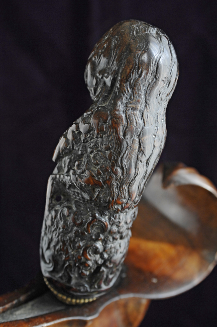

This week a hilt was auctioned, possibly made from rhino horn, and possibly from 17th cent. There are only 3 figural 16th/17th cent. horn hilts from european collections shown in Jensens Krisdisk - in Vienna (which is rhino for sure), Firenze, Dresden, so they are more rare then similar ivory hilts.
Two pictures of it for posterity.

I can't speak for sure to either the age nor material of this piece (though it doesn't have quite the wear and patina that i would expect from a 17th century hilt), but it is indeed lovely. I do hope that whoever won this auction has the wherewithal to undo the mad glue-man's atrocious and sloppy adhesive mischief.

Regarding wear, the most sensitive place on these hilts is the nose, and here it is very similar to some wooden specimens from Krisdisk.

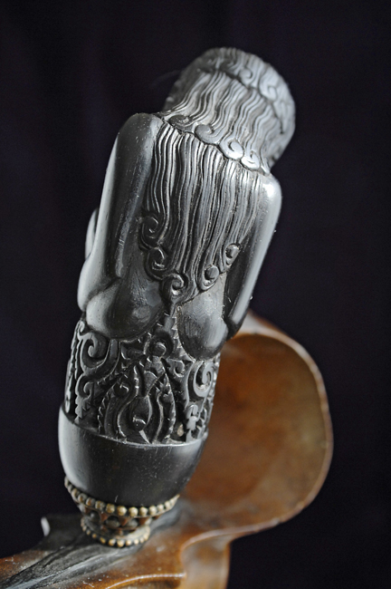

Old 17th April 2016, 09:09 AM   #4
Hello Gustav,
I've followed the auction as well and think like you that the hilt is carved from rhino horn and think that we are not the only ones by the reached price. And I am also sure that the hilt have a very good age. Are you the winner of the auction? If so, good luck for removing the glue.
Actually, from my experience the place on these buta hilts that tend to receive the most amount of wear is along the backside as this is the area most often positioned into the palm of the hand when holding the hilt. You can see the extensive wear in this very old example from my collection below.
Of course we can only use wear as guide to age in a very approximate fashion and in the end it all depends on how much any particular piece has been handled in its lifetime. If it was collected early in its life and taken out of daily use it could still be old and not show as much wear. But it is really impossible to tell one way or the other, isn't it? I don't see any particular indicators in the style of this buta hilt that would definitively place it in the 17th century. Carvers have been producing this right up into the 20th century, though perhaps not in rhino horn. I can see why you suspect it might be rhino, but for me at least, i would not say that a definitive conclusion could be reached on that assessment based solely on these two photographs. It's a shame we don't have more detailed shots, especially a good close-up looking down on the grain from the top. Otherwise i think we are only guessing at this material. Hopefully, if the auction price went high on this piece as , the winner's gamble was rewarded.
QUOTE]
David, I have studied the kerisses and their hilts from old Kunstkammer collections for some years now, have visited many museum magazines in the last years and have seen and handled most of them. We have a very limited amount of pre-1700 hilts, perhaps less then a percent of figural hilts ever made let's say from 1500 to 1670, so each of them is singular and has sometimes quite unexpected features. Nevertheless, there are some indicators, which are typical for early figural hilts and doesn't appear on later Pasisir figural hilts, and this particular hilt has many of them. One of the keys is the symbolism within the Tumpal, and the state of development of the reversed Tumpal under the feet of the figure. Also modern replicas of these hilts mostly fail in reproduction of one very important feature.
Please take a close look at Chapter Banten in Krisdisk (attention to the noses, when a hilt is depicted en profile )
Old 18th April 2016, 02:12 AM   #7
Posts: 7,259
In Jawa people tend to regard wear to the back of the head as a sure sign of age in a figural hilt, and the corresponding part of other hilts is normally the place they look at if trying to guess at age of a hilt.
I tend to agree with this, but I also recognise that protruding parts of a figural hilt face do mostly show wear on older hilts.
As to material, yes, it might be rhino horn --- it does look like it in the photo --- but I've seen this same sort of grained surface in hilts that were taken as kerbau (water buffalo) horn, ones that were old and dried out. I might even have an example at home, I'll see if I can find one in a couple of weeks.
Gustav, could you please expand on the these comments in your post #6 :-
1) there are some indicators, which are typical for early figural hilts and doesn't appear on later Pasisir figural hilts, and this particular hilt has many of them
2) One of the keys is the symbolism within the Tumpal, and the state of development of the reversed Tumpal under the feet of the figure
3) Also modern replicas of these hilts mostly fail in reproduction of one very important feature

I agree that the materials look like rhino horn but it should be confirmed in the hand.
Regarding the indicators mentioned by Gustav differentating this hilt from the modern ones, I see 4 of them:
. The shape of the worn-out nose with distinct nostrils.
. The earlobes (or earrings) have a different shape than on the modern hilts.
. The small carving above the tumpal motif on the front depicts the male organs according to Jensen.
. The carving at the base of the tumpal motif depicts the female organ according to Jensen.
Accordingly I believe that this hilt is very old.

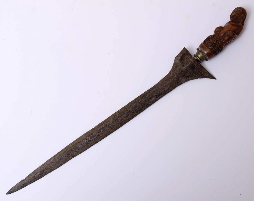

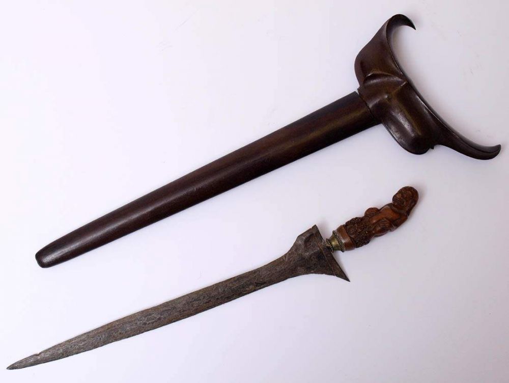

Today I received an e-mail with four pictures.

Jean, I would be extremely reluctant to identify the form of the nose, or of the ears, or of any other part of this hilt as indicative of age.
Why?
Because current era carvings of this hilt form are, in general, copies of earlier hilts, sometimes fragmented earlier hilts, but those earlier hilts themselves were again copies of hilts that came down from a previous time.
The cheap modern productions that we generally see are turned out like Bali art carvings, but the high quality hilts made by m'ranggis use patterns and models that have been in the craftsman's family for generations. Certainly, these vary, but they vary in accordance with what one m'ranngi's family carves, as opposed to what another family carves.
Yes, the an acceptable reading of the abstraction between the figure's knees is of his reproductive organs, however, we must never forget that we are dealing with a society that is based upon death and renewal, so the way in which this symbolism is read can often be a little bit too simplistic.
When we consider the tumpal it is important to understand that an upright tumpal is representative of the gunungan and all associated icons, and also of the male element. The inverted tumpal is symbolic of the female element. The small yoni inserted in the base of the tumpal completes the Hindu-Javanese iconography of the Lingga-Yoni.
There are a number of ways that this symbolism can be interpreted, but it is perhaps sufficient to recognise that it is representive of Siwa's Shakti, Siwa himself being represented by the gunungan.
As a complete entity of lingga-yoni we have the symbolism of continual renewal --- plus a whole heap of other symbols.
What I've written above is all well known, nothing new or special there, but Gustav's words intrigued me, so I eagerly await his response.

Folks, we have been through this already several times: From the pics supplied so far, there is no chance whatsoever to verify wether this hilt is made from rhino or waterbuffalo horn! We really need a close-up of a cross-section of the fibers, i. e. the top of the head or possibly the base of the hilt also.
We can argue about likelihoods but this never positively prooves anything for any given piece. Actually, the current pics make me feel albino water buffalo - I agree that the alternative is also plausible though...
Thanks a lot for those pics, Gustav! Could you please try to get additional ones? I also wouldn't mind better quality pics of the other parts of this keris...

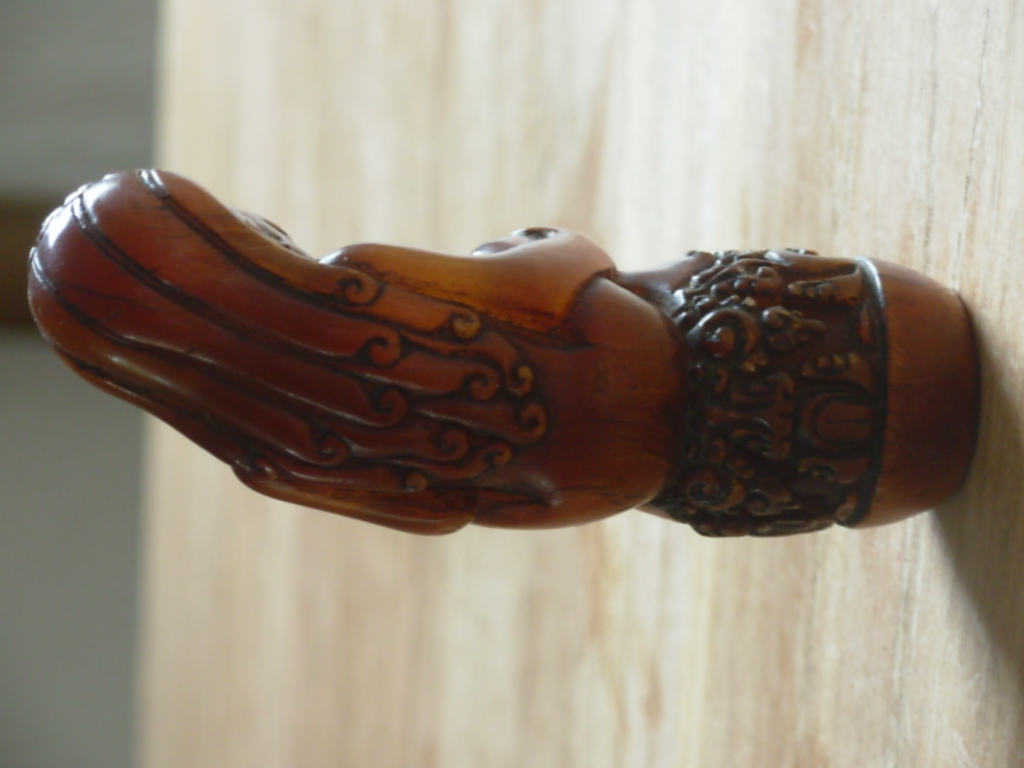

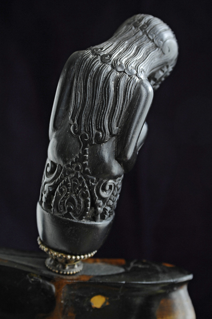

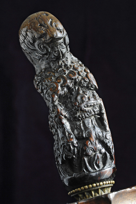

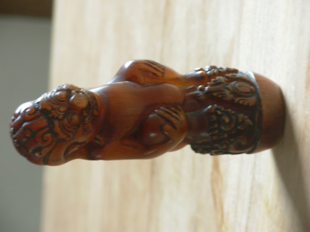

Kai, here are a couple of examples which i am sure have been carved within the last 100 years. To my eye you can still see aspects of the lingam/yoni symbolism in the tumpals carved here.
I am also including a front shot of the older example i showed earlier for a comparison of the tumpals used there. I am uncertain of the actual age of this hilt.

Jean, i have both white and green buffalo horn that is also translucent. I don't believe we can use that as an indicator of rhino horn. Again, i am not trying to argue that this cannot be rhino, simple that we do not have the type of photographs yet that can provide any definitive answer to that question.

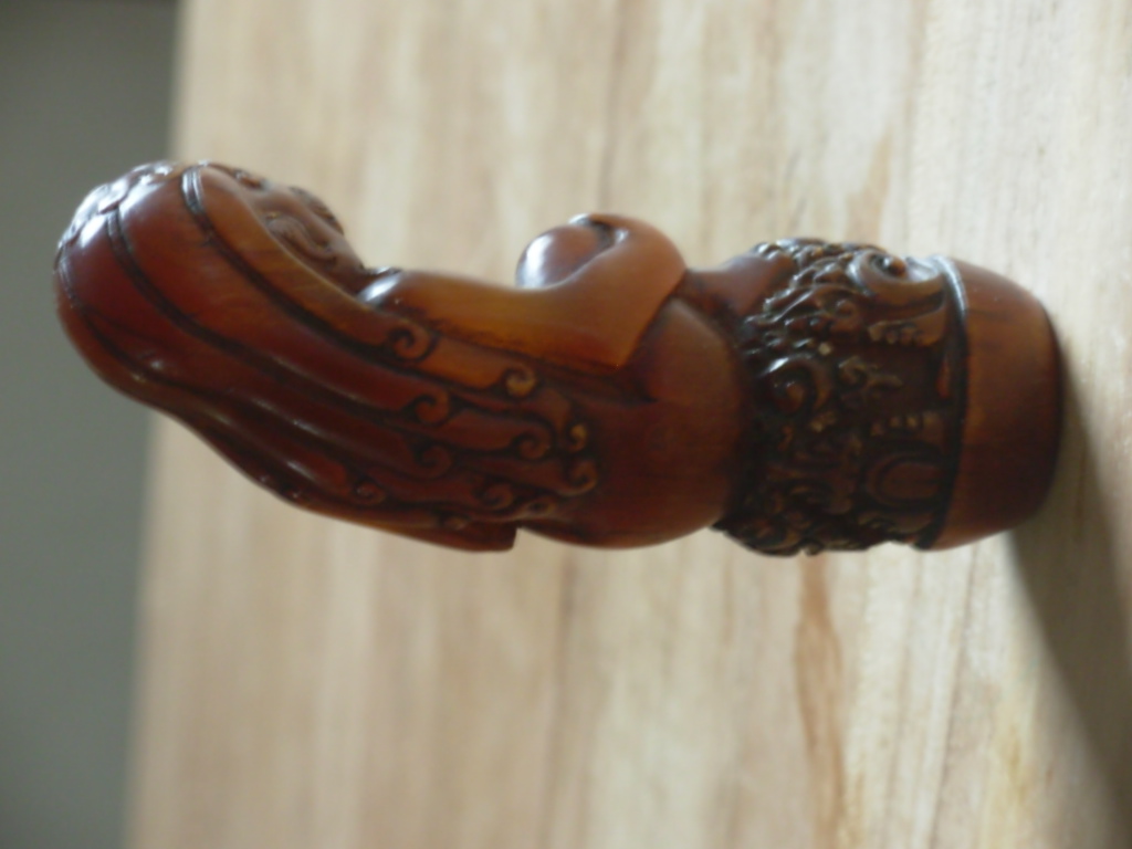

Hello Kai,
here two more pictures from the auction.
Old 18th April 2016, 08:54 PM   #17
Hello Detlef,
Thanks! I was hoping for additional pics, better resolution (despite the auction pics being better than from many auction houses), from other angles, or after cleaning/warangan since Gustav may have the opportunity...
Hello David and Kai,
Could you please show us a hilt made from white or green buffalo horn and having a similar color to the one shown by Gustav?

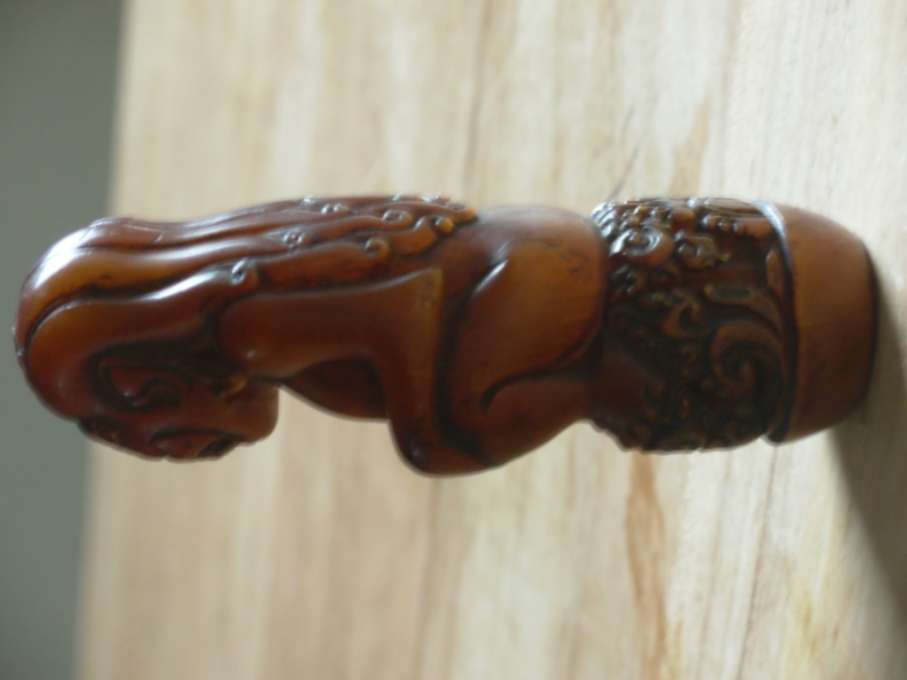

Hello Jean,
Sorry for the brisk comment. A search on the main forum will yield a bunch of threads covering the identification of horn.
Here some examples from albino water buffalo:
(The greenish variants tend to be a bit darker, of course.)
Yes, these 2 do qualify as modern. Very similar workmanship, indeed.
While it is evident that these are offspring of the old style hilts, it's not about the similarity (nor quality of workmanship) but rather differences in detail.
Thanks, a really nice one! This "man in green" style makes it even more difficult to place (and the wear doesn't help either to discern details).
We need close-ups from all sides of this hilt for analysis. It might be older than you think...
Well, i only posted these hilts because Gustav seemed to be implying that the lingam/yoni symbolism is not to be found in the tumpal of "modern" versions of these hilts. While stylized i maintain that symbolism is indeed present in these examples. I have seen many other more modern versions where it is not.
I don't really want to detract from this thread too much by posting a series of images of this hilt. While worn it does seem to also incorporate the lingam/yoni into the tumpal. However, i have posted all sides of it before so you can check this thread out if you want a closer look. I am aware that it is pretty old.

Perhaps we (because it should be a discussion between many people in the ideal case) should start with the typical ornaments found on Bungkul of 16th/17th cent. hilts depicting naked figures of what is commonly called demonic character. These are my observations, I will try to be as exact as possible:
There are four upright triangular elements, dominating in size. The forward and the rear are mostly nearly identical to each other, as are the right and left ones.
The forward and rear consist of an elongated oval mirror, which sometimes is further partitioned, like on the initial hilt of this thread. There are tendrils on both sides of this mirror and above. So these two triangular elements are symmetrical in themselves.
The right and the left consist mostly of an bigger scroll (which in its size dominates the triangular element like the mirror the other pair). The second one, curving to the opposite direction is placed beside, sometimes the place for it is to small and it stays underdeveloped. From the top of the bigger scroll another smaller one in opposite direction is spouting/growing. So these "side triangles" are perhaps symmetrical in thought, yet not in the execution.
Above/between the upright triangles smaller downright ones are placed, and these consist mostly of tendrils with one more prominent scroll often more clearly distinguishable.
In the deep cuts between the upright and downright triangular elements sometimes more clearly the four edges of a cubic structure are visible.
This is the standard situation, which may slightly vary from hilt to hilt.
Now to the possible symbolic content of these features, at first the forward and rear triangles. This is the part, where I can only speculate and list the possibilities I am aware of.
The upright triangle as form could be expression of Gunungan and/or Kalpataru (the divine three). If together with the oval mirror in it, the range of interpretations widens. Then it could depict a Lotus plant with the blossom in the middle, which as whole can sometimes also be seen as a substitute for the divine tree. Important - Lotus as the base of a figure - the earliest clear depiction of a Mendak is a Lotus (on statue of Bhima/Kertolo in Museum Nasional). Lotus symbolizes the purity of divine descent, symbol of creativity and fertility, which leads to the understanding of the blossom (oval mirror) as Yoni and depiction as female genitals (the male genitals are that of the naked figure, they are placed exactly over the mirror. They sometimes have distinguishable Palang balls and do clearly belong to the shivaitic context. If you wish - when Keris is held in the hand, the Lingga is in the upright position pointing to Yoni (activated so to speak)). One more symbolic layer for the mirror is that of depiction of a Bintulu. Bintulu are often found at the base of East Javanese bronze figures, and have protective function. This all was always more or less clear.
Now to the right and left upright triangles. There are two possibilities:
1) the main element could be the bigger scrolll/tendril (which in size corresponds to the oval mirror)
2) we have the same three branches composition, which is distorted by the legs of the naked figure and becomes asymmetrical.
My thoughts to the first possibility: upright or downright scrolls are often prominent in gateways (Naga Temple in Blitar, 14th cent. or even more appropriate, gateway of mosque in Sendang Duwur, 16th cent.), and the source of this feature most probably is Makara. Together with the oval mirror in the middle of them, interpreted as Bintulu, it could be understand as a repercussion of Kala-Bintulu arch found at gateways of temples (and even schematically depicted on earliest Sunggingans as framing of water sources).
The second possibility - there is a depiction of the divine tree in van der Hoop, plate CXXXI. This is an asymmetrical Cirebon interpretation, and is quite close in general style to the triangles in question.
Well, time to sleep. It will be continued.
