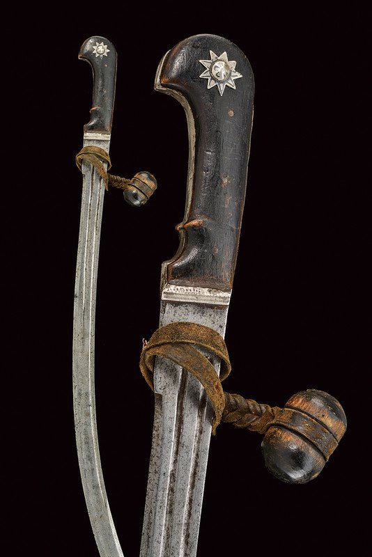

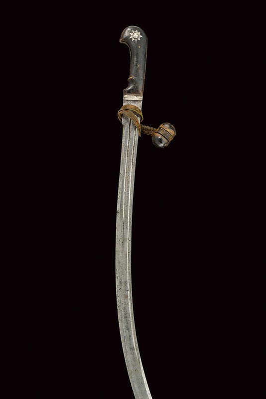

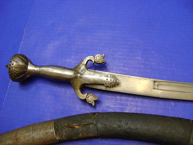

From Czerny's auction. Ended not sold.
Wooden grips, nielloed fitting on the eared pommel, "indian" ricasso, fullers resemble Afghan work.
I am lost...
Where from, how old?

My bet is Central Asia, Bukhara or thereabouts!

I also think it is Indian/Afghani.

The point of the blade reminds me of some pulwar I have seen.
A shasqua
dating: circa 1900
Strong, single-and false-edged blade with double groove and tang; grip featuring wooden grip scales and silver, partially carved and nielloed mounts. The sword knot shaped as a wooden barrel.
Provenance: Provenance: Caucasia
Dimensions: dimensions: length 97 cm.

Old 28th March 2016, 03:27 PM   #6
David,
I do not think so.
Yours is a classical "Bukharan" saber of a shashka-like form with 5 rivets ( we discussed them already).
The one from Czerny's is a totally different animal, IMHO. Much closed to the Afghani "pseudo-shashka".
P.S.
A friend of mine from Belarus sent me pics of that sword published on another auction. Here we can see the upper part of the blade with the "box-like" system of fullers.
AFAIK, this is very typical of Afghani blades.

It is rare, but not completely uncommon for Afghan blades to have traveled West. Here is an example of such a blade, with a shashka hilt, in clearly Ottoman scabbard:

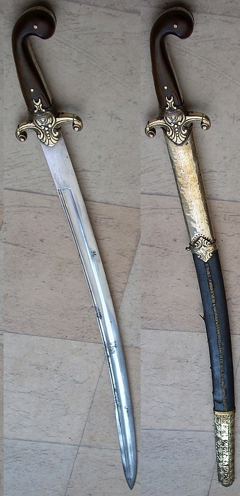

Gentlemen,
Here is an Afghani Pulwar with identical fullering.
I checked Askhabov, Astvatsaturyan and Rivkin's books as well as my own Caucasian Shashkas and there are no similar examples.
Moreover, look at the handle: the "cheeks" are separated by wide distance covered with a strap. This is absolutely incompatible with Caucasian examples, but identical to Afghani pesh kabzes, chooras and pseudo-shashkas.
The only strange thing is the "dimple" next to the bolster for the index finger and ( perhaps) rather short pommel.
But the more I look at it, the stronger I feel for the Afghani origin.
Old 28th March 2016, 07:57 PM   #9
Teodor,
I re-read your topic re. Afghani blade in Caucasian mounts.
I guess there might be examples of Afghani blades traveling West. Caucasian mercenaries ( Georgians, Armenians and Circassians) constituted the backbone of Shah Abbas' cavalry and fought in Afghanistan and India. There is a sword in the Hermitage collection consisting of a Khanda blade and Georgian handle.
But the construction of the handle on the Czerny's example absolutely excludes Gaucasian origin and is strongly tilted toward Afghanistan.
Old 28th March 2016, 08:09 PM   #10
Posts: 10,862
I must admit , especially with Ariel not having an exact bead on this thing, that it is quite subtly an anomaly which seems to fall between the cracks on many counts.
Between his knowledge on the weaponry of these regions and the sources he notes not able to define it, any precise classification seems unlikely.
I do agree however that this does seem N. Indian, that is from Afghan regions, and the expected hybridization which comes from these and Central Asian areas.
While of course the hilt is fashioned to look like a shashka, the structure is quite different. The distinctive 'cleft' is achieved by using what appears to be a metal block 'sandwiched' between the grip plates and clearly profiled to match that curious forefinger nock at the base of the grips.
There is no metal bolster at the base of the grip as known to be typical on the 'pseudo-shashkas' of Afghanistan, and while this has the 'feel' it does not correspond to typical Bukharen sabres (as posted by David), which indeed 'usually' have five grip rivets.
The blade as well pointed out, does seem remarkably similar to similar seen on other Afghan swords. That blockish fuller type effect seems to recall some of the Persian trade blades, which I have seen with a kind of wrap around fuller near the forte.
One feature not yet addressed is the curious starburst device on the pommel area of the grip, and if memory serves, that resembles something like this in Kubachi type embossed silver hilts and in that same hilt location. I cannot yet find images, but it does seem that such devices were often placed on Caucasian (usually Daghestani) hilts with some award or other significance.
What makes that so intriguing is that here is a distinct Caucasian affectation added to a hilt designed to approximate a Caucasian shashka, with a clearly N.Indian/Afghan blade( the ricasso), but the entire assembly is constructed quite unlike the various forms mentioned overall.

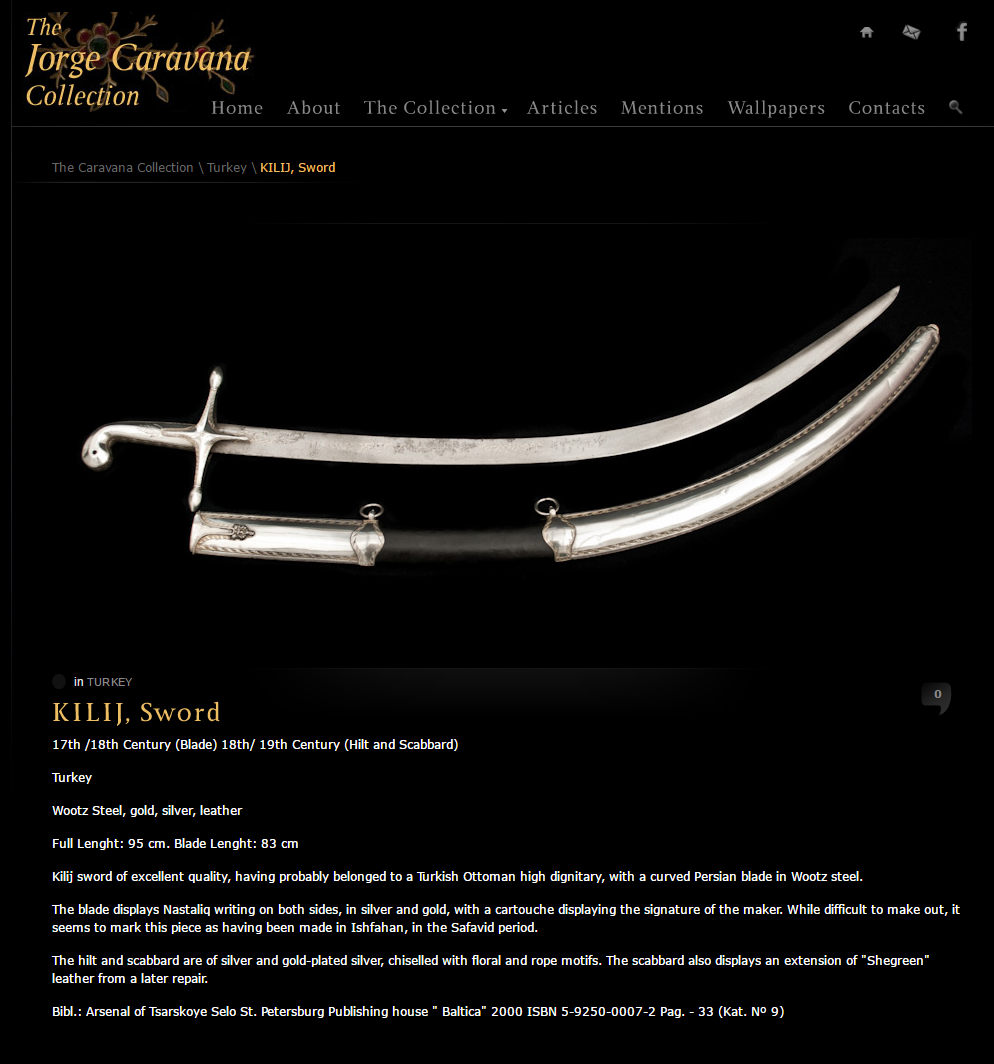

Originally Posted by estcrh
It depends, Ottoman kilij can have many types of blades and still be recognizable.

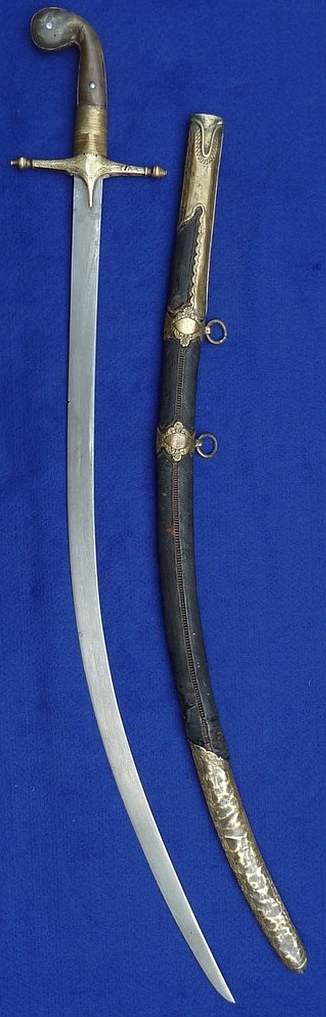

This is true. the last sword I'd call Ottoman shamshir, not because of Kilij type hilt but because of shamshir type blade

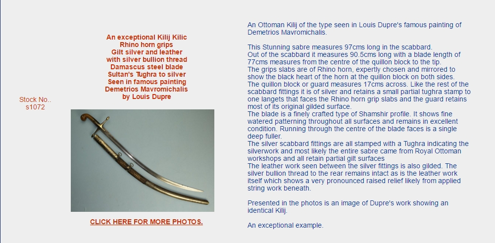

Both terms would be correct, it is an Ottoman kilij and Ottoman shamshir.
The pulwar is another example, they can have several different blade types but the hilt identifies them.
I beg to differ.
I have seen many authors making the very same confusion and identifying a sword exclusively by its hilt.
And yes, the hilt can be used for defining/identifying a sword, but when the blade is not very characteristic and cannot be identified as such.
In this case, the Ottoman Kilij is characterized primarily by the presence of the yelman and in lesser measure by the reinforced T-shaped spine extending along about two thirds of the blade and the fuller which the Shamshir lacks. Also the archetypal Kilij has a specific shape with a very shallow curvature (or no curvature at all) for the portion of the blade near the hilt, and a very deep curvature closer to the tip like the one in your second photo.
Of course there are blades that display mixed characteristics (as you may encounter "Shamshirs" having fullers or even an yelman) and cannot be accurately identified. In such cases allocating a specific name other than the generic terms of "sword" or "sabre" would be rather inaccurate and misleading, but it is not the case with the Ottoman Shamshir in your photo.
If however, you are Turkish, then the term Kilij (more accurately Kilic) will become also accurate, but only for you, because in Turkish, Kilic, literally means sword... any sword. But then, in the same line of thought, you would be correct calling "Kilic" even a Japanese Katana or an Italian Rapier.

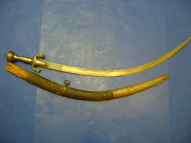

There was a special term for Turkish sabers with pistol handles and shamshir blades: kilij ajemi .
The terminal "c" in some European versions of transcribing Turkish word "kilij" in fact much have a diacritical mark, indicating its pronunciation as "ch" or "dzh" . Correctly, it is Ç. Thus, Kilich, KiliÇ and kilij are the same word with identical pronunciation but different Latin letters used.
Sometimes it is simply difficult to phonetize foreign sounds precisely: Russian X is Kh, and Щ in English uses 4 letters: SHCH. Thus, Khrushchev:-) And what is correct: Czar or Tsar? Woody Allen pondered on it once and New York Times crosswords treacherously use both spellings to frustrate you. Bastards that they are:-)))

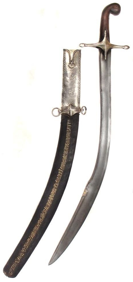

Old 30th March 2016, 12:39 PM   #24
ALEX
ALEX's Avatar
Posts: 936
... Kilij has come to mean any Ottoman pistol grip sword whether it has a yelman or not, straight blade or highly curved blade, T spine or shamshir blade etc...
I do not know how this came about. surely, some collectors have their ways and terminology "preferences", but traditionally, Kilij signifies the blade with yelman, not any blade with pistol grip. There are Indian blades with yelman and tulwar-type hilts that can be called Kilij-type blades because of specific blade profile, regardless of the grip. Likewise, there are Kilijes with other, not pistol hilt types. It is profile of the blade that makes it a Kilij to begin with.
Old 30th March 2016, 12:43 PM   #25
estcrh
estcrh's Avatar
Join Date: Jun 2012
Location: USA
Posts: 1,492
Alex, according to who?
Old 30th March 2016, 12:47 PM   #26
ALEX
ALEX's Avatar
Posts: 936
about every knowledgeable collector i know, and all decent books I read.
They all could be wrong, of course. Please substantiate your argument.
By the way, in Oriental Arms sample above, it states "shamshir blade in Turkish fittings". The Kilij/Shamshir title may refer to "Kilij" as a word for sword in Turkish language, as in other similar descriptions. but I have not seen anything saying any blade with pistol grip is a Kilij.
We had similar argument before about "Saif" as any sword with Arab hilt
Word Saif means sword in Arabic, just as Kilij is sword in Turkish. What this has to do with the hilt type?
Old 30th March 2016, 12:56 PM   #27
estcrh
estcrh's Avatar
Join Date: Jun 2012
Location: USA
Posts: 1,492
http://www.swordsantiqueweapons.com/s1072_full.html
Old 30th March 2016, 01:07 PM   #28
ALEX
ALEX's Avatar
Posts: 936
Good, this is a Turkish\Ottoman shamshir that someone called Kilij. Do you have more reliable references, not on-line ads?
Old 30th March 2016, 01:11 PM   #29
estcrh
estcrh's Avatar
Join Date: Jun 2012
Location: USA
Posts: 1,492
Alex you call it what you want, other people will do the same.
Old 30th March 2016, 01:24 PM   #30
mariusgmioc
mariusgmioc's Avatar
Location: Austria
Posts: 1,918
This is a perfect example of the same confusion. Even the one who wrote the description concedes this is a Persian blade, yet he identifies it EXCLUSIVELY by its hilt.
If this line of thougt is correct, then whatever sword bears a characteristic Indian disc-shaped pommel, is a Tulwar (see for example lots 1, 2, 4-11 of Czerny's last auction; pay spacial attention to lots 7, 8 and 11).
www.czernys.com/auctions_view.php?asta=57
