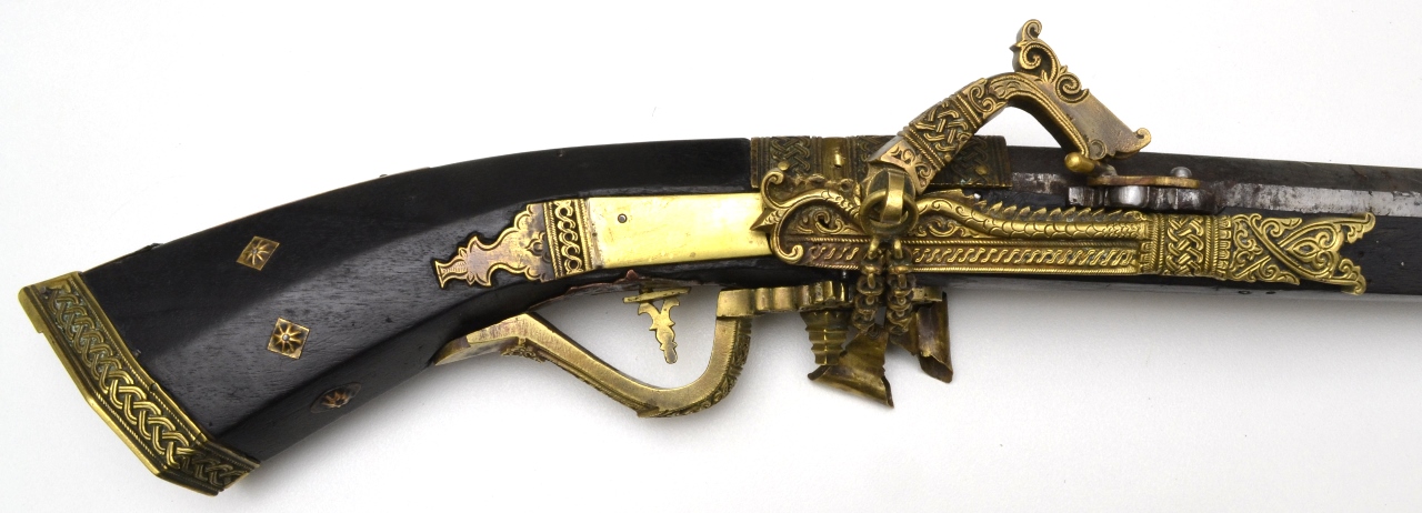

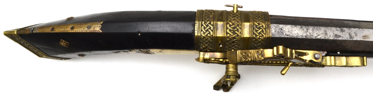

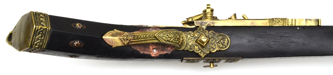

Hi Guys
I am far from a gun expert and I need to give a brief and hopefully interesting talk on this Malaysian matchlock. I am hoping someone out there might be able to help me. I believe this gun is a Matchlock musket (satinggar espingarda) with snapping lock, Malaysian, 18th century. It has a plain Octagonal Barrel, polished blackwood stock, lock and mountings of heavy chased brass and appears to emulate the Japanese Teppo.
References:
George Cameron Stone, A Glossary Of The Construction, Decoration and Use of Arms and Armor.1934, p. 264, fig. 326.
Robert Elgood, Firearms Of The Islamic World...,1995. pp. 188-189, fig. 129
I did find a vague reference to these guns being used by the Portuguese to repel the attacks from the locals, which I have been unable to explore further. Also if anyone can tell me what the two dangling things are hanging from the lock I would be most grateful.
Essentially any additional details that can be provided to jazz up the description and story behind this gun will be most welcome.
Cheers Cathey and Rex

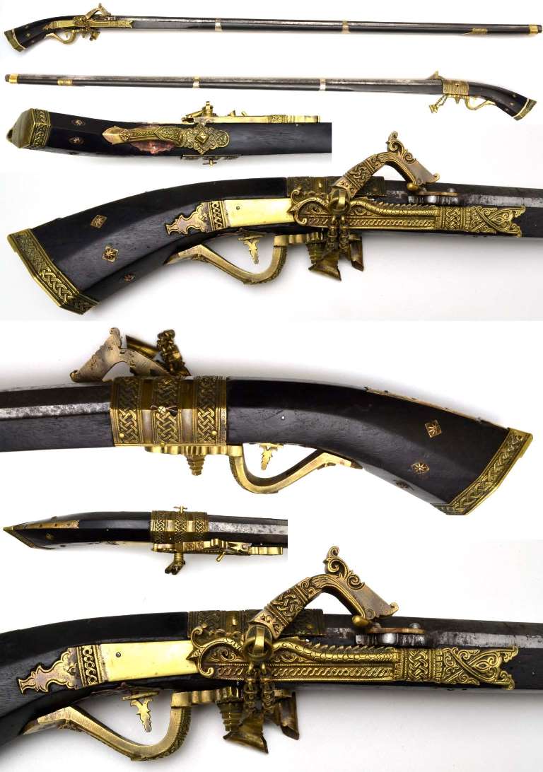

Cathey, beautiful gun and fantastic pictures, here is a link to a thread discussing a similar matchlock, you should use the forum search function, you may find additional information, as for the chain and its use take a look at the image I posted below, the small tubes attached to the chain seem to be for holding the match cord.
Can you tell us more about the type of audience that you will be speaking to?
The Malaysian matchlock along with the Japanese, Vietnamese and a few other Asian matchlocks are "snap matchlocks", which means that the serpentine (the curved lever which holds the smoldering matchcord) locks in place when pulled back and it is released when the trigger is pulled, the smoldering matchcord touches the primer pan which ignites the powder charge which in turn ignites the powder in the barrel.
Matchlocks from India, the Ottoman empire etc used a different lock in which the serpentine fell foward when the trigger was pulled and went back into an upright position when the trigger was released.
The snap matchlock used in Asia is said to be based on Portuguese models produced in their colony at Goa India. The snap matchlock was originally a European model that was brought to Goa by European gun makers working in India. The Portuguese introduced these guns to Japan around 1543, I am not sure when they were first introduced to Malaysia. (Forum members please correct any wrong info or add additional info!!)
http://www.vikingsword.com/vb/showthread.php?t=20873

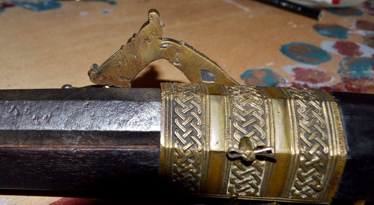

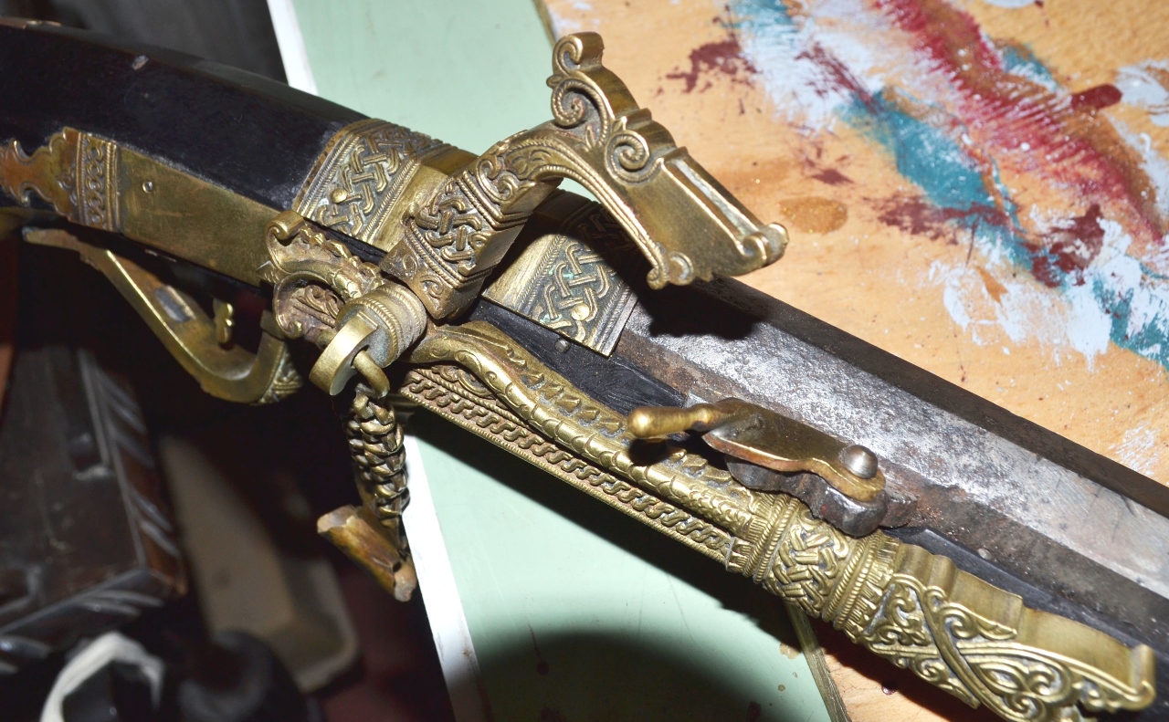

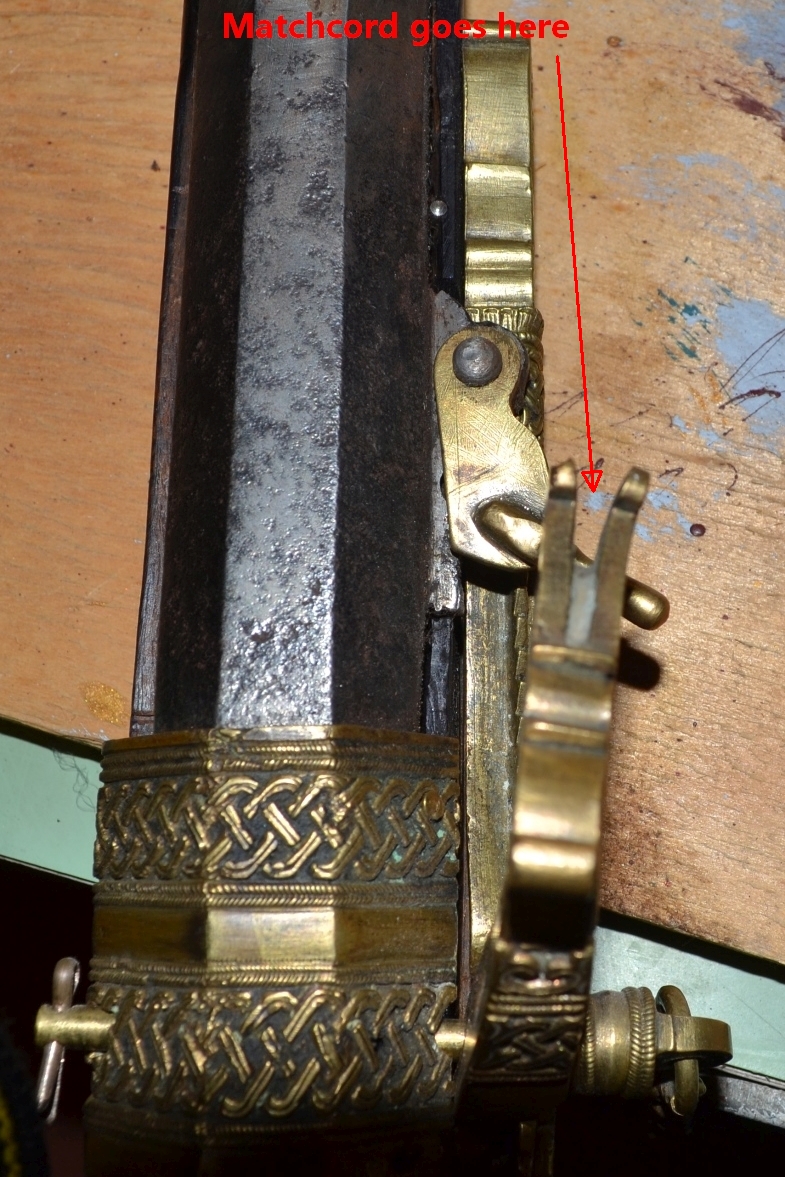

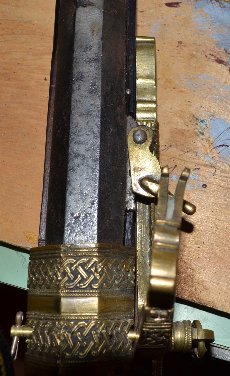

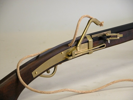

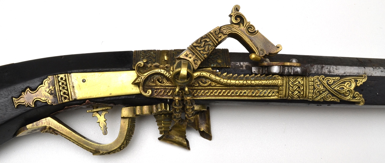

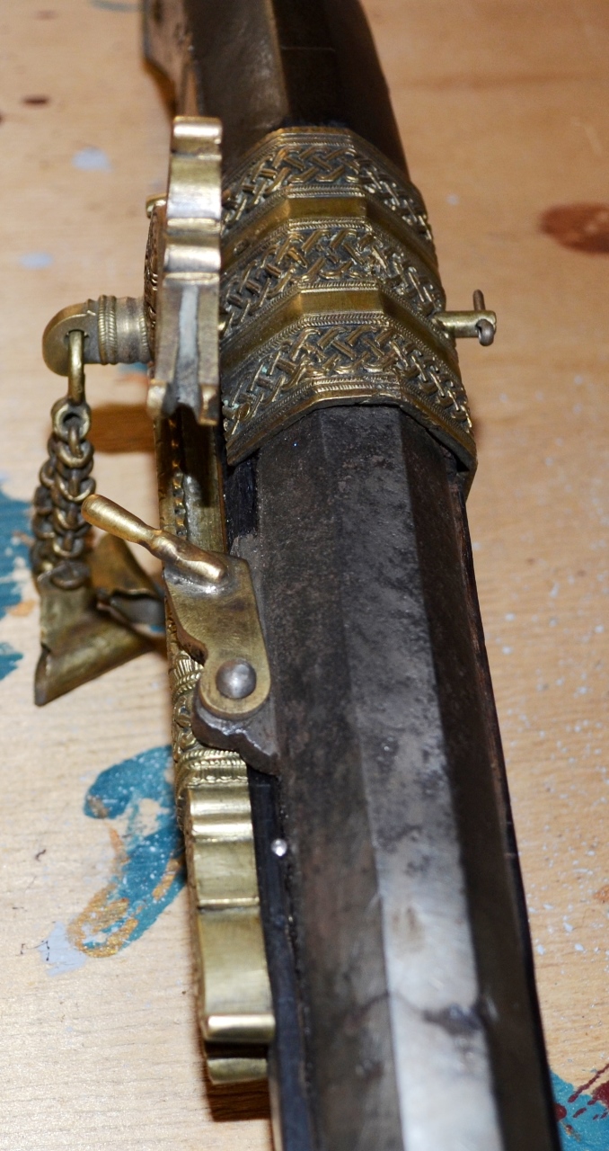

My next question is how does the rope actually access the pan, does it thread through he hammer of the lock.
Can you post photos of the serpentine (hammer) from all angles and I will see if I can show you the route that the match cord (rope) would take.
Here is a link to a place that sells matchlock match cord.
http://www.therifleshoppe.com/catalo...ocks/(933).htm

Default Extra Pics as requested

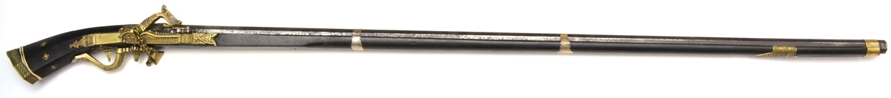

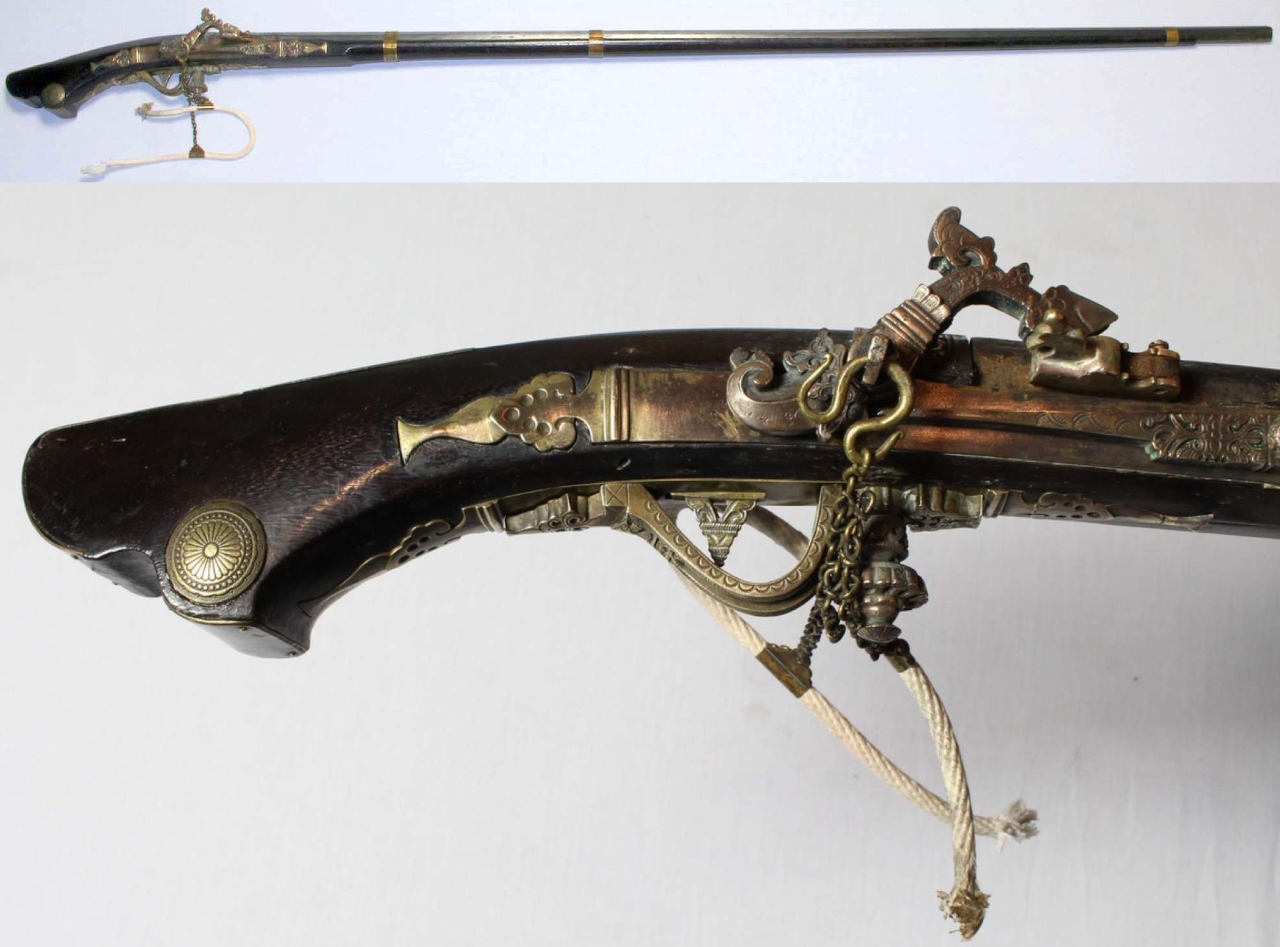

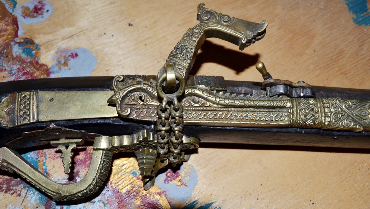

Hi estcrh
We have taken a few extra pictures form different angles hope this helps.
Cheers
Cathey and Rex
Cathey is offline   Reply With Quote
Old 7th February 2016, 10:25 AM   #9
estcrh
estcrh's Avatar
Join Date: Jun 2012
Location: USA
Posts: 1,492
Hope this helps.

Thanks Estcrh,
most helpful, I will purchase some cord and take a photo of it set up. The other point I am curious about is, when I compare mine to other examples the butt is very different lacking the two semi-circles to the end.

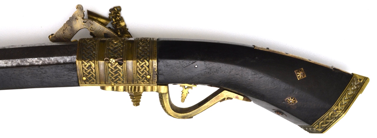

Buttstocks on these Malay guns come in two basic shapes. One is like yours, essentially flat-ended. You see a variation of this style on guns from central and southern Vietnam as well. The other has a contour with, as you describe, circular cutouts. This has some similarity to some (not all) Japanese and Korean stocks.
On the Malay matchlocks, there are noticeable differences in the style of decoration on the brass parts, between examples displaying the two buttstock variations. There may be a regional factor, since the stylistic differences are pretty consistent. Try as I might, to date I've not been able to find any publication which analyzes these variations and tries to pin them down to any specific areas in the archipelago.

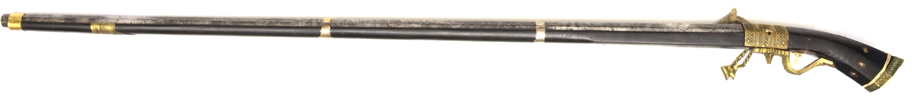

I have a Malay gun of the same "model" as yours, same stock profile and style of decoration. It's a monster:
Weight 11.76 lb , approx. 5.88 kg
Caliber 16.5 mm, approx. .62 in
Barrel thickness across flats at breech 32 mm (almost 2x bore diameter)
Overall length 61.75 in., approx. 155 cm
The point of balance is 68 cm from the end of the buttplate, this is where the piece sits level if rested on a block at that very point. I am of average height and have been shooting all kinds of rifles since I was a kid, and even a bigger guy than I am will have trouble keeping aim from a standing position because most peoples' arms aren't long enough to reach the balance point and simultaneously support the weight of the gun. Imagine how much trouble a people of shorter and lighter build like most Malays would have!
So clearly the dimensions of these guns makes them most unsuitable for hunting, especially in tropical rainforests. Another thing, the heavy serpentines coupled with the weakness of the brass mainsprings make for an extremely slow lock time after the trigger releases the sear. Positively sluggish! Most game animals wouldn't hang around that long.
In the paucity of written references on these guns, I recall seeing some mention of these being fired from some kind of support, possibly for defensive purposes. Can't recall the title and author at moment, unfortunately. But it makes sense considering how massive these things are. The extremely thick barrel walls at the breech probably mean that a really heavy powder charge can be accommodated, far more than would be safe in a lighter hunting gun. Were these intended for shot, or ball? Hard to say. My example has no sights, so hard to imagine any utility with a solid projectile. If a gun like this were loaded to the max with buckshot, and fired at attackers from atop a palisade, it would be in its element for sure.
For comparison purposes, I have 2 other specimens, of different buttstock shapes and deco style. One has the flaring butt that you compared with Japanese style gunstocks, that's almost as heavy as the piece I'm discussing here and it too has no sights. The other one is longer but a good deal lighter and and aimable, and it has a foresight in the form of a little tube at the muzzle, but no backsight.
It's conceivable that these mega-muskets did play the same tactical role as "gingals" did in Burma, India, and China (and the corresponding "fusils de rempart" or "Wallbüchsen" in Europe), supplementing the artillery. Recall that the Malay Archipelago was famous for its "lantaka" cannon, those bronze swivel cannon which were based on Portuguese and Dutch prototypes.
