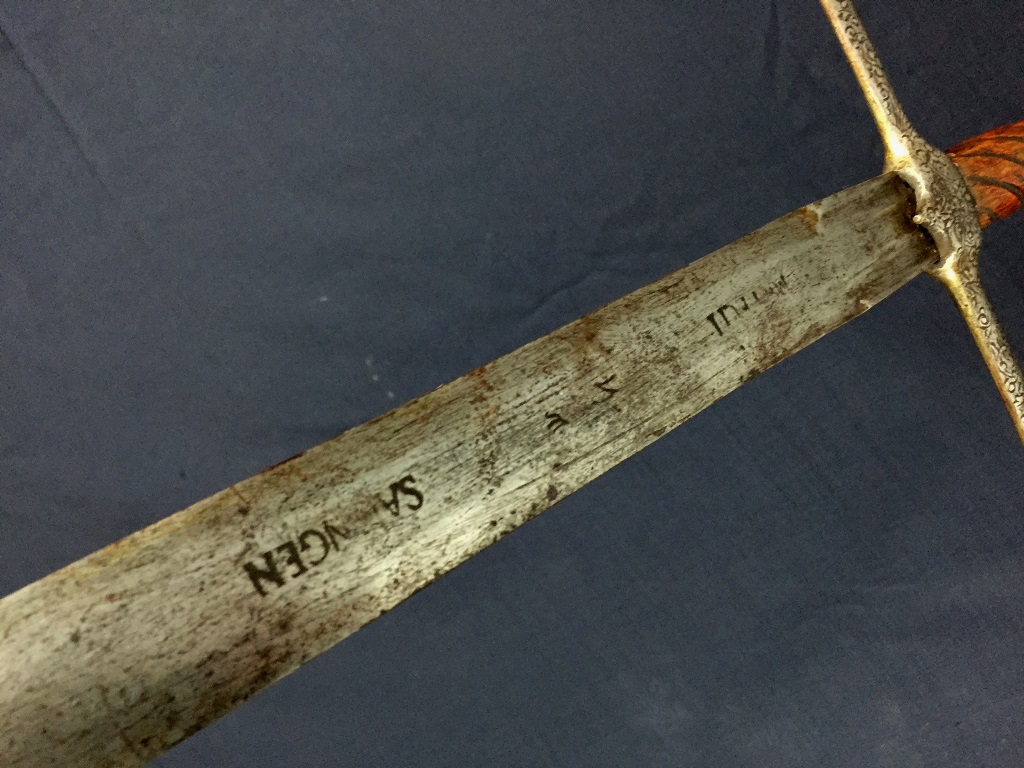

Default A composite 17 th century sword for comment.

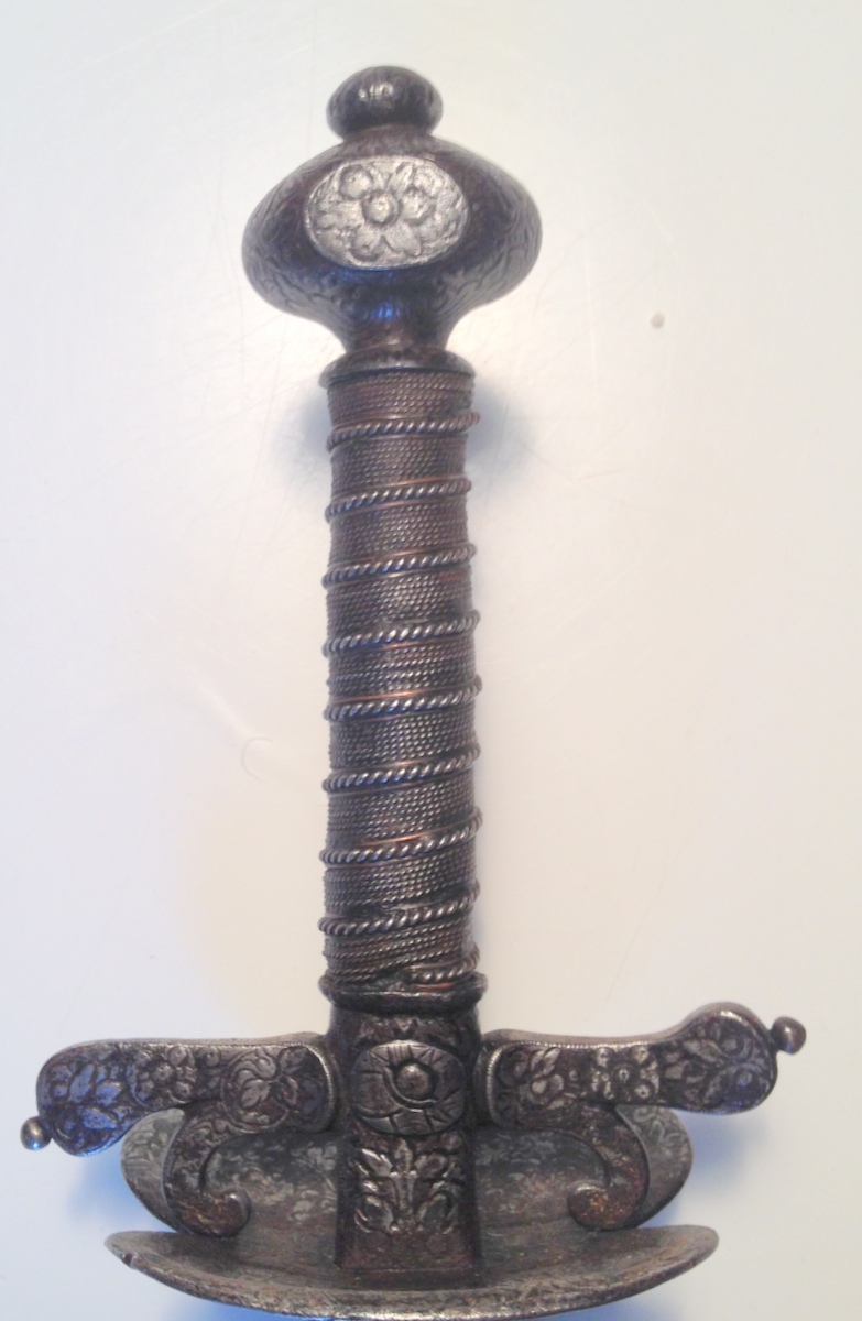

This sword is without doubt with a later pommel and grip .
I Believe that the spatulate quillons are from periode .
I ‘m wondering how could be classified this sword ,also I have never seen similar pommel.
Is it an existing type or pure fantasy ?

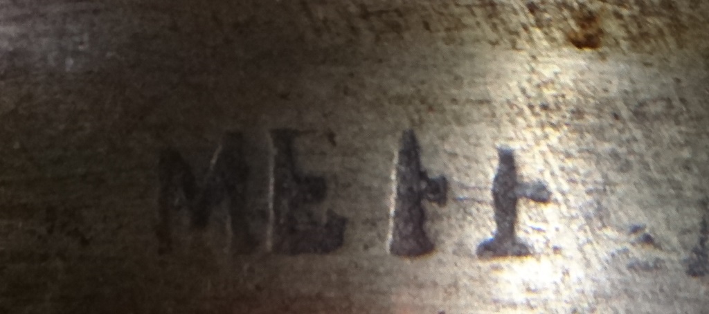

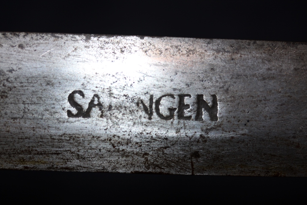

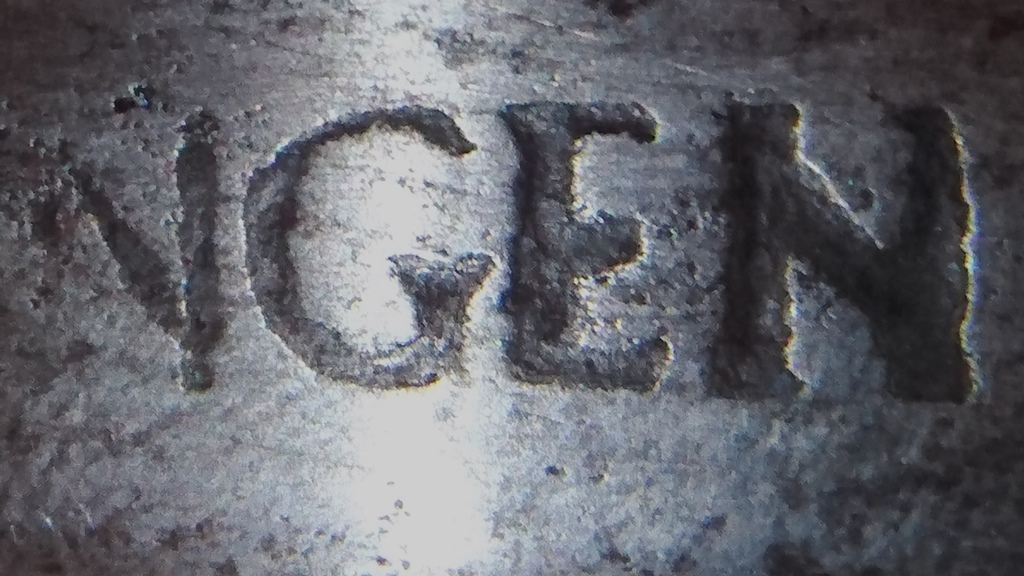

Also on the blade the inscription ME FECIT SALINGEN with what appear to be a trace of Passau wolf and not SOLINGEN.
I found a link for a similar inscription but unfortunately this link is not working anymore.
https://www.rijksmuseum.nl/nl/collectie/NG-1647
Zwaard met opschrift 1414 ME FECIT SALINGEN zwaard (wapen), l 106,1cm. Meer objectgegevens.
May be somebody has a explanation about Salingen in place of Solingen / Mistake or different place?
Any comment will be welcome.

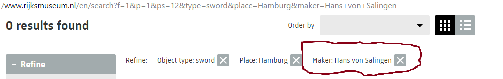

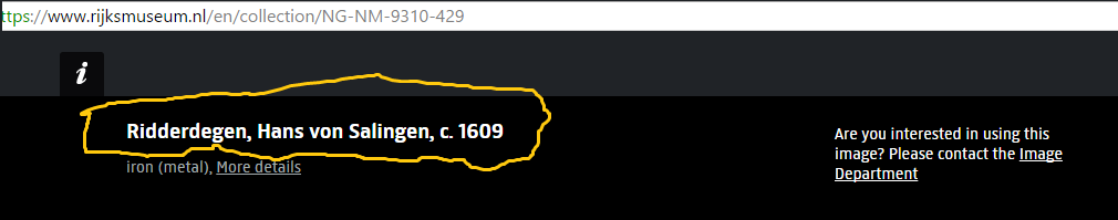

Try Hans von Salingen, a sword smith active in the early 17th. century. Apparently that sword in the Dutch Museum was dated circa 1609.

This sword seems more of a theatrical or perhaps 'parade' type item, but nicely interpreted as such.
It seems that this particular inscription may derive from blades which likely were either from a Solingen maker working in Netherlands or in a shop producing them similarly in those regions
The link that Ibrahiim has posted showing a 'sword' which has been assembled far less deftly in such theatrical style has a genuine old blade in excavated condition as its key feature.
The use of '1414' and the running wolf are simply spurious representations of popular markings used on many Solingen blades.
The so called 'Passau' wolf was one of the most widely duplicated forms and was actually more aligned with Solingen blades where it was heavily used.
Its application as an indicator of quality became well known as it became diffused into other centers across Europe and into other cultural spheres

it is a composite sword but certainly no theater or parade sword.
Guillons, flat in the plan of the blade and spatulate in shape occur in the first half of the 17th century. see attachment of a Solingen 1 1/2 sword.
the engraving of the cross is very characteristic for the first half of the 17th century, several hilts with this style of engraving are known to me.
The blade in geometry seems to me early 17th century and seems to fit the guard like a hand in a glove, which may imply that the guard for is made
for the blade.
The pommel is earlier and belongs to a type of 1 1/2 half sword which appeared briefly in the 16th century. it certainly does not belong to the guard. see attachment for this type of sword, and for a similar pommel .
I will post an example of such a 16thC sword with this specific pommel later.
So basically you have an early 17thC sword, with an older pommel ( grip is a later replacement) ......not bad.

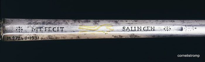

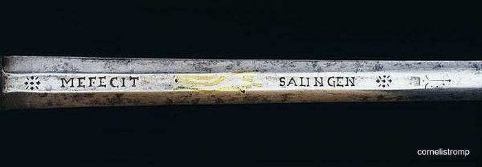

mmm..................all 17th century pommels are possible but a (flattened in the plan of the blade) globular or reversed egg-shaped pommel engraved as the guard would look nice.
pommel types such as in http://www.vikingsword.com/vb/showthread.php?t=17320
mefecit salingen= Solingen made me.
I cannot enter my books but in wapenhandelinghe by jacop de gheyn is a sword of your type if I remember well.

Red face My mistake ...

Salingen is a quarter or neighbourhood of Dortmund, Germany.
Old 17th January 2016, 12:39 PM   #10
I have also seen that, Henk .

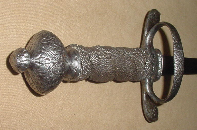

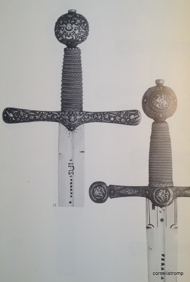

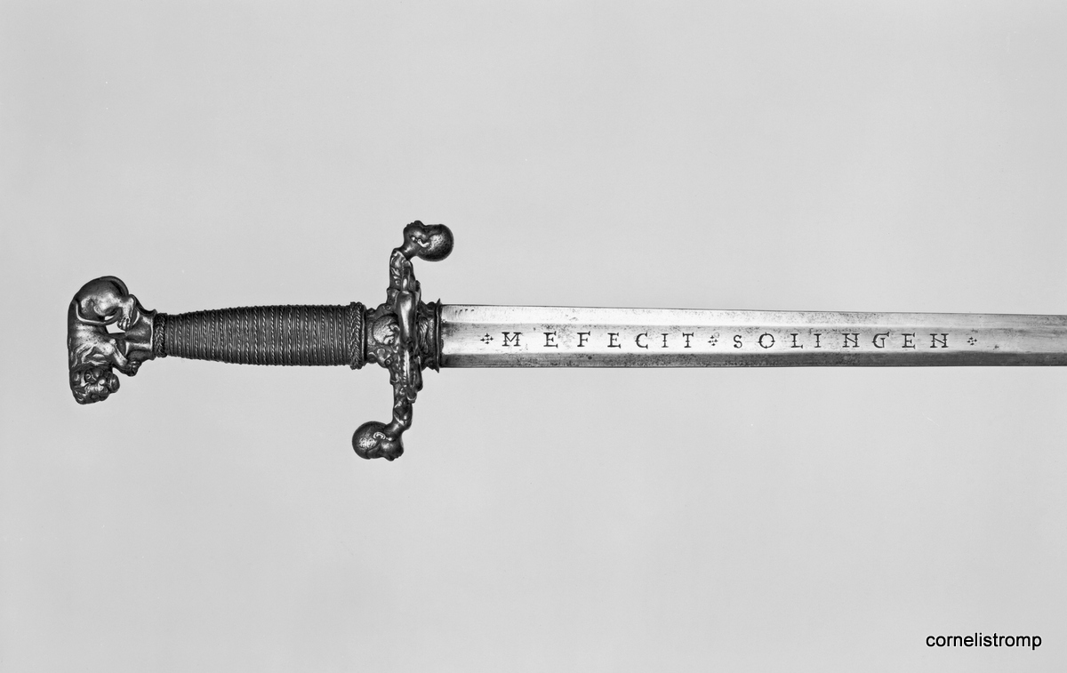

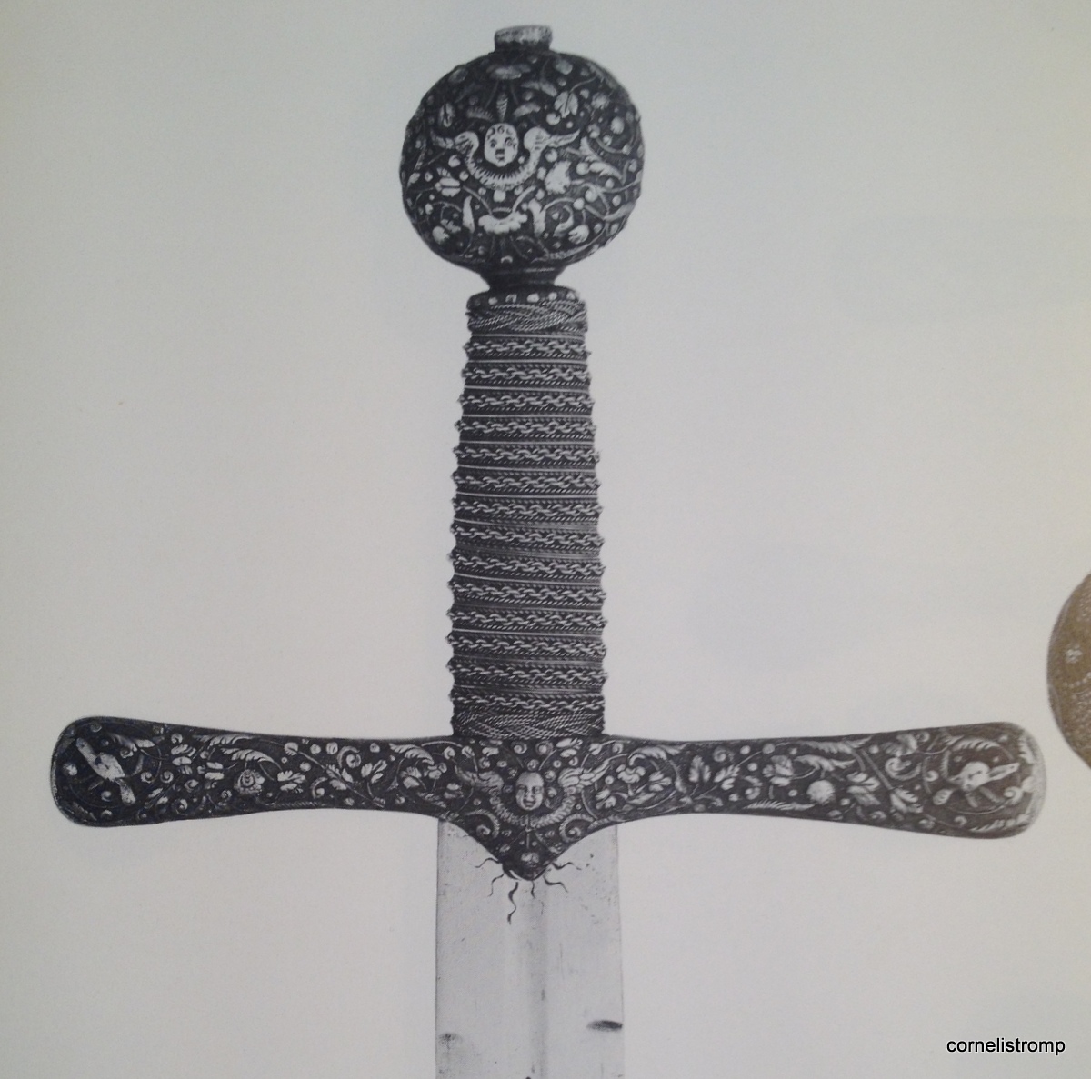

this is an example of the 16th century sword that belongs to your pommel, the same type of drawing of Hans Doering in post # 5
the blade with two short and one long Fullers characterizes several one+ a half handers in the 16th century.

Hi Fernando and Henk,
So it could be Hans (sword smith ) from Salingen in Germany ?
Thank you Jasper,
There is no doubt that you have a large documentation and also an outstanding knowledge about the typology of swords components from this period.
Best
Jean-Luc

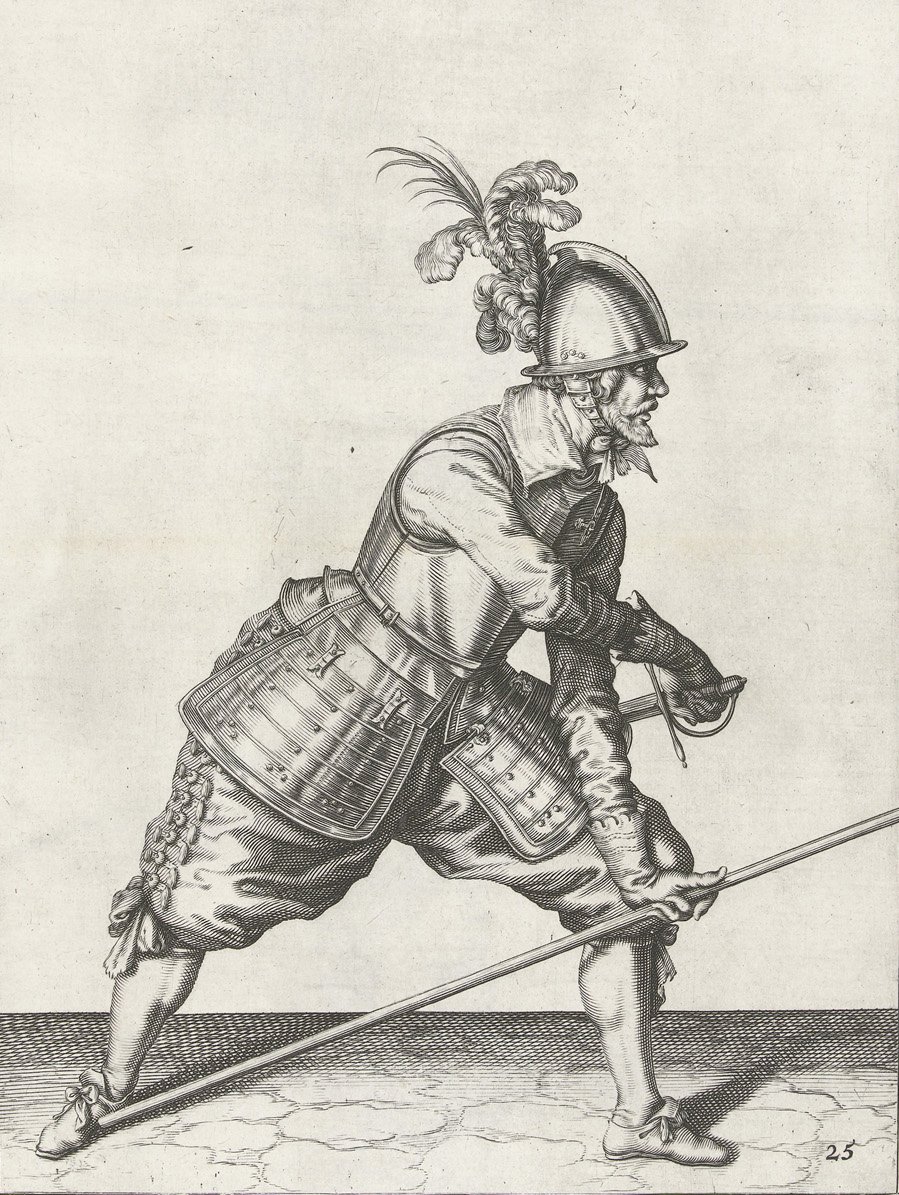

attachement: Jacob de Gheyns Wapenhandelinghe van Roers Musquetten ende spiessen, 1607
if you look to the hiltform a simple cross and a knuckle guard, in the 17th century.

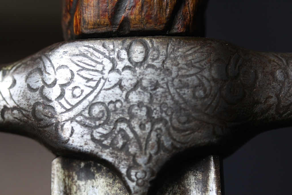

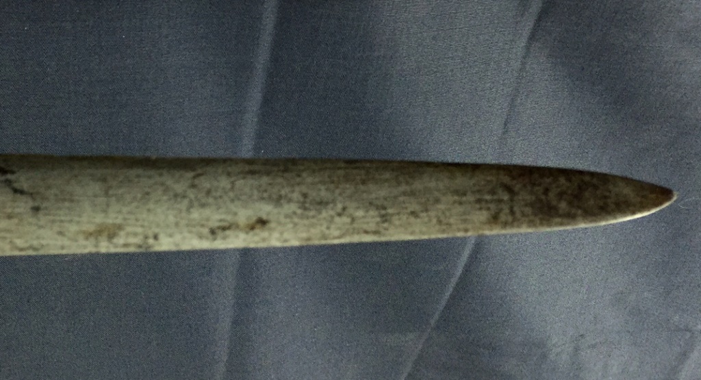

Please forgive me and I hate to be a negative Nancy but I just dont see an early piece here.
The pommel- Looks 20th or maybe 19th century. Look at the sharp edges that appear modern machine made.
The blade- The metal appears old but the script in the blade looks like a modern 20th century font that you would see on something modern. I dont think I've ever seen a script or font like this on anything older than 19th C.

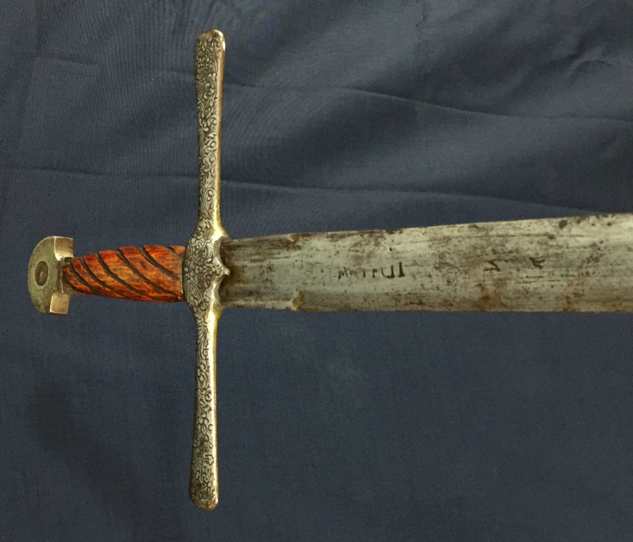

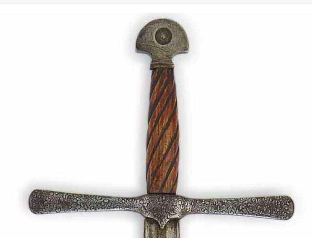

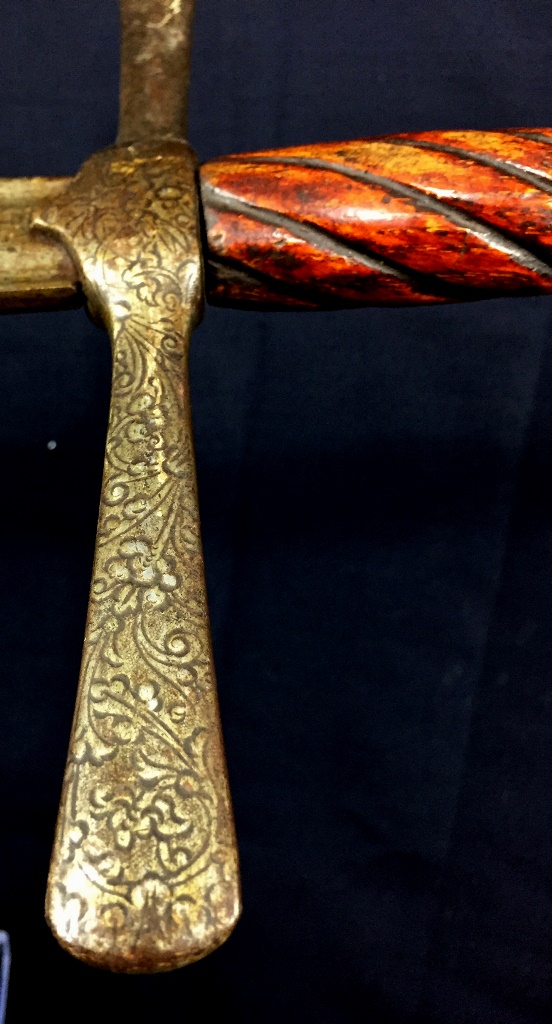

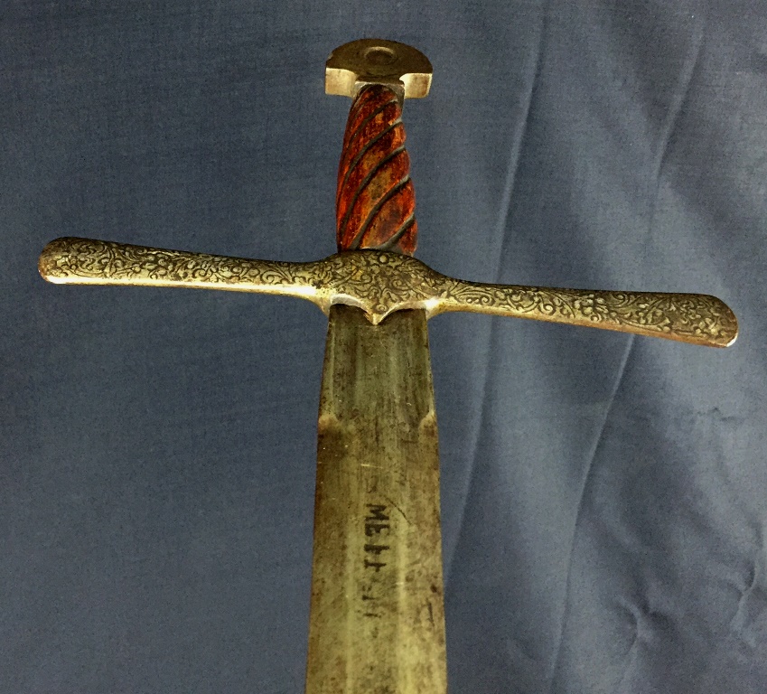

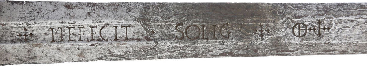

I found out in the meantime, that there's not many study for the simple crosshilted sword in the post-medieval period.
according to Claude Blair ( An English sword with an ottoman blade in the swiss national museum) this hiltvorm was in the civilian and military dress till the mid of the 16th century but there after seems to have gone out of fashion, until in the beginning of the 17th century it returned again mainly in the civilian dress.
the available evidence for the use of Such swords in the 17th century actually only comes from England.

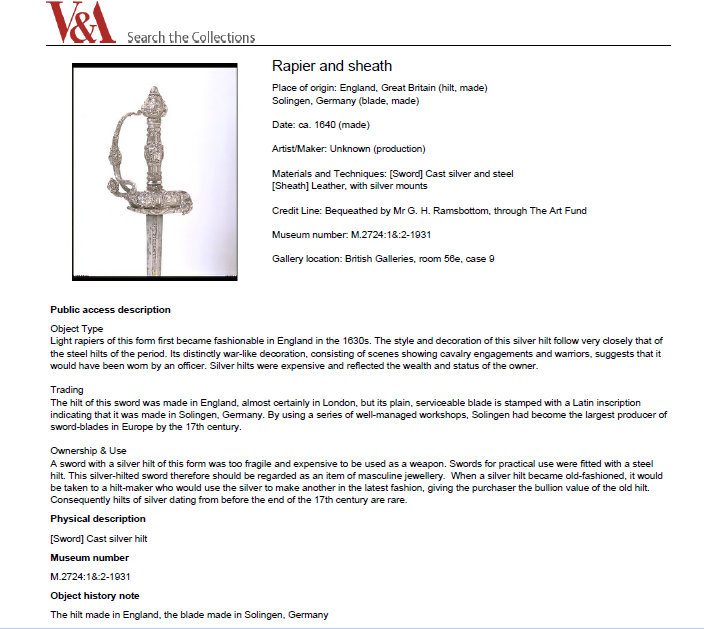

See attached a simple English cross hilted sword with a similar paddle shaped guard as the sword under discussion, simple in form of course not the decoration.
me fecit salingen seems a corruption of mefecit solingen, I do not believe salingen is the name of a sword maker, because often the first and last name of the sword maker was mentioned in the inscription.See an example of a rapier, 1630 in the V & A museum, monogram; inscribed ‘Me Fecit Salingen’ and inlaid with a running wolf.
Also an example inscribed mefecit Solingen.

Cerjak
Cerjak's Avatar
Join Date: Jan 2012
Location: FRANCE
Posts: 1,065
best,
jasper
Hi Jasper
You did a perfect job I can see that your thought about the type of pommel compatible with this sword in post 7 was exact:
A Globular pommel would be perfect with this sword.
Thank you again for the pictures.
best
Jean-Luc

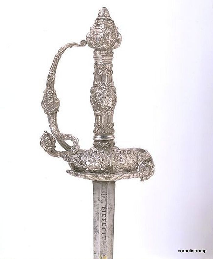

have you seen the last pictured hilt with the guard finals in the form of moor heads and the pommel where a lion was cut out.
really beautiful transitional small sword and probably Dutch, blade has master mark of meves berns.
I must admit that I agree. The cross piece also seems nicely detailed but is a casting rather than being chassed/engraved. If it were the patterning would continue around the arms. The lettering looks to be acid etched rather than properly engraved as well. How deep is the lettering? I'm thinking an oldish blade strangely dressed up to be something better.

Detailed pictures of the pommel, the crossguard and the blade could help.
The sword also seems to be covered in old varnish or hardened oil.
Its best to remove this as it does not ad to the intrinsic value of the sword and it would allow to take clear pictures .... its not like removing an old patina and
in this case ther is no old patina under the varnish or grease.
These are just suggestions of course.

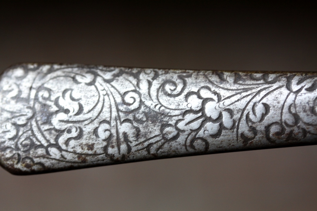

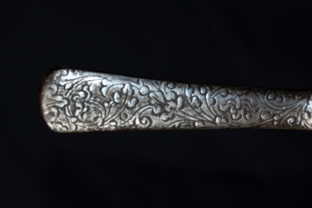

as far as I know, scrolling foliage paterns engraved ensuite, actually never passes through the narrow edges of flat guards to the reverse side.
however in rare cases on the narrow up and down side sometimes is a border of points, hammered in or encrusted.
RobertGuy would you please post an example where the engraved foliage pattern continues around the flat arms of a hilt, that would be very interesting ?
re: inscription in the blade
this must be engraved in relief and not etched on the surface of the blade of course.

Old 31st January 2016, 05:46 PM   #22
Cerjak
Cerjak's Avatar
Join Date: Jan 2012
Location: FRANCE
Posts: 1,065
Default extra pictures
here some extra pictures
Old 31st January 2016, 07:16 PM   #23
ulfberth
Join Date: Jul 2014
Posts: 447
Hi Jean Luc thank you for posting extra pictures,
from what i can see on the structure of the metal the blade seems 16th C.
The blade looks to be thoroughly cleaned at one point in time because the lettering is partly worn out but there is little or no pitting in the blade.
The cross guard could be late 16th or early 17th C , the engraving is good for the period. I cant say nothing about the pommel.
kind regards
Ulfberth

Old 1st February 2016, 04:23 PM   #26
Posts: 10,862
This thread and the entire discourse is outstanding!! I cannot thank all of you participating here enough for these observations and the great illustrations.
This is like a course in arms study, and for an old nomad like me in a Winnebago who seldom sees or handles actual weapons in person, it is amazing
I thank Jen Luc for always sharing the excitement of new items he acquires so we can learn from them (Jasper, as you agree none of us ever stops learning).
Ulfberth, thank you for your astute skills in observing details on the metal work and components in their character.......things I certainly miss each time never escape your eye!
Jasper, if I may, it seems you mentioned that the spelling of Solingen adapted to that form at some point in time, leaving the SALINGEN spelling behind. Can you please reiterate?
On the blocked letters on the blade of original post, I would have taken them for more modern as they seem so heavily stamped and don't seem to have the fine serifs and flourished features of the early examples shown in some of these illustrations. Only experience and keen eye as with you guys could discern that these are indeed early.
Would that be likely from shop variation or worn stamps etc?
Old 1st February 2016, 06:33 PM   #27
cornelistromp
cornelistromp's Avatar
Join Date: Mar 2009
Posts: 1,071
this is own interpretation!
nevertheless the silver hilted rapier from post nr16 with the MEFECIT SALINGEN blade is attributed by Claude Blair, the keeper of metalwork in the Victoria & Albert Museum for ten years before his retirement in 1982, to a Solingen workshop.
my date of 1630 , 10 years earlier for the rapier's is also own interpretation.
best,

Posts: 1,071
this one is also nice.

Salaams all.. Magnificent thread! ... In reference to http://art-of-swords.tumblr.com/post...lace-of-origin What does the text imply about this spelling? It appears to indicate that Latin uses the SALINGEN form rather than SOLINGEN. Is this the case here?
Quote"The hilt of this sword was made in England, almost certainly in London, but its plain, serviceable blade is stamped with a Latin inscription indicating that it was made in Solingen, Germany".Unquote
In that region in the past it has been called similar names but not Salingen: From wikepedia Quote "Solingen was first mentioned in 1067 by a chronicler who called the area "Solonchon". Early variations of the name included "Solengen", "Solungen", and "Soleggen", although the modern name seems to have been in use since the late 14th and early 15th centuries". Unquote.
Ibrahiim al Balooshi
