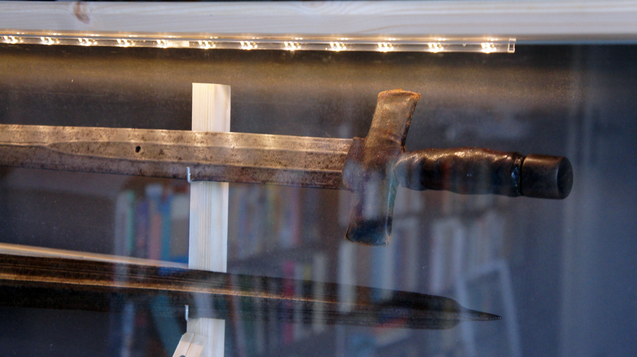

This might be of interest for some. I have been testing out some sword case ideas recently.
These have glass doors and I have fitted LED lights inside. The stands inside are rough and not a final design.
If anyone is interested the main cases and the LEDs are all from Ikea, not very expensive and very easy to put together.
These are just a few quick pics, the glass is still a bit dirty as I just put everything together!

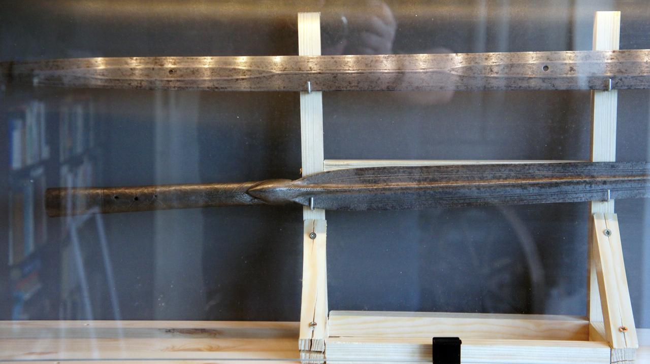

Got some acrylic stands made up. Still working on lighting...

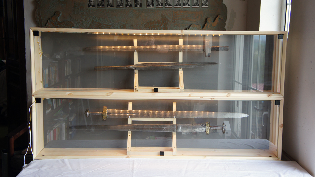

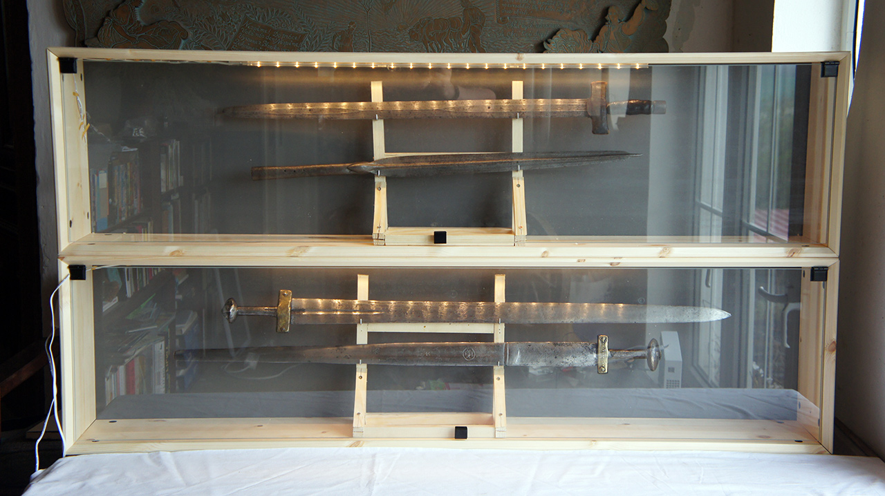

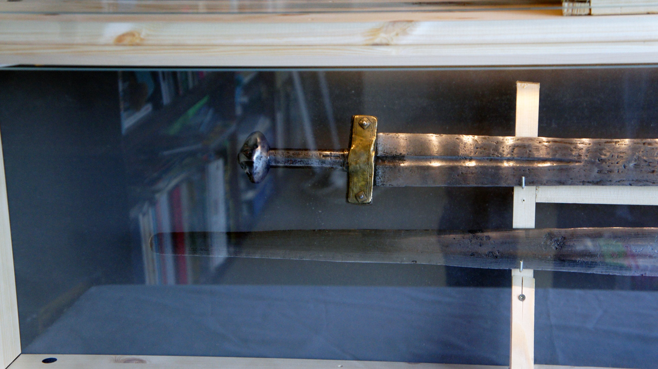

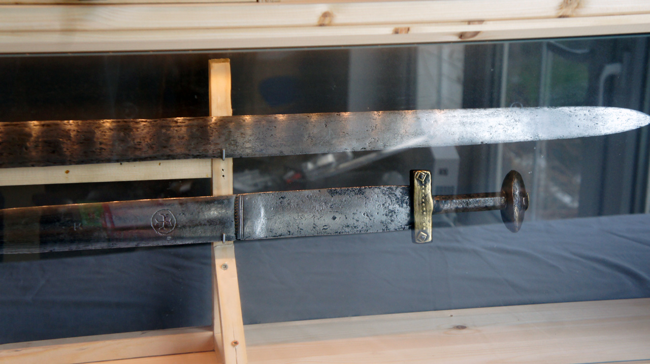

Well I finally completed these cases. In the end for lighting I ran a strip of flexible LEDs inside a groove in the top panel of the case. I'm pretty happy with the result.
The photo makes the light seem more uneven than it really is.
