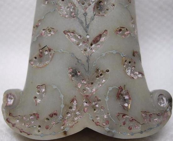

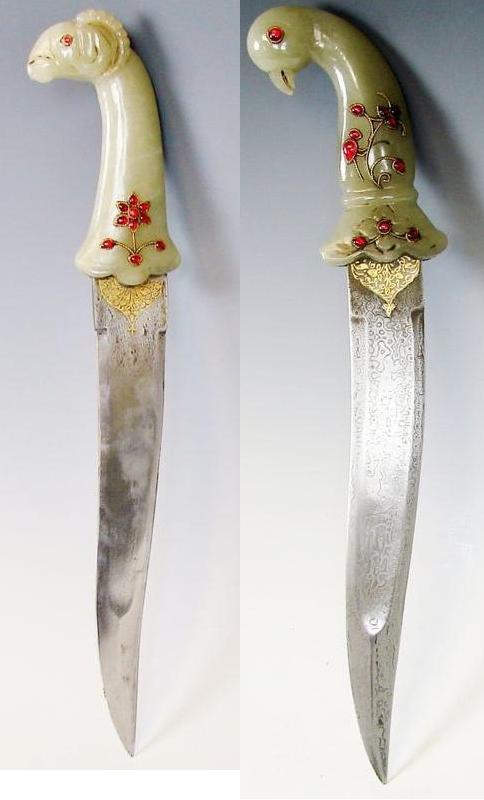

now when I got your attention:-) there's a growing trend hitting the market, and particularly eBay, of mughal kundan imitations. Not to discredit a particular seller (as there's no mentioning of word "kundan"), but to educate those who may not realize this is not kundan, as it looks like some do not know, based on prices and feedbacks. So look at the below closeups: the real kundan requires stones to be placed (pushed) into carved patterns into melted gold. What we see here is a clever surface application with twisted wire and stones being glued on top. The work is actually quite sloppy, there's even some glue residue left and I'd feel sorry for anyone during Mughal times who'd dare to produce such "quality" - that person would be expelled from the workshop and loose an arm. Nowadays, this is what buyers do:-). One can write a few pages of what's "not right" with those daggers, but pictures worth a few pages more...
Old 18th March 2012, 10:55 PM   #2
Posts: 7,415
WOW! Ugly stuff. And you can't tell very well from ebay pictures. Good to have this thread, thank you.

Hi Alex, you're absolutely right
and ... if it's was "only" concerning Mughal kundan ...
I will add some criteria, about edged weapons, or part of armour
- when the pic's exposure, is done, darken voluntarily
- when there is no mention about a date or even a century, like that, no risk to be accused of false description
- last point, but sometime I may be wrong, when the price is far away of the market average price

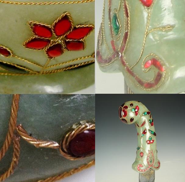

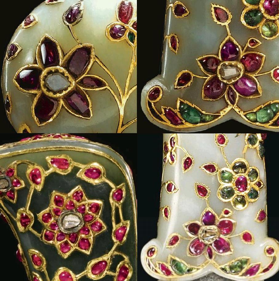

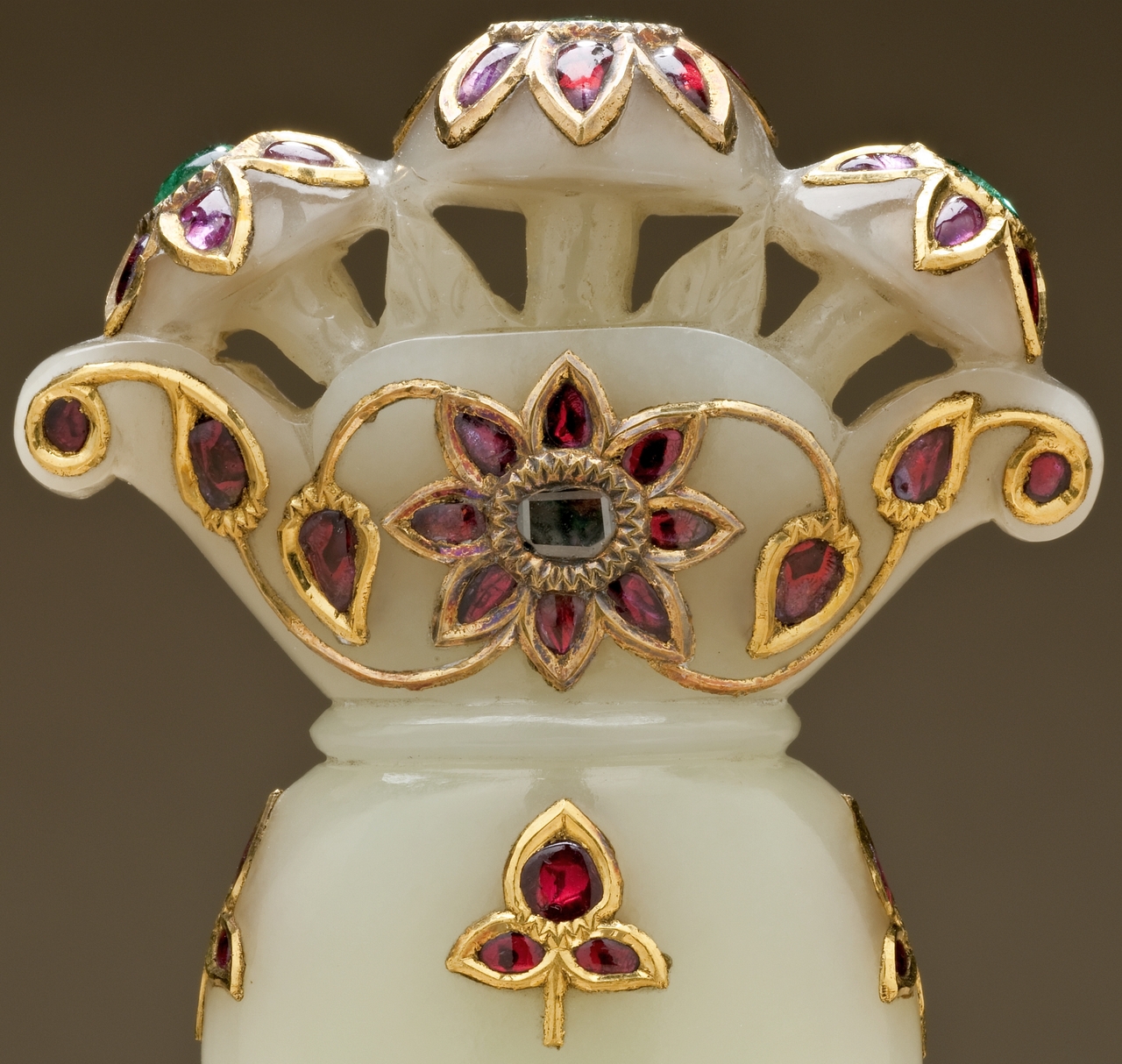

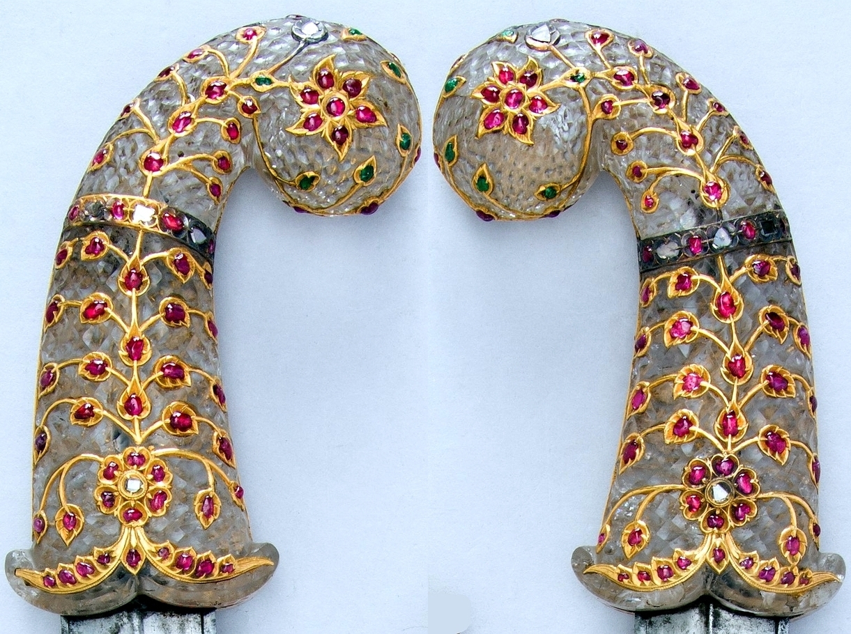

Here are few examples of kundan technique...

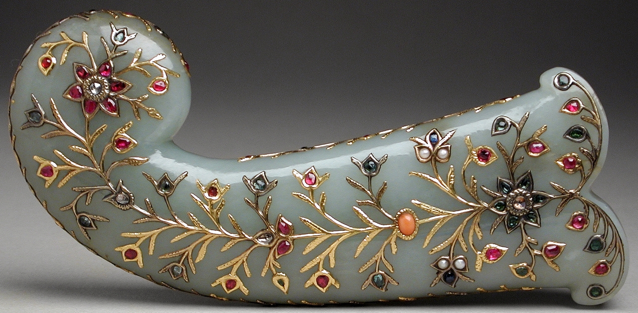

And here's 18th century nephrite jade handle with all jewels and gold removed, so you can see the original carvings before they were filled with all that bling:-)

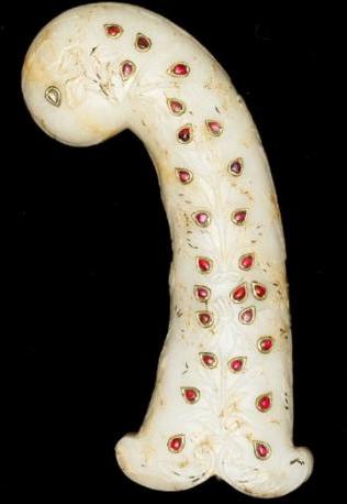

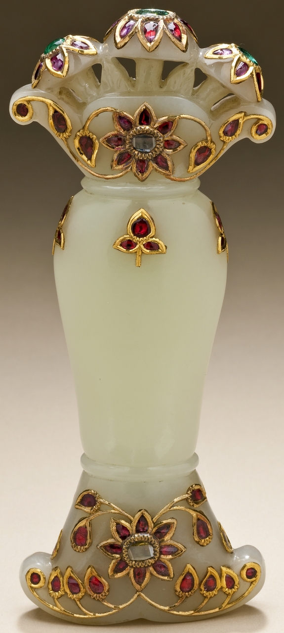

also, 19th C mughal handle with some kundan applied much later, likely in 20th C.

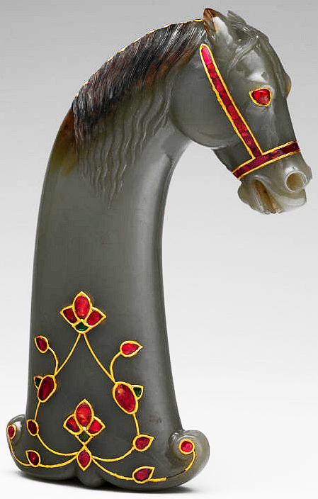

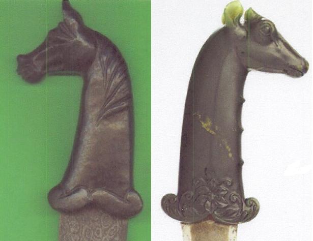

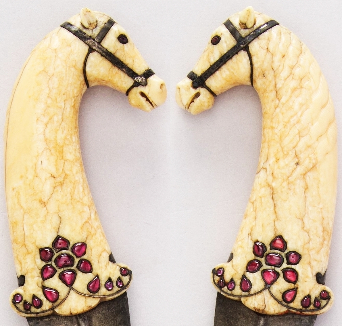

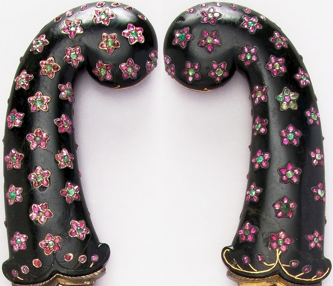

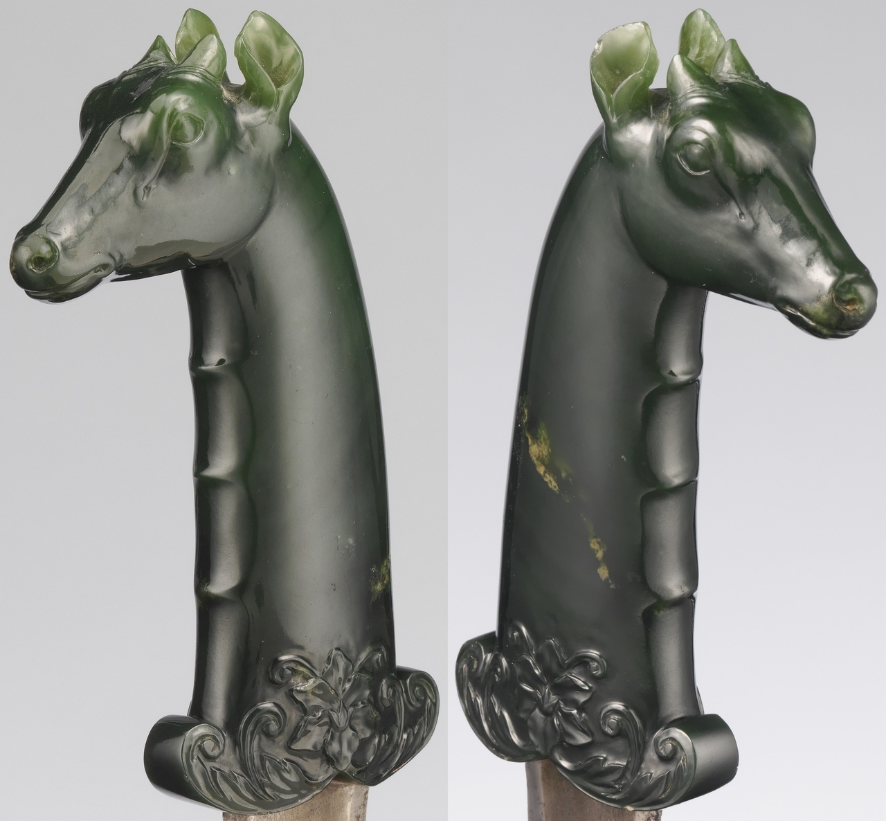

since we're on a mughal subject - here are few handles in most common mughal horse forms. Just like with new kundan - one thing is when you're looking superficially or on blury pictures, but when you start comparing with authentic mughal, the difference becomes much clearer.

Kundan is a very interesting subject, but few collectors know much about what it is. Some of the reasons could be, that good kundan work is rare, and so very expensive. Another reason could be, that on many of the hilts with gold and gems all of value have been removed and sold seperately.

Alex, the hilt to the right in post 10 is not a horse, althought it could look like the head of a horse, it is a nilgai - notice the small horns.
Jens, these are not horns, these are true inward-turned ears: a specific feature of the so-called Marwari horse.
The Met has been known to be wrong from time to time when describing items in their collection, this one seems to be described correctly, besides the ears you can see a pair of horns.
http://www.metmuseum.org/collection/...&tabname=label
Dagger with Hilt in the Form of a Blue Bull (Nilgai)
Object Name: Dagger
Date: ca. 1640
Geography: India
Culture: Islamic
Medium: Hilt: Nephrite Blade: Watered steel
Dimensions: H. 15 in. (38.1 cm)
Classification: Stone
Credit Line: Gift of Alice Heeramaneck, in memory of Nasli Heeramaneck, 1985
Accession Number: 1985.58a, b
On view in Gallery 463
The weaponry produced at the Mughal court reflects the same refinement as other portable arts. Daggers such as this one were sometimes awarded to officers who had distinguished themselves in military victory and were worn at court as dress accessories indicating royal favor. Animal-headed hilts were especially favored, and the realism of their rendering conveys the keen appreciation for nature by Mughal artists.
On this dagger, the hilt portrays a nilgai, or blue bull, one of the most beautiful animals found in India, and terminates at the base with a leafy scroll and lotus flower. Carved from a bluish-green nephrite that approximates the color of the animal, this hilt not only demonstrates the artist's thorough mastery of hard-stone carving, but also displays a level of accuracy and sensitivity that suggest close observation of a model, perhaps one of the captive animals kept in the imperial zoo.
High resolution image.
https://s-media-cache-ak0.pinimg.com...4ab58015ac.jpg

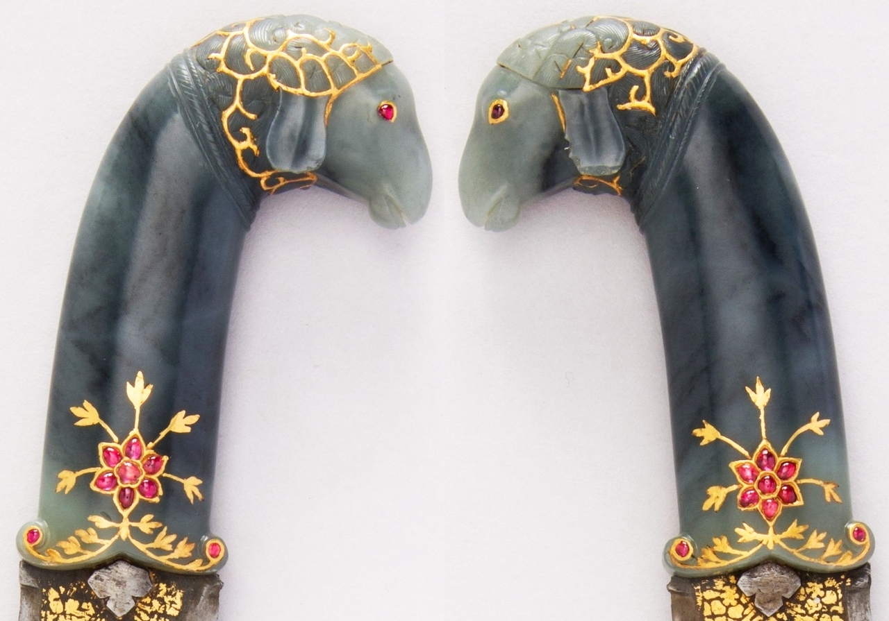

Originally Posted by Stan S.
Any chance fo seeing pictures of similar but confirmed mughal period weapons for comparison?

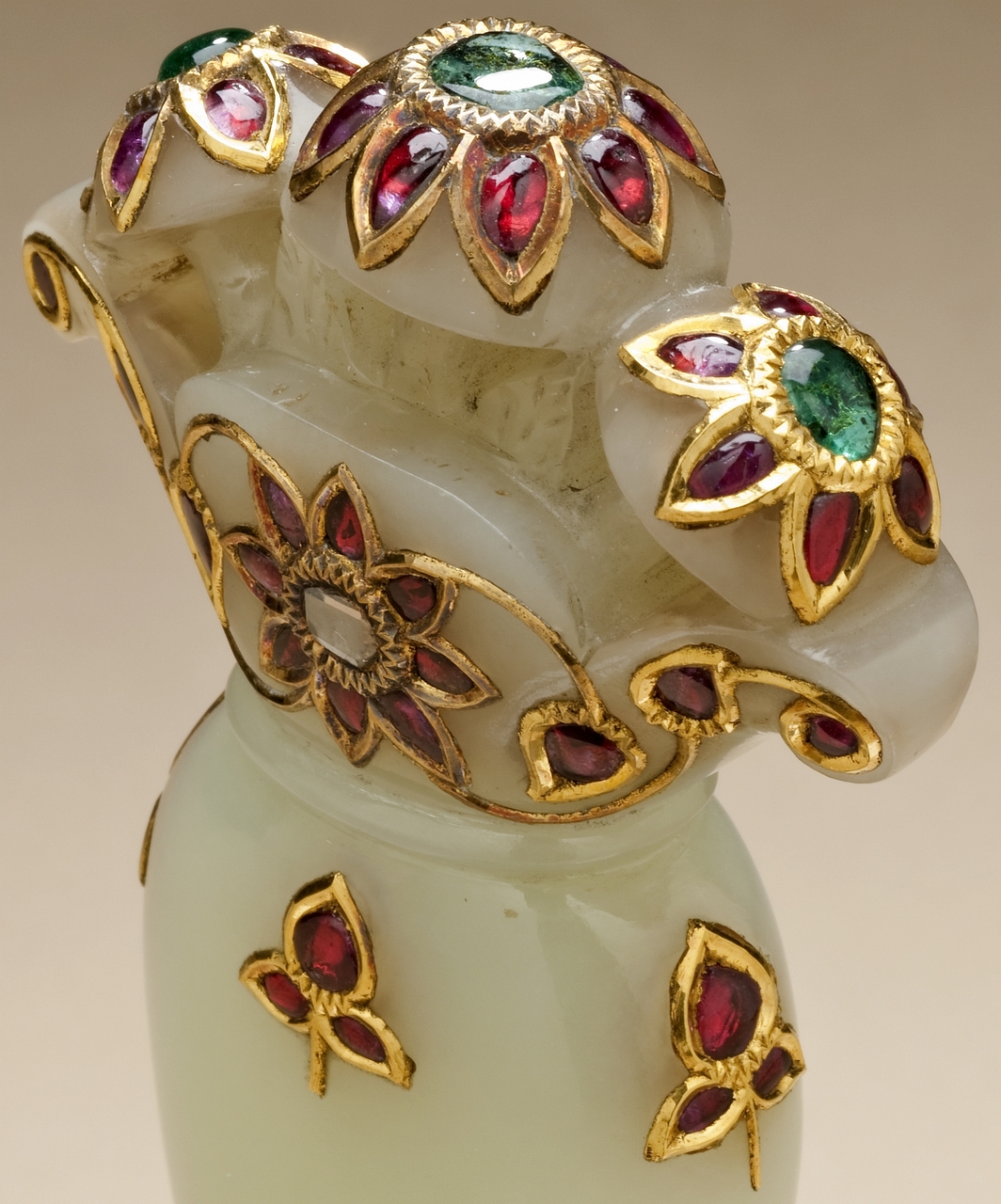

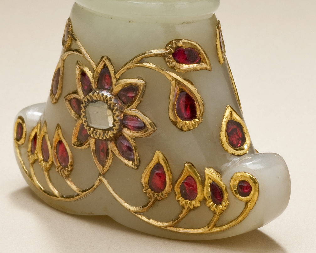

Here are a few examples from the Met Museum.

Ariel, I still think the one to the right in post no 10 is a nilgai, just like the one shown in post 18. See the text here.

Old 30th November 2015, 07:25 AM   #29
estcrh
estcrh's Avatar
Join Date: Jun 2012
Location: USA
Posts: 1,492
A few more excellent examples.
