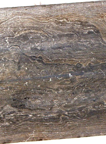

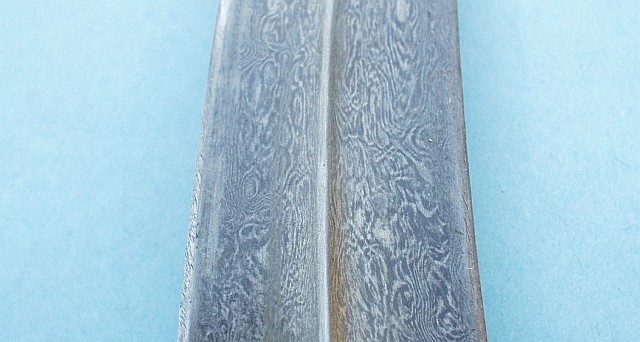

Posts: 7,415
Now here is the close up of the blade (looks like wootz, doesn't it):
Old 20th December 2004, 02:02 AM   #11
Mick
Mick's Avatar
Location: Orlando
Posts: 104
Sorry Battara
That's a folded blade, not wootz.

Old 20th December 2004, 03:50 AM   #12
Andrew
Andrew's Avatar
Location: USA
Posts: 1,725
I agree with Mick, Jose. That looks forge-folded. Is it polished like a Japanese blade, or etched like a keris?
Wow. What an interesting blade.
Old 20th December 2004, 02:46 PM   #13
Federico
Federico's Avatar
Location: Minneapolis, MN, USA
Posts: 312
Are the white specs just dust in the scan, or is that actually in the steel?

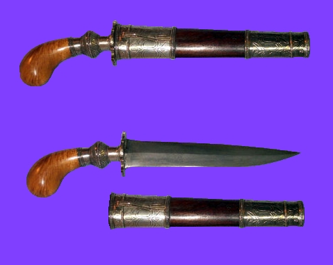

Old 20th December 2004, 08:40 PM   #14
Ferguson
Ferguson's Avatar
Posts: 793
A poor picture of a Tulwar with a wootz blade.
Steve

Old 20th December 2004, 10:42 PM   #16
Posts: 7,415
Hesitant to call my blade wootz, yet hesitant to call this pattern welded only. The white flecks are the scanner glass surface. It is not etched like the Javanese, yet not polished like the Japanese. In any case, it is the most heavily laminiated steel I have seen on a PI/Moro piece.
Old 21st December 2004, 02:59 AM   #17
RSWORD
RSWORD's Avatar
Location: Greensboro, NC
Posts: 1,099
Jose
Having the privilege of handling that lovely gunong of yours, I can tell you it is not wootz. Rather, I believe it is a type of pattern welding, possibly 3 plate, not unlike Chinese sanmai.
Old 22nd December 2004, 04:54 AM   #18
Posts: 7,415
Oh I agree. Having some wootz pieces from Turkey and Persia, Wootz is a little different. Though it does look a little wootzish. Many tulwars have incredible lamination, though not that same as wootz. The first picture is from a Kurdish jambiya I have (from Artzi ) with Persian wootz, the second is a Turkish jambiya (again from Artzi ) with Turkish wootz. As you can see, there are differences in the multiple lamination technique and wootz, though similar in some cases:

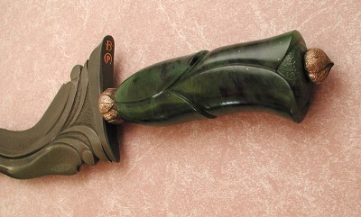

Old 18th January 2005, 01:09 PM   #19
Mare Rosu
Deceased
Mare Rosu's Avatar
Location: USA, DEEP SOUTH, GEORGIA, Y'all hear?
Posts: 121
Default Pendray Wootz Kris
quote by RICK:
"I'll bet Mr. Pendray could make a beautiful contemporary kris blade from wootz .............. "
RICK;
I found this picture of the Kris that Al Pendray made out of his wootz.
Sorry for the image size but it is all I could find. I have been searching for it for a while. It has a jade handle that was made by someone other than
Mr. Pendray but do not know just who, for someone in Hawaii if I remember correctly, will keep on searching.
I found it! along with this writeup.
The price may not be allowed, if so Andrew or RICK remove it.
Sculpted Jade
and Wootz Kris
"An exquisite collaboration between Broadwell and Alfred Pendray. Features Pendray's Wootz damascus steel forged to shape on the 20" blade, including the raised center ridge. Exceptional forging! Jade handle with bronze fittings. All sculpting and carving, as well as all blade grinding and finishing, done by Broadwell. By far the most difficult and time consuming art project to date, this magnificent piece was commissioned as a showpiece for a private collection."
Similar Piece: $8000
Photos: Point Seven,
S Broadwell
Mare Rosu is offline   Reply With Quote
Old 18th January 2005, 02:14 PM   #20
Andrew
Andrew's Avatar
Location: USA
Posts: 1,725
Thanks for posting that photo, Gene. No problem with the price, as it is not for sale, having been made for a private collection apparantly.
It's nice to know what some of the upper-end custom stuff sells for.
Old 18th January 2005, 10:15 PM   #21
Posts: 7,415
Although not traditional, that's one perdy piece.
Old 18th January 2005, 10:20 PM   #22
Posts: 6,441
Thanks Gene !
That's a very beautiful piece of work .
I sure would like to see some detail shots of this blade .
Old 20th January 2005, 06:14 PM   #23
Mare Rosu
Deceased
Mare Rosu's Avatar
Posts: 121
Thumbs up David Broadwell
I did not find any closeups of the blade but I did find
Mr. David Broadwell
(David) the maker, along with Al Pendray of the Kris and I have asked him to join into this discussion of his Kris.
Now that the forum is back up and running (Thanks Dr. Lee!)
So all you forum folks please welcome David, when he signs in, and ask away about the kris.

Old 21st January 2005, 01:03 AM   #26
Double Edge
Join Date: Jan 2005
Location: Texas
Posts: 4
I appreciate the introduction, Gene. Yes, the wootz and jade kris is mine, made for a collector a few years ago. This was my second sword, the first being a boarding cutlass. Both swords were made as interpretive art pieces, not as historical reproductions.
As Gene said, this blade is made from Al Pendray's wootz. Al forged the blade to shape with all its hills and valleys, and forged in the raised center ridge. Al is unusually skilled with his hammer and I received a pretty clean billet. I fitted the kris with bronze trim and a British Columbian nephrite jade handle. The steel does have a pattern, but like most wootz it takes some tricks with a camera to get the pattern to show easily. Pattern welded is a breeze to photograph compared to wootz! Unfortunately I do not have any more pictures of this sword including close ups showing the pattern.
The man who commissioned this sword grew up in Indonesia and obviously likes the kris. He requested my style of sculpting and the wootz over a pattern welded "damascus" steel. That's why you see more of an Art Nouveau interpretation rather than a traditional look.
Gene had asked about etching the wootz. I used a diluted ferric chloride solution. It actually took three etchings to get it right, and I had to refinish and polish the blade each time. Wootz is etched by a quick wiping of the etchant followed by a rinse and oiling. I finally got my wife out in the yard with a garden hose and I would wipe on the etchant and she would hose down the blade. You can't let the ferric stay on the steel more than a few seconds or you loose the crystiline carbide structure that makes the pattern. Wootz takes a surface finish, rather than the topographical etch more commonly used on pattern welded steels.
If there are more questions about this or any other knife or sword I've made, ask away.

Old 21st January 2005, 12:30 PM   #30
Mare Rosu
Deceased
Mare Rosu's Avatar
Posts: 121
Question Polishing wootz
"Gene had asked about etching the wootz. I used a diluted ferric chloride solution. It actually took three etchings to get it right, and I had to refinish and polish the blade each time. Wootz is etched by a quick wiping of the etchant followed by a rinse and oiling. I finally got my wife out in the yard with a garden hose and I would wipe on the etchant and she would hose down the blade. You can't let the ferric stay on the steel more than a few seconds or you loose the crystiline carbide structure that makes the pattern. Wootz takes a surface finish, rather than the topographical etch more commonly used on pattern welded steels."
DAVID
Question:
Did you polish the wootz after the last acid etching?, what did you use to do the polishing, and how? What was the dilution ratio of the Ferric Chloride? What oil, preservative did you use on the finished blade?
Now aren't you sorry for asking for more questions?
And one last question, Did you pay your wife for her help in the etching of the Kris?
