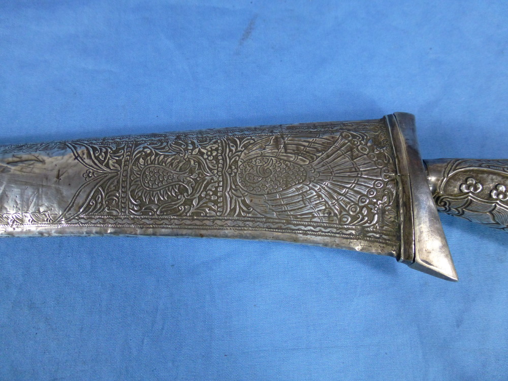

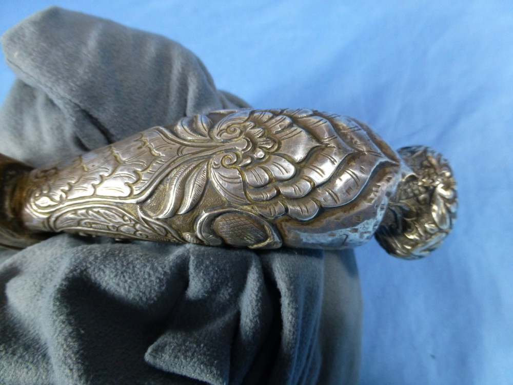

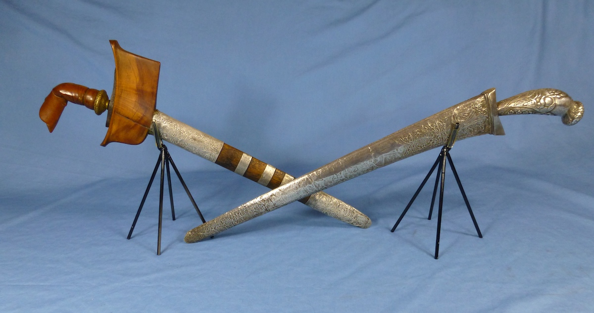

These are two recent acquisitions from Oriental Arms. Artzi associates the Keris with the Bugis, he is less clear on the Pedang Lurus, “common in Java but can be found also in other Indonesian islands”. In any case, the two pieces are certainly both Indonesian, and close contemporaries. This is a new area for me and I would appreciate insightful comments on these pieces and who would have been the original owners. I have read about the cultural significance of the Keris but I know virtually nothing about the cultural context for the Pedang.
Old 12th August 2013, 03:18 AM   #2
Posts: 9,207
Hello Marcus,
please post the keris in the other forum and show us from both pieces more pictures, special from the blades. The keris don't look pure bugis to my eyes but more in direction Peninsula or Sumatra but need other pictures.
The pedang seems to be a classic pedang lurus from Java and seems to be in very complete condition, many I have seen have had demaged scabbards since the silver cover is most of the time thin. Also here, please show the blade.

I support Detlef's request and notes.
Please show as requested in the required forum as the Keris looks to be Central Western Sumatra but more exacting detail will be discussed in the Keris forum.
The Pedang Lurus come in all qualities over a long period of time, I would be interested in viewing the rest of it here too.

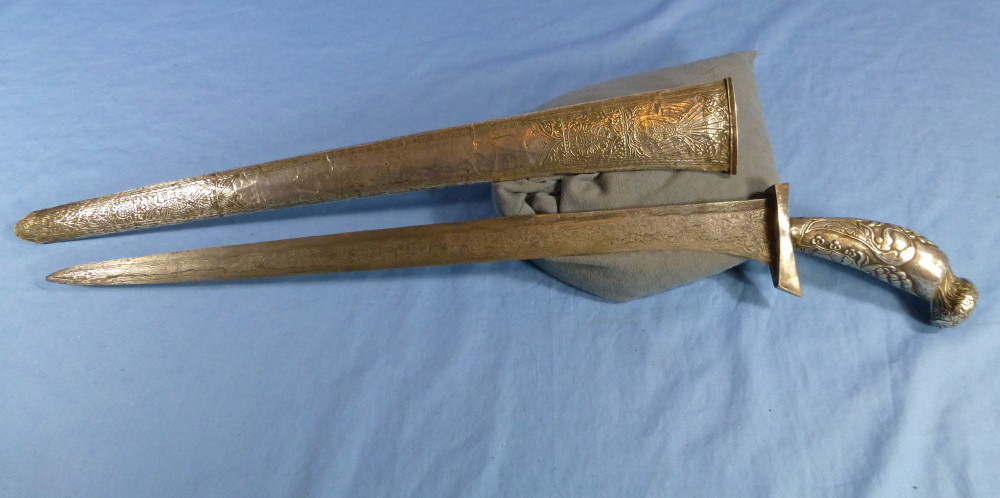

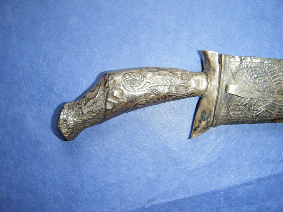

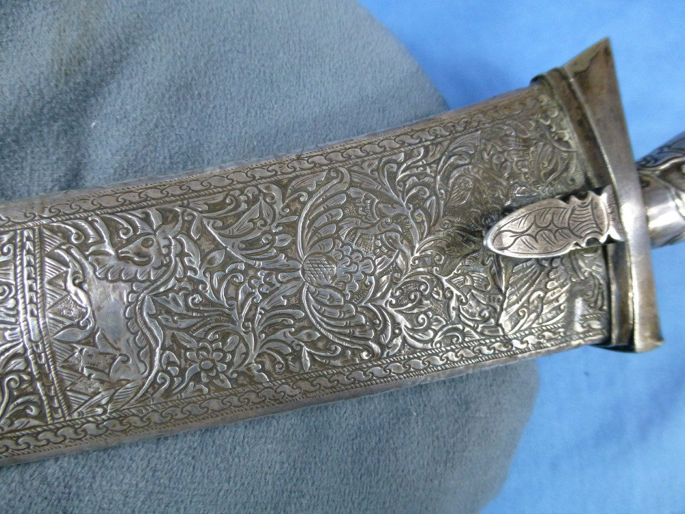

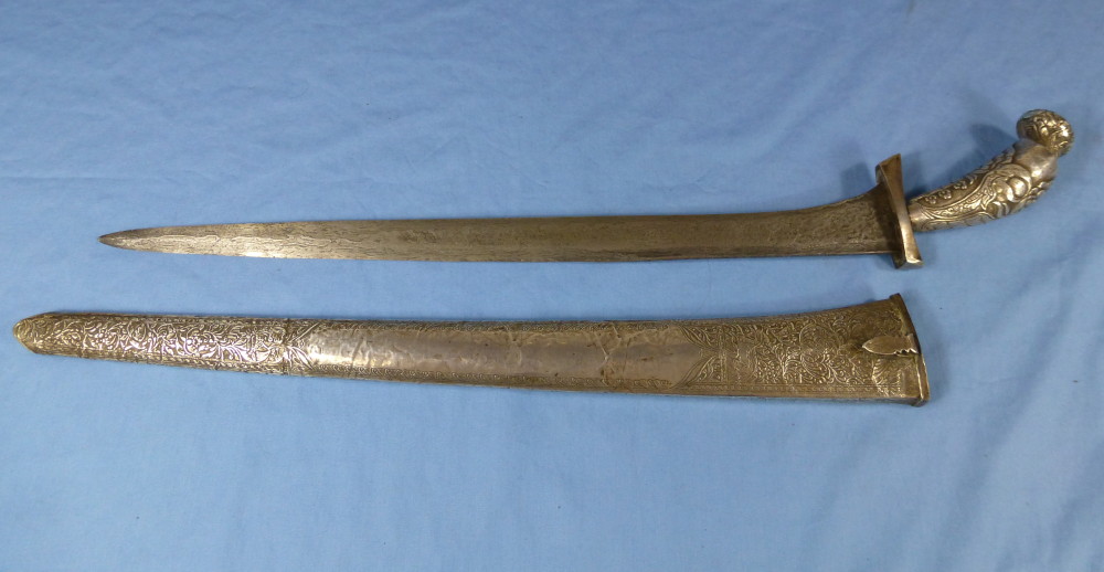

Default more photos
As requested.

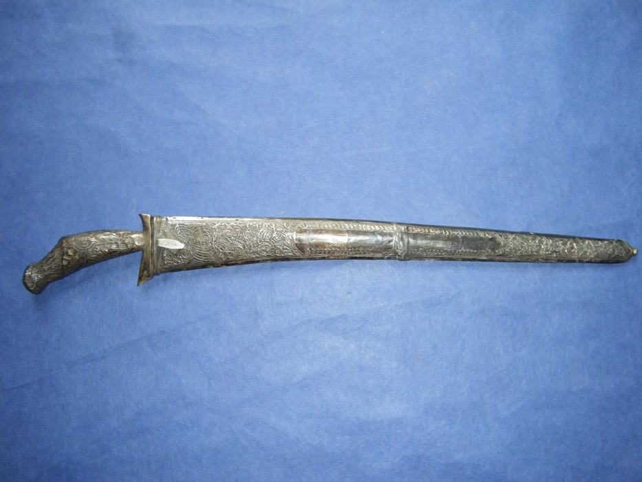

Default One more
I look forward to comments about the ethnicity and social status of the person who might have first owned this sword.

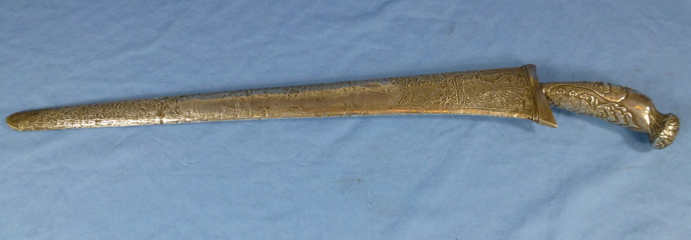

Yes, a nice complete pedang lurus from Java and better as my own example.
How long is it, blade and complete? The ethnicity is Javanese. Status I can't answer, maybe Alan know more.
Old 12th August 2013, 07:53 AM   #7
Posts: 7,015
In Jawa, pedang were not status indicators, as keris could often be, and in olden times, were.
However, one would not expect to see a common man with a silver mounted pedang, nor would one expect to see a ruler with a silver mounted pedang. The ruler would very probably opt for gold, the common man for wood, if he even owned a pedang. Mostly common soldiers were armed with spears, and often those spears would not even have iron tips but were simply sharpened and hardened bamboo; this was particularly the case where levies were involved.
This is a pedang of pretty ordinary quality, not outstanding in any way, but it is a good, solid, functional piece in dress that could be used in a formal setting. I would expect to see such a pedang as the property of a middle ranking noble, not a man of exalted status, and not a common soldier.

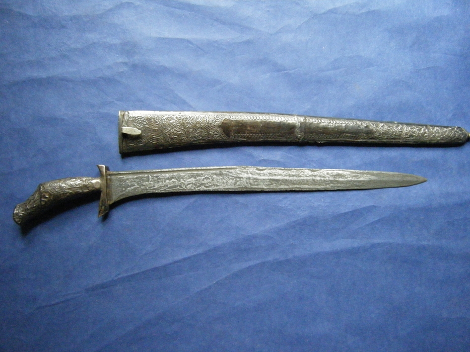

Posts: 9,207
Here for comparison my example, not fom the much better quality as your one.

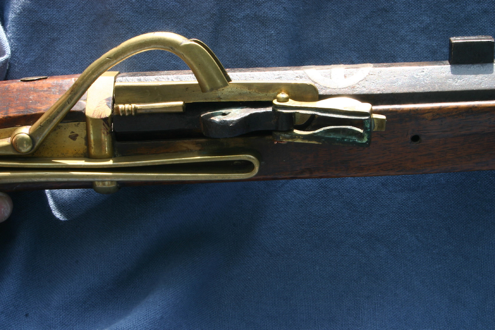

Of course the obvious impact was that the Japanese were still using 16th century matchlocks in the 19th century. Their use however had been elevated to the status of one of the Samurai's arts.

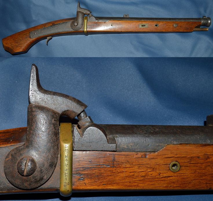

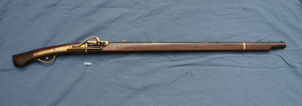

The Japanese did try all manner of updates to their matchlocks, they even converted them to percussion, photographic evidence suggests that this happened a lot more than was previously known.
The problem was that the assembly line made European firearms had evolved to the point that the Japanese method of gun making could compete with the Europeans and most of the individual Samurai domains did not have the finances to purchase European firearms in the quantity needed to make a significent difference, although a few did this and fully equiped with modern European firearms.
Here is a link to a Pinterest page with many examples of non matchlock firearms used by the samurai, both domestically made and imported. Below is Japanese matchlock pistol convereted to percussion.
