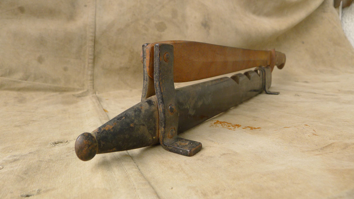

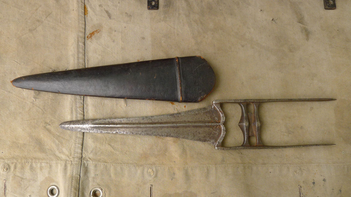

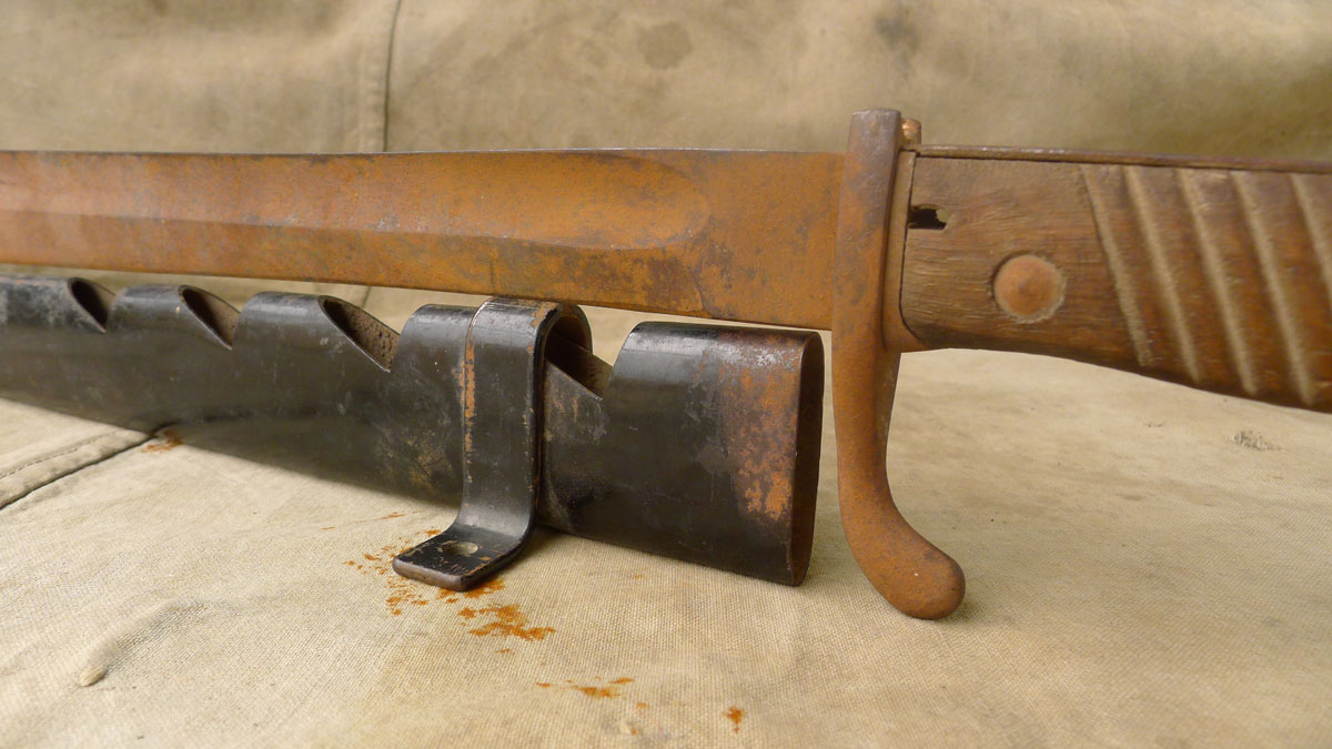

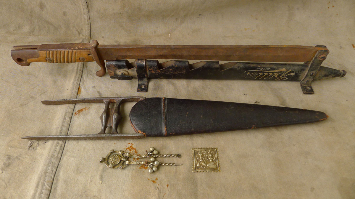

Gents,
here is some souvneirs that I brought home recently.
The Katar should be okay.
The Splitter is interesting but probably does not fit this forum.
Cheers,
taube.

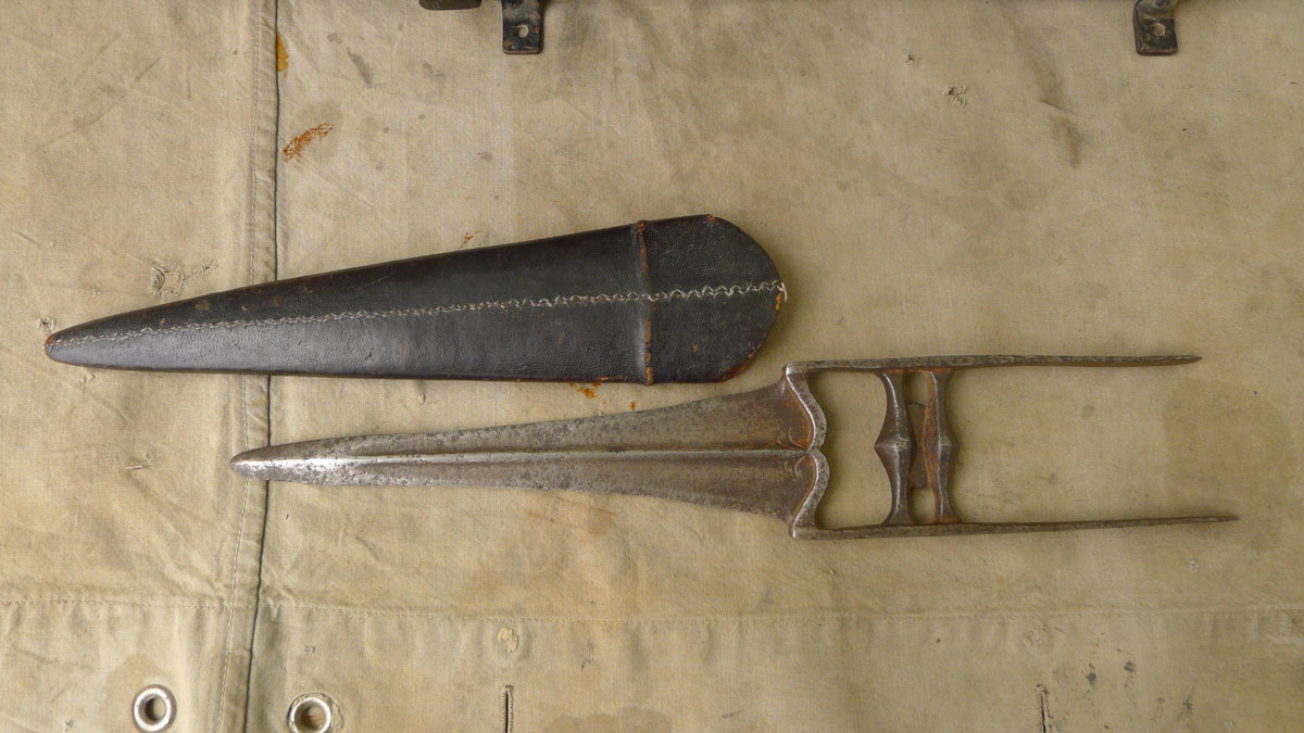

Interested in your Katar as I think I have its twin. Mine has a new made scabbard but I am particularly interested in the small crescent like marks at the base of the blades. I was told these were armoury stamps but they look more like simple decoration to me. Do these help date these blades? I know dating is very difficult and examples are still being turned out and then convincingly, if fraudulently, aged.
I include measurements for my example.
Weight: 10.2oz (0.29kg)
Length overall: 18'' (46cm) Blade: 10.5'' (27cm)
Width of grip: 2.53'' (64.4mm)
Profile taper: 2.37'' (60.3mm) at ricasso, 1.08'' (27.4mm) at mid blade, 0.78'' (19.9mm) two inches from tip.
Distal taper 0.25'' (6.5.mm) at ricasso, 0.19'' (4.8mm) at mid blade,. 0.21'' (5.3mm) 2 inches from tip.
Any thoughts and opinions from forum members gratefully received.

Hi Robert,
quite similar indeed.
Not being an expert at all, I thought of mine being an everyday use, low budget example (hopefully).
Would be pleased to hear some long term collectorīs opinion.
Cheers,
taube.

Hi Taube, Robert,
The decoration at the base of your jamadhar are stylized lotus buds. They are important in Hindu symbolism, associated with creation and the gods Vishnu and Brahma IIRC.
The word Jamdhar can be interpreted as a distortion of "Yamadaushtra", derived from "Yama" (Lord of death) + "Daushtra" (tooth in Sanskrit). So "Death-Tooth". Forum member Bhushan pointed this out some time ago, and I believe there is also a reference to it in Egerton.
The combination of a death iconography with a creation one in interesting.
This would place the dagger within the Hindu sphere, maybe not the Mughal. It brings up a very interesting thought about the Mughal's adoption of these daggers. Very hard to date these daggers as they were produced and used all over India well into the late 19th century.

Taube, looking at your scabbard I wonder if yours is a Nepali piece. The scabbard construction is very similar to that seen on khukri.
Thanks, Emanuel.
Very interesting aspects you are hinting at.
I just liked the piece as an object but you are really filling it with life.
My Katar was purchaseded in Jaisalmer, Rjasthan.
Of course, you can never be sure about sellerīs appraisals.
He stated his items are from the surrounding area.
taube.
