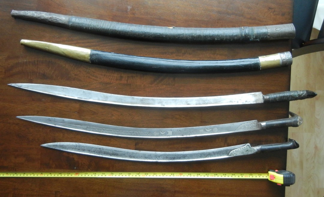

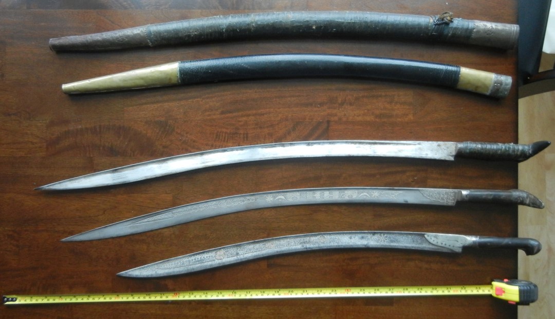

Hi everyone,
After a long pause I recently acquired these three Yataghan. I am most attracted to this type of yataghan because they are substantial, heavy-duty pieces, much sturdier than the thinner, slimmer, fancier type. They also feature an integral bolster construction that doesn't actually seem to be that wide spread in European/Mediterranean/Ottoman weaponry.

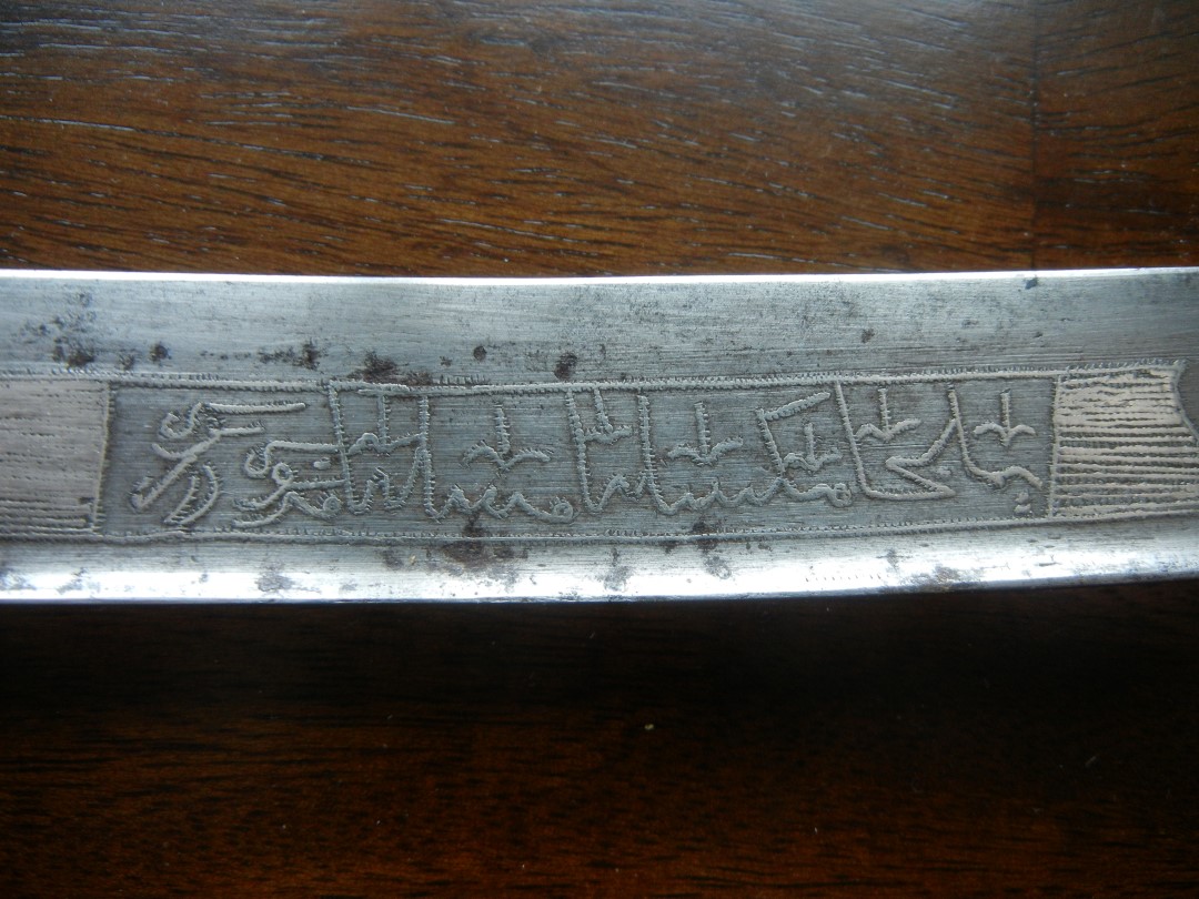

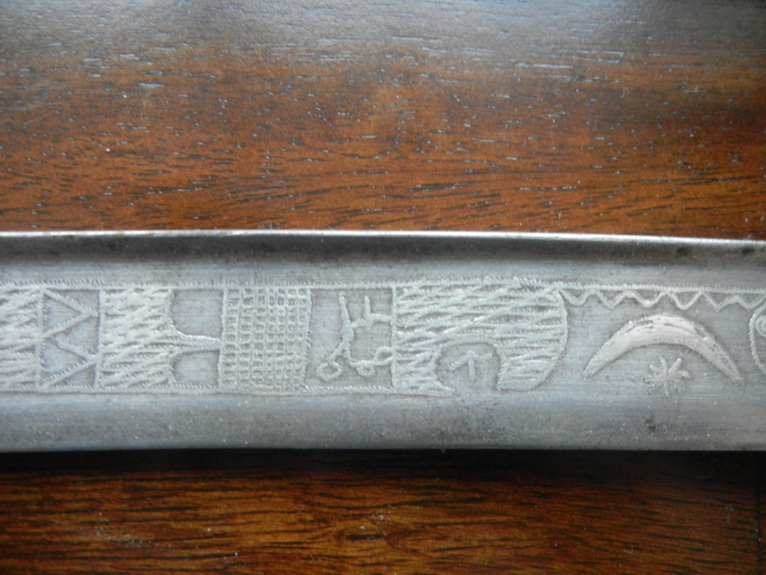

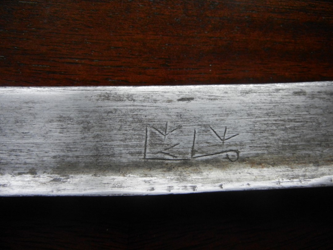

The top one is a monster, with 29" (74cm) blade that is 1.3cm thick at the base. The bolster is almost 3cm wide. With a large horn T-pommel, the type is associated with Zeybek irregulars/mercenaries The blade has scratched decoration on the surface, can anyone decipher? The scabbard is wood wrapped with leather and green fabric strips, similar to the kind seen on some Surmene and Laz weapons. The rough scabbard throat and tip might be tarnished silver, or just steel. I think I see 1913 very roughly punched on the throat. An identical one is pictured in this old thread

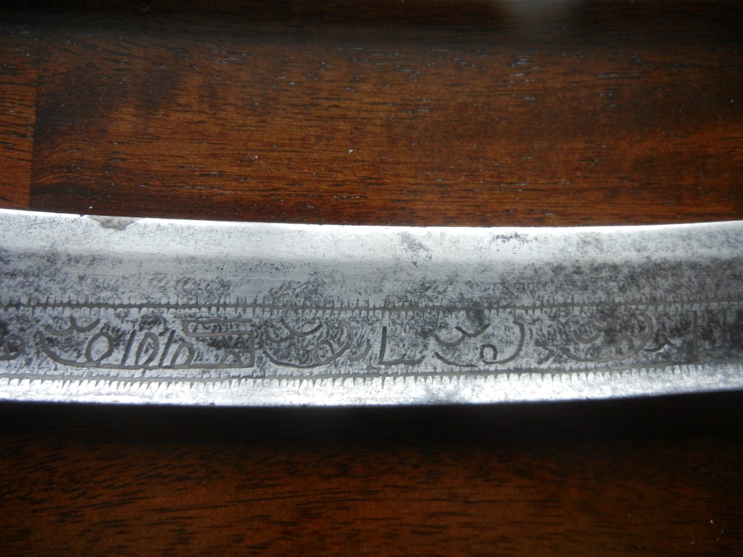

The second one shows better quality, and I had thought it might have a Turkish ribbon pattern-welded blade. I will know after a trial etch. The large blade is 28" (71cm) long. The T-pommel had a piece broken off and reattached with some putty. It broke during shipping but I should be able to re-attach it nicely. The scabbard is leather glued over wood, with brass throat and tip. The blade doesn't fit in very well so maybe it wasn't original. This blade seems to have lots of silver inlay and overlay, made with the later triangular punch technique. Can anyone translate any of the cartouches? In one or two cases I'm not sure of the correct orientation.

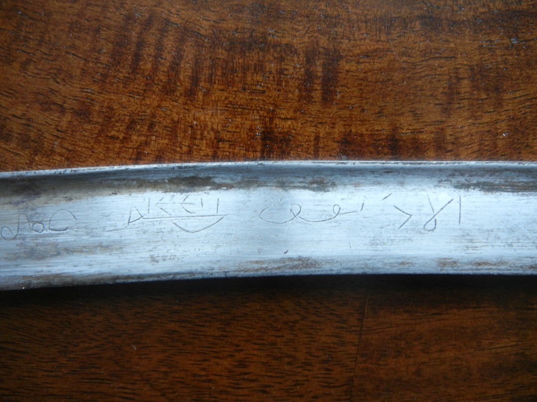

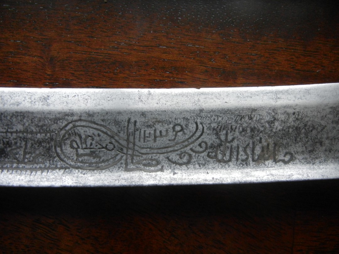

The bottom one shows the best quality. The blade definitely has Turkish ribbon construction and it has nice brass inlay. It is dated 1239 = 1823. This would make it the earliest dated yataghan with integral bolster I have seen. The blade is still generous, at 24"(60cm) long and 1cm thick. The profile of the T spine is more refined and lighter than the larger two. Here is one with very similar blade.
Any thoughts of comments about the very large yataghan in particular and how they fit in what we know about this weapon style?
Thanks,
Emanuel

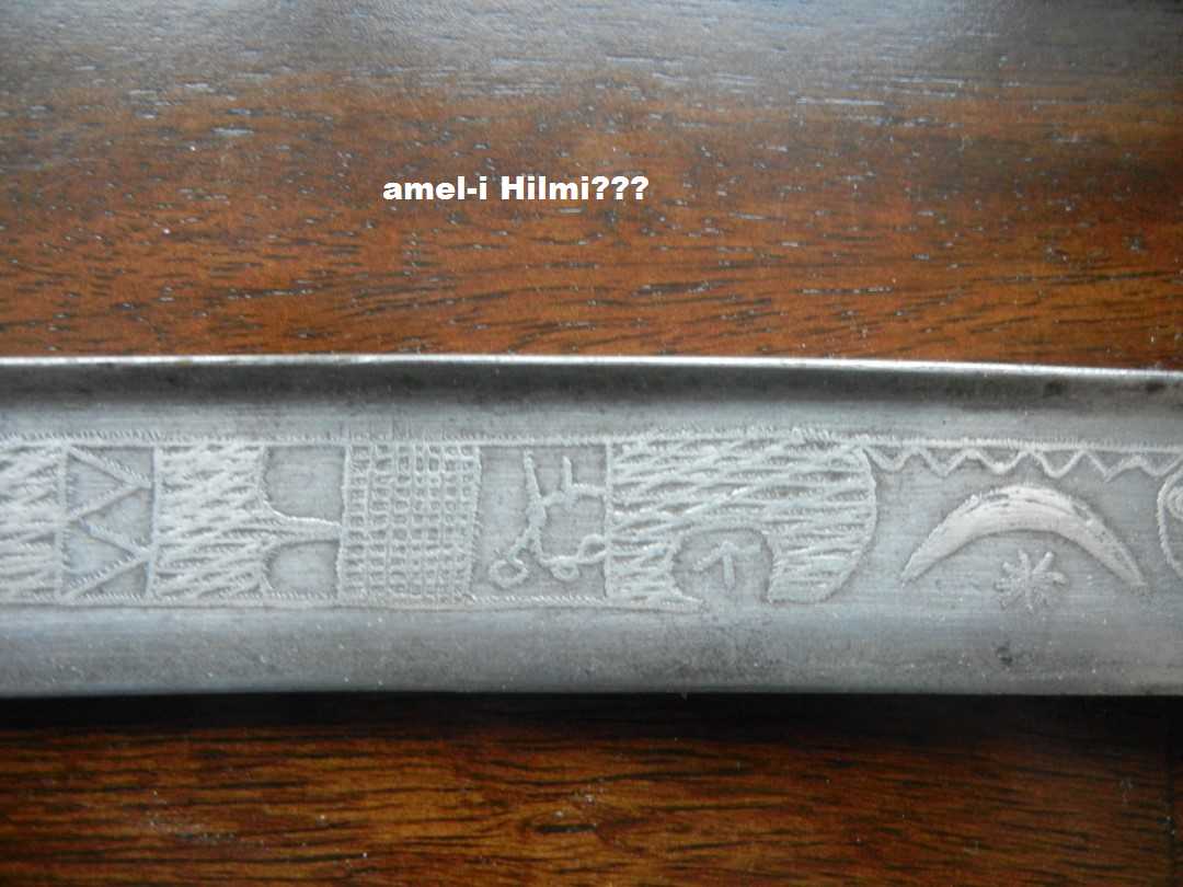

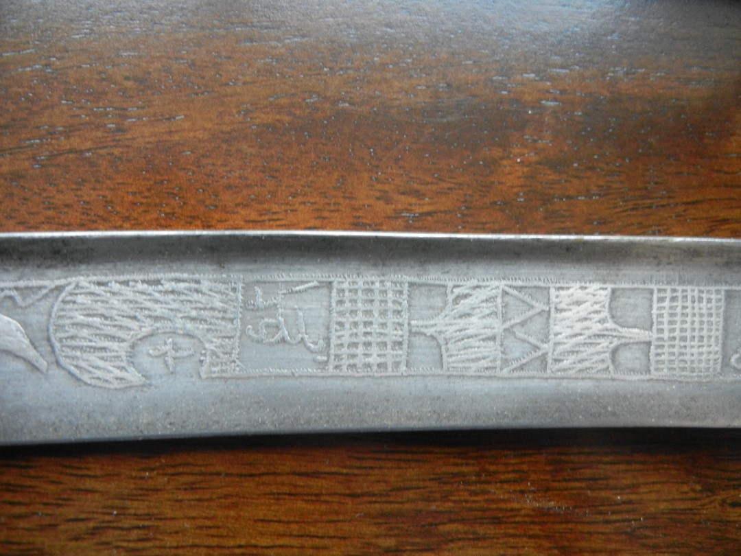

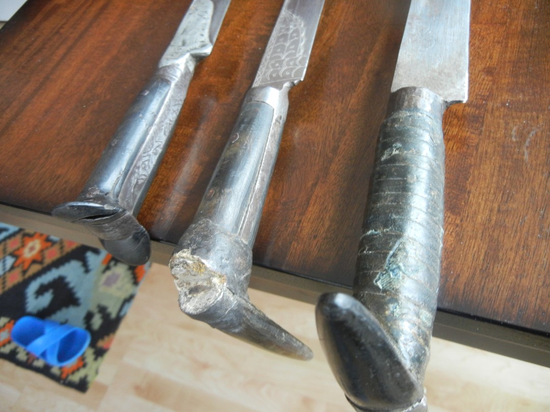

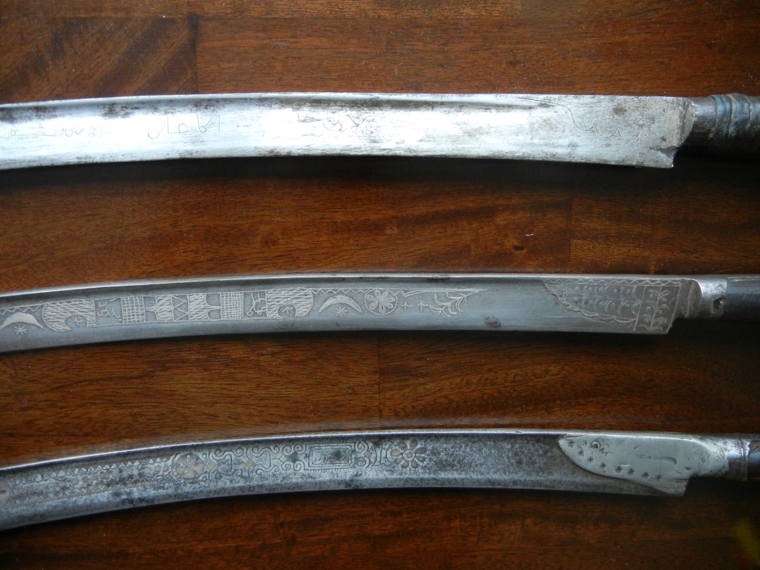

Default Top one
Detailed pics

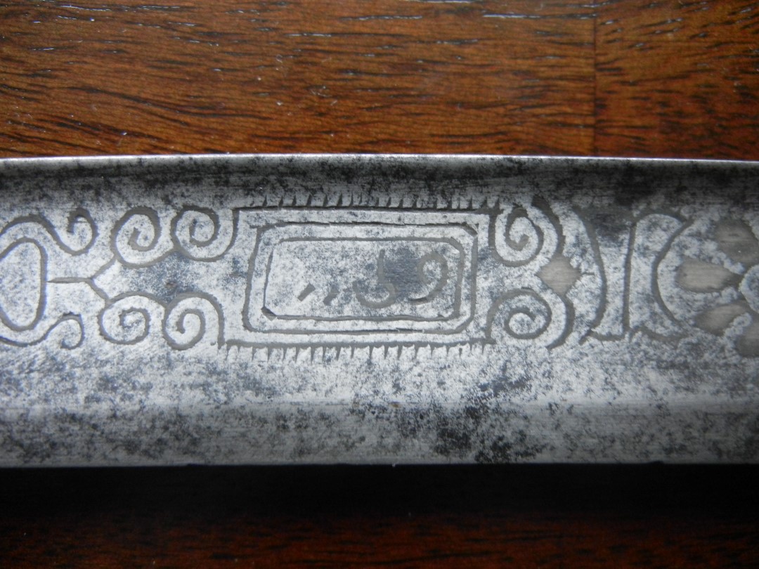

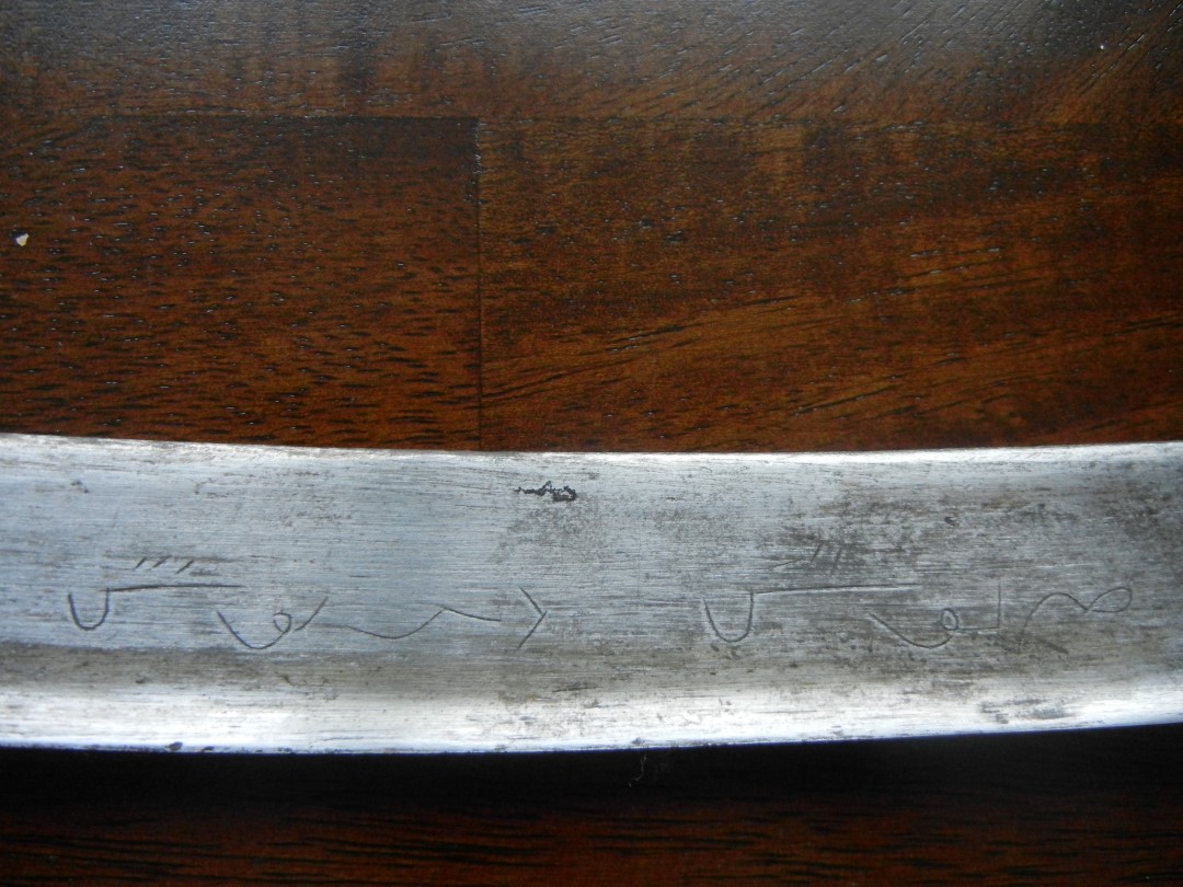

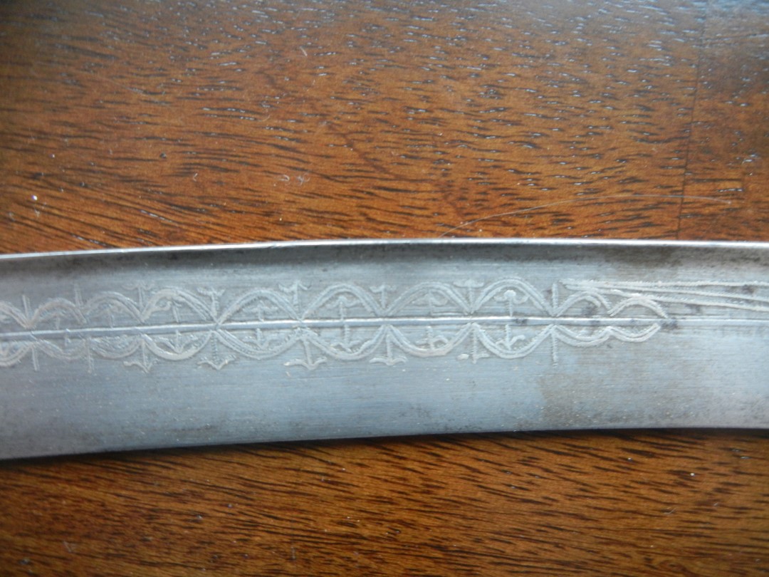

Default Middle one
Not sure about the orientation on some of these.

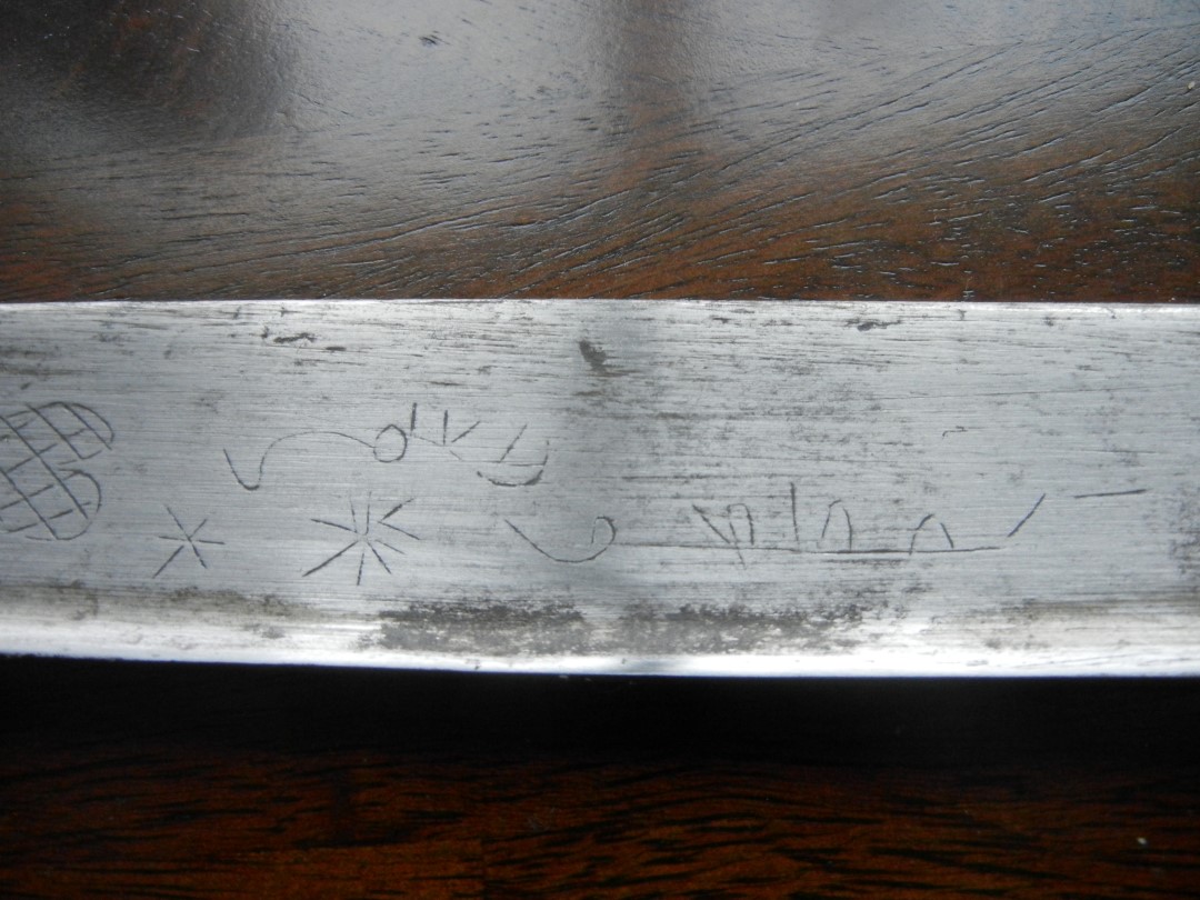

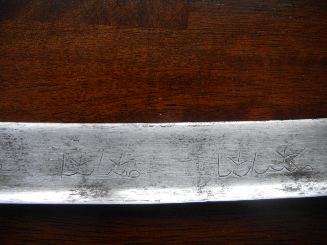

Default Bottom one
And the nicest one

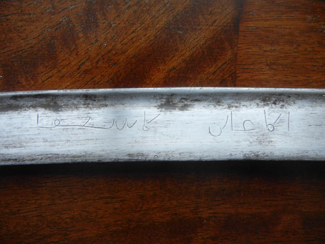

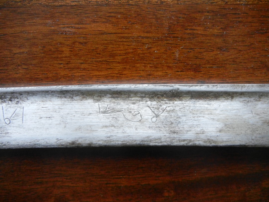

Originally Posted by Emanuel
Detailed pics
Do I read this correctly as a stylized 1279 = 1862?
Another inscription on the top yataghan.
Old 19th March 2014, 07:26 PM   #6
Zifir
Zifir's Avatar
Location: Istanbul
Posts: 228
I will start with the post #5:
As far as I see it's; li-sene 1331 / Year 1912/13
The inscription:
Lā fetā illā Ali, lā seyfe illā Zülfikār / There is no hero like Ali, there is no sword like his sword (zülfikar)

Post # 4
Maşae Allah, 1239, sahib Mustafa / As Allah wishes or willed (a phrase used to show appreciation -as well as to avoid casting a bad eye on something), Year 1823-24, owner Mustafa
Emmanuel can you post the rest of this picture, because I cannot be sure without seeing it.

That matches the 1913 on the scabbard then. So this makes the large yataghan the latest I have seen, and an example of 20th century production
This also matches what Sancar and others have said concerning these monster yataghan with T-pommel being more for show. The craftsmanship is quite poor, despite the large quantity of steel.
I will take better pictures of the inscription on the bottom one tomorrow.

Post # 2
Names of seven sleepers and their dog:
Yemliha, Meksalina, Mislina, Mernuş, Debernuş, Sazenuş, Kefestetayuş, Kıtmir

Posts: 228
Post #3,
similarly some of the names of seven sleepers:
but the rest are missing.
I am not very sure about the makers name, and I could not the second inscription.

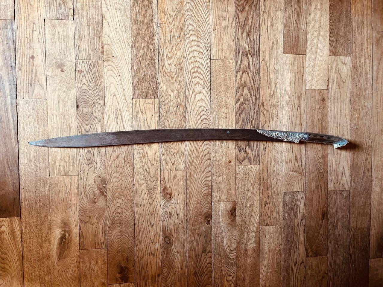

According to the seller this yataghan is 113 cm long. Unfortunately not mine so I can't confirm it.
