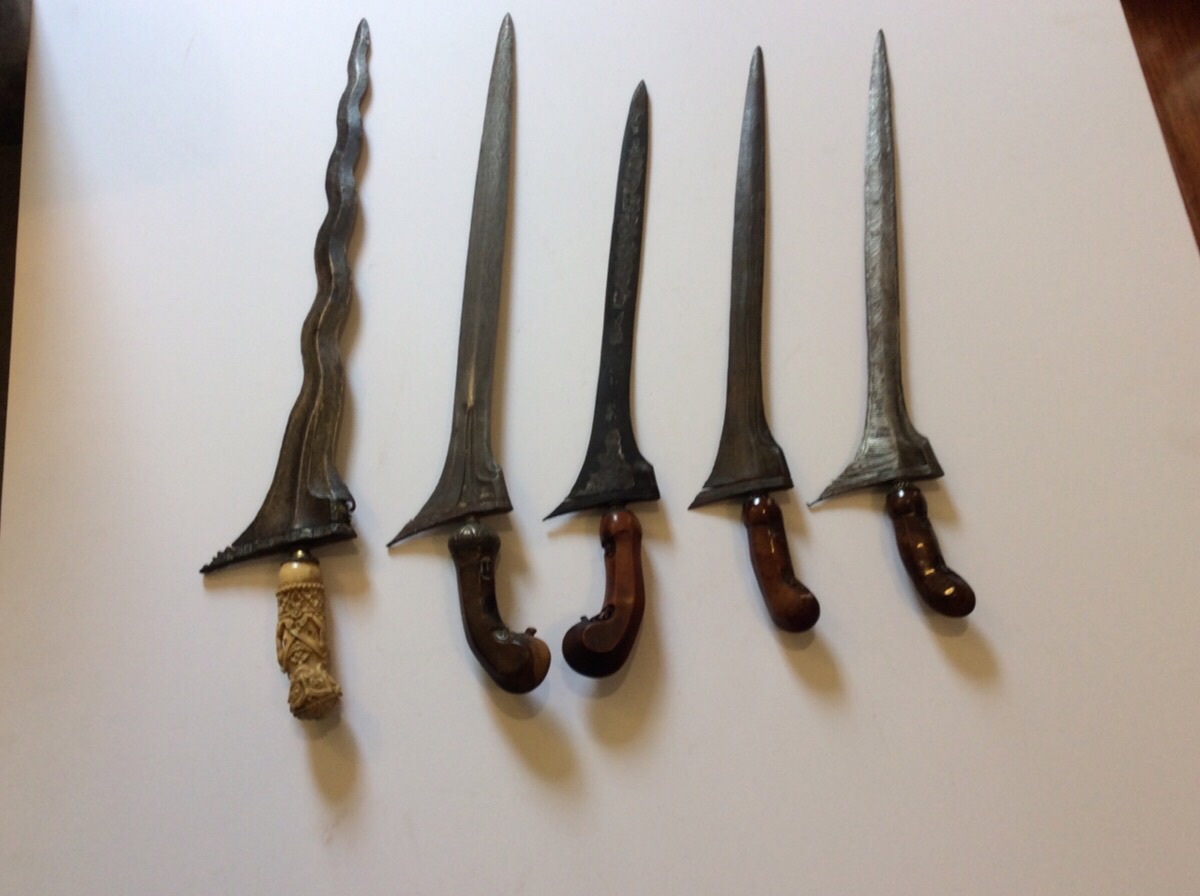

It has been a little quiet on the forum and we did this once before and it seemed fun and informative. I am posting pictures of 5 Javanese blades and am curious as to thoughts about age. I'll post thoughts with each individual detail picture for sharing and to open the door for alternate opinions.

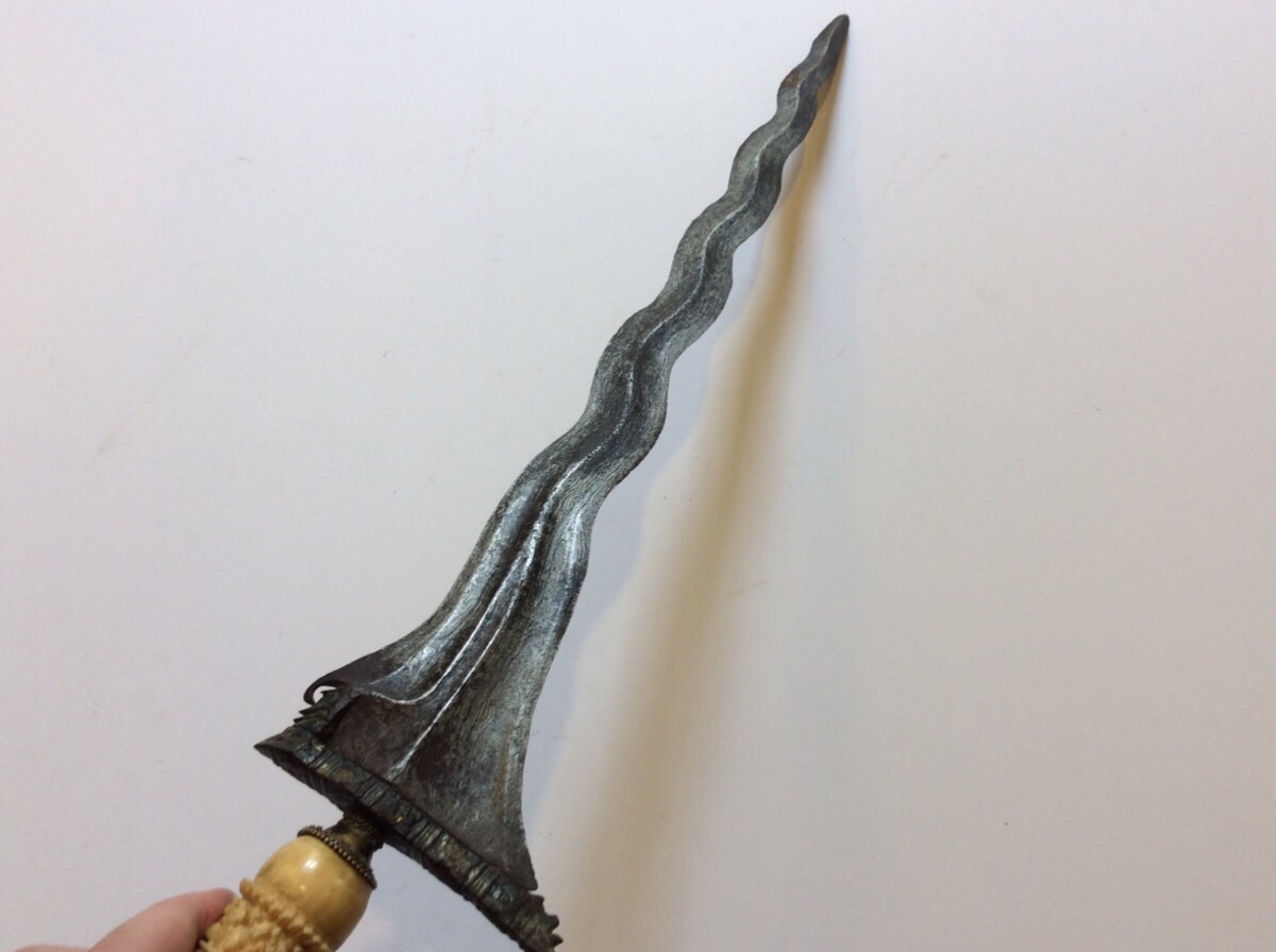

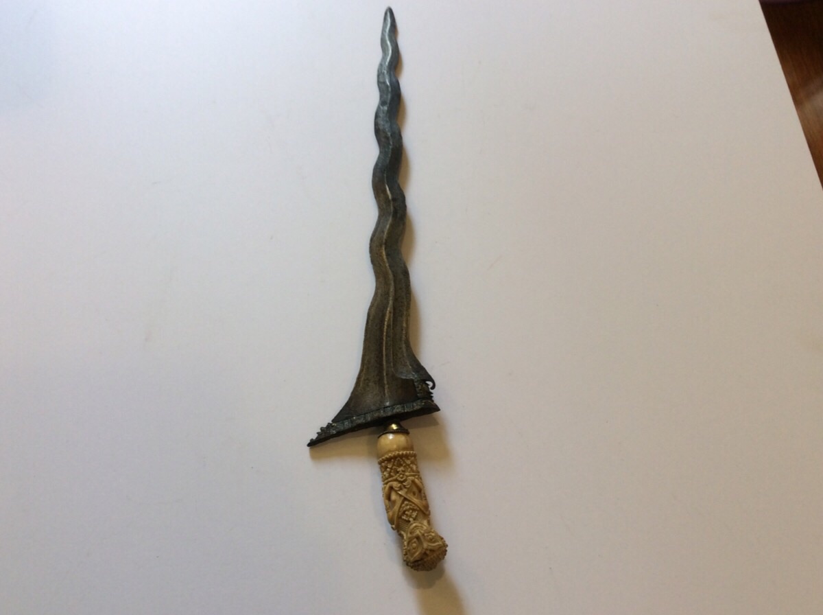

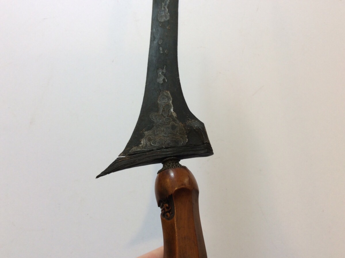

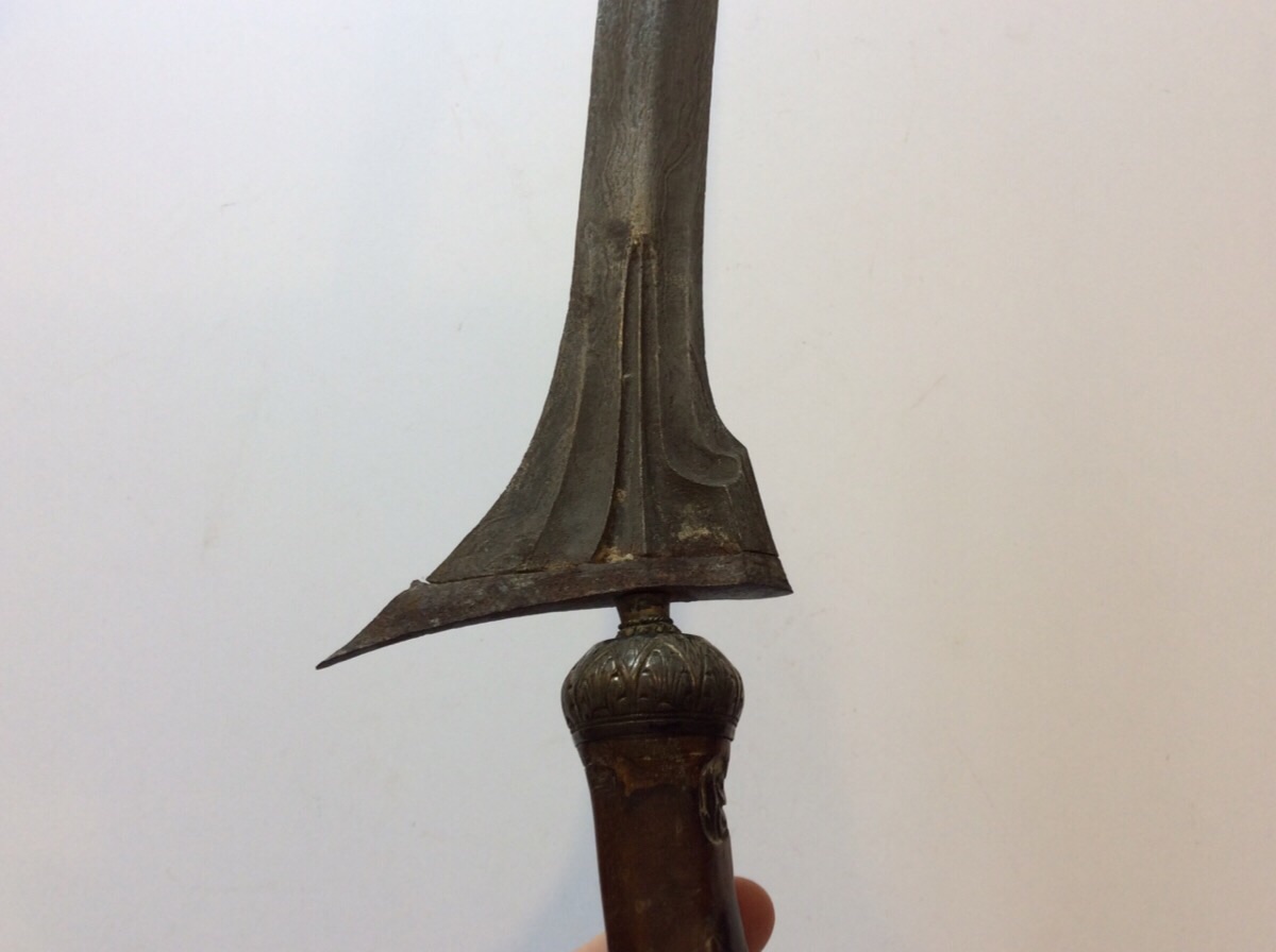

So if I go left to right this first one has a very robust blade, very thick ganja and seems quite old to me. I would guess 17/18th century for the blade. I understand all,opinions are taken from pictures and are not to be taken as fact when there isn't the opportunity for hands on examination. Opinions are for fun and information.

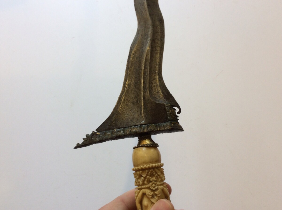

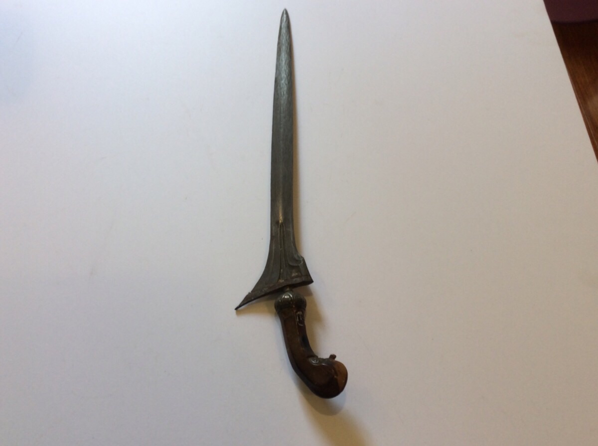

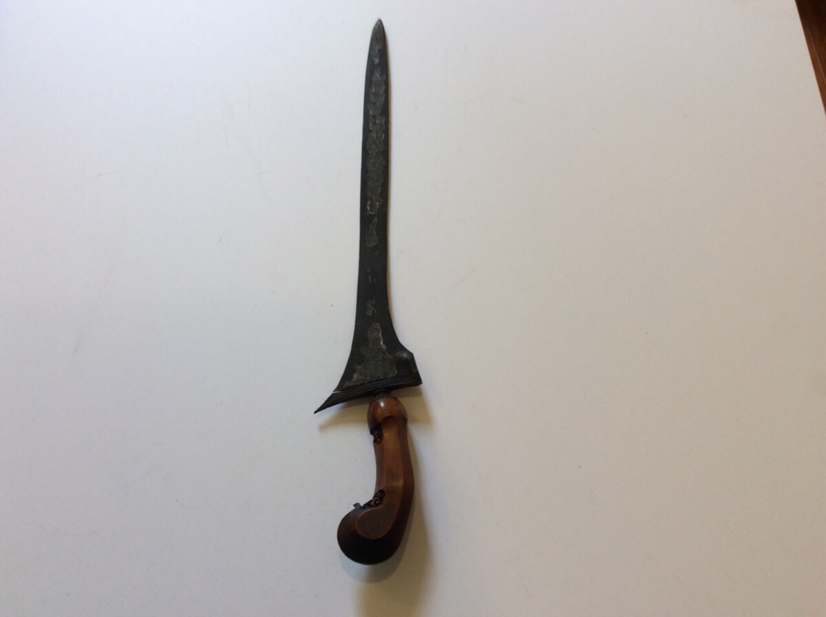

Blade #2 is a robust stout blade. It is a fairly recent addition so my apologies for it not being properly cleaned and oiled. Will get to that. My guess is that this one is 19th century.

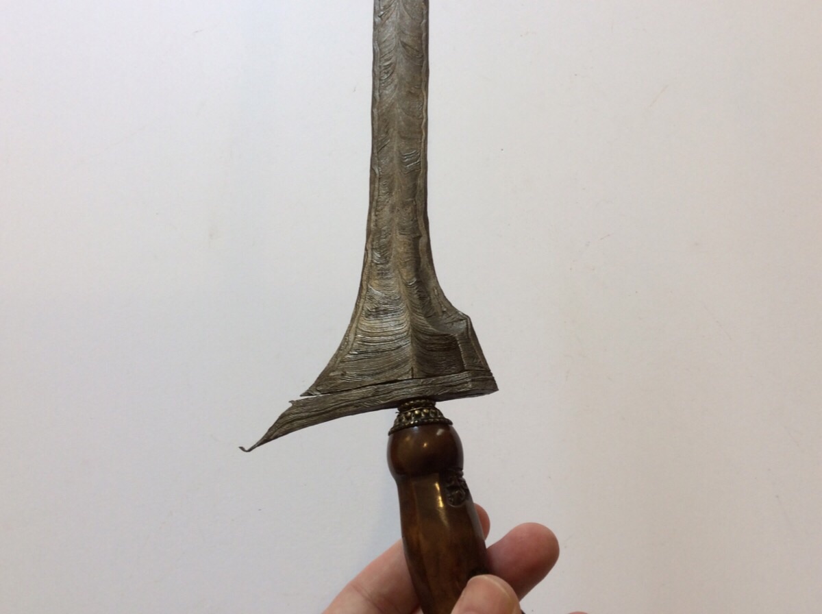

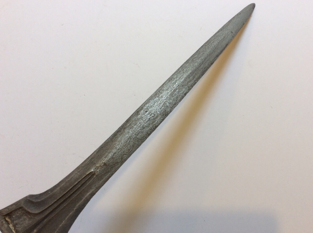

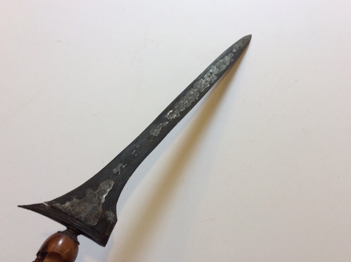

Keris #3 has a fairly thin blade. Seems to have been through a number of ritual washings in its life. Nice pattern with floating islands of silver pamor. I suspect this one is sneaky old. My guess is 18th century or earlier.

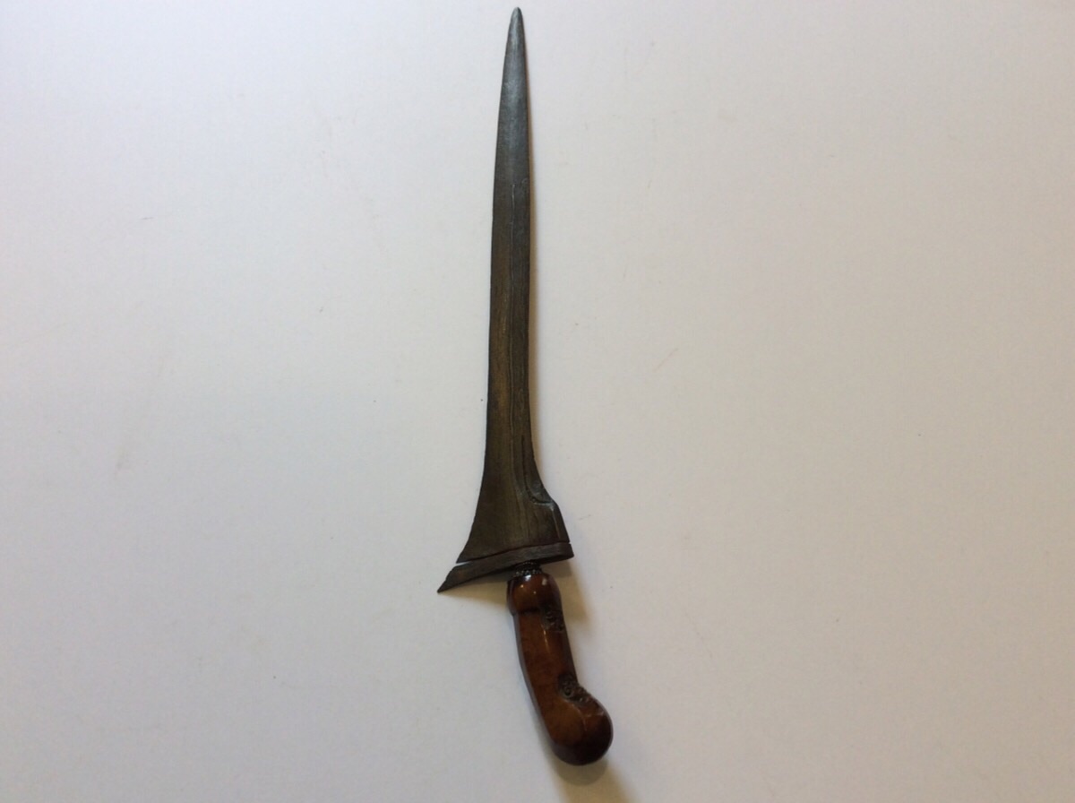

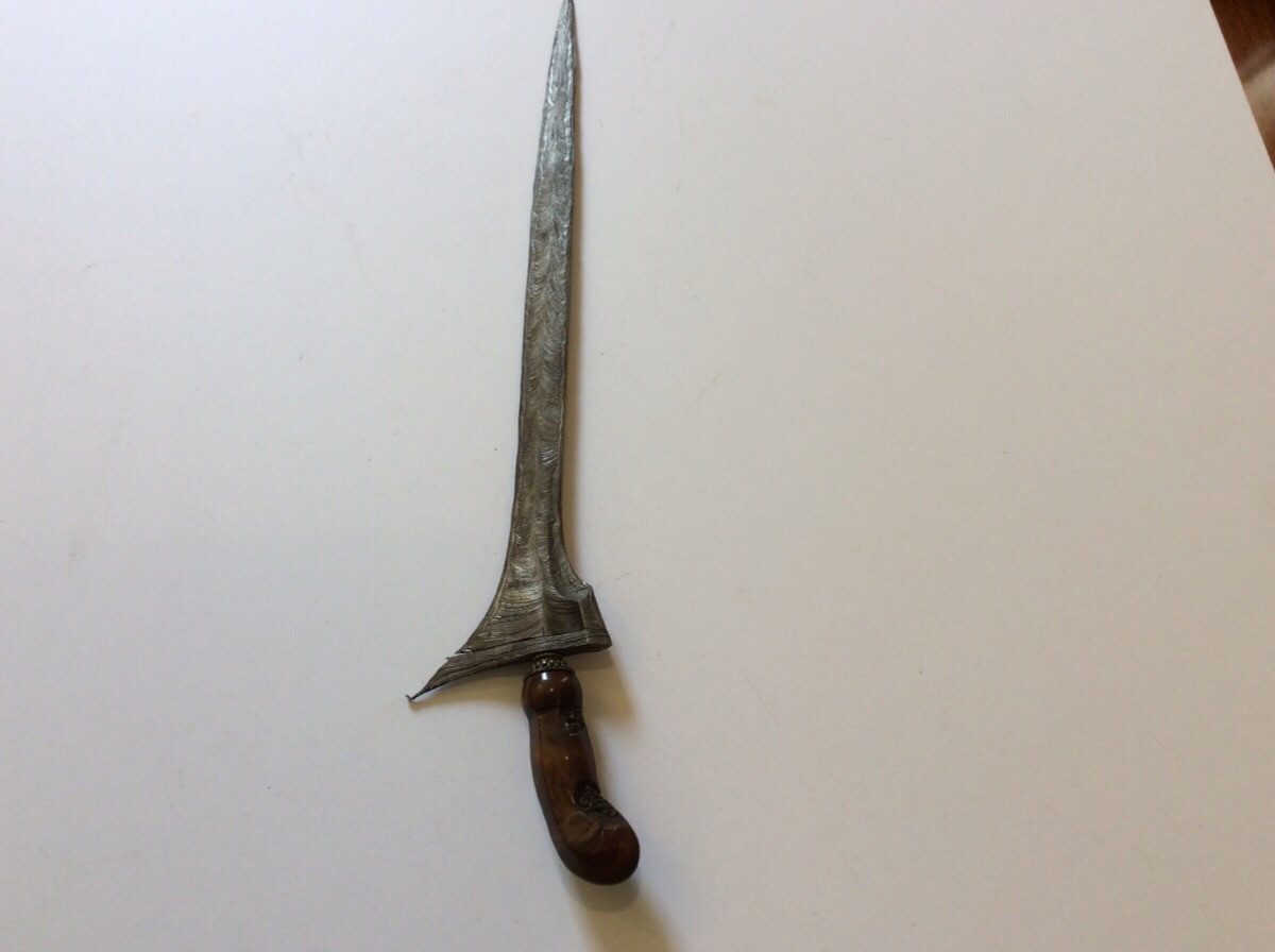

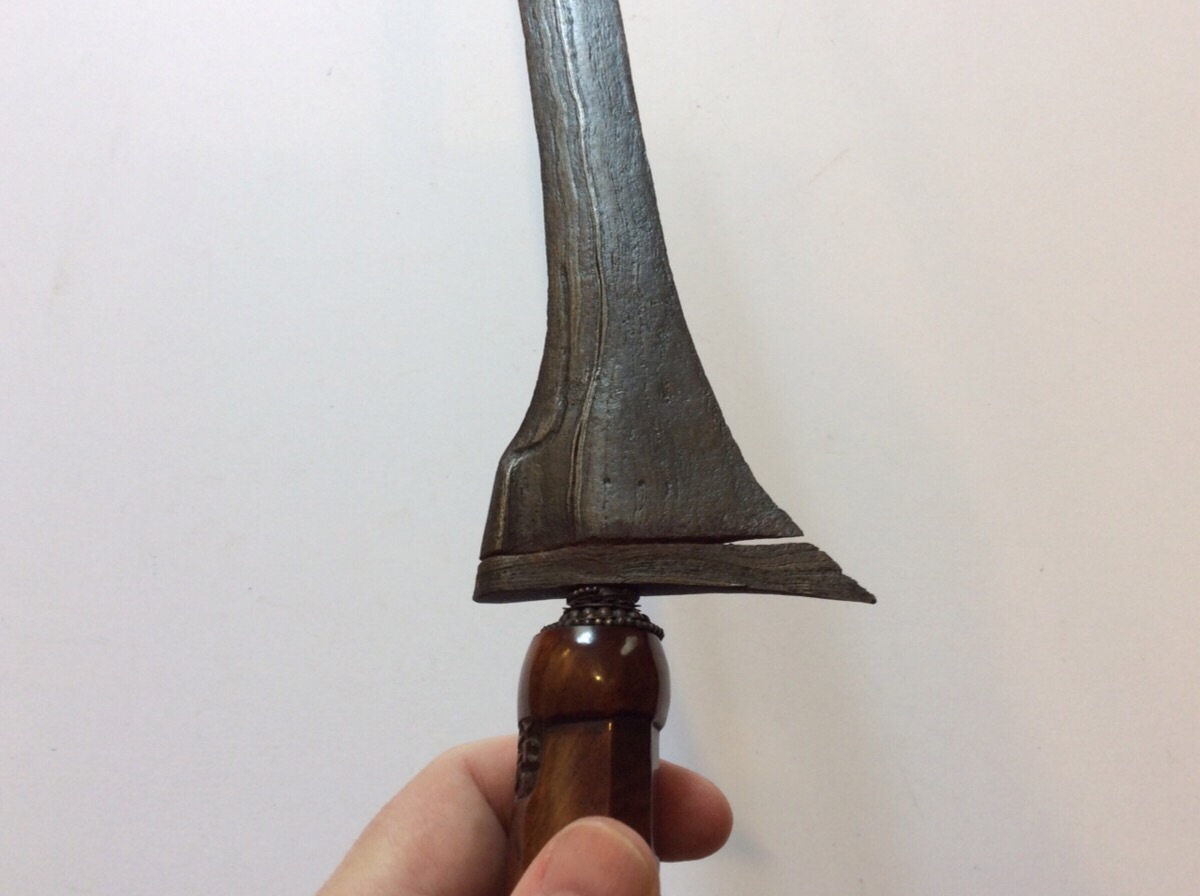

Keris #4 seems a fairly ordinary blade. Not thin nor robust it sits in the middle from a heft perspective. Longitudinal pamor might grade up if it was in stain but as is seems fairly ordinary. I'm guessing 19th century to maybe early 20th century.

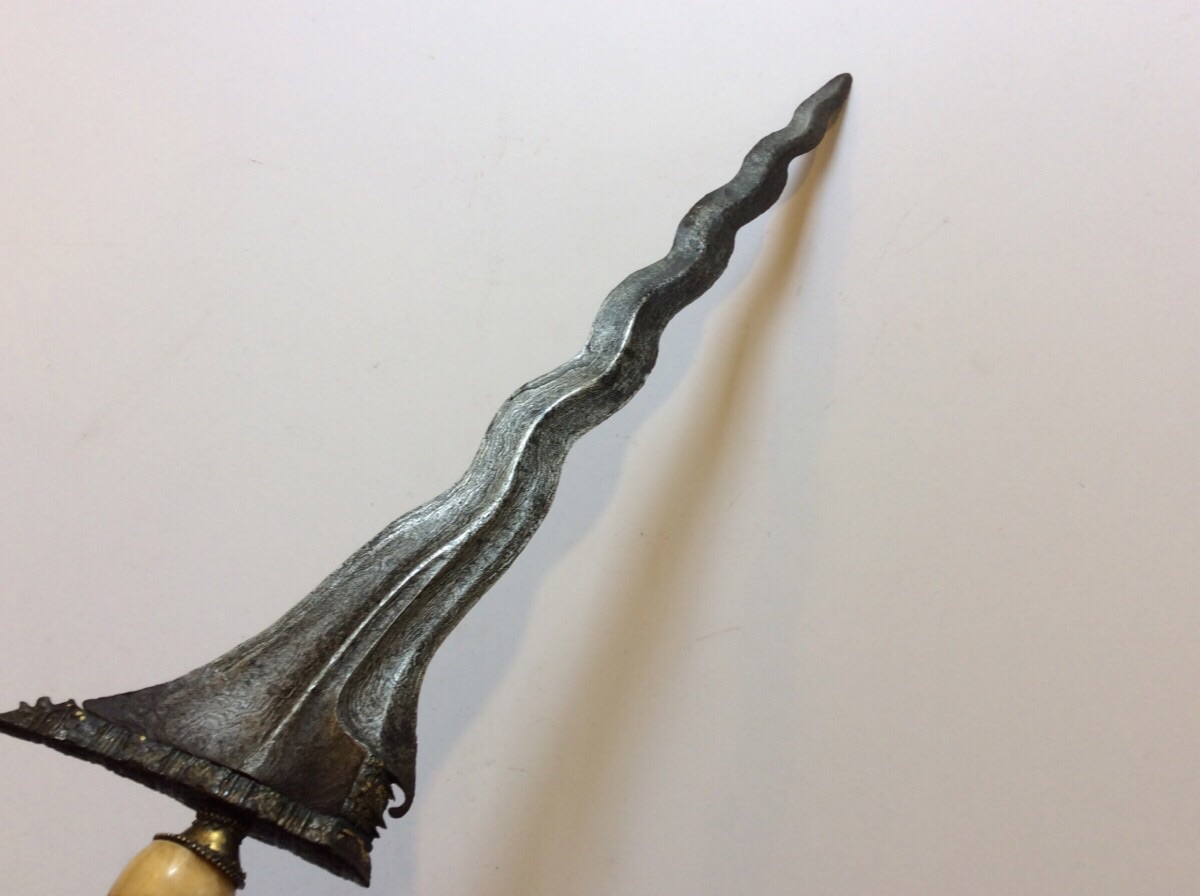

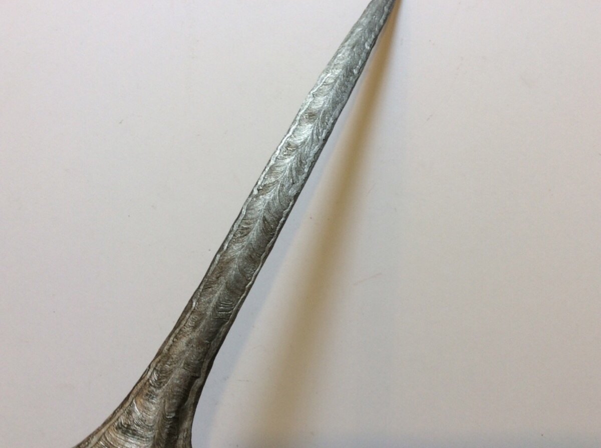

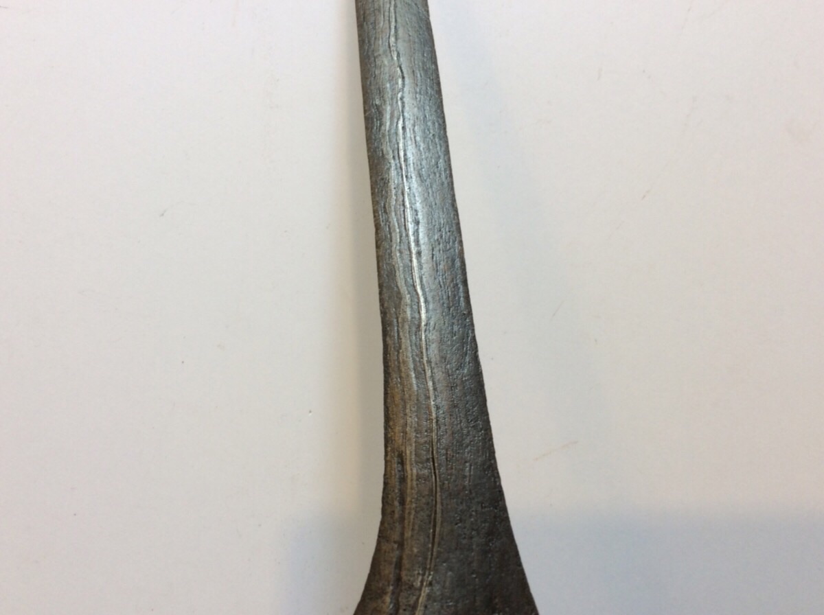

Keris #5 has a fairly bold "chicken feather" pamor. It seems a lot of this style of pamor are contemporary. This one seems different because the feathered pattern is captured between the edge ridges. Not a good description of what I am seeing but hopefully the pictures illustrate what I am talking about. I don't know how old this type of pamor is but my guess is that it is fairly recent. So I will guess this blade is late 19th to early 20th century.

This is intended to be fun and share our guesses as to age. Again, caveat that this is being done from pictures on a computer screen so I won't hold anyone to it. Curious if folks agree or disagree with my guesses. I'm also curious if the consensus tends to be the same or if any of the pieces illicit a variety of opinions.

Post #5, keris #4, is the oldest blade, the others I'm not prepared to give an opinion on, simply too many missing pieces and absolutely no knowledge of the history.
Just based on what I can see in the pics, I'd probably be prepared to place all except #5 into the 1800's, but there are a couple that could be earlier, and one that could be very old indeed.
But from pics?
Nope, not possible for me I'm afraid.

Thanks for the thoughts. For the 2 that could be earlier and the one that could be very old are there additional pictures or information I can provide to help?

Thanks for asking, but no, no additional pics or info would assist, I'd really need to handle them.
I have a whole heap of photos of old keris that are in museums in Europe, many were collected pre-1800, some pre-1700. If these keris were stripped of dress and even very, very good photos were presented for opinion probably most people would guess them at less than 100 years old. You just cannot tell very much from a photograph.
Even when you have it in your hand, it becomes an educated guess to put an age on it.

I only can tell you that blade #1, #2 & #5 seems to be better blades to my eyes. I am correct that I see traces of gilding at the gonjo by blade #1?

If we are now looking for tangguh classifications, rather than age estimates, that's a game that I'm quite prepared to play, in spite of the fact that these keris under discussion are not of very high quality, nor in particularly good condition. However, I need some more photos.
I need the hilts to be removed from all keris, and close ups provided of the top of each gonjo, looking directly down on to it, and with the pesi not obstructing the gonjo top.
I also need a close up of each pesi.
I need a close up of the mid-section of each blade , this should be of only about 3 or 4 inches of blade.
For blade #5 I need several close ups of both sides of the gonjo joint (ie, where the gonjo joins the blade), and close ups of the base of the pesi where it enters the gonjo taken from both sides. These base of gonjo shots should be taken at an angle looking down onto the edge of the hole where the pesi enters the gonjo.
If I can see those photos I'll do my best to provide a qualified opinion in respect of tangguh.
Incidentally, where blade quality is concerned, keris #2 appears to be far superior to anything else in the line up. To a degree this opinion can be confirmed by close examination of the entire blade:- if the side we cannot see matches perfectly the side we can see, then this is a very competently made blade. By "match perfectly" I mean that the placement, size and form of all features is precisely the same on each side. "Precise" means exactly that.
