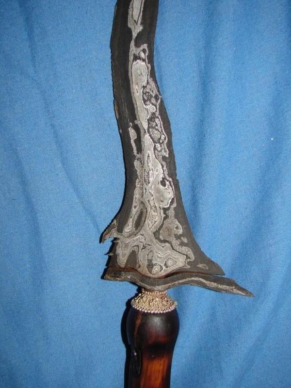

So, how does the keris of the Majapahit tangguh look like? I think I may have a vague idea on one of the possibilities of the shape (Not material or tanting) of Mojo keris according to tangguh system, for a luk 9 keris with ganja wilut - from our previous discussions. I attached the picture below and I hope I didn't get too far from what can be accepted.
I am sorry I had forgotten where I get this photo from to give credits. Also sorry if my writing is rather incoherent.

Rasdan, I would prefer not to comment on this keris, I don't want to get bogged down in a tangguh discussion.
Please accept my apologies.
