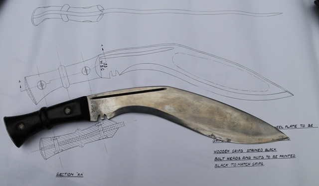

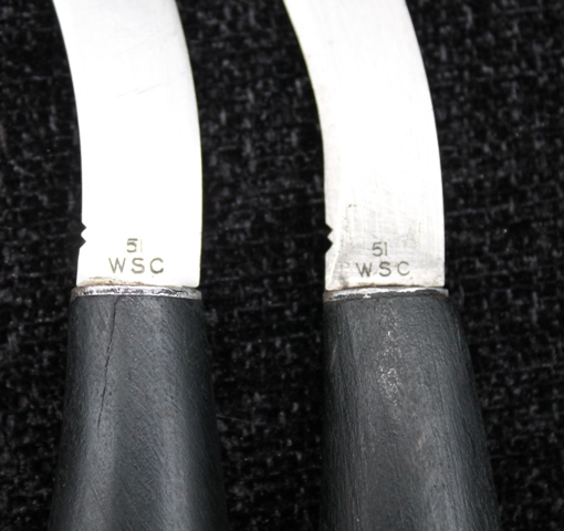

Wilkinson Sword Company Kukri (WSC 51)
Below is some basic information about the Wilkinson Kukri, which I have been researching in depth for some time. There will be further information coming in the new year, as some breakthroughs have been made, which I am currently in the process of collating.
My thanks go to Robert Wilkinson Latham for allowing me free access to important historical documents, and for his kind assistance with my many questions.
The initial design process began sometime during mid 1949, with the final design being sealed on 12th October 1950.
During this time, Jack Wilkinson Latham, the then Managing Director of Wilkinson’s, questioned some of the specifications given by the war office. Chief amongst these were the strict inspection tolerances concerning the Kaudi. Upon further enquiry, it was ascertained that it was the Chief Inspector of Ordinances opinion that the kaudi was used as a sight, so that the kukri may be thrown with accuracy, and should therefore be produced to the same tolerances as a rifle sight!
Needless to say, after a short discourse on the history and construction of the kukri, the ordinance relented, and the blade and kaudi were allowed the same tolerances.

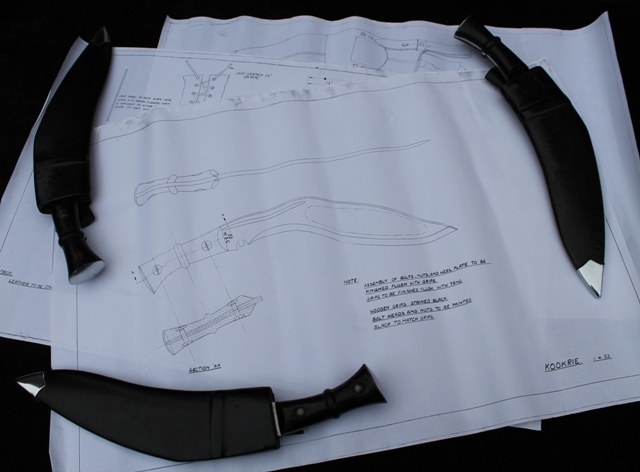

Officially designated MK IV/MK4. These names appear on the official Wilkinson Sword productions drawings.
Interestingly both the terms “Kookrie” and “Kukri” are used on the Wilkinson Sword Documents, the documents being updated in 1968 with a Nato stock code (1095-99-962-0535)
The MkVI was also referred to as “Kit kookrie MK1” in official correspondence with the Inspector of Armaments during 1969 , but this refers to the kukri, scabbard, frog, karda and chakmak as a unit.
It is estimated that 1402 were finally produced by Wilkinson’s. This is an unusually small amount for a military production run, Less than 10% of serving gurkhas at the time would have been issued with them. This lends credence to the theory that the WSC order was an experiment in logistics, quality and costs.

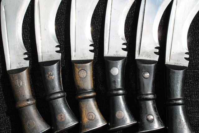

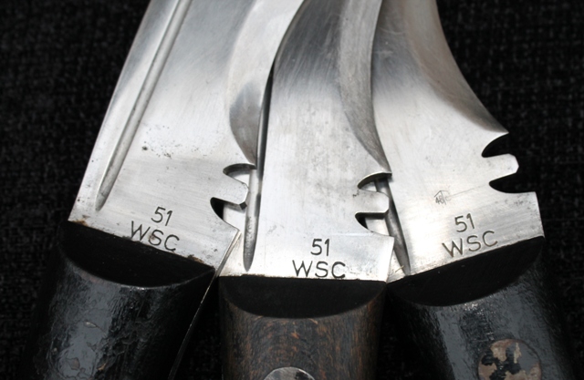

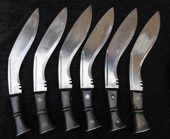

It does not take a kukri “guru” to see that the Wilkinson MK IV was based on the WW2 designed Mk III. Placed side by side the resemblance is striking. However, upon closer inspection there are certain features which set the two Marks apart.
Wilkinson’s produced a high quality kukri. The blades were all hand forged, the butt plates and scabbard chapes were both chromed. The steel used in production was to Wilkinson’s own specification. Such products don’t come cheap, and it is easy to see why the initial order was for such a small number.
Of the kukris produced, 1400 went to the Army, two were retained by Wilkinson’s themselves as samples for possible future orders.
Despite Wilkinson’s maintaining a dialogue with the Ministry regarding further production, none were ever made. Cost seems to be the main issue, as Wilkinson submitted plans for more cost effective models, but by this point, the MK5 had reared it’s ugly head, and sourcing kukri in India was by far the more cost effective solution.
So what became of the 1400 that were produced and issued? Most seem to have found their way to the Far East, for issue in the Malaya and Borneo campaigns.
Such unforgiving jungle environments probably did nothing to improve the chances of survival. Infact, fifty (50) examples were returned to Wilkinson who were asked to rehilt warped English Beech grips. Later they were tasked with supplying a further four hundred (400) replacement hilts and rivet fittings.

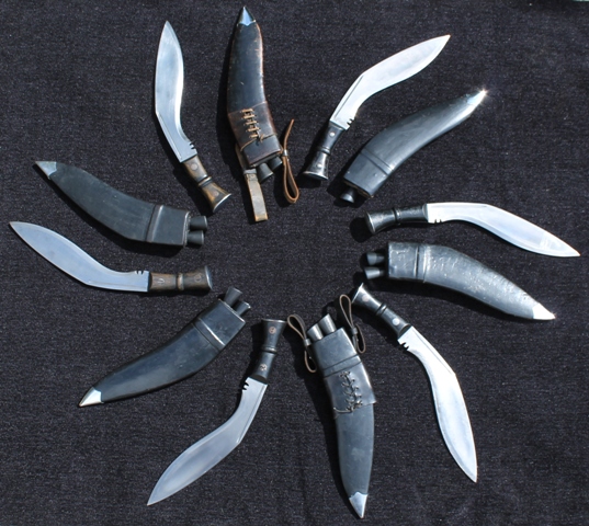

Of the examples I own, three have verifiable provenance, which has assisted me in ascertaining a little more of what became of the 1400. There are many rumours also, some based in truth, some in fantasy.
One story is that the gurkhas believed the blades had no soul, and simply threw them away. Another says that a large portion are still sitting in a warehouse in Singapore, gathering dust. Gurkhas, for anybody who has never spent time with them, are a canny bunch, so I don’t see them discarding kukris en masse. The army doesn’t tend to listen to how people “feel” about a weapon, the nature of the beast is that items will continue to be issued (with the requisite forms and hurdles of course) until they are either all gone, or no longer required.
However, one interesting account comes from a Captain R.V.W. Curd, Royal West Kent Regiment (1942-1953) and Royal Army Ordnance Corps (1953-1965), who wrote to Wilkinson’s some years later.
In the letter Captain Curd wrote: “It was part of my duties to order replacement kukris from one of our officers stationed in Northern India whose job it was to buy them locally from makers in the area. Some years prior to my arrival, Gurkhas in Malaya seemed to be wanting too frequent replacements for worn out knives, so somebody ordered a trial sample order from your firm for field trials by one gurkha company”.
He continues “The first I heard about them was when the consignment was returned to Singapore as the Gurkha’s didn’t like them. The reason given was that the quality was too high, and that once the fine edge of the main knife was gone, they could not sharpen them. The little sharpening knife couldn’t cope with the hard blade, and there were no stone wheels in the jungle!”.
Now, I can understand that the handles were an issue, and probably began rotting in the jungle as soon as they arrived, hence the order for repairs and replacements. But having used a WSC 51 Chakmak (sharpening steel) to sharpen a Wilkinson Sword 51 kukri, I can assure you it works just fine.
Perhaps a small number of unissued pieces were returned, and perhaps they are the majority of the excellent condition pieces we see on the market today. I can understand that the Wilkinson quality and brand would have certainly appealed to Gurkha Officers, so perhaps some found their way home that way. (One of mine certainly did!)
And as for the rest? Malaya lasted for twelve years, so I doubt it would take long to burn through 1400 kukris. I don’t see any great mystery, they were issued, used, repaired, reissued, used, etc until they were either destroyed, rendered unserviceable, or replaced by something else. I don’t think many made it home.
Around twenty (20) examples are currently extant, in various museums and private collections across the globe. Many are found in relatively good condition. The hardest part of the set to come by is the frog. I have seen less than five complete sets. For those want to collect a complete set of British Pattern Kukri, they are quite simply, the holy grail.

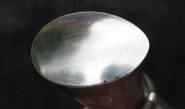

Default Apologies

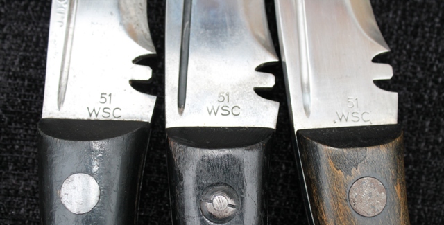

I forgot to add an image of the chromed butt plate or pommel.
Another measure to combat against deterioration in the jungle. Sadly as the beech grips all warped and rotted it was all for naught.
