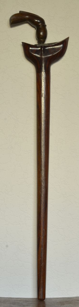

today I show the newest member of my tiny collection, a Keris Panjang with an unusual 5 Lok Blade.
The blade length is 22,5" or 57cm, whole length with scabbard is 29,5" or 75cm.

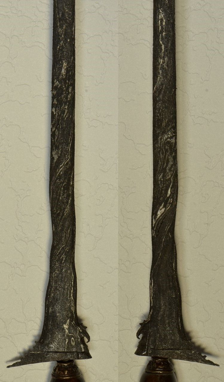

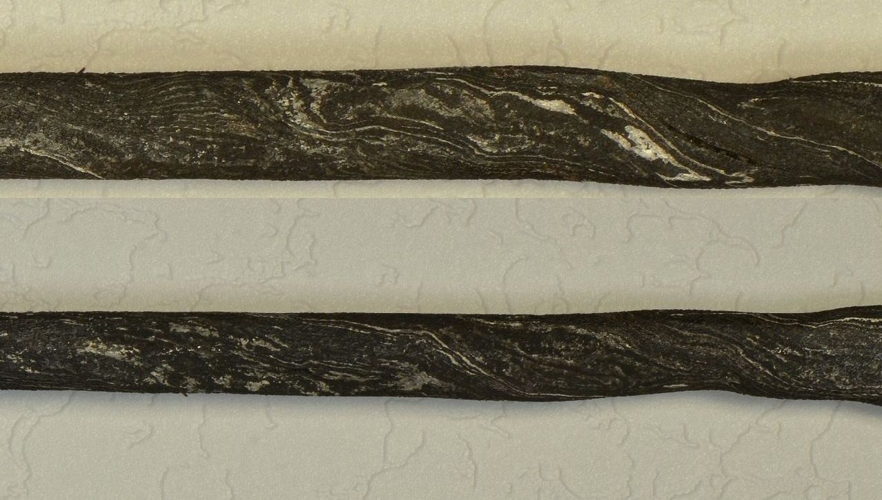

The hilt looks like South Sulawesi type and is maybe younger than the blade. I think, the dapur with 5 Lok is unusual for a Keris Panjang. I like the twisted pamor pattern in the area with the waves. The blade is still quite sharp and I think at least solid quality forging.
The blade itself is heavily corroded and was recently etched.
I know, here are some very experienced experts with very impressive knowledge and so I would be very happy, to read some informative comments about this Keris.
Thanks in advance for any comment and best wishes,
Roland

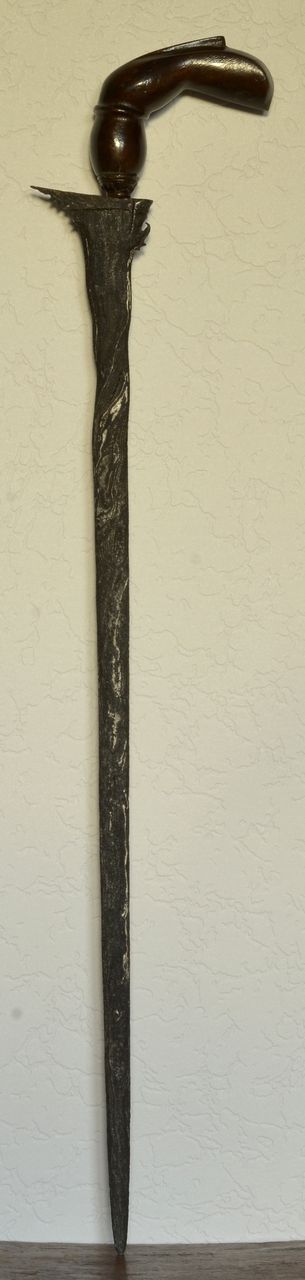

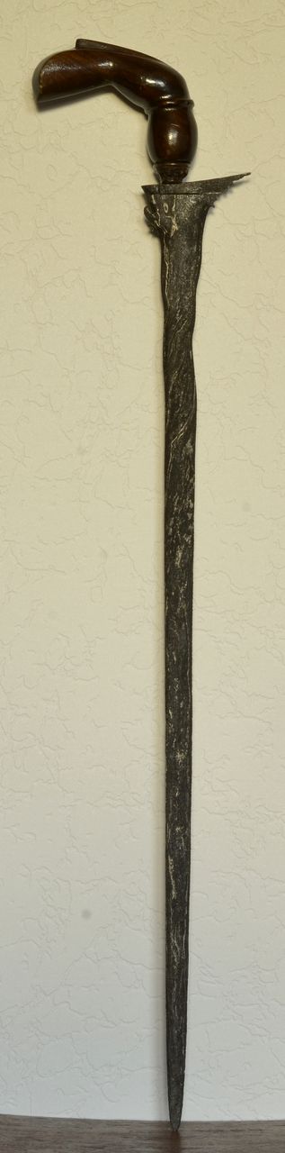

I have seen, and owned, a number of old keris panjang with pamor blades, but the pamor was always a very simple basic one, never a manipulated pamor.
I can show you my panjang with pamor I do not know his age
(maybe someone can say something about it)

Hi David. The age of a Keris is not very important for me. I removed the hilt and checked the tang. My opinion is early to mid 20th century or younger and badly stored.
A Keris is more an artwork than a weapon for me and a nice pamor and shape is much more important than the age.
The surface of this blade looks shattered and is either strongly corroded or etched with a special technique. The point is lost but not broken, it looks like a frayed v-shaped cut.
Roland

Sirek, have a close look at the ron dha on your keris.
What do you notice?
What do you notice?
Mr Maisey my untrained eye try to see what you mean, but I'm not sure where to look out for: not correctly cut?

Posts: 7,229
Actually both ron dha are correctly cut, and well cut, but the rondha in the gonjo is Surakarta pattern, and the ron dha nunut --- ie, the ron dha in the wadidang of the blade --- is Mataram pattern.
This sort of mix usually indicates that the gonjo has been made for a different keris and adapted to fit the one it is on.
Thank you for pointing that out, If I had to explain the difference it seems to me that the upper part of the ron dha in the Mataram pattern bends more upwards.
Concerning the gonjo, I have always had the suspicion that this was a replacement. But for me that was not such a problem because i thought it is not uncommon with older blades.

It is very common for a gonjo to be replaced on an older keris, however, the usual practice is to make a new gonjo, not recycle a gonjo from a different blade.
The reasons for replacemant can range from the original gonjo being damaged to the use of an original gonjo in the manufacture of a new keris.
If we think of the gonjo as a female element, and the wilah as a male element, it should be obvious why it is not fitting to replace a gonjo with the gonjo from a different wilah. When this is done it can very probably be considered to be the work of a dealer, or some person who does not understand keris ethics.
