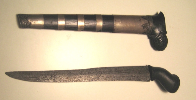

Hi all,
Just received this knife this morning. It seems I'm finding more and more Indonesian stuff lately. This is one of my latest finds, others will follow.
My guess is that it's from Bali. Could anyone tell me the correct name of this kind of knife ? I tried to look it up in the book by Zonneveld, but could find anything matching.
I think it's an older one (judging from patina on the scabbard). The blade is straight. One edge is sharp over its entire length. The other side has a cutting edge of approx. 2/3 of the blade. This knife has no pamor.
Scabbard and handle are made of wood. The scabbard has some iron binding. At the bottom a piece is missing. I'm planning to restore it (when I find the time). Do you think it needs a bone tip or would a wooden one be better ?
Total length is : 30,5 cm. Length of blade : 22,5 cm.

i would guess that you awn a quite nice bade bade.

But it doesn't look like Bali.
That style of floral hilt and scabbard is found mostly in the Padang High-/Lowlands
(W Sumatra) but also around Banjarmasin (S Borneo).
My guess for this one is Sumatra.
I think it looks best with a bone tip.

Very nice piece. I think Sumatra, too. Congratulations.

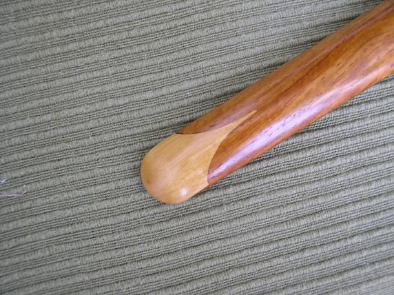

It is a badek from Sumatra. The round tip of the scabbard is inserted in the V incission in a contrasting wood, bone or ivory. Nice find.

I just remembered where I have seen this kind of Badek before -
on my own wall.
I got mine from Adni and he described it as a Karih.
As you know all Indonesian blades have several names...

yours is a karih for Sumatra. An uncommon side-weapon used by Minangkabau people. Probably a local name for this badek-like weapon. The difference, badek is single-edged whilst the karih is double-edged with some other minor difference.
Freddy,
yours looks like a badek, a nice pretty one too, (imo only).

I think the foot should be of this style. This is the buntut of my keris panjang, but it should be the same for the badek. It's actually quite hard to make a piece that would fit perfectly into the curved 'V' slot.
