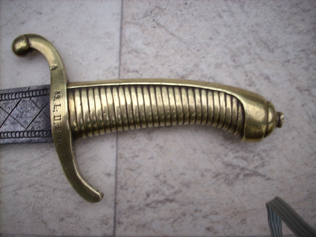

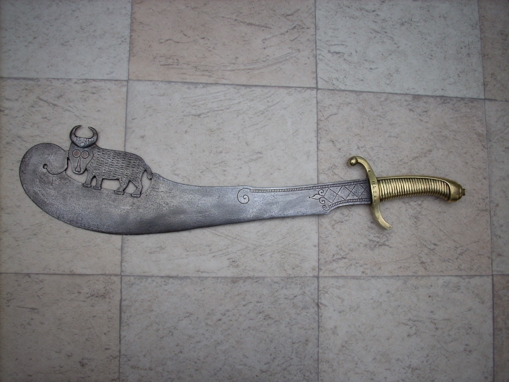

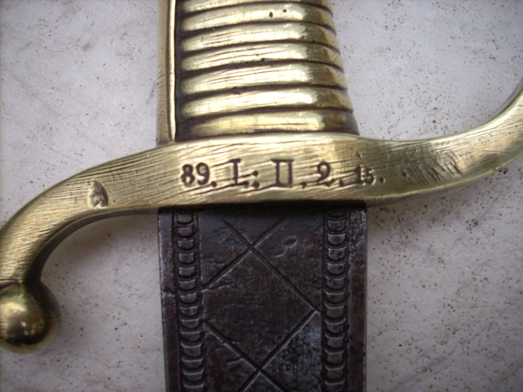

Hi Everyone,
I Would very much appreciate if any of the members could translate the letter and numbers on the quillon of this French infantry sabre from which this Dahomey Hwi has been made. I posted it on Ethnographic Arms discussion Forum some days ago but no one seems to know which regiment the sabre belongs to.
Thanking you in anticipation.
Miguel

Hi
I think the markings are german regimental markings not french
I will try and translate when I get books out

Good call Ken!
Apparantly French briquettes did not typically have regimental stamps, only rack numbers at least noted for Napoleonic period. Not sure about later, but then these weren't really in use that much after the M1832 form came in.
I checking Hughes & Fox ("Compendium of British & German Regimental Markings ", 1975, p.28) there is one grouping of interest,
L. 76.L. II. 4. 50.
Note the L. and the Roman numerals, periods after each number, letter
This particular designation is for
2nd Landsturm battalion of Landwehr-Regt. Nr. 76 4th Coy. Weapon 50
I think Ken's suggestion of German probability is spot on, and though I cannot specify unit, the number, letter combinations seem to correspond in effect. West Africa did of course have considerable German colonial activity as well.
It seems these briquette hilts often ended up in strange hybrid cases, and I have seen them in Spanish colonial composites also, notable that the knuckleguard was often removed on that as well.

Hi
During the Franco Prussian a lot of French equipment was taken by the German forces, it is very common to see French Bayonets re marked with German regimental codes in this way and re issued to rear line troops
So it is highly likely the same thing happened with this side arm.
I should have regimental code in a few days
Ken

Miguel,
Thank you so much for the kind words, I am indeed proud to be included among the rich knowledge of many members here. I learn a lot mostly from the experience and examples shared here, and must note that most of what I place here is from compiling information from references and various sources.
Ken was spot on in his recognition of those markings as German, which was what led me to my confirming that suspicion in degree. Essentially, this is the teamwork that I believe is so key here in our study of these arms.
All best regards,
