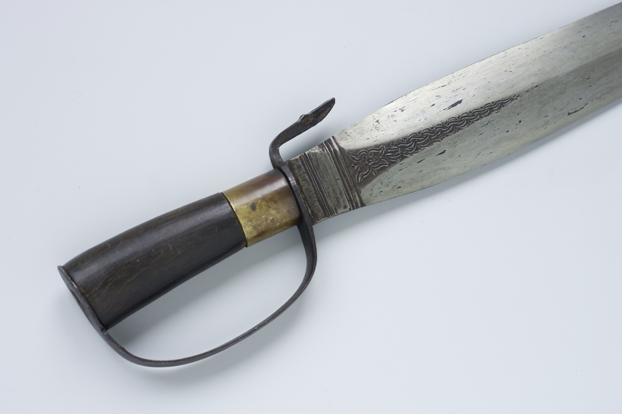

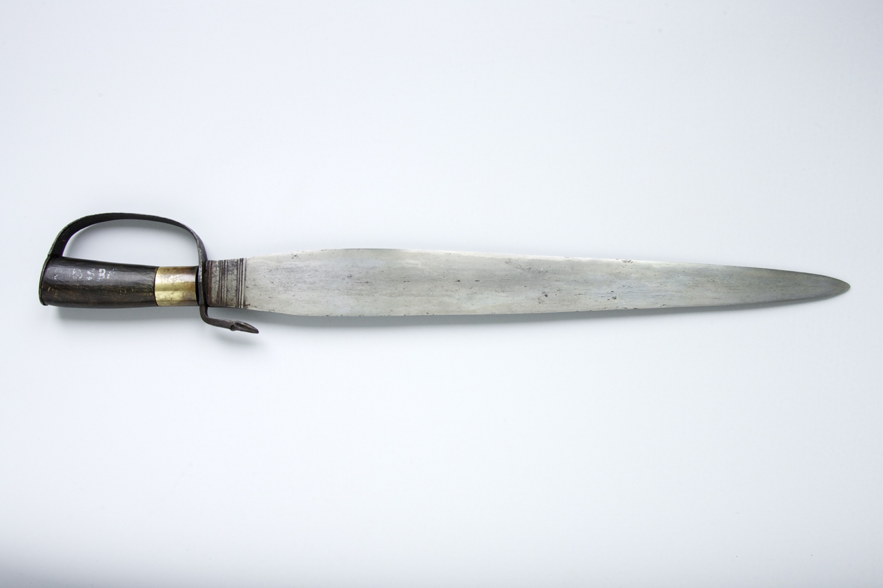

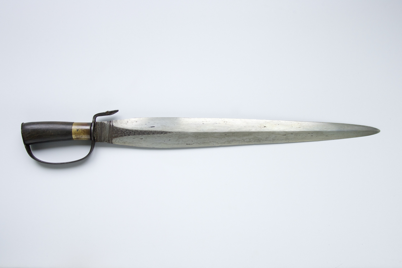

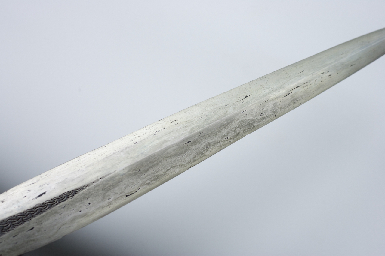

Hello guys, it's been a while!
I wanted to share with you guys a recent acquisition. It follows the format of regular Chinese hudiedao, with D-shaped knucklebrow and a hook at the back of the blade, and is also of roughly the same size.

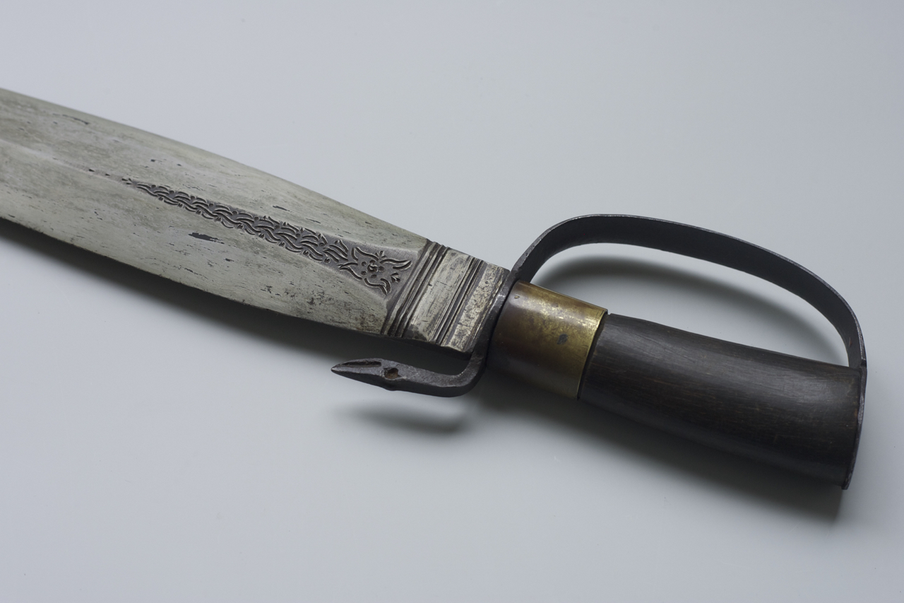

The major departure from the standard design of such swords is the symmetrical, leaf-shaped, fully double edged blade on this one where a wedge-shaped single-edge blade is the norm. Other interesting differences from Chinese hudiedao include a slightly forward curving handle, chiseled decoration on the blade, and the hook being shaped like a little dragon head.
It is most likely of tribal origin, loosely based on equipment by the Han Chinese. That's pretty much everything I know about it, I haven't seen anything similar.
Perhaps the decoration could give away which culture produced it. Anyone?
(See pictures attached. In recent polish by Philip Tom, showing some of the laminations in the steel.)

I think it's Filipino, Chinese influenced for sure .
What makes me think so is the banding at the forte and the decoration which strikes me as very Okir-like .

I agree with the consensus! I think it is Filipino. The lamination is typical for there, the banding at the block type forte, and I think the quillon is a snake or naga versus a dragon. The grip and ferrule are even quite Filipino. I bet we can find some similar blades in prior posts with similar hilts.

Yes definitely Filipino. A wonderful piece and a great addition to your collection. When you get tired of looking at it you can send it my way. If this were listed on a certain online auction it would most likely be described as a Civil War D-guard bowie.

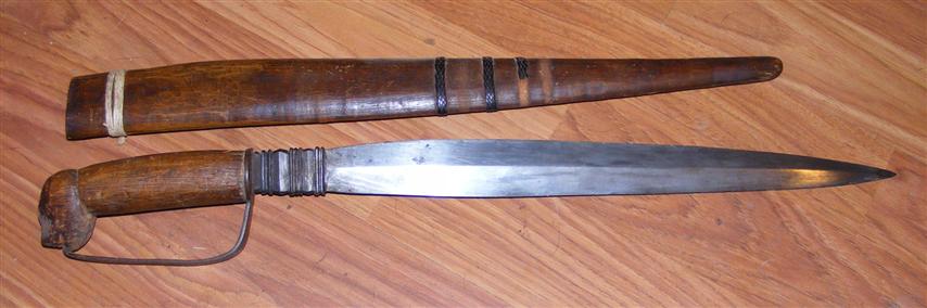

Reminds me of this one: http://www.vikingsword.com/vb/showthread.php?t=19754
Old 29th June 2015, 03:01 AM   #8
Posts: 6,418
Originally Posted by Timo Nieminen
Yeah, that's the one that came immediately to mind for me too .

Although I'm not entirely convinced mine is filipino, it most certainly shows a strong relationship to these with the chiseled forte and the leaf shaped blade.

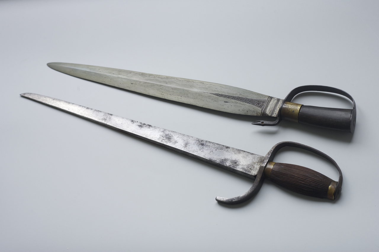

More Sinified aspects of mine is the straighter shape and the way it builds up width from the forte, giving it more of a Chinese "feel" to it. Compare that effect to, for example, these:
Chiseled engravings on blades, were also quite common (and often floral) in Vietnam.
All considering, we might assess it originated somewhere around the South China sea area, sharing shores with South China, the Philippines, and Vietnam.

sorry, no, I don't agree. It's in my opinion clearly a Luzon piece, the way how the guard is attached in up from the horn hilt, the carved ricasso at the blade and the lamination of the blade let me be very sure.

The blade looks very Philippines, and not Chinese at all. The hilt looks Chinese to me.
Here is a photo of a sword I thought looked quite Chinese. The grip has a similar shape to yours (though the guard differs). It came with a bunch of Indonesian blades, and might be Indonesian like its box-mates.

Philippines, with Spanish colonial influence (the quillon with the snake similar to those found on espadas)-

Sajen, I see what you mean with the Luzon attribution. In internet search came up with quite a few of them with such a long brass ferrule. I couldn't find any with a complete straight and symmetrical blade like mine. Is this more unusual in this sphere?
Mine seems more Chinese-influenced than most I'm coming across, but you guys have convinced me it's probably made elsewhere.
Philip pointed out how the quillon on the back is too close to the blade for Chinese standards. In China they were used to flip the blade around so they could strike with the handle. I thought perhaps this was because you don't want to flip a double edged blade, because the back edge will then be next to your forearm. But I see many filipino blades that have the same, a thin quillon pretty close to the blade.
