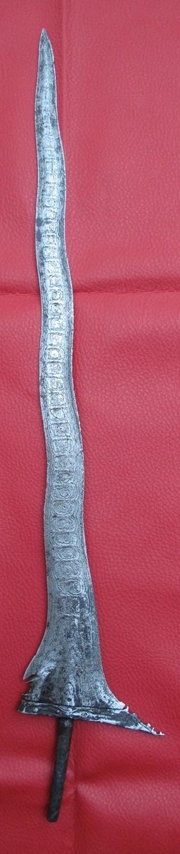

Old 2nd July 2015, 03:21 AM   #5
Green
Green's Avatar
Join Date: Apr 2015
Location: Malaysia
Posts: 328

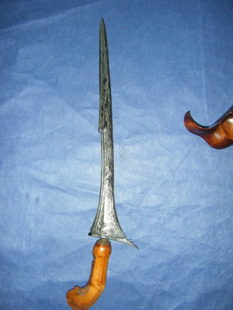

Thanks all for the explanation. Here is an example of what I would call an over cleaned blade.It looked shiny , smooth to the touch and the color is silvery. compared to what some would view as 'normal' surface which is duller original color and the surface feels somewhat like v fine sandpaper (the second pic).

Two keris of very different age and very different material:- we cannot compare apples to rambutan.

interesting comment that Mr A G Maisey. The over cleaned keris is mine and supposed to be quite old possibly late 19th century/early 20th?. Do you think this is so ?
The latter I don't know as i just pluck out the pic from the net. But be that as it may , irrespective of old or new keris, one would expect the surface look would be the same ?
Old 2nd July 2015, 07:39 AM   #8
Posts: 7,228
Green:-
When we start to talk about the age of a keris blade, or any other tosan aji for that matter, we are moving into the area of blade classification, ie, "tangguh", and this is a field that is full of misunderstanding, misinterpretation, and extreme difficulty. It is not an area that anybody with any degree of knowledge likes to get involved in when all they have to form an opinion are incomplete photographic representations of a blade.
That said, I am still prepared to make a couple of comments.
The blade you consider to be over cleaned is a relatively young blade, I'm not prepared to classify it, but it probably does come from the era you have nominated, say, later than 1850.
The other blade comes from a much older period of time.
The materials used in a blade are a major indicator in classification of a blade, and they vary from era to era. We do not expect a 17th century blade to use similar material to that which is used in a 19th century blade.
Some Javanese blades from the period after 1850 used some rather odd materials for pamor material. One such material was Dutch coinage, and blades containing this material have a smooth, greasy feel.
To understand how a keris should look takes a great many years of dedicated study, combined with the opportunity to handle literally thousands of blades. In short, a 19th century Surakarta blade will not have material that looks even remotely like a Pajajaran blade that comes from a much earlier time.
Before we can form an opinion as to whether or not a blade has been correctly cleaned, we need to know what it should look like when it has been correctly cleaned. Before we can form this opinion we need to be able to classify the blade, that is, give it a tangguh. Before we can give it a tangguh, we need to handle it.
Photos are not adequate in this instance.

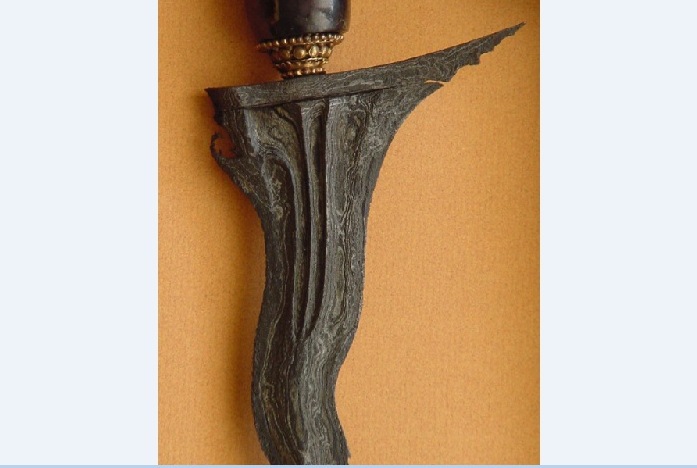

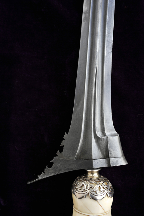

Here is an example of a Balinese keris (late 19th to early 20th Century) with a traditional smooth surface and stain as well as a keris from the Malay Peninsula with a smooth surface. Both these smooth surfaces are correct surfaces for these types of keris IMO.

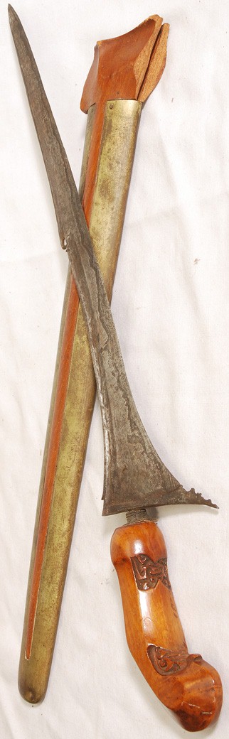

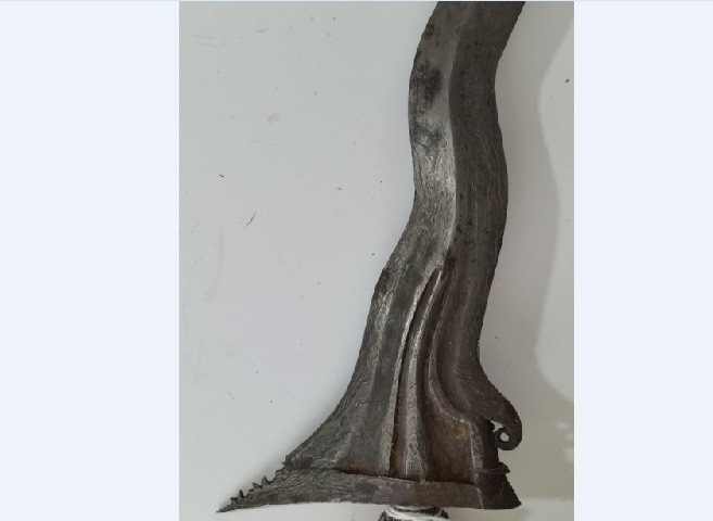

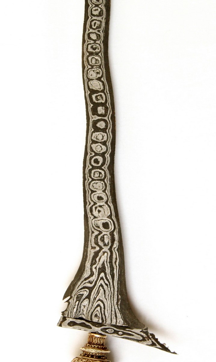

IMO and by Indonesian standards your blade is not over cleaned but poorly maintained, it has several rust spots and the pamor pattern looks indistinct probably because the blade surface was polished with fine abrasive materials.
Personally I would have it professionally cleaned and stained, see an example of a blade before and after treating it with warangan.

Jean
Join Date: Jun 2009
Posts: 1,740
Hello Green,
Thank you for your views on the subject and other opinions will be welcome. There seems to be some differences in the kris culture between Indonesia and Malaysia?

I think that Javanese collectors will clean and etch their keris blades as well. A keris from Java, Madura and Bali has pamor and to show the pamor is what it is to intended to do IMHO. A Malay keris don't have pamor normally and don't get a warangan normally.
I agree also with the statement from David in up.
Here is a blade from Java from my collection before and after cleaning and warangan.
