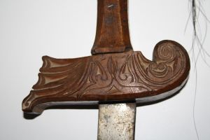

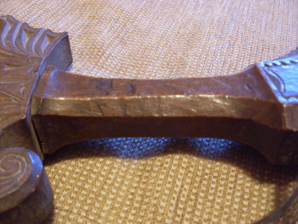

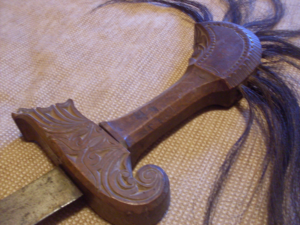

This is one of my last adquisitions. Is my first kampilan with this type of hilt. The description from seller was :
CARVED WOOD HANDLE.
TOTAL LENGTH: 88.5 CM.
BLADE LENGTH: 66.5 CM.
HANDLE: 22 * ??14.5 CM.
I hope enjoy with pictures
brst regards
carlos
Old 18th June 2015, 03:39 PM   #2
kino
kino's Avatar
Posts: 1,038
Very nice and unusual Carlos.
It seems to have a well defined octagonal handle. Would you know if it were wrapped before rattan or otherwise?
I've never seen a pommel like this before.
Thanks for sharing.

When I see hilt pommels like this I immediately look to see if they are cut down from broken "open mouth" pommels and they usually are.
This one, however, is not and is original as is.
It's a lovely piece and a GREAT fine! Congrats!

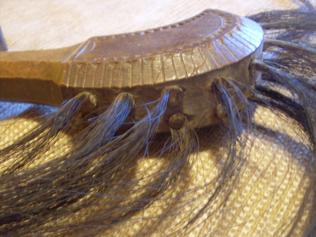

Hello Carlos,
Congrats, another great kampilan for your collection!

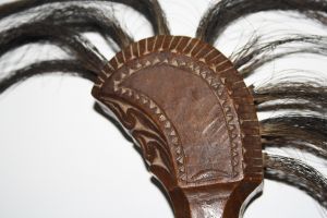

Is this human hair or horse?
Could you please post a close-up of the hairy side of the pommel?

Hi Carlos:
Very nice and unusual example.
How old do you think it may be? The carving on the hilt and cross guard look very crisp and appear to have had little handling--might suggest relatively recent manufacture. The hair "implants" look to be nearly all there (unusual to find on older pieces). Hard to tell from the picture how old the blade might be. My initial thought was that this might be second half of 20th C, but only inspection in hand would allow an accurate estimate of age.

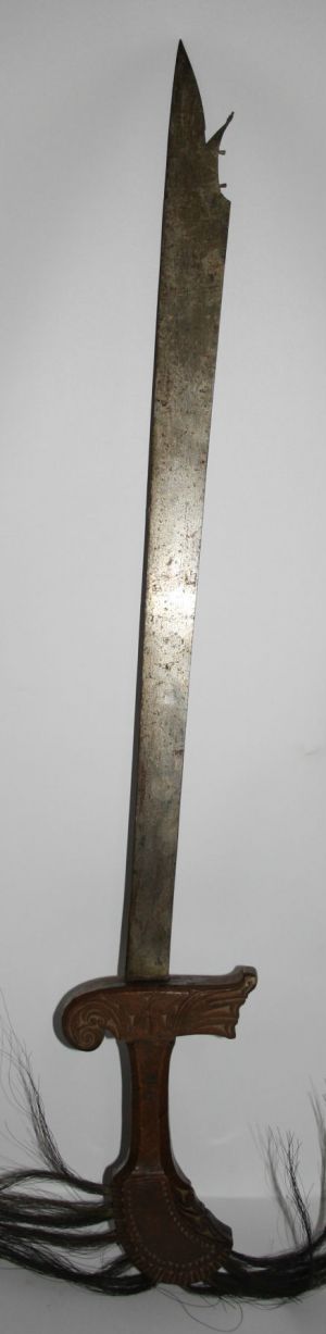

If I might ask for more thoughts on the blade from those of you who are keen collectors of these. Is it possible some of the staining which seems present could be from 'cosmoline' or the type of storage preservative
often seen on weapons of early 20th century and in military or arsenal context?
I was wondering if perhaps during occupation at close of Spanish-American War period perhaps old examples or blades might have been stored by Filipino forces, and this might have reentered the population at later date. Possibly the remount might have been designed specifically toward a more ceremonial or traditional role then.

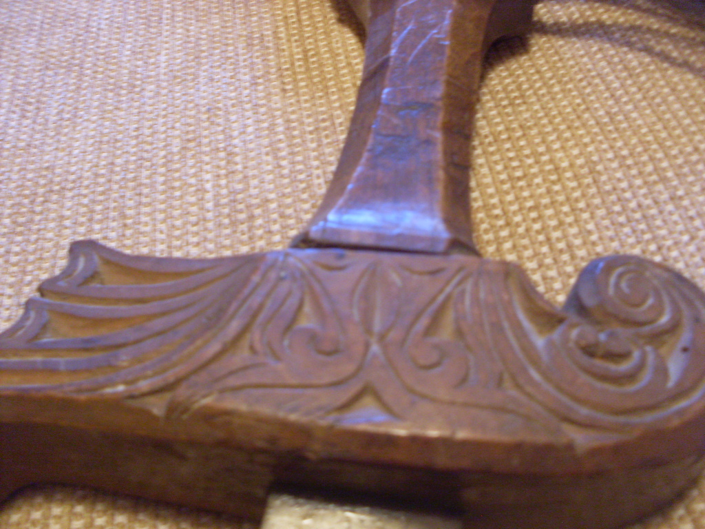

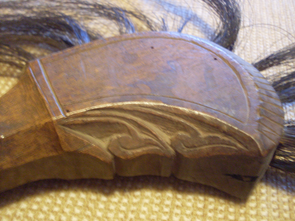

hello !!

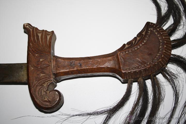

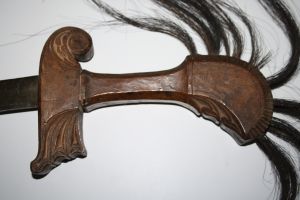

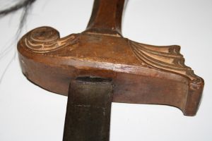

i think is a 19 century kampilan, in Spain is unusual find fake kampilan. The most of them are "souvenirs" from war in the end of 19 century.
I add more pictures.
Thanks all forum members by comments.
best regards
carlos
Old 20th June 2015, 08:17 PM   #14
Posts: 7,403
The hair plugs look like Hey have age and wear to them. I agree that this is late 19th century. It also looks like ther may have been a silver okired plate on both sides of the pommel - I see nail holes in your pictures.
Old 20th June 2015, 11:33 PM   #15
Posts: 4,732
Yes, the latest pics would indicate more age to the hilt, as you suggest. A very nice and unusual example.
