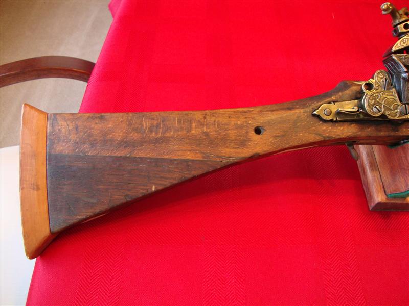

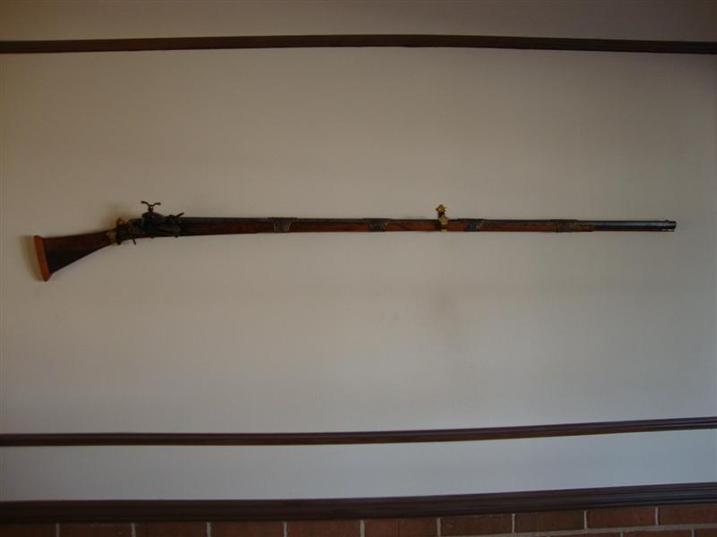

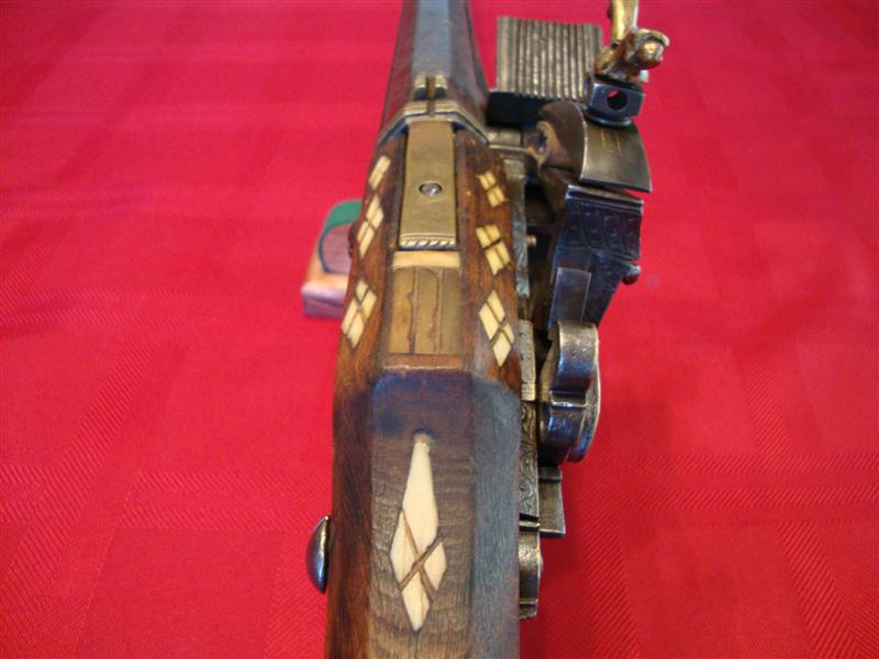

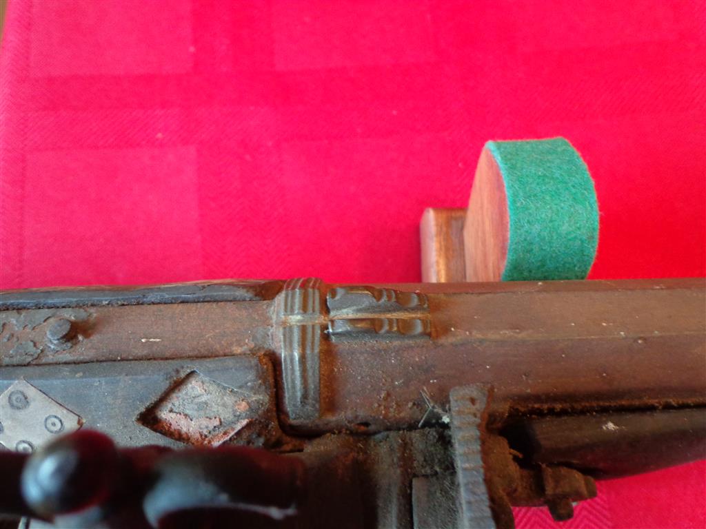

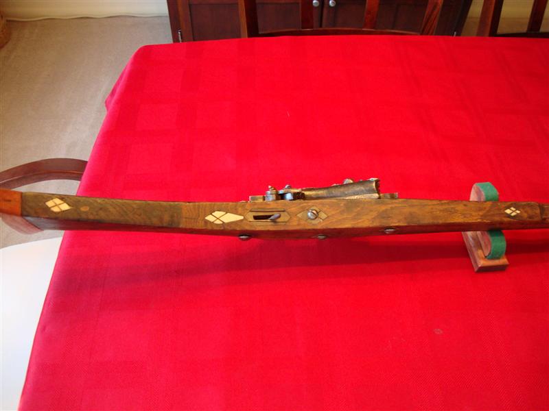

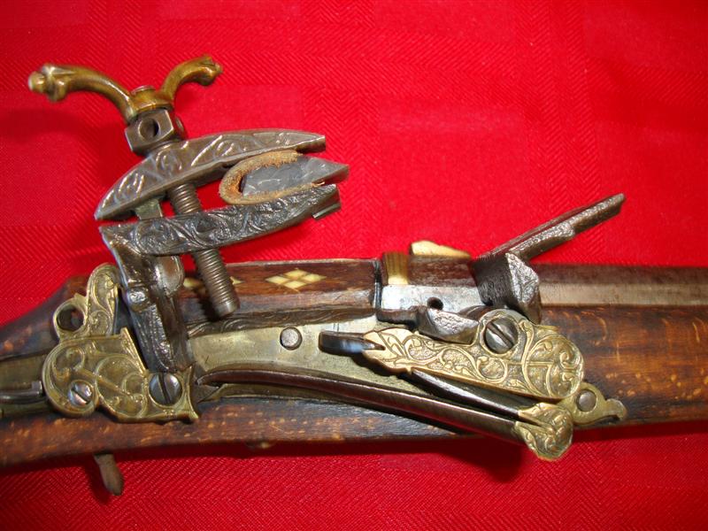

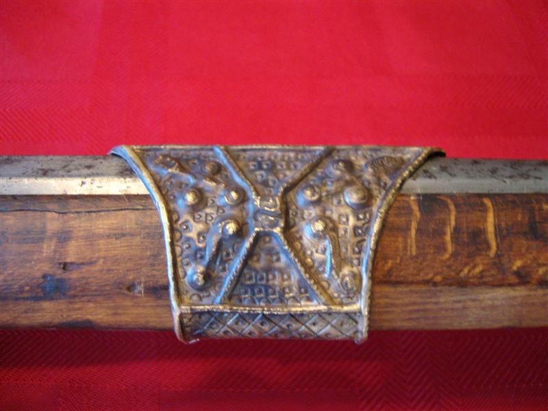

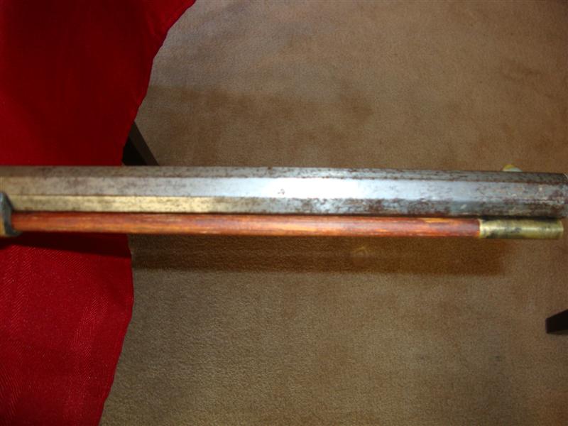

Hello again. Here is another gun some of you might find interesting.
This is a typical Algerian Kabyle long gun, with the typical large miquelet flintlock. This was a fairly plain gun that did not take a lot of work to restore to safe firing condition. Here is what was done:
1) The lock just needed cleaned and the trigger bar bent a little to better align with the trigger pull. The lock sparks really good now.
2) The stock was in the shape shown here and really did not need any attention. I didn't even re-finish the stock. Left it as is.

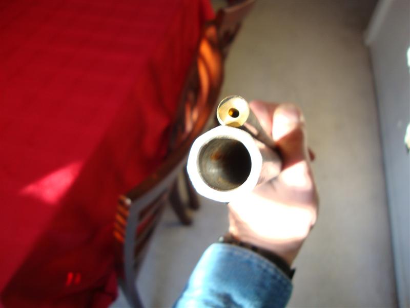

3) The outside of the barrel was already in the condition as shown, with the front and rear sights intact. So the breech plug was removed and inspected along with thread condition. All seemed good. So a new steel .55 caliber barrel liner was installed.
4) There was only two original barrel bands that came with the gun. And they were really beat up. So, had Armourer John Katz make 4 new ones that closely resembled the originals.
5) Original ramrod was missing. But easy to make a new one with brass tip threaded for cleaning accessories.
Gun works and shoots fine now. Hope you enjoy the pics. Rick.

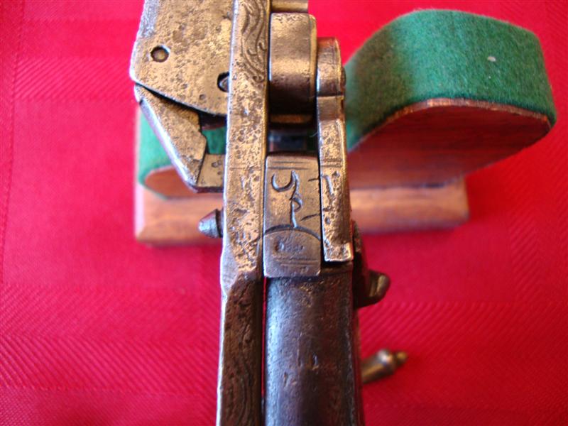

And the last.....I think.

LOVELY JOB IMPRESSIVE RESORATION,CHEERS

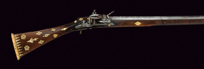

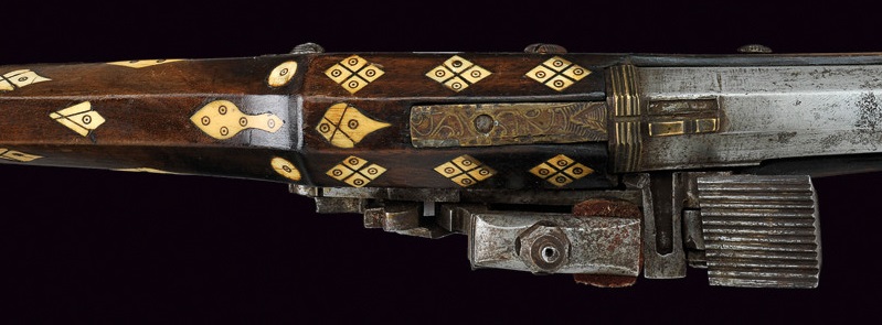

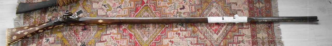

Hi Rick,
Here is mine. I had to do barrel bands like you,not fixed yet.

Hi Kubur.
Your's has a very nice decorated stock. And all the inlays seem to be there. Your ramrod looks like it still has most of the metal (brass) wrap still intact. Great! As you say, some new barrel bands, and that should turn out looking good. I really like the stock decoration.

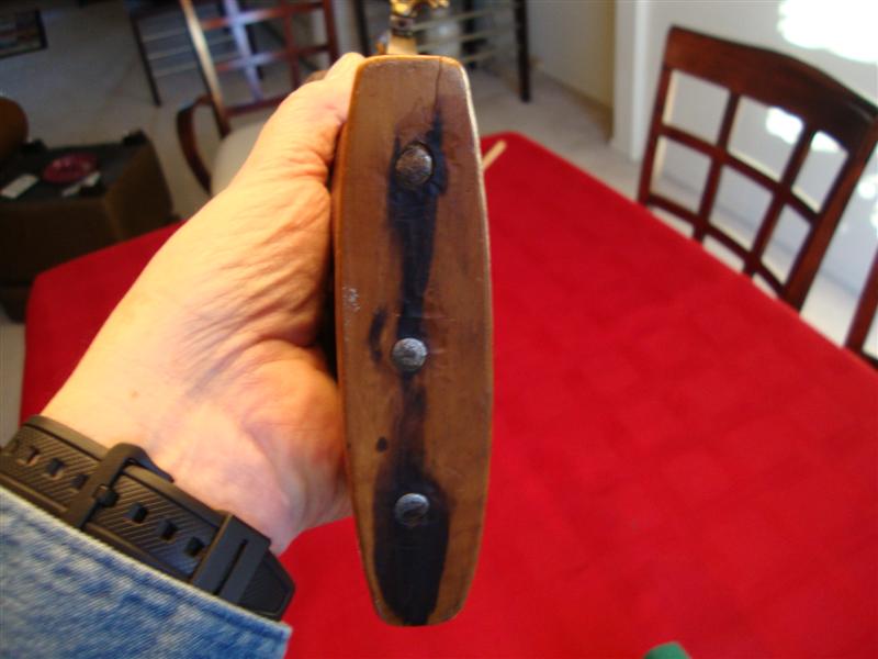

An interesting feature of these guns is the bottom of the fore stock is flat, and the length is only about two-thirds the length of the barrel. Also, the locks are inlet only about half the thickness of the lock plate. But every one I've seen is built that way.
By the way, is your's missing one of the two parts of the rear sight? Or is that just the photo?
Rick.

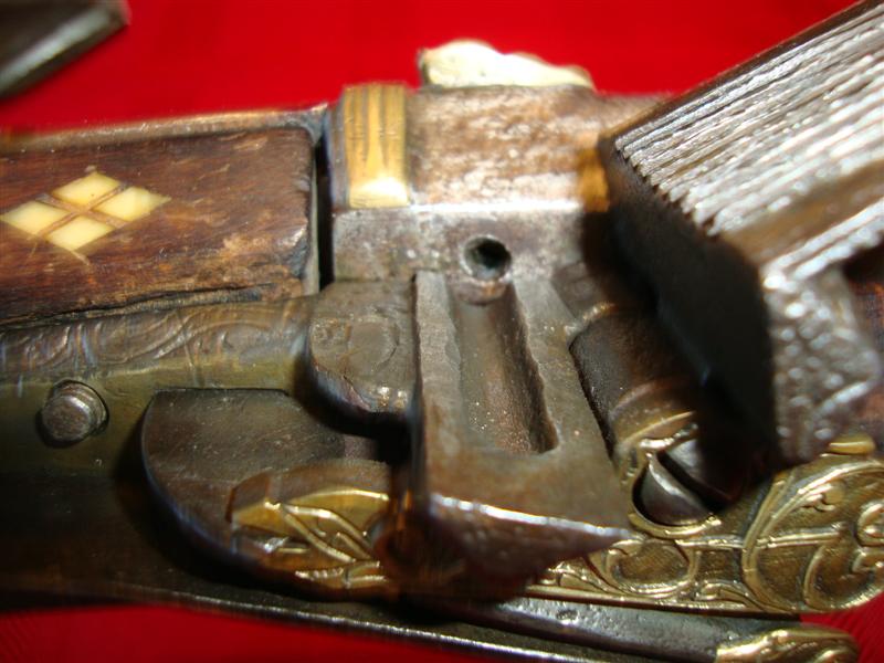

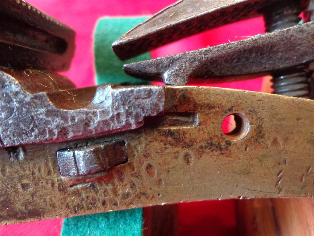

At your last but one picture...
Salaams rickystl How interesting is that!! The Algerian gun mark also seen as I see it on some swords at the top of the Red Sea region... I will dig out the references in Library later... This looks like the shortened version of "God is Great" The famous Islamic mark....and of Algerian swords and guns. Searching...
Got it...
Please see http://www.vikingsword.com/vb/showth...ttara+comments
This is a clear Algerian mark (identical to the Gun Mark ) on a blade posted by Michael Blalock . I suspect that it appears on other blades as a simple cross format also on the same post above and that this marks Algerian blades and are common in Red Sea regions. This may well be one of the confusing factors linked to the conundrum of Omani Blades particularly when rehilting has occurred.

Hi Rick,
The ramrod is made of silver on wood. Yes, unfortunatly one part of the rear sight is missing and worst the top of the cock /hammer screw...
I have seen some Algerian long guns made in the early 20th. But this one is definitively from the beginning of the 19th c. (or late 18th) according to the book that I've seen. Best, Kubur

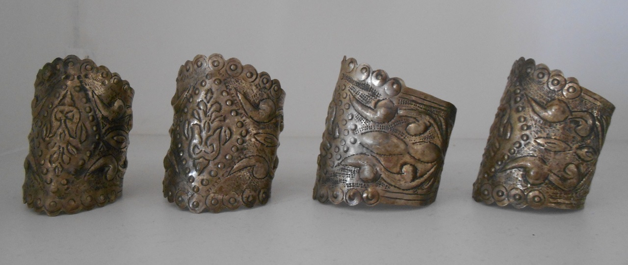

Here the barrel bands. I gave them a patina just by putting them in a plastic bag with rotten eggs. Stinky and dirty but works well...

Salaams Ibrahiim.
Thank you so much for identifying this mark. I am very much a novice with markings. Yes, the mark on the blade looks the same as on the gun lock. Hmmm...Red Sea region. How interesting. I'll be able to add this information to my library page for this gun. Again, THANK YOU!!!
Rick.

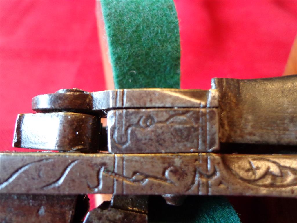

Hi Jim
Thanks for your input on this Thread. That Ibrahiim was able to identify this mark, with links to the Red Sea region, and add to this Thread is most appreciated. And an unexpected surprise.
Now I need to investigate if any other markings exist on the other Algerian locks in my collection.

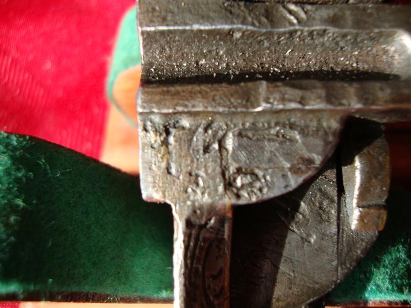

Meantime, here is a lock marking from another Algerian musket in my collection. It is a different mark, but in the same location as the first. Maybe someone can identify this one?
Thanks again for any assistance.
Rick.

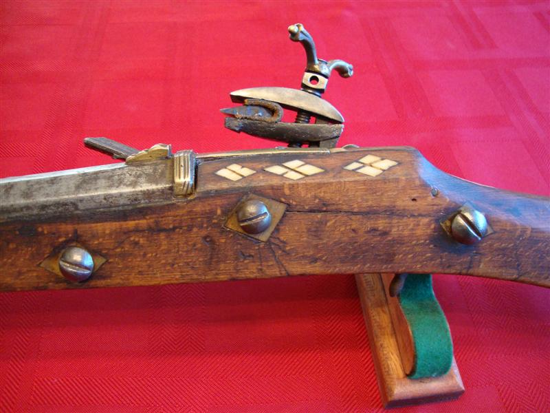

Hi Kubur.

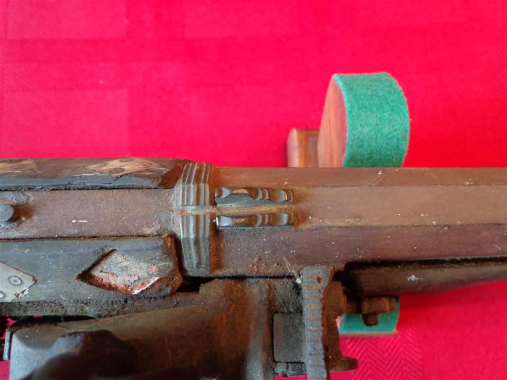

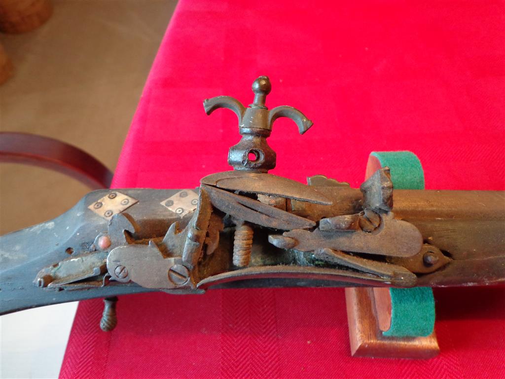

Well, you might be in luck. Here is an Algerian "parts" gun I have. The barrel still has both pieces of the rear sight, and the top screw still has it's "wing". I can send you both sight pieces and the complete hammer screw if you like? I'll clean them up a bit before mailing. Just let me know if you're interested.
HAMMER SCREW: I've found that these screws are interchangeable with other Algerian locks. That way you can just trade screws. If the threads don't match, you can detach the wing and tiny post and add it to your hammer screw.
REAR SIGHT: Can you tell by looking at the empty space if the rear sight was soldered on or staked on? If you know what I mean?
Rick.

Hi Kubur.
Are those barrel bands original to your gun? Or did you make/have those made for you ??

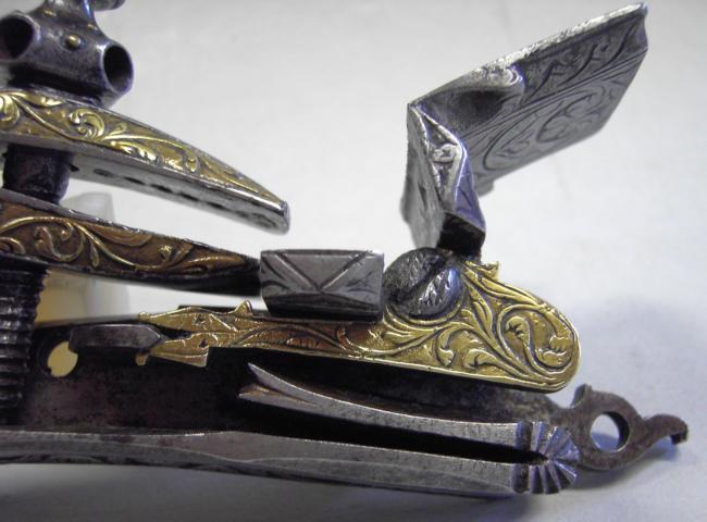

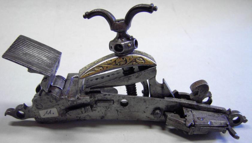

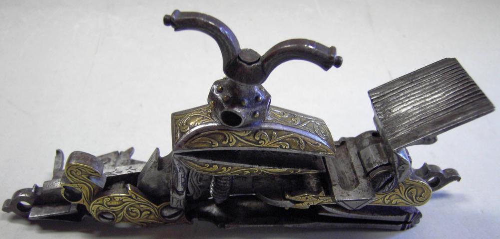

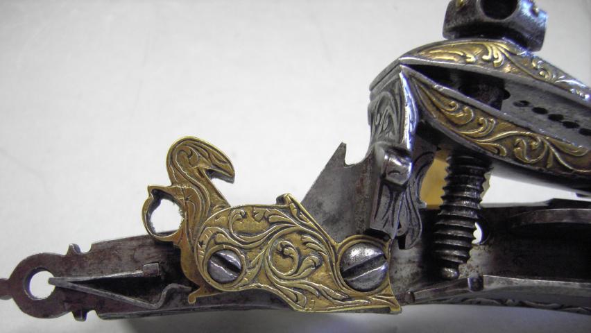

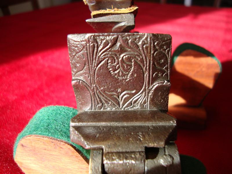

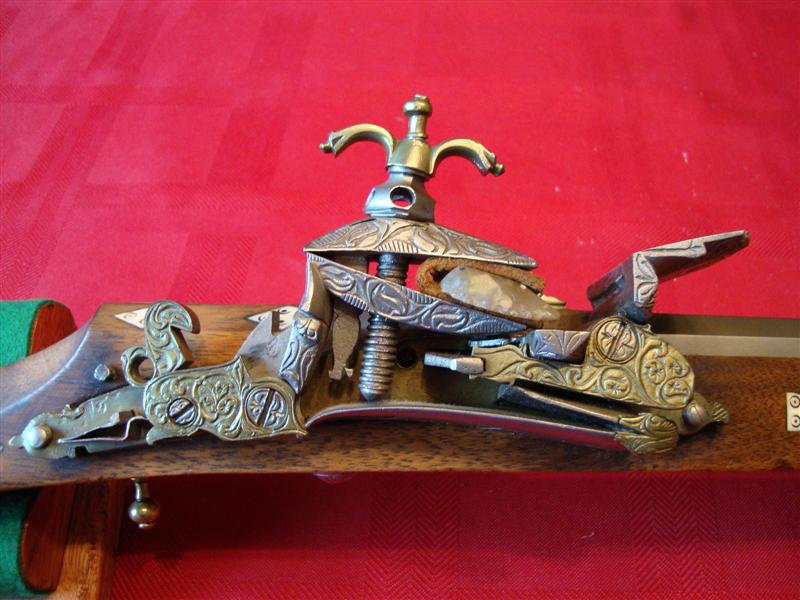

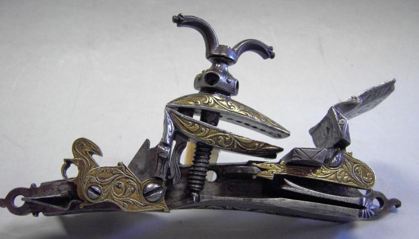

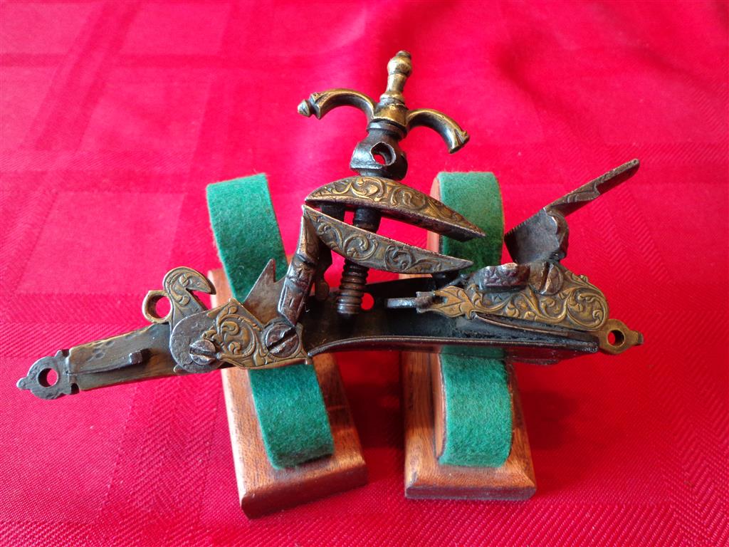

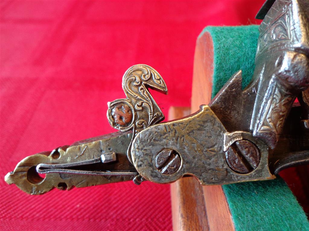

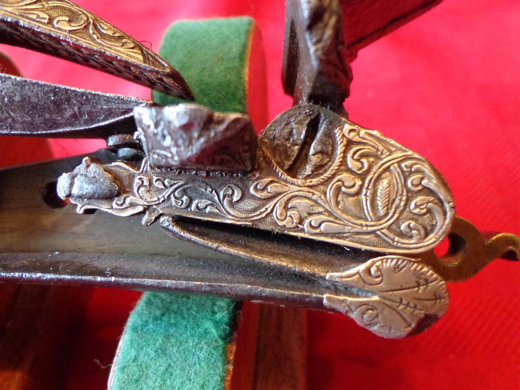

I want to add another very well and artisticly made Algerian lock of my collection which has no single mark on it.
corrado26

Hi Corrado.
That is a VERY nice Algerian lock. Very artistic and well executed. Notice the decorative file and chisel work on the mainspring. Not usually seen on these locks. Very neat. I've noticed that all these locks are built almost identical. The only differences in the amount of decoration. Thanks for posting.
I've looked at three other Algerian locks in my collection. All have a mark. But all different. I'll take photos and Post here.
Rick.

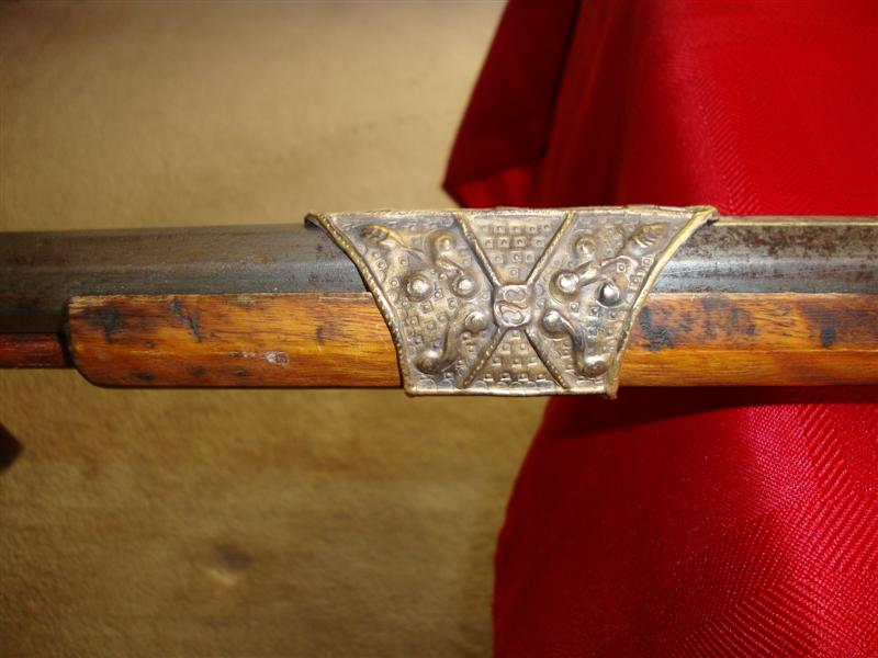

Hi Rick,
I had only one band and I asked to a guy to make four more for me.
The original is silver, the new ones are tin-plate but with the "artificial patina", i's alomost impossible to see the difference...

Absolutely, and thank you for continuing the impetus of this thread by seeking other examples along with Corrado. The observations by Ibrahiim indeed reveal there are certain similarities which might give us a better idea of the scope and dynamics of arms trade in these regions.
While my focus has typically been on edged weapons and makers marks and inscriptions mostly European, I have found that often many clues and important details reside with material on firearms. Case in point with Elgood's excellent book on Islamic firearms.....his footnotes are a treasure trove of encyclopedic data!
Often of course various trade entrepots handled all types of arms, and comparing marks on all can many times give us key details.

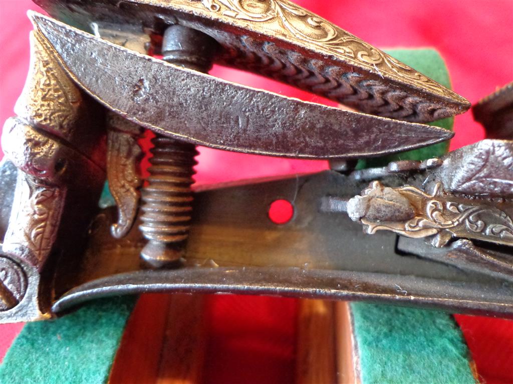

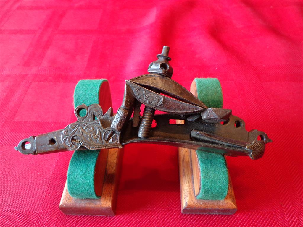

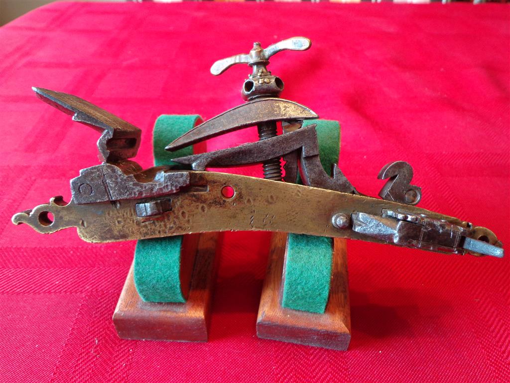

Well, I have three more locks to post here. Since I posted two above, we'll call these locks 3,4, and 5. I'll post #5 separately, since it is the most interesting.
#3 here is another "parts" lock with it's mark on the bottom.
#4 lock is complete and in good condition, but needs additional cleaning. With it's mark.

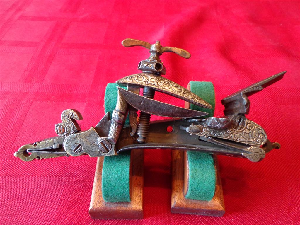

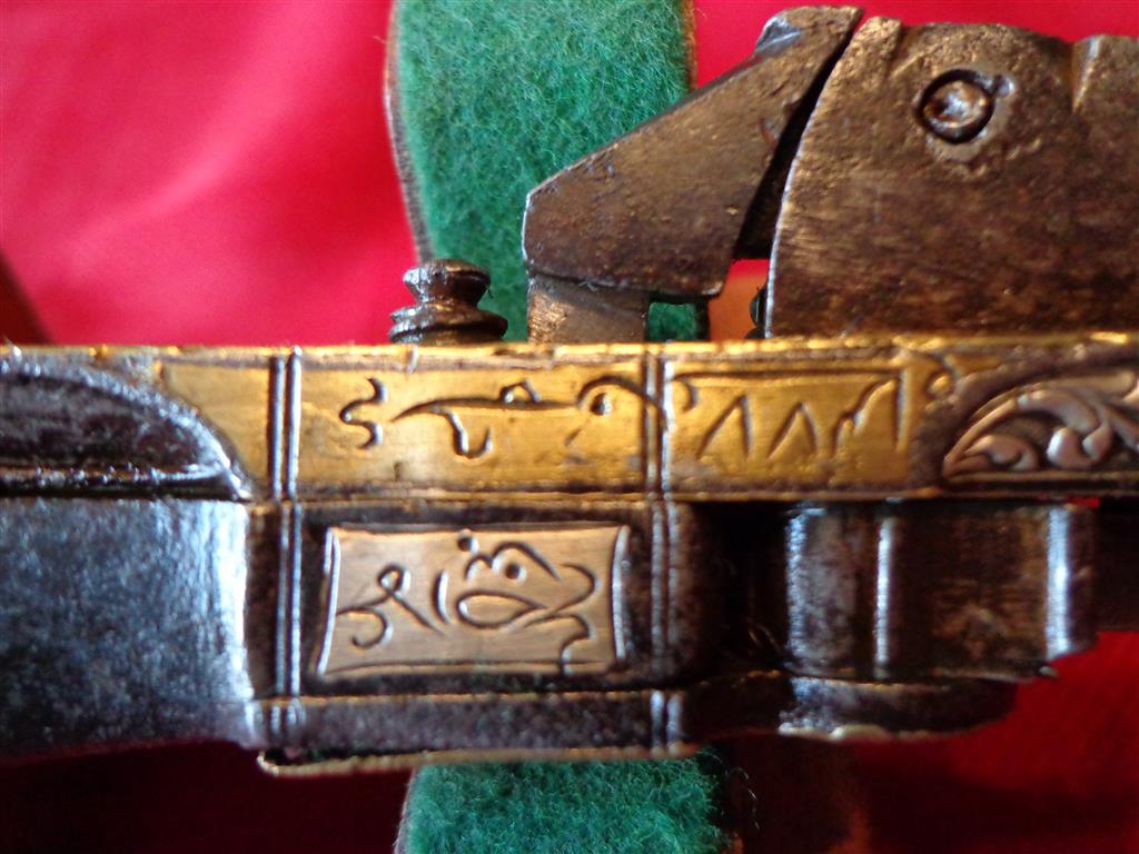

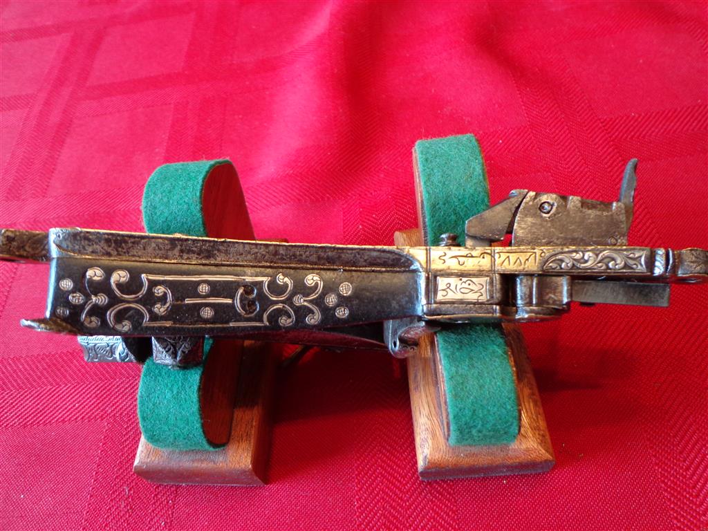

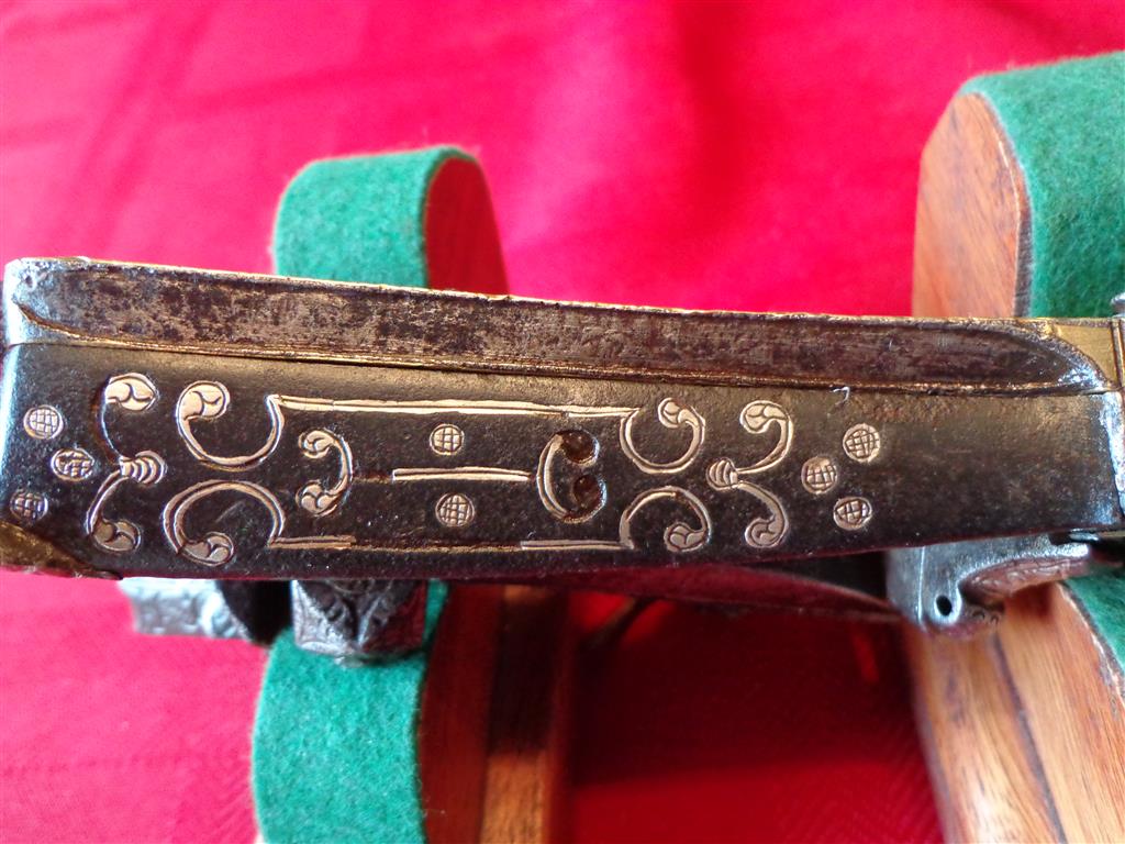

Here is lock #5. At one time this had to be a beautiful lock. It is a bit larger than others that I've seen. It's complete,with the exception of the crude copper replacement wing. The lock plate has brass overlay on BOTH sides of the plate. It has some brass, but mostly silver inlay/overlay throughout. Even the bottom of the mainspring has genuine silver inlay, most of which is still present. The dog safety catch at the rear has what's left of a "pink" stone, so famous with Algerian guns.
There are three marks on the bottom of the lock. Two engraved in brass plates, the other in a silver plate. Only lock I've ever seen marked this way. Maybe someone can translate? Thanks for looking. Rick.

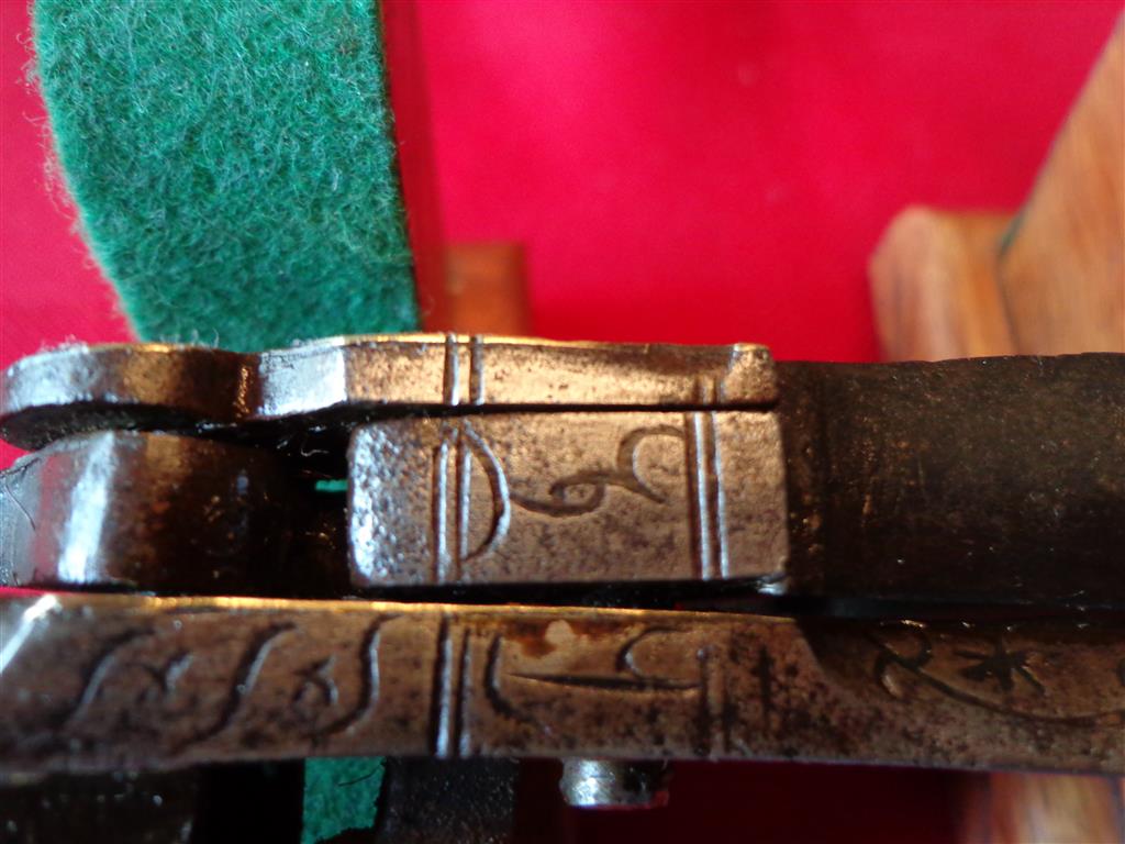

And the rest for lock #5. Very cool markings!!!

Hi Rick, thanks a lot for posting these interesting fotos, especially the underside of the mainspring with its silver inlay and the brass cover at the inside is most remarkable. This shows the pleasure of the gunsmith while making this lock and demonstrating his skillfullness. Very impressive. I like these locks very much, much more than the long guns they are belonging to
corrado26

Hi Corado.
Yes, notice the silver is genuine inlay, not just painted on. Only one I've ever seen with the mainspring like this. And the marks/signatures (3) on the bottom are especially interesting being done with inlays. Hope someone can translate them? Just wish this lock was in the condition of yours. LOL.
Thanks again for your comments. And, again, your lock is the only one I've seen with the fancy chisel and file work on the mainspring.
Rick.
