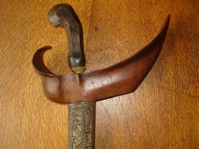

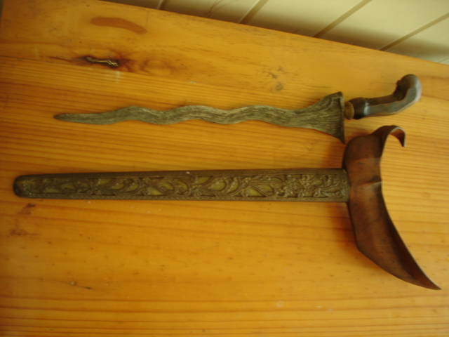

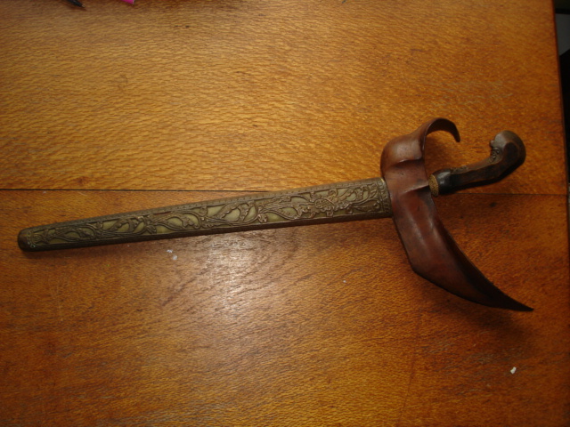

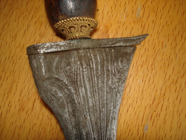

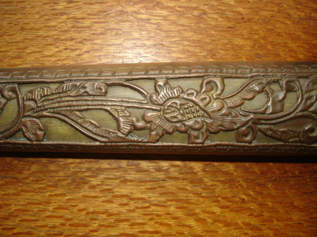

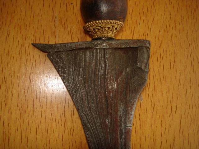

This is the other keris I have inherited. Would I be right in guessing it is from Solo? The wood seems quite dry so I will try the wood oil as has been suggested, but is there anything I can do to stop the rust that has started from doing any damage. Also I was wondering (I know it's probably not an easy question to answer), but does anyone have any idea how old this or the other keris I posted under "help please" are? Oh and one more question any clue about the metal it has a few green spots so does that mean it's copper should I care for it in a special way? O.k that was two questions sorry.Thanks again x

From the looks of it, this is a keris from Solo.
Try using sewing machine or any other kind of light neutral oil and a fine toothbrush. Give the blade a thorough brushing. use clean rags/tissue paper to clean off the rust (blot, not rub). Repeat oil-and-brushing until the oil blotted off no longer has rust in it (i.e. no longer brown/red).
Once this is done, you only need to clean the blade about once a month (assuming you keep the keris in a cool dry place).
There is a good possibility that this may not get some of more deep-set rust out. In which case, you might want to get in contact with of the more experienced collectors who can help you with cleaning the rust using more 'caustic methods'.

Welcome to the forum Toniaus. Both your keris have some real age to them, but i will stop short of pinpointing any period. Determining the tangguh of any keris is tricky in hand and extremely difficult based merely on internet photos. Some might offer their opinions anyway, but i would not chisel them in stone if i were you. I can see that yours are not modern keris and i would even guess they might be as old as 18thC or more (though i could be wrong).
This keris has one of the standing pamors or pamor adeg. It is indeed dressed in the formal (ladrang) Surakarta form so Solo is the probable origin. I doubt the green spots indicate copper unless you are referring to the metal part of the sheath (pendok), though that looks like it might be silver or some silver alloy (though mamas is more common). Have you tries a polishing cloth on it?
Blu Erf gave you some good advice, but i wouldn't be so hesitate about recommending more elaborate methods if the oil and brush doesn't fix your rust problem. Here's a link that might help you:
http://www.vikingsword.com/ubb/Forum1/HTML/000717.html
You might not want to go as far as the staining aspect discussed in this thread, which you would want to practice on some unimportant blades first i think, but the cleaning method is fairly safe and fool-proof and will remove deeper set rust.
