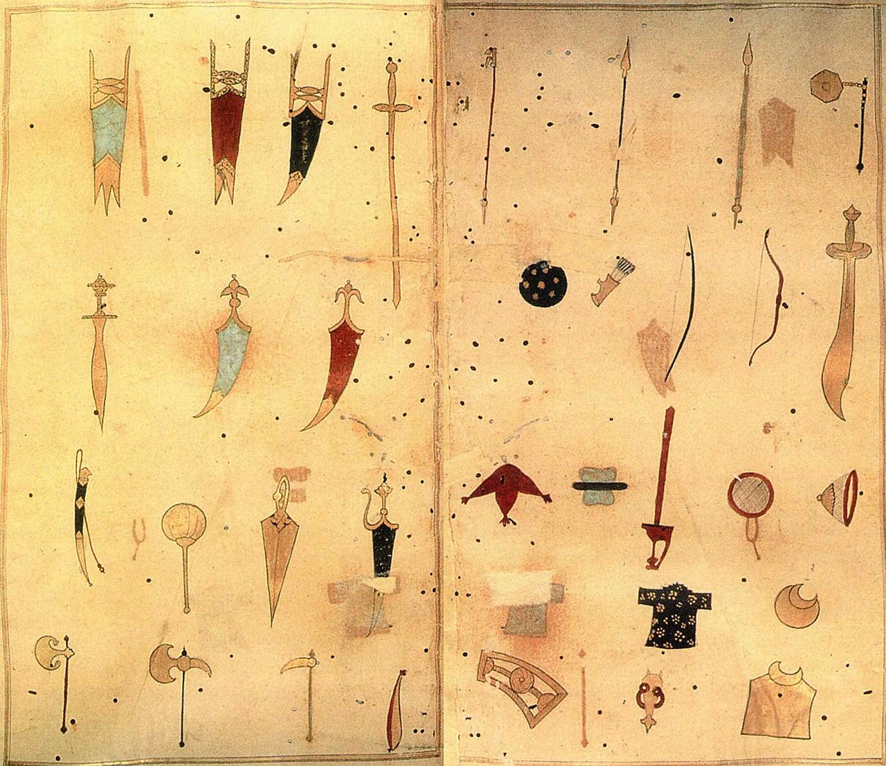

Possibly original plates. Made available on Wikimedia Commons (by a Russian speaker ) with following description:
1 row: jamdhar sehlicaneh (3-pointed dagger), jamdhar doulicaneh (2-pointed dagger), jamdhar (broad dagger), baneh (sword), javelin, tschehouta (spear), barchah (lance), flail.
2 row: katarah (katarsh, dagger), jhanbwah (jambiyah, dagger), khapwah (k'hapwah, dagger), dhal (shield), tarkash (quiver), maktah (bow), kaman (bow), scymitar.
3 row: gupti kard (dagger), shushbur (shashpar, mace), narsingmot'h (dagger), bank (dagger), g'hug'hwah (chainmail), udanah, bhelhetah (sword), phari (cane shield), sipar (shield). below: angirk'hah (over armour coat), zirih (coat of mail), kant'hah sobha (neck protection).
4 row: tarangalah (axe), tabar-zaghnol (axe with hammer), zaghnol (warhammer), chaqu (clasp knife), gardani (horse protection), qashqah (champron), bhanju (coat with neck protection).

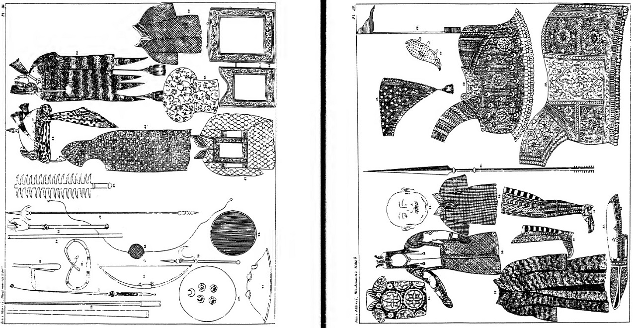

Plate from Egerton

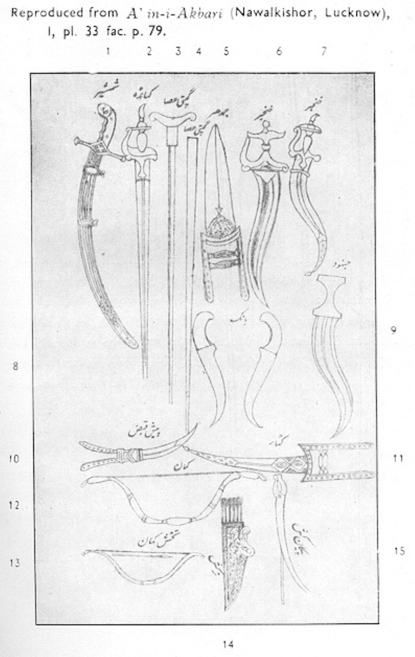

Aziz, Abdul, Arms and jewellery of the Indian Mughuls, Lahore, 1947. Originally posted by Jens.
(1) Shamshir,
(2) Khanda,
(3-4) Gupti ‘asa and sheath,
(5) Jamdhar,
(6) Khanjar,
(7) Jamkhak (according to Blockmann; name in plate therefore wrong),
(8) Bank,
(9) Janbwa (name in plate wrong again),
(10) Narsingh-moth (so in Blochmann; in plate the name is pesh-qabz),
(11) Katara,
(12) Kaman (bow),
(13) Takhsh-kaman (small bow) and arrow,
(14) Tarkash (quiver),
(15) Paikan-kash (arrow-drawer).

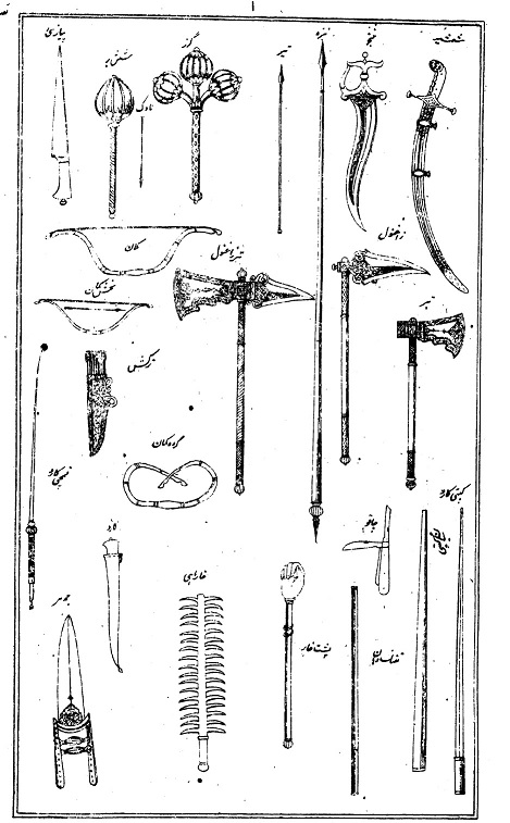

I promised:
Mercenary is offline   Reply With Quote

Excellent, thank you Mercenary! Now if anyone could get a shot from the original manuscript or one of its copies/facsimile that would be great

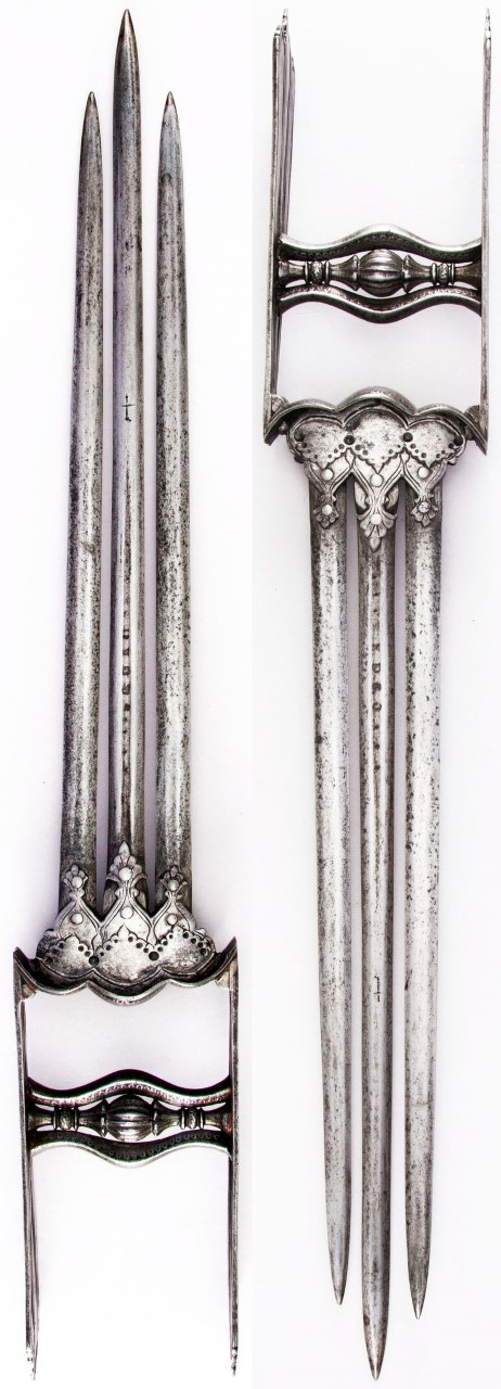

If you have a look at the plate shown in post 3, I am wondering why some of the blades are so long.
Look at no 26 Jamdhar Doulicaneh and no 32 Jamdhar Skhlicaneh. They have two or three points, but I am wondering if, when you try to stap someone, the stap would stop quite early - or a very big force would be needed, and they would be no good against mail armour.
So why did they make Jandhars like that?
Jens
Old 27th October 2015, 11:22 PM   #13
Emanuel
Emanuel's Avatar
Join Date: Jul 2005
Location: Toronto, Canada
Posts: 1,242
Egerton explained Doulicaneh and Sehlicaneh as follows:
"Doulicaneh" and "sehlicaneh", appear to be hybrid words (Pers. and Hind.)" "du-likhana," two-scratcher; "seh-likhana," three-scratcher. From likhana, to write or scratch - Note by Col.Yule.
I suppose the attached, South-Indian double-bladed (from Oriental-Arms) and triple-bladed (Tanjore, from Metropolitan Museum, bequest of George C. Stone) examples are representative. I don't think I've ever seen any other kind of two/three-pointed types, aside from the more modern scissor type.
Perhaps these were like the double-bladed bichwa. Less practical and effective, but more exotic and fearsome than a single blade

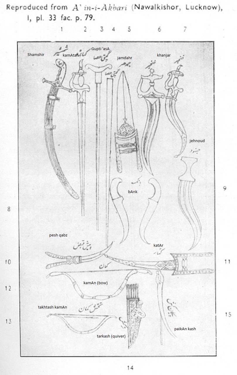

I wrote the proper pronunciations for this image, there is another image with Farsi names if you can get me a better copy of it I can do the same.

Emanuel,
Yes you are likely right, when it comes to the two or three bladed Jandhars, as anything else would be cloes to impossible.
Jens

AJ1356
Many thanks. It is correct: "bank" is just "curved dagger". Any curved dagger.

I tried to see if I could find a meaning for bAnk, but I could not find it in Farsi, it could be an Indian term.
