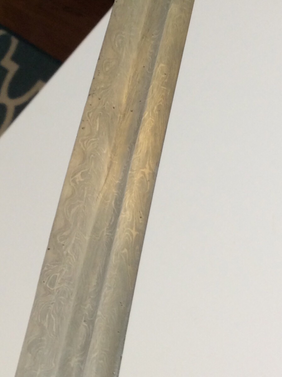

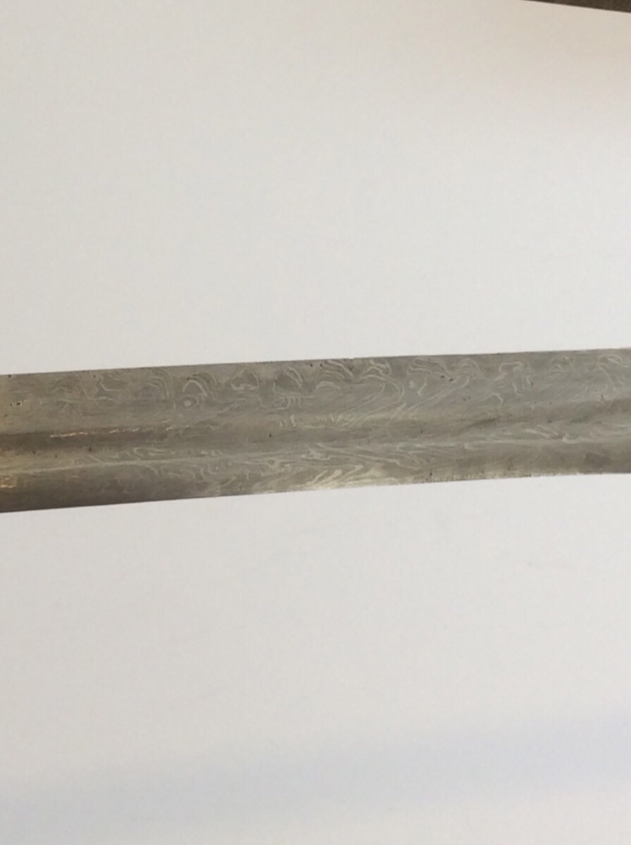

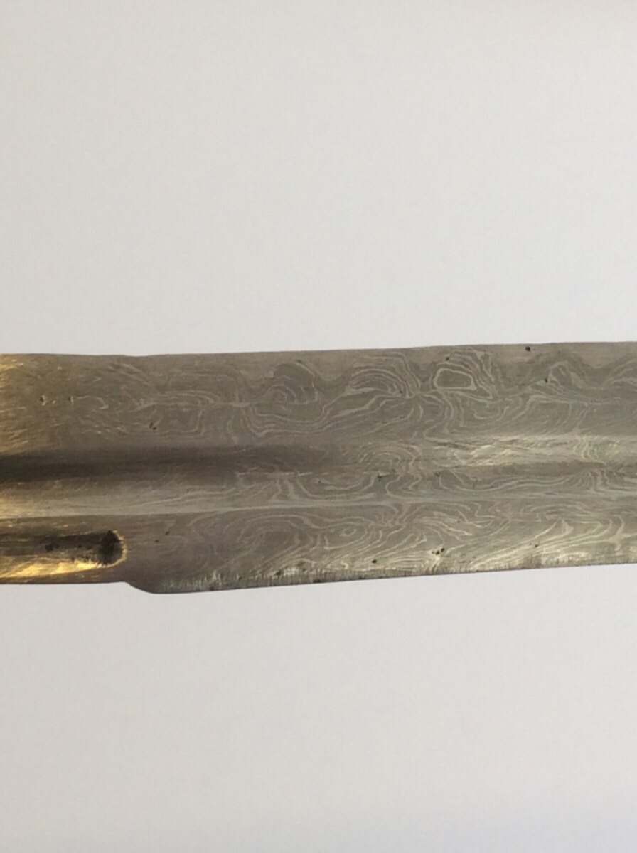

This post is for those collectors that appreciate patterned blades and for any blacksmiths that have created pattern welded blades.
This is a Chinese blade, 17/18th century, with a blade that features both twistcore AND a horse tooth Hamon. Fine twistcore that is tight without seam openings is an accomplishment and horse tooth Hamon by itself is a complicated feat. To find them together is quite rare.
Enjoy.

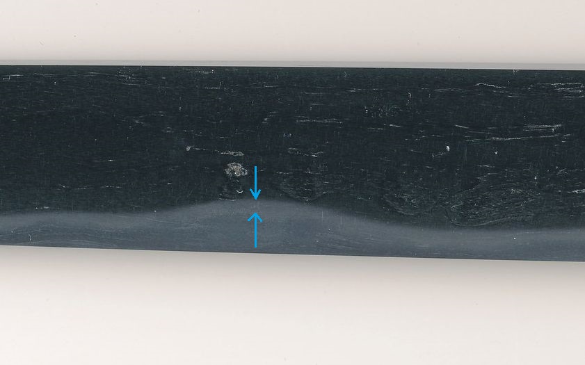

A very interesting blade with Torsion damascus pattern. But i can see no hamon. In my understanding the hamon is the transition area between the hard cutting edge and the softer steel above the cutting edge. The color of a real hamon differs from white to black, depending on the angle of light.
Can you make pictures with flashlight or with a scanner please? This would show the hamon more clearly.
And can you make a picture of the whole sword please?

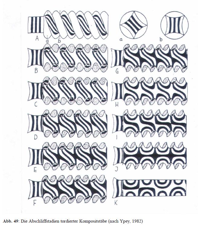

I added two pictures for you, one shows the hamon on my yoroi doshi tanto and the other one shows the compositions of a torsion damascus pattern, grinded down step by step.

The blade has an inserted edge between cheeks of twistcore steel. If you look at my bottom picture and then to the left side of the blade, which is the cutting edge, you will see regular undulations. Below those undulations there is no pattern. This is the area I am referring to as the hamon. While my pictures may not highlight it particularly well there is definitely a clear delineation. Look to the right side of the screen and you can see the twistcore pattern goes to the spine. That regular up and down undulation is referred to as horse tooth by the Chinese because of the regularity. Horse tooth hamon are fairly rare on their own but to accomplish this between cheeks of twistcore steel is a particularly fine forging.
I tend to use hamon in both a Japanese and non Japanese context. The high art polish of a Japanese sword is what really gives it that milky white coloration. Take a Japanese sword for just a foundation polish and you will clearly see the "hamon" but it will not be milky. Many cultures have blades made from inserts steel between cheeks of soft steel and if polished you will see that delineation between the two zones. You see it in Moro, in Chinese, in Indian and occasionally in Southeast Asia. You also see changes in coloration from heat treatment along the cutting edges. Some dha, for example, have their edges flamed hardened and this creates a dark zone along the edge. You see this on wootz steel sometimes. There will be a clear color differentiation between the hardened area and the rest of the blade. You even see it in Nepalese kukri and American Bowie knives. You can learn a lot about how the blade was forged, quenched and hardened from a professional polish and etch. I even one time had an early Kilij blade that had an inserted edge of high carbon steel between cheeks of wootz steel!

Thanks for explaining the "hamon" in the horse tooth inserted edge. Now that it is pointed out, the "milky", "cloudy" look is obvious along the edge. Some of the "teeth" are whiter than others, and you can see some where the milky look is discontinuous.
