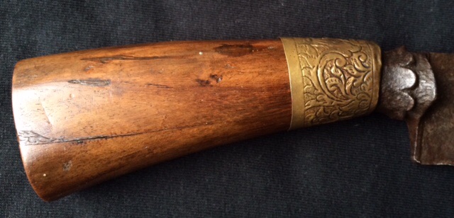

I recently acquired a sword whose blade is consistent with a sikin identification. However, the hilt does not match the strong implication in VZ's book that a sikin hilt is invariably forked. Nor does this hilt match what I know of the "horse-hoof" type hilts that are sometimes found on other swords from Sumatra, but I readily admit my limited expertise on that subject and this leads me to the query in this post.
See photo attached. The hilt is 4 1/2 inches long and about 1 1/2 inches high with an oval cross section, slightly flattened on the sides and increasing in size towards the down turned pommel as you can see in the photo. The pommel itself is nearly flat, with no decoration.
Any ideas what kind of hilt this is? Is it reasonable to think it could be found on a sikin?

One potential explanation for the discrepancy is that the handle is a later replacement.

I agree with Ariel. The whole thing is much later to the blade, including the bolster, or ferrule.

Yes, a later replacement.
The floral decoration on the ferrule is not Atjeh, nor is the hilt.
It looks also oversized. a picture of the complete weapon will give a better view on the size.

Agree with the others, it's a replacement hilt. When the blade is good I would look for a matching hilt.

In my opinion definitely recent replacements.
